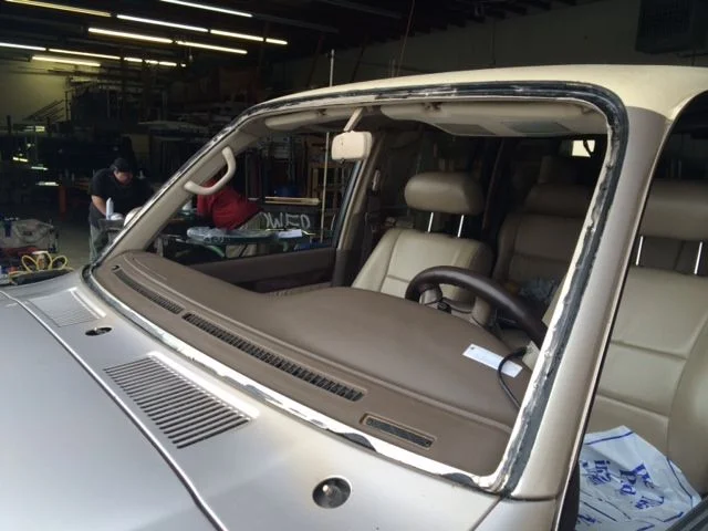

Glass and gasket came out very easily - he freed up the gasket while using his feet to essentially kick the glass out. Glass came out with the gasket still attached (no need to cut it since no sealant). The old sealant you see was from a previous job.
A close up of the old urethane from a prior install.

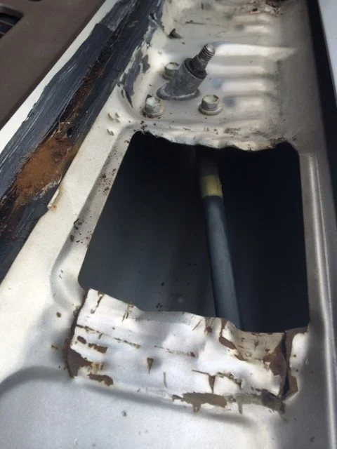

Rust spot from a leak and pooling water. Luckily it was not very deep. Also, the PO hack job cuts...anybody seen this before?
3M primer around entire windshield frame and on that nasty hack job cut, along with sealant on the cuts.

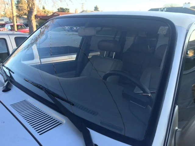

Finished product after I did the gasket to body urethane. The brown/bronze shade strip is very subtle on the LX450, it is an improvement over the previous windshield. Now, waiting for rain...
