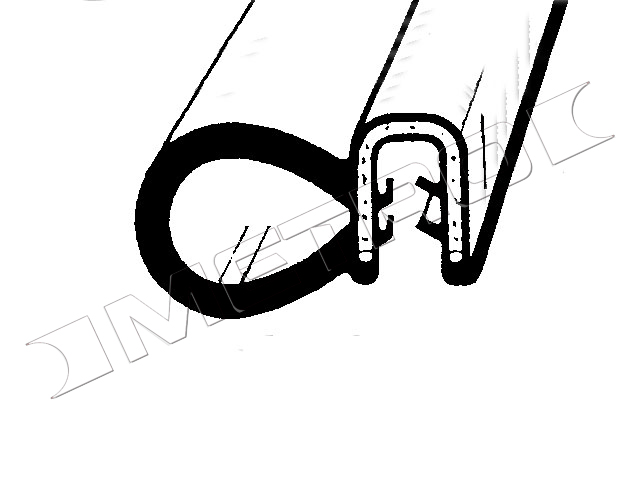

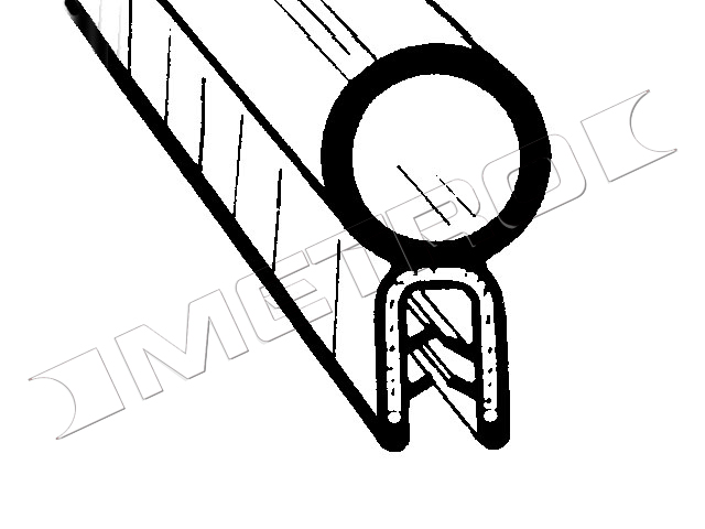

Here are some pictures of the two we carry (sorry for the large sizes).
Both are $4.25/foot. We only sell it by the foot so there is no limit to how much or how little you need.
The shipping will be an added cost. Price of the shipping all depends on location.
