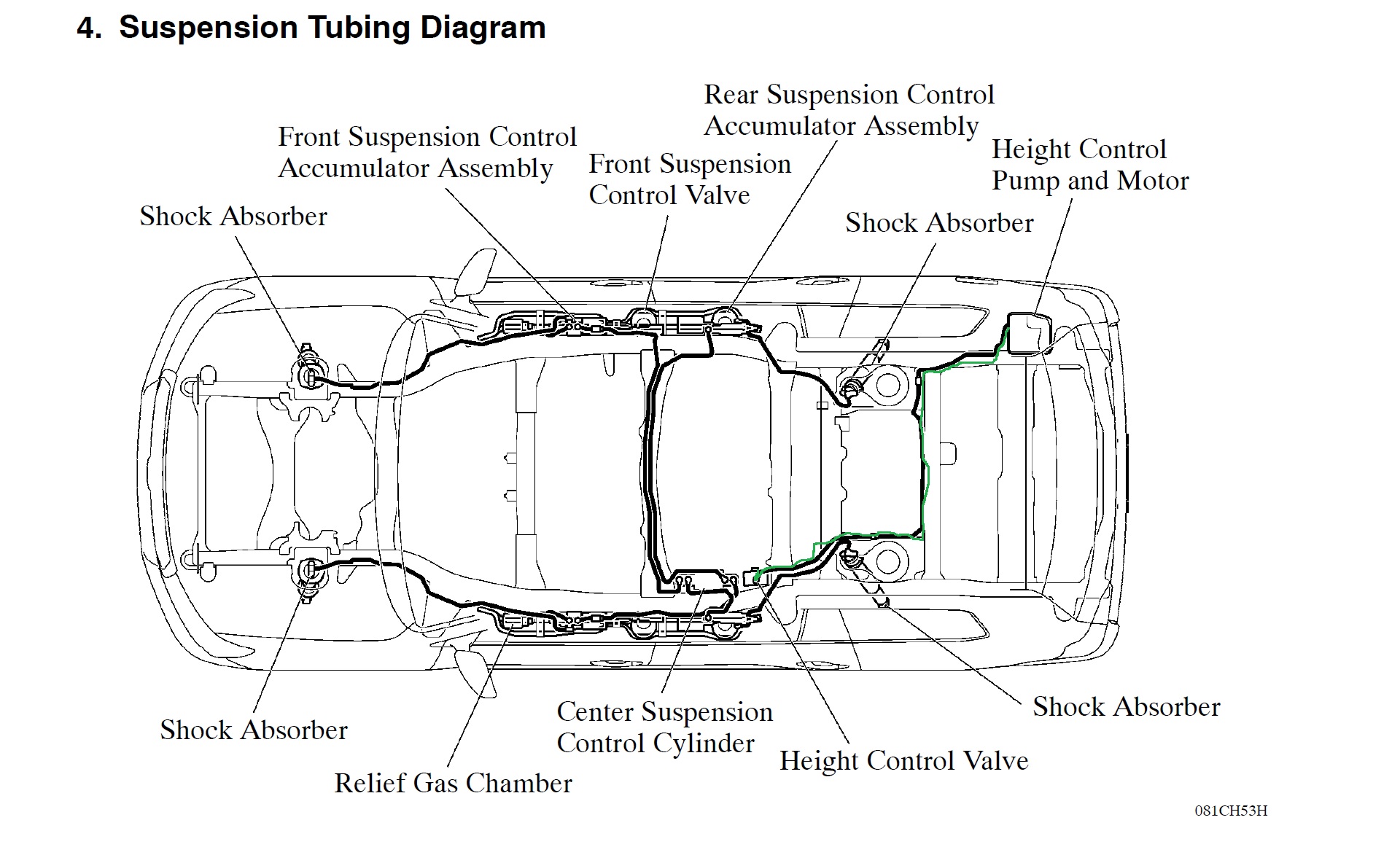

I know the truck says it's in N, but does it appear one of the corners is low? If you have lost fluid, after the height control valve, you should be down a couple inches in at least one corner, and if a gate valve has opened while driving, then lost height on both sides of the axle of the leaking part of the system.
If you are out of fluid and have not lost height, then the leak has to be between the pump and the leveling valve/accumulator. That would mean your leveling valves are closed and still holding pressure between the valves and the active part of the suspension. That would point towards the line NYC570 is referencing. It runs between the pump and the Height Control valve.
If the reservoir is empty and you don't have any fluid in the system between the pump and the height control valve, you definitely don't want the pump to run as it will allow air into the system. You can use the "AHC OFF" button, but remember that button is really only for when the truck is stationary. Once the truck is in motion, all the normal rules apply and the truck will ignore the "AHC OFF" command. The only way to be sure you don't run the pump would be to pull the fuse/relay for it.
highlighted the hydraulic line in green. If you had lost fluid after the height control valve, the truck would have to be on the bump stop on at least one corner. It would be the same as opening a bleeder valve from one of the corners.

The Height Control Valve is very close to the rear left side globe. (See the diagram in post #6 above.) The area in question is located where the line passes over the exhaust going between the pump and the HCV.
The thread I posted above speaks to both the rusted line (caused by moisture retained by heat shielding) and also a second failure where the bracket that holds the line and the line that goes to the rear shock (they run very close to each other for a brief period) pushes the two lines too close to each other causing wear on one or both lines until one fails.
