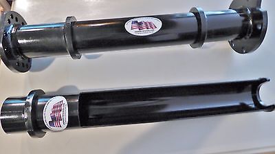

how complex is this tool? Have any pictures for those of us with a press and some fabrication ability?
It’s just big... we call it Thor’s Hammer.
Not ours but you get the idea...
You can buy them as well. No experience or affiliation:
