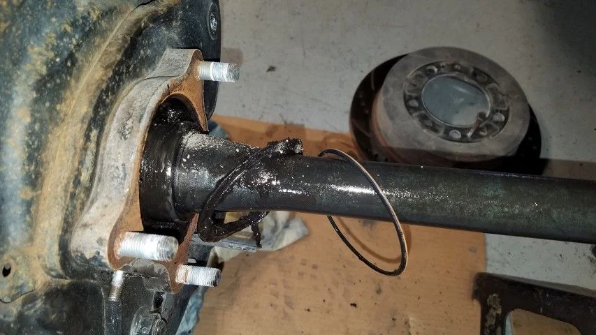

Will the axle pull out of and go back into the rear end without opening the 3rd member? My wife's 200 needs a rear wheel bearing and I have access to a press so I'm going to attempt it myself but the shop manual doesn't go into detail.
Yes, you remove the park brake cable, hydraulic brake line (or cut axle tab like we do) wnd remove the 4 nuts per side, the axle will slide right out. No need to touch the diff.

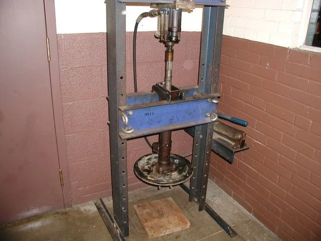

This axle sounds similar to the mini-truck SF type, where the shaft is pressed into the bearing. This is the jig I made for pressing them out:
In use:
I'm sure it won't fit on the Cruiser axle, just wondering if the method is similar.
In use:
Identical method with a tool similar but with the 200 dimensions, etc. Same setup with the retained bearing and retainer sleeve, etc.
