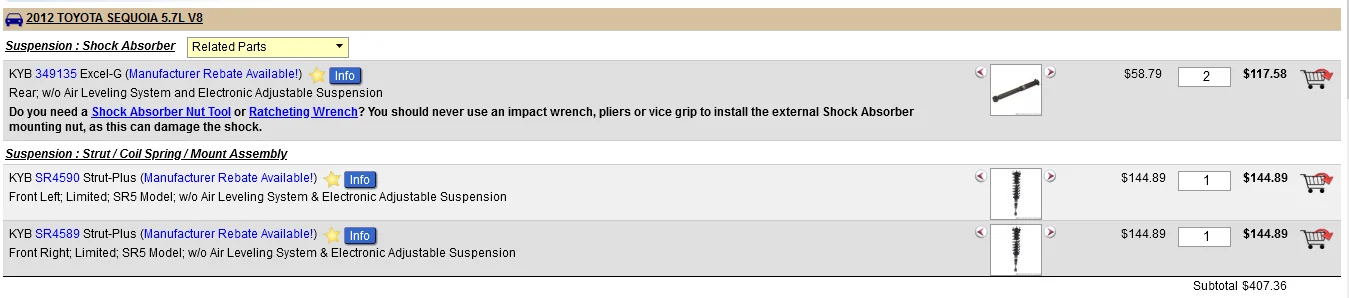

Looking forward to getting the springs. I am also going to replace the rear shocks and loaded front shocks / springs with KYB when I do the rear springs:
