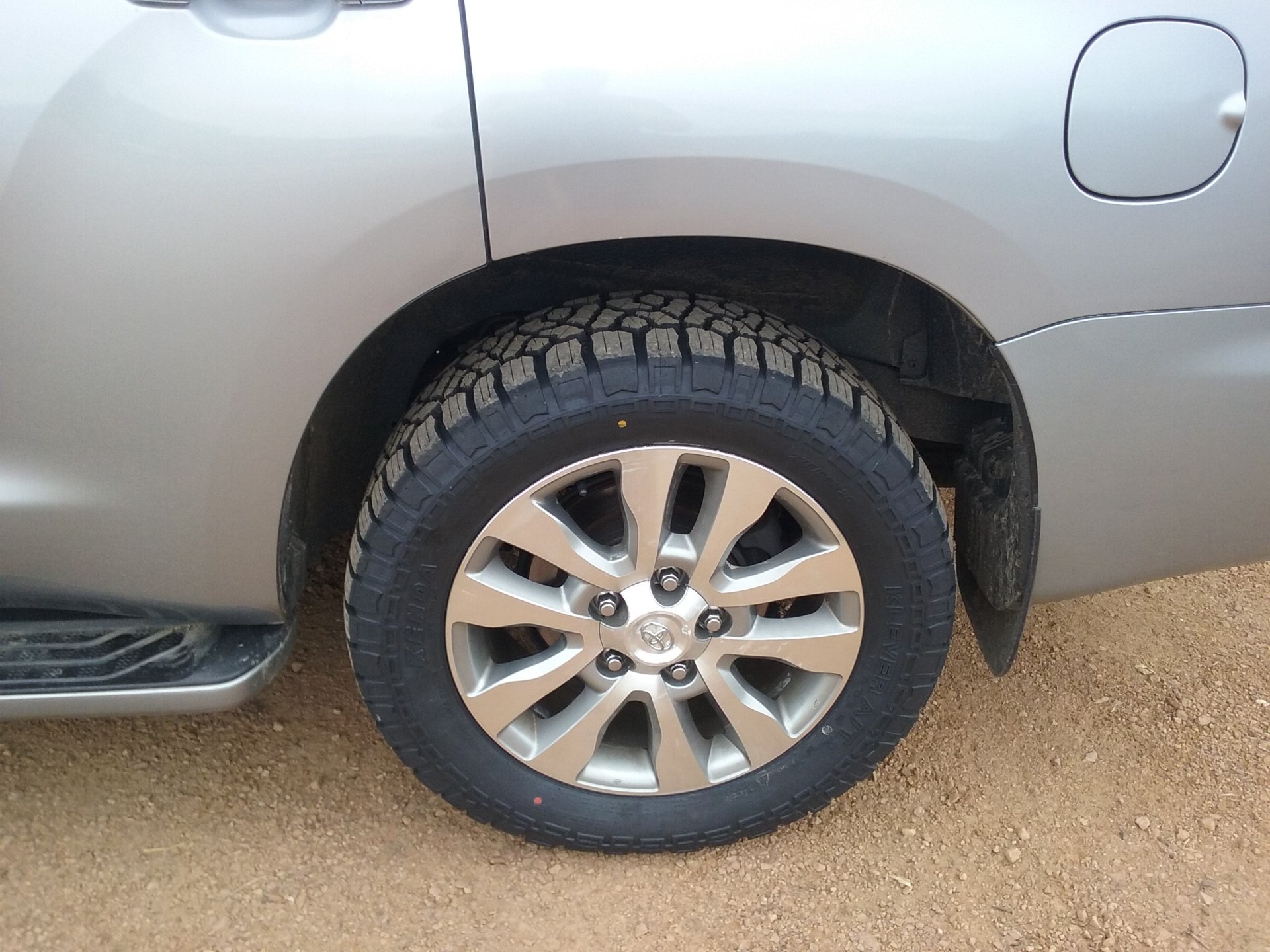

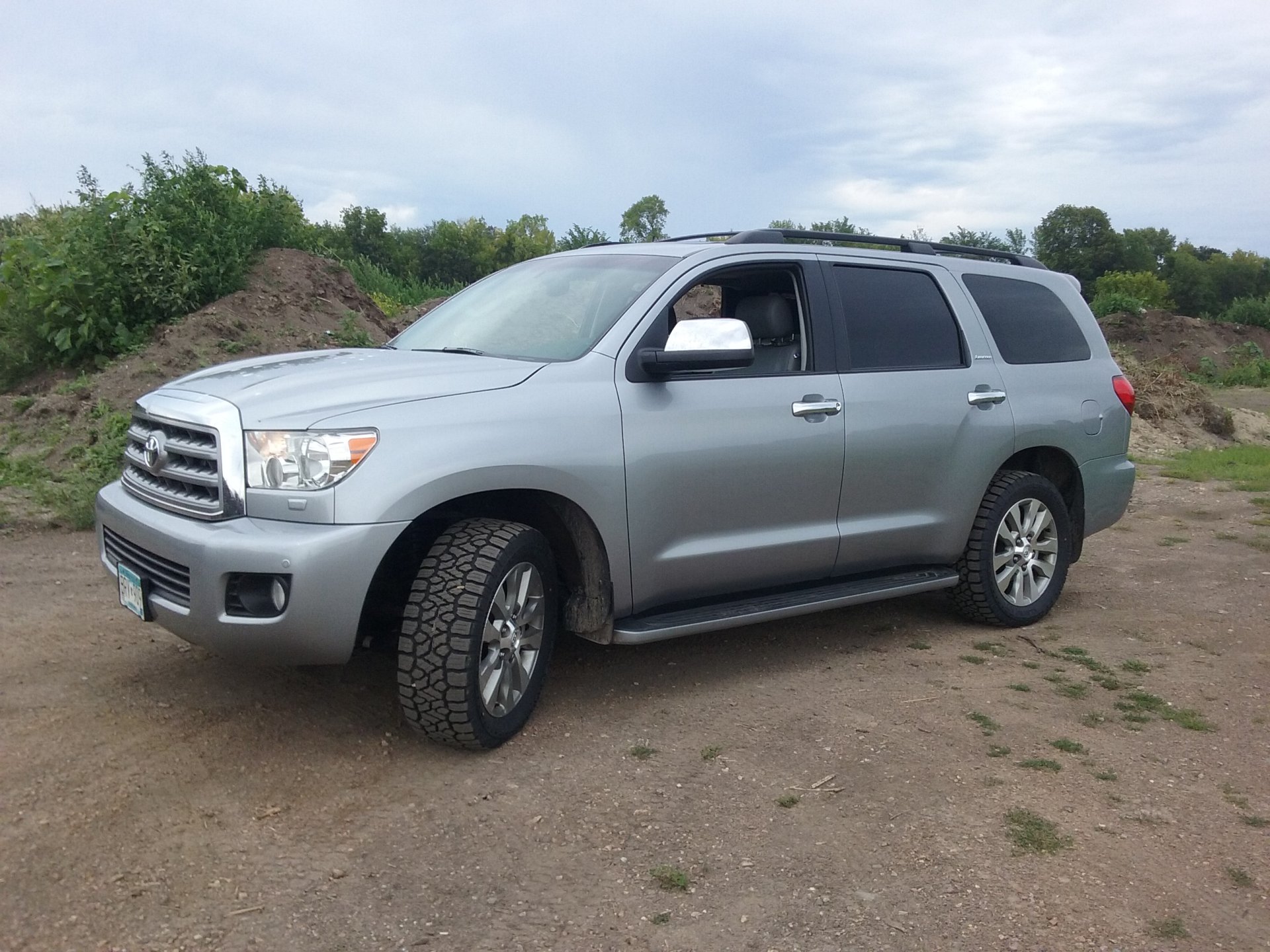

Got new tires installed! Kenda Klever A/T 2 275/55R20 XL tires installed, alignment and 4 new TPMS. The tires were only $170 each, I couldnt pass that up, most other comperable tires were $240+.
The tires are definitely more aggressive than I though they'd be. Yes, they are louder than the street tires that came with it. I only have 40 miles on them so far, they ride fine and handle well. They almost look like M/T tires.
Will update with my opinion of the tires as I put more miles on them. I tow a boat and larger camper, so keeping the OEM size was important, also wanted to upgrade to XL (extra load) rating.

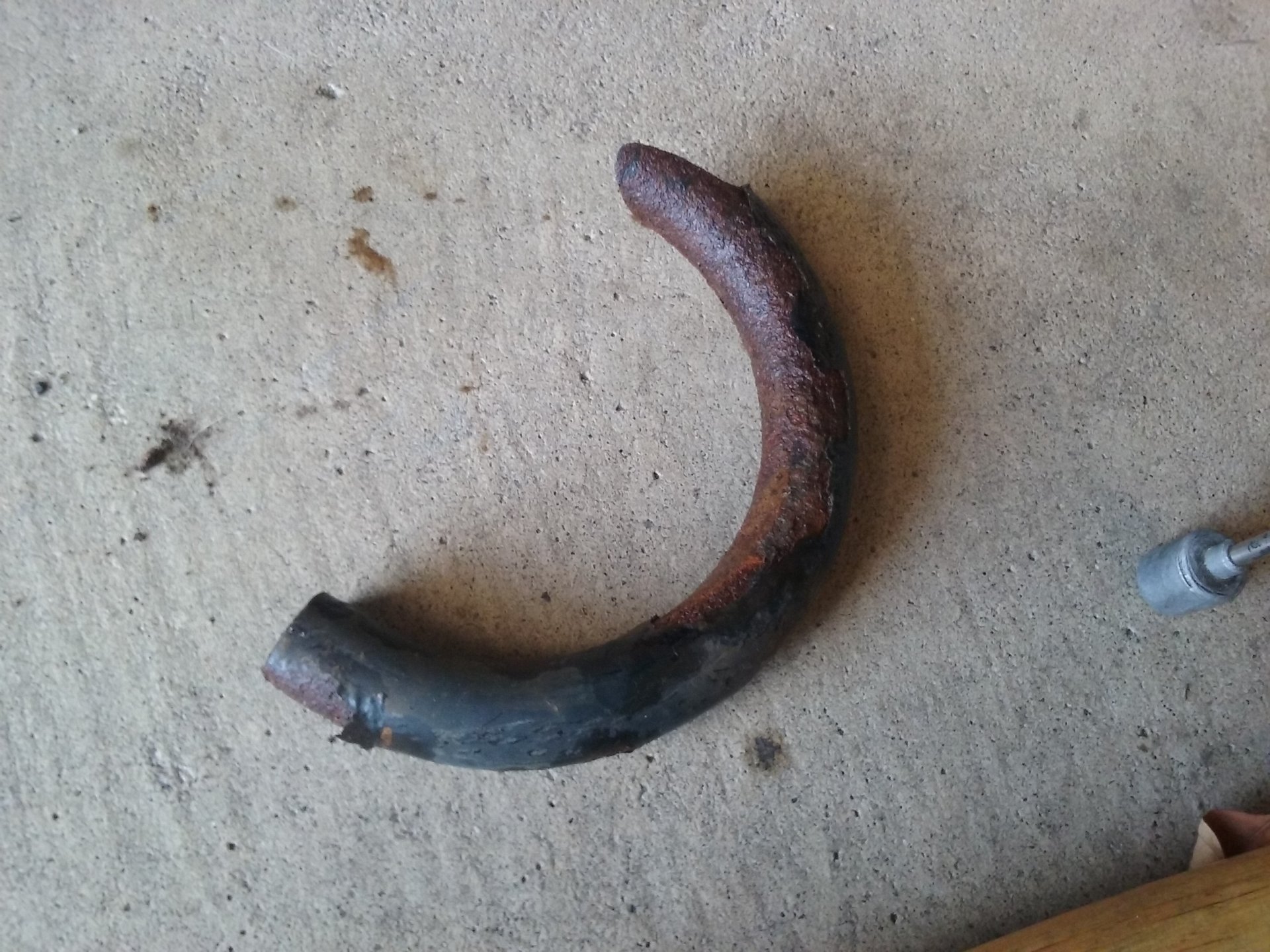

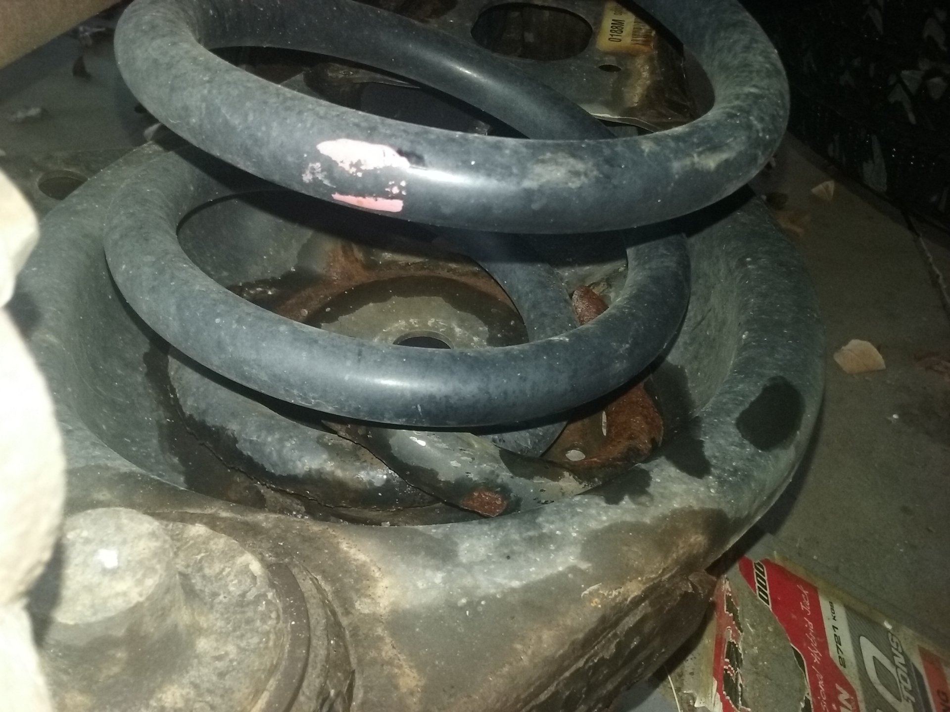

I heard a loud metallic rattle when hitting bumps from the RR wheel area today. Found a broken rear coil spring.
I'm now looking for heavy-duty springs that dont increase lift height - any ideas?
The Dobinsons look good, but out of stock. any other ideas?
Awe crap, that stinks. I know there is a company that will make you coil springs to order at your height and size specs and weight requirements but I can’t remember the name of the company.
So apparently Gen 2 sequoia rear suspension coil springs are made of unobtanium. Expensive and/or out of stock, even the OEM springs are horrible.
I decided to go with standard height Dobinsons, but they wont be in until early 2023.
Does anyone have a used / OEM rear spring I could purchase?
Even cheaper and free shipping with code FREESHIP
Thanks for the heads up, but all i have to say is "yeah right"! These are on national backorder. These dealers do not have them in stock, and the ETA is TBD. The springs are on a ship or stuck in a port. Dealers have no ETA.
