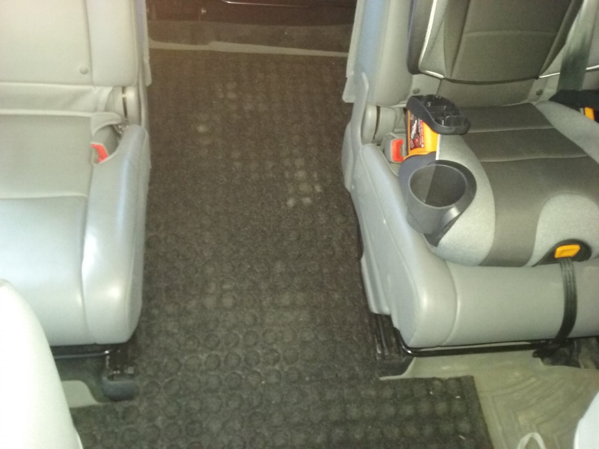

First Mod: Removed center seat from middle row to create pass through like a minivan. Looks better in person. Excellent, useful mod for a family of 6:

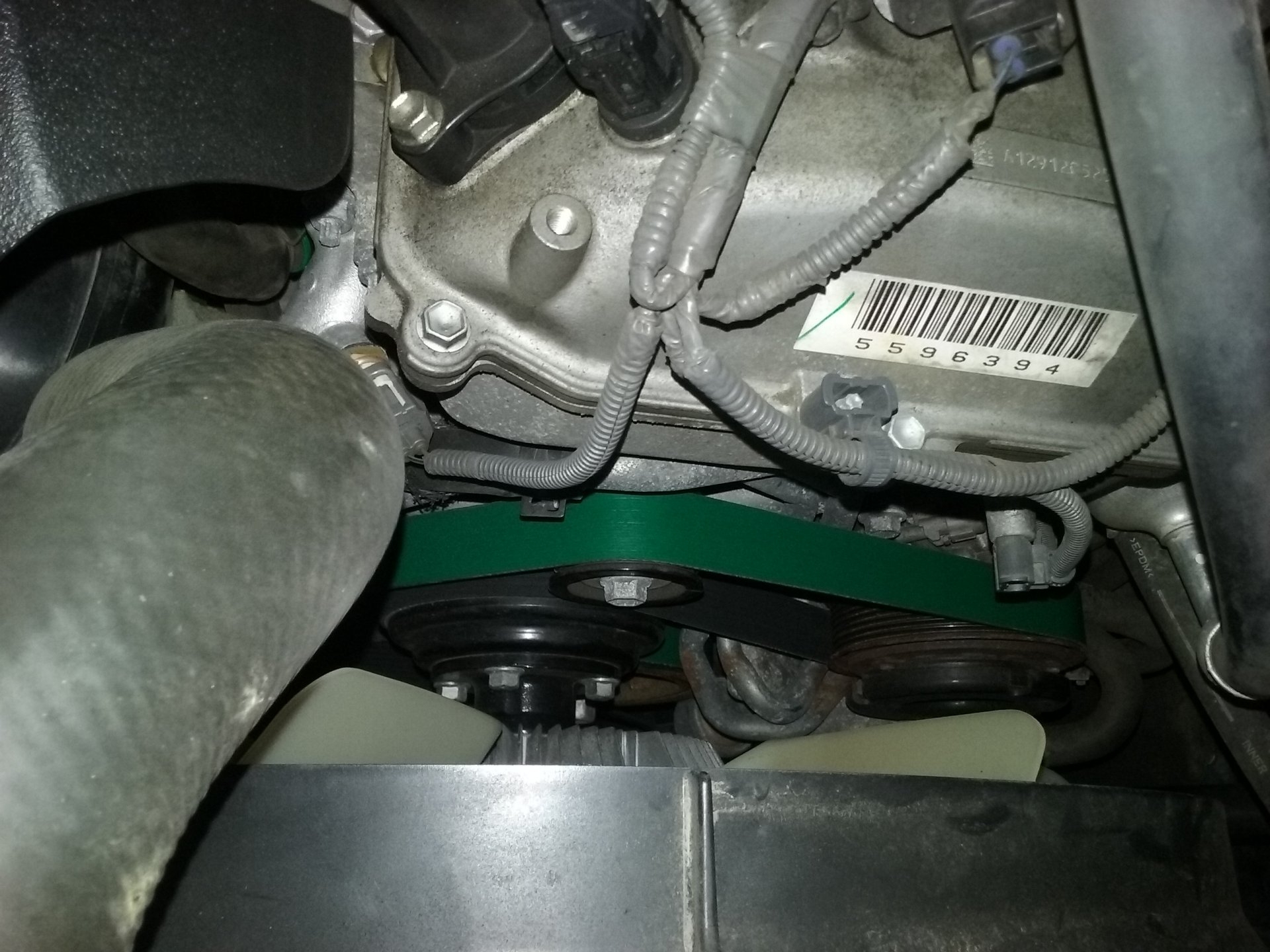

Replaced OEM belt with a (AC Delco) Gates FleetRunner ($22 on RockAuto):

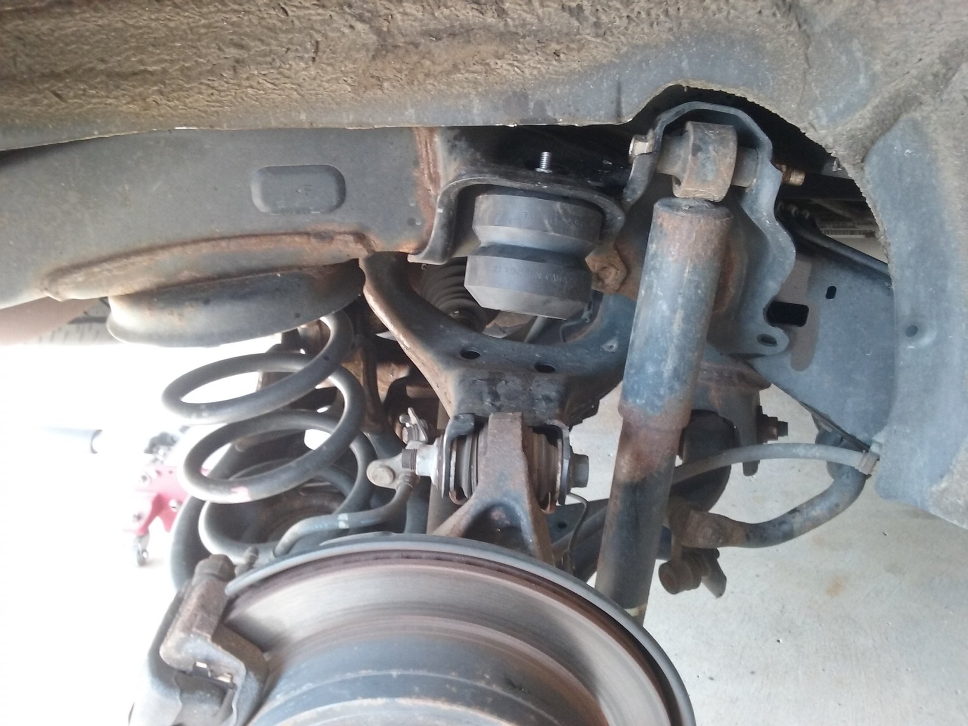

Installed some Timbren springs / bumpers today.
Timbren Industries TORSEQ1 - Timbren Suspension Enhancement Systems​
Took about 30 minutes. Removing the rear tires is a must for simplicity of the install.
I'll report performance after I tow with them. Looks like new shocks are in order as well.
Drove approx 30 miles with 0 load, the Timbrens made 0 difference.
Drove 30 miles with my 18.5' boat, Timbrens made 0 difference, couldn't tell if they were working or not, rode great, handled well, minimal squat. The boat only has 200lbs of tongue weight though, so they might not have been engaging yet.
The real test will be the camper, which I will load ups soon.
The Timbren SES kit for the Sequoia is amazing, I highly recommend them for the sequoia IRS if you are towing. Handled totally different with them installed, much more confident and solid than the standard suspension when towing the camper. No weight distribution hitch needed, love it.
