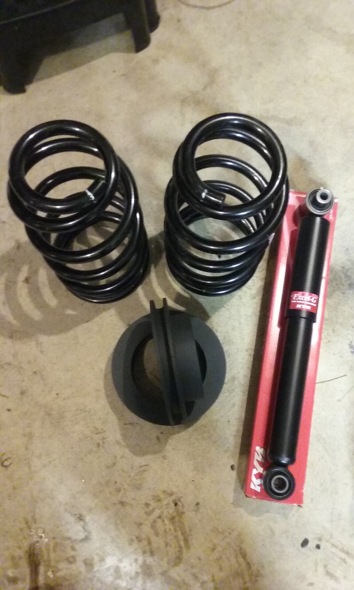

Since Dobinsons springs (stock height and 1.75") are out until June / July now, I ordered some factory springs, new KYB shocks, and 1" rear lift spacers. All going in this weekend, finally. Wish me luck, I'll update when done.

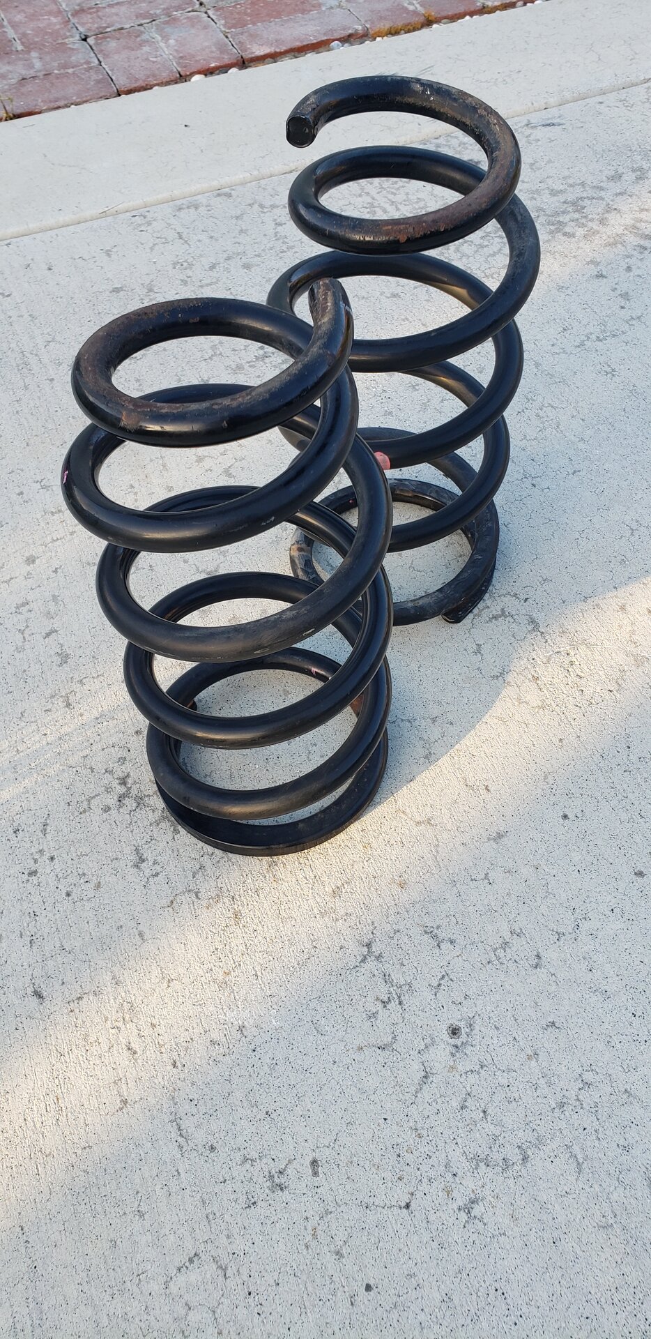

I was able to find a lightly used 1.75" dobi coil in SoCal.

Got it done! Found out that BOTH rear coils were broken, that explains the heavy ass when towing. Check your springs!
Took about 3 hours to replace both coils springs, both shocks, and install 1" spring spacers. It looks amazing, I'll post good pics tomorrow in the daylight.
Using spring compressor OEMTOOLS Coil Spring Compressor 57035 (rented from AutoZone) is questionable. If I didn't have a few decades of mechanical and engineering experience, it would not have very been safe.

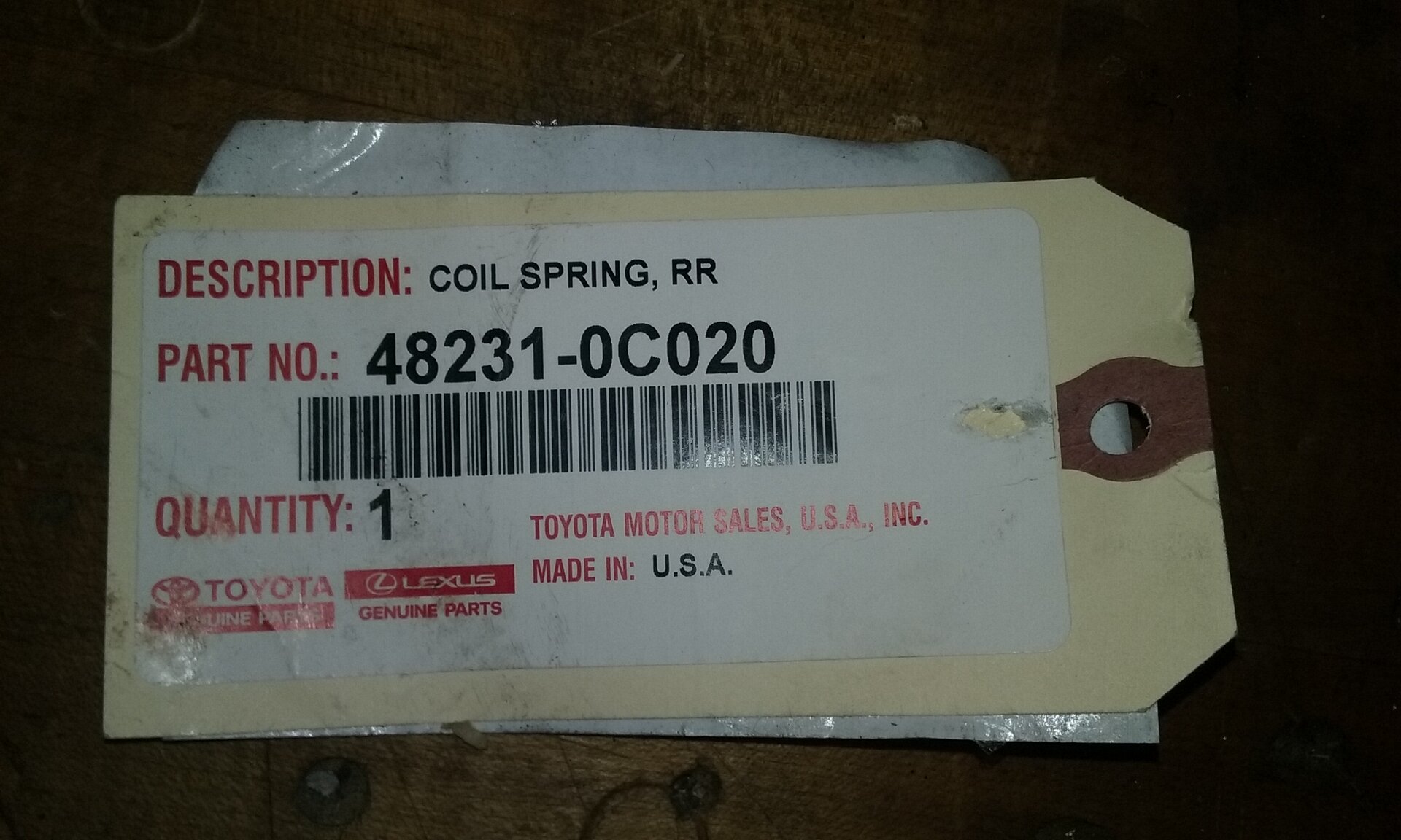

1. I found the set of OEM springs online, here: Joseph Toyota in Cincinnati, Ohio. For some reason they were the cheapest and free shipping.
