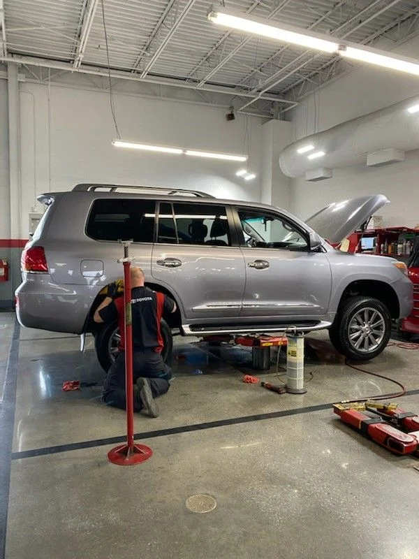

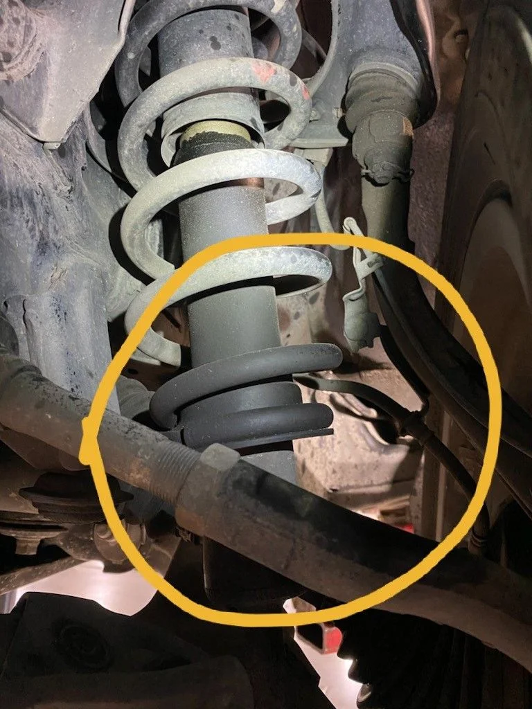

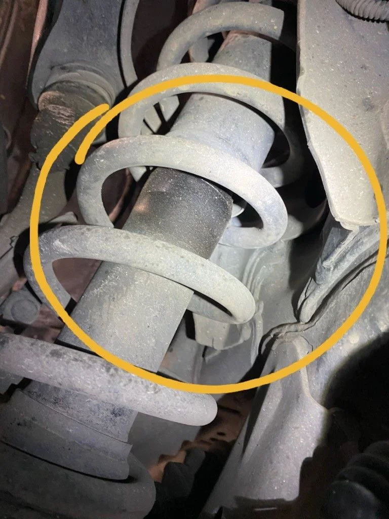

I recently purchased a 2011 LX570 with 77k miles and a clean Carfax (no accidents, 2 owner) in Fayetteville Arkansas, at Honda of Fayetteville sight unseen as I live in Tampa, FL. I requested a full 60k mile service be completed as I wanted to hit the reset button on all service and to ensure she would be ready for the drive back to Tampa. I also requested a full inspection (at their sister company - Toyota service across the street from Honda), when inspecting the car, the Toyota mechanic (previous Lexus mechanic) noticed that there was an oil leak from the front shocks and leaked down to the oil cooler and filter housing. On Monday, I requested to replace them, additionally on Wednesday I requested replacing the rears (although no leak) so they would all be new. While my wife and her friend were attempting to pick up the car on Saturday (tickets were purchased 2 weeks prior), they informed me that while the mechanic was putting the AHC Fluid back in the car after replacing the rears and it was not taking it, fluids were bled and it was slammed to the ground. They kept me well informed during the process as they were attempting to have the car ready for the long drive in the 11th hour, and told me that after some time the mechanic was able to push the AHC fluid through the lines and thought that perhaps there was buildup which needed to be flushed out. Everyone was overjoyed as we thought we had solved the issue; however, they called back and said that during the mechanic's test drive it did not take and the he was noticing a ticking noise, which he said was the AHC pump and that as soon as the car would be turned off the car would drop again and would not be suitable for driving (especially long distance). They assume there is an issue with the AHC pump and called the 2 closest Lexus dealers; one was closed on Saturday (service dept.) and the other had the part on backorder. As I was researching the forums (ClubLexus, & IH8MUD) I requested the mechanic do two things which seemed to solve the issue for previous owners.
1st - Clear the ACH codes (previously attempted by mechanic)

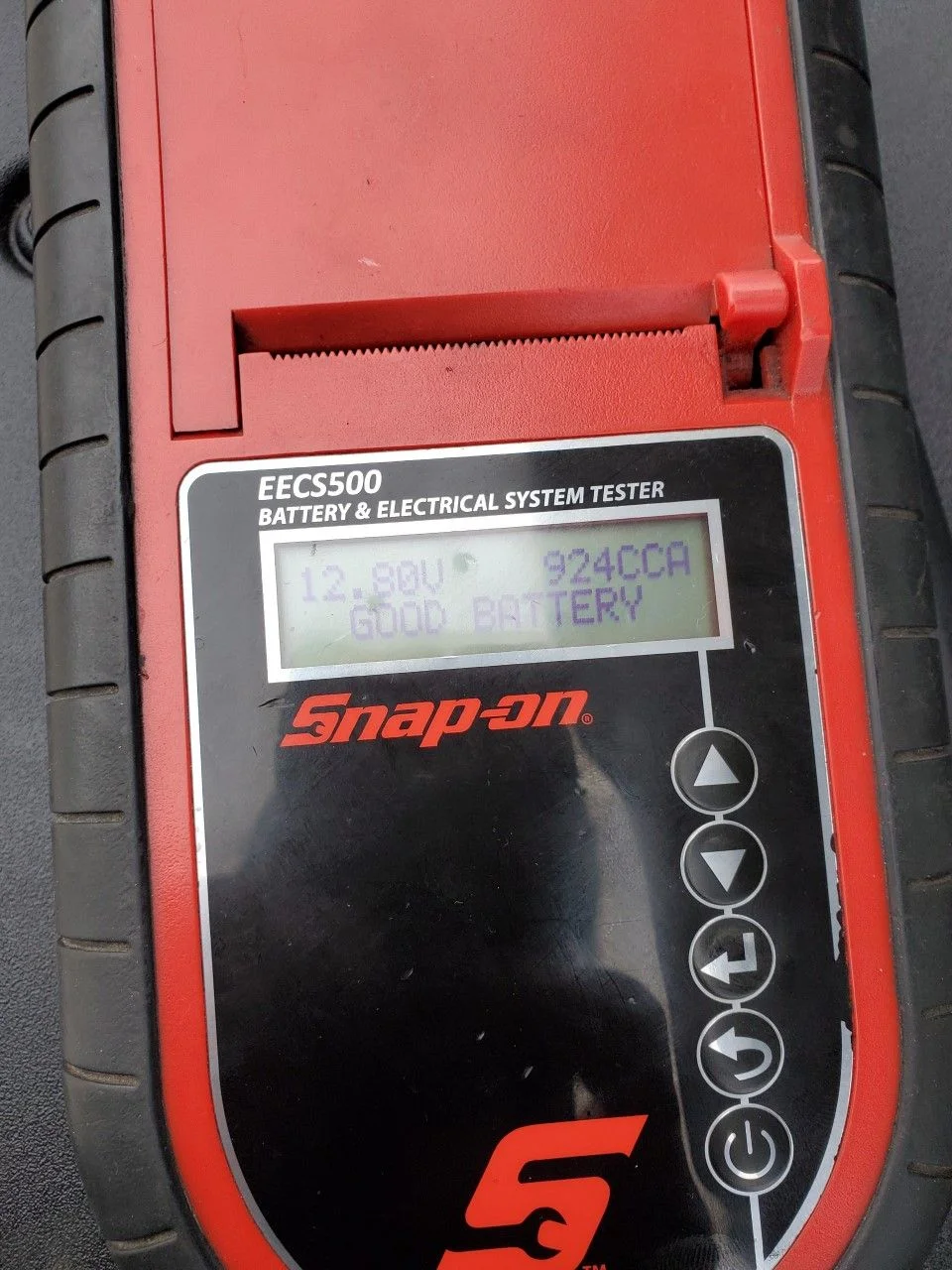

2nd - Check the voltage of the battery to ensure it would be able to operate the pump (previously done during inspection, and redone upon my request)

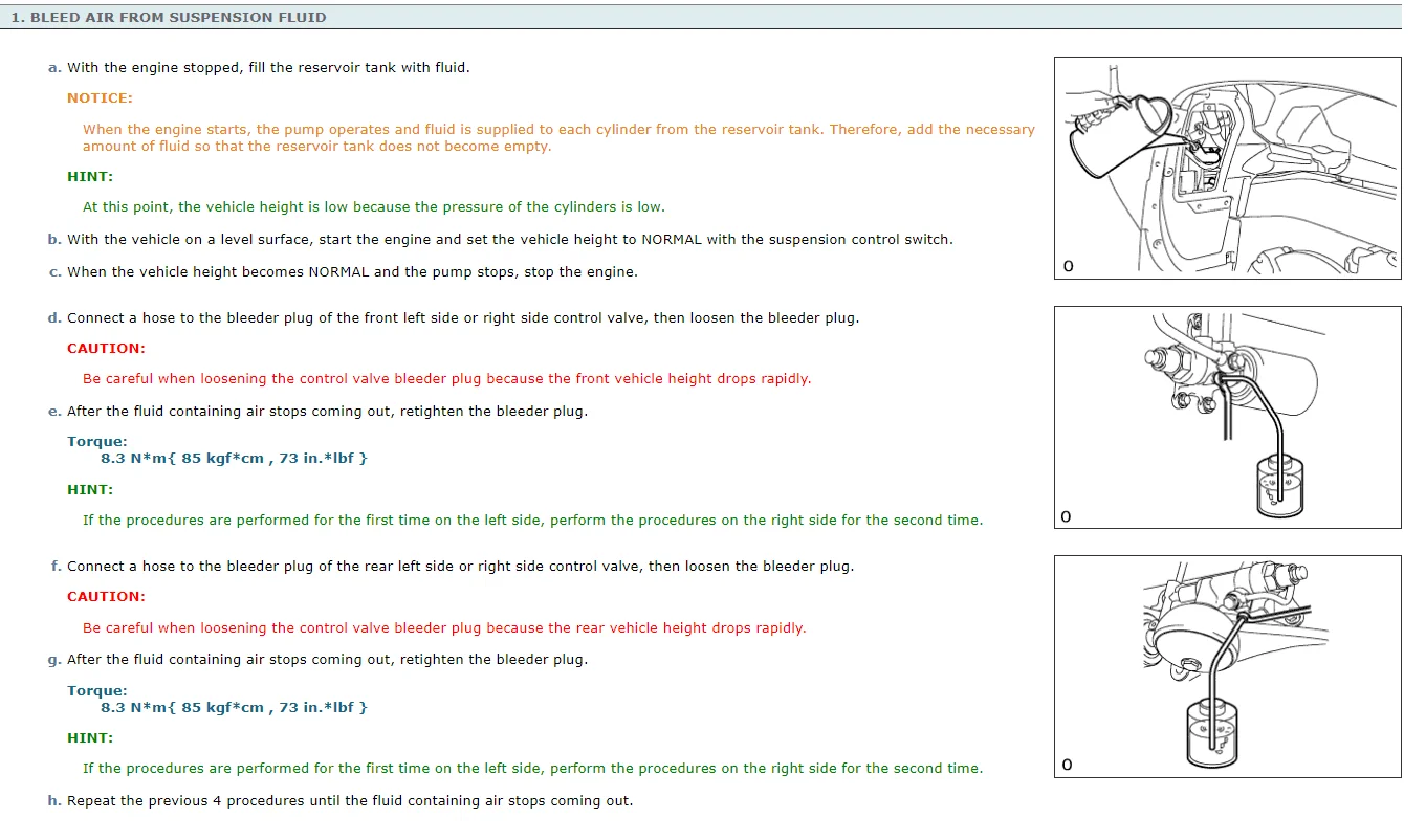

The dealer is going down the bad hole. It's not the pump. Some faint clicking noise is not abnormal. The system needs to be bleed and burped, as the pump is just sucking air. We've seen others go down this hole before with the dealer only to come full circle after multiple pumps to proper bleeding of the system. @eatSleepWoof
I also don't think this sounds like the pump being at fault. Almost certain there's air or something else (other than fluid) in the lines.
If they do install a new pump, tell them (at least 50 times) that it is NOT self priming and that it HAS to be manually primed or they WILL burn it out.

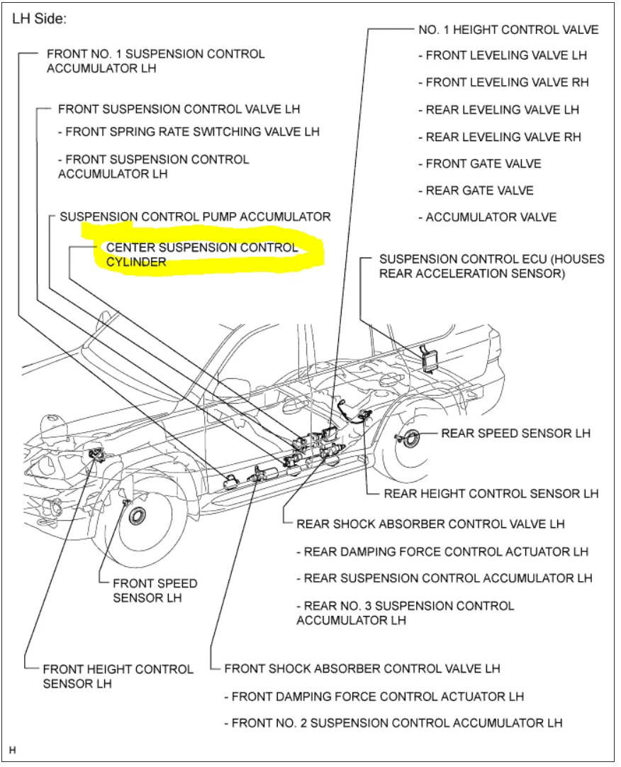

I believe the following to be the key issue, which is not stated at all, in the repair manual bleed procedure. It's because the state of the system is in an atypical situation as a result of the tech allowing the AHC pump reservoir to run dry in initial priming after changing shocks.

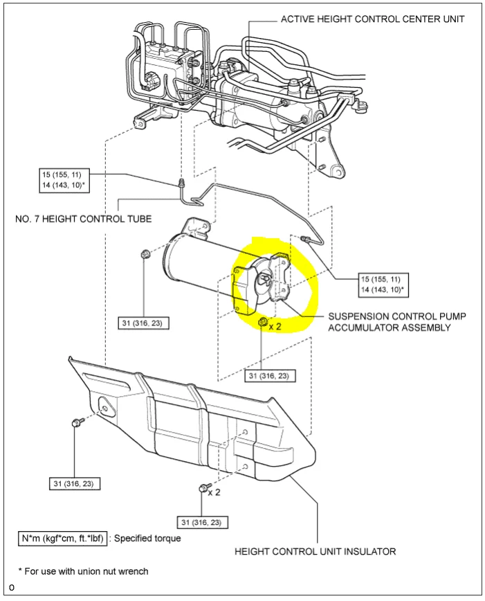

There is a main central accumulator that's located on the inside of the frame rail under a cover near the exhaust resonator. That accumulator has to be bleed and relieved of pressure, otherwise the AHC pump is dead heading into high pressure without the ability to prime out air. This 5th central accumulator is what feeds the 4 corner accumulators and what they need to bleed for the AHC pump to prime.
@jovan101 - tell the tech working on the car to bleed from below circled component/plug
