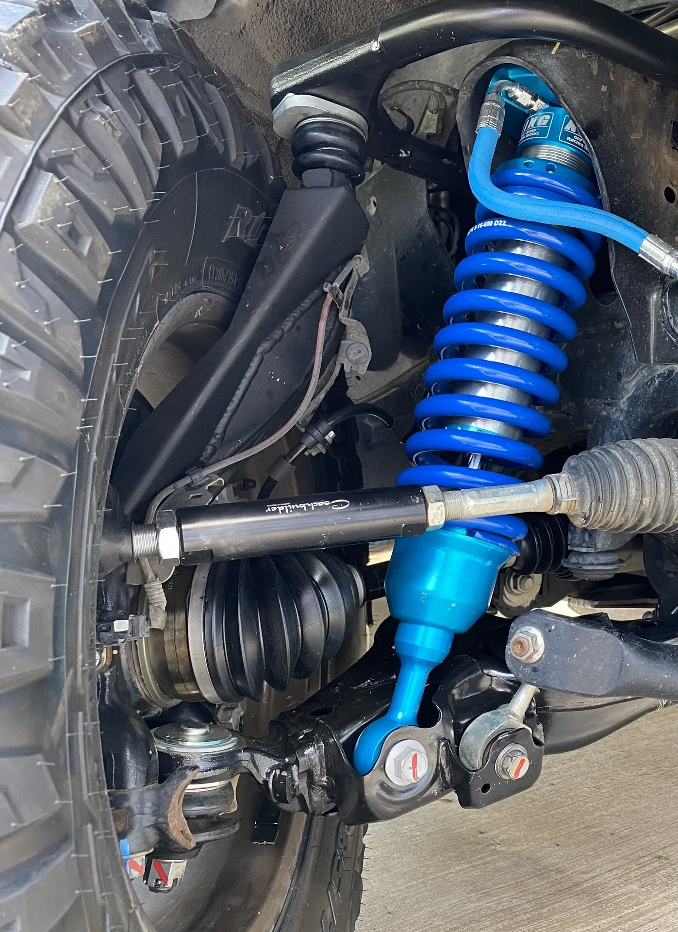

As for the front, you might consider different outer tie rod ends from Ekstrom Design. Coachbuilder OE Replacement Steering Kit, Tundra 2007-2021 Including TRD PRO - https://shop-coachbuilder.myshopify.com/collections/steering-upgrade-kits/products/coachbuilder-oe-replacement-steering-kit
The geometry of his OTRE's reduces bump steer.
My truck is Tundra-swapped and he made a set just for this oddball application (thanks to Nwfl4runner). If you know exactly how long they need to be, David Ekstrom could probably whip up some for the 200 Series. David answers his emails quickly: ekstrom_design@yahoo.com

Front end set up is CLEAN!!!! Great information too. Thank y’all for volunteering this information. It’s greatly appreciated.
