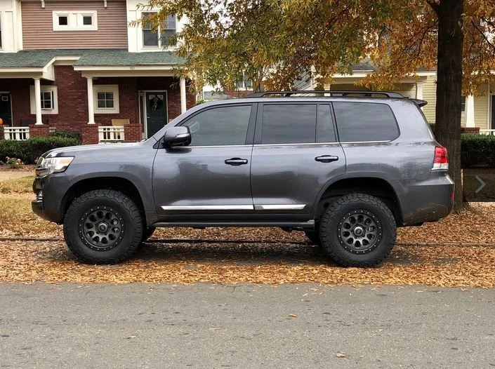

Hence the purchase of my 2009 Lexus LX570. I am starting off with swapping the OEM 20" Lexus wheels with 18" Stealth Custom Series - Ray 10 in matte black (18x9, 5x150, 6", +25mm). I read as much as I could find on the forum, in regards to the limitations of going for an upsize tyre setup on the LX570 and the rubbing issues. As of now, I am considering to go with 285/60/18. Obviously, many of you have gone over that size on the LX570. My question remains, what procedures have you gone though to actually eliminate the rubbing issue. So far based on my understanding, its been a combination of doing the fender liner mod and using spacers. I am planning to achieve the following look (note the LC200 is 2" lifted and is running 305/65/18 via performing the 4runner liner mod where its pushed 1" forward:

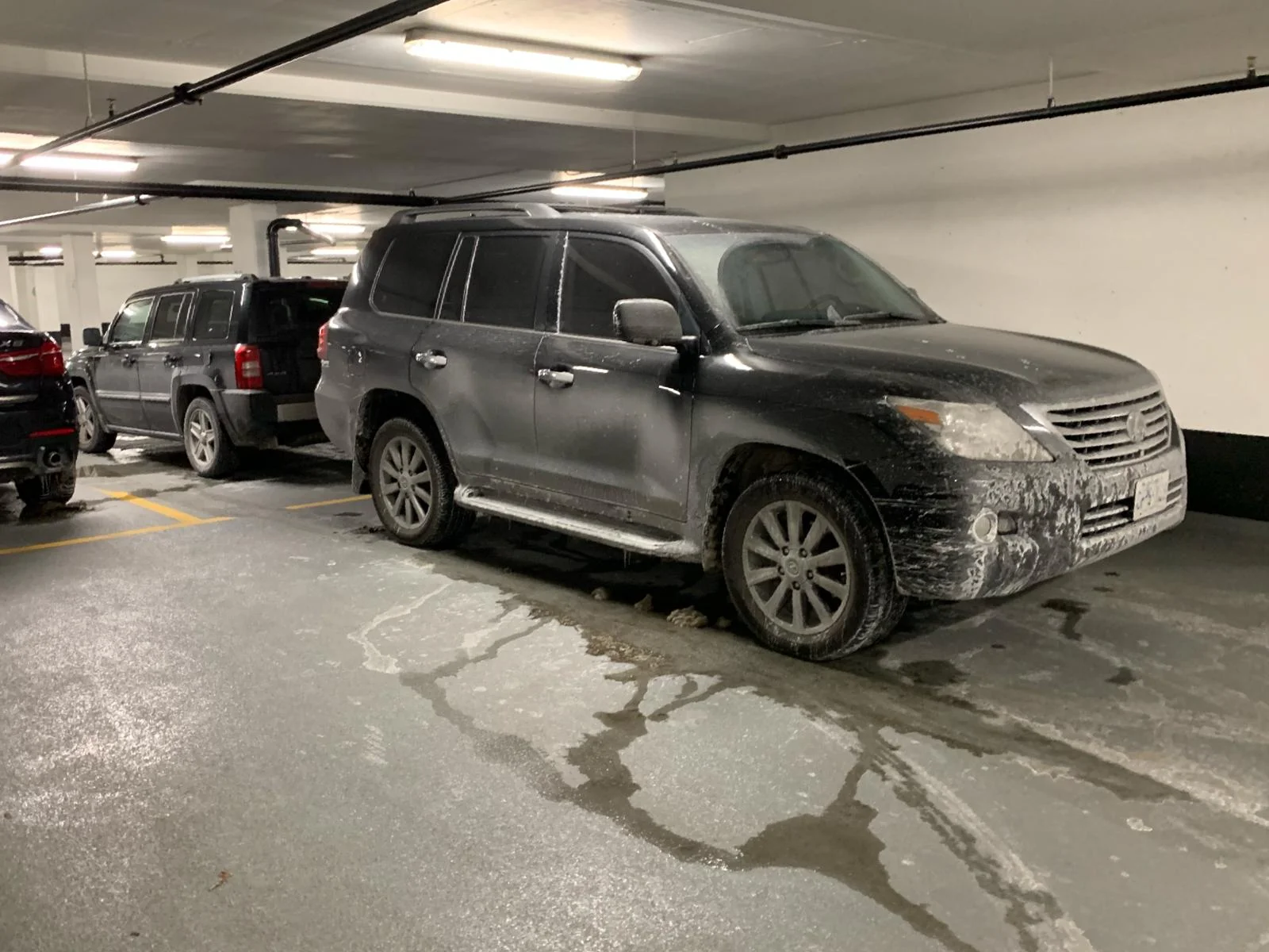

And finally perhaps I should put a picture of my truck, right? (excuse its dirty appearance, its been snowing!)
1918190
Have you gone through any similar procedures while upgrading your tyre size? What size and what mods have you had to perform to achieve the desired outcome? What do you recommend?

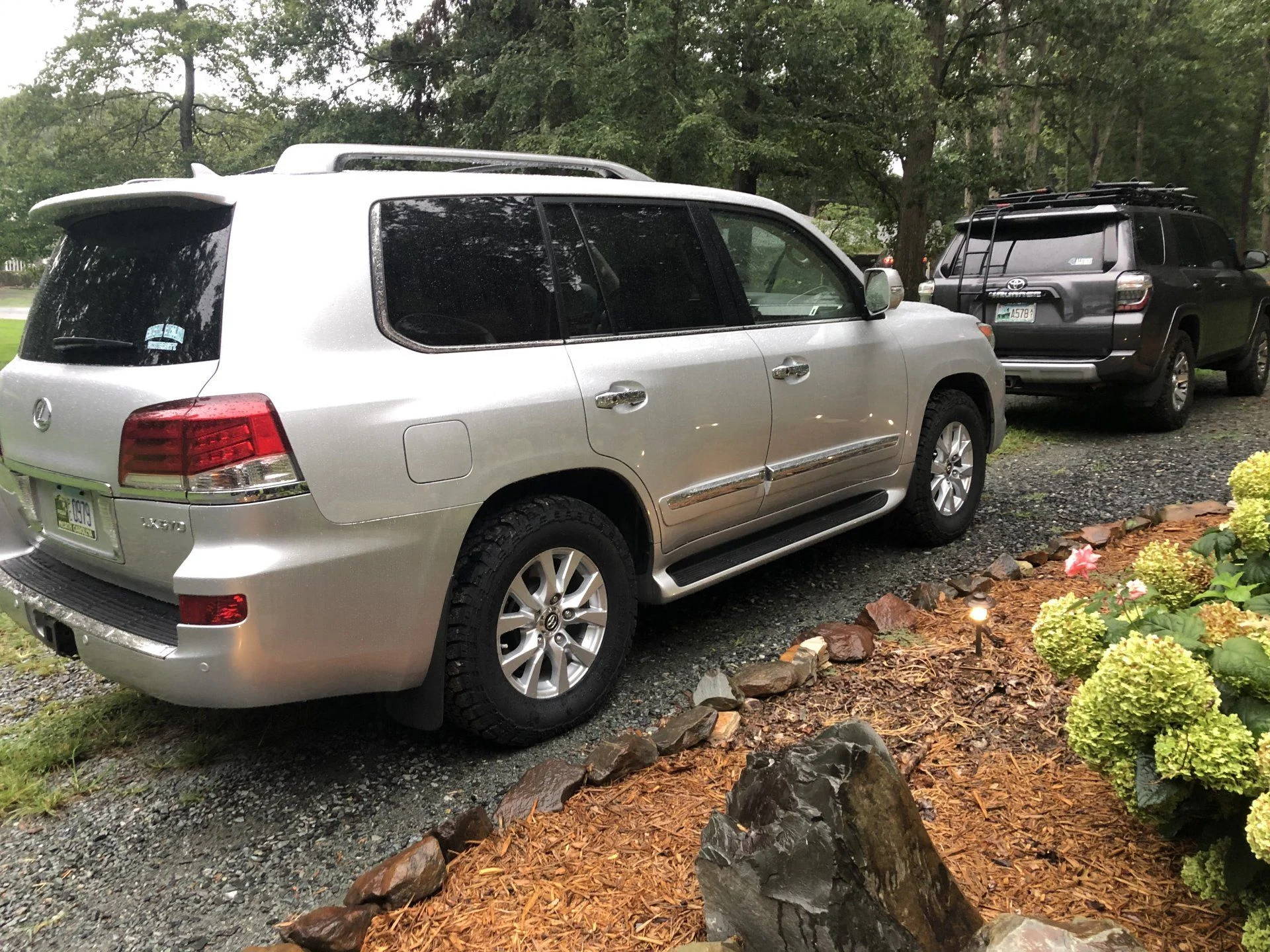

275/70/r18 and 25mm spacers on my 08:

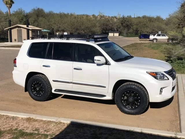

I had 285/60/18 Ridge Grapplers on my '14 LX. I loved them but wanted an even more aggressive look. I just recently replaced them with Ridge Grapplers 285/65R18. They look great. Fit snug with no mods required. I will try to find pictures to post.
I have NOT done the sensor lift. I want to but working under the truck is not my specialty and I would probably screw it up.
If anyone could recommend someone in the Phoenix/ Scottsdale area that could do this with/ for me - I would be happy.
Here is a picture with the Ridge Grapplers 285/65 R18. No sensor lift

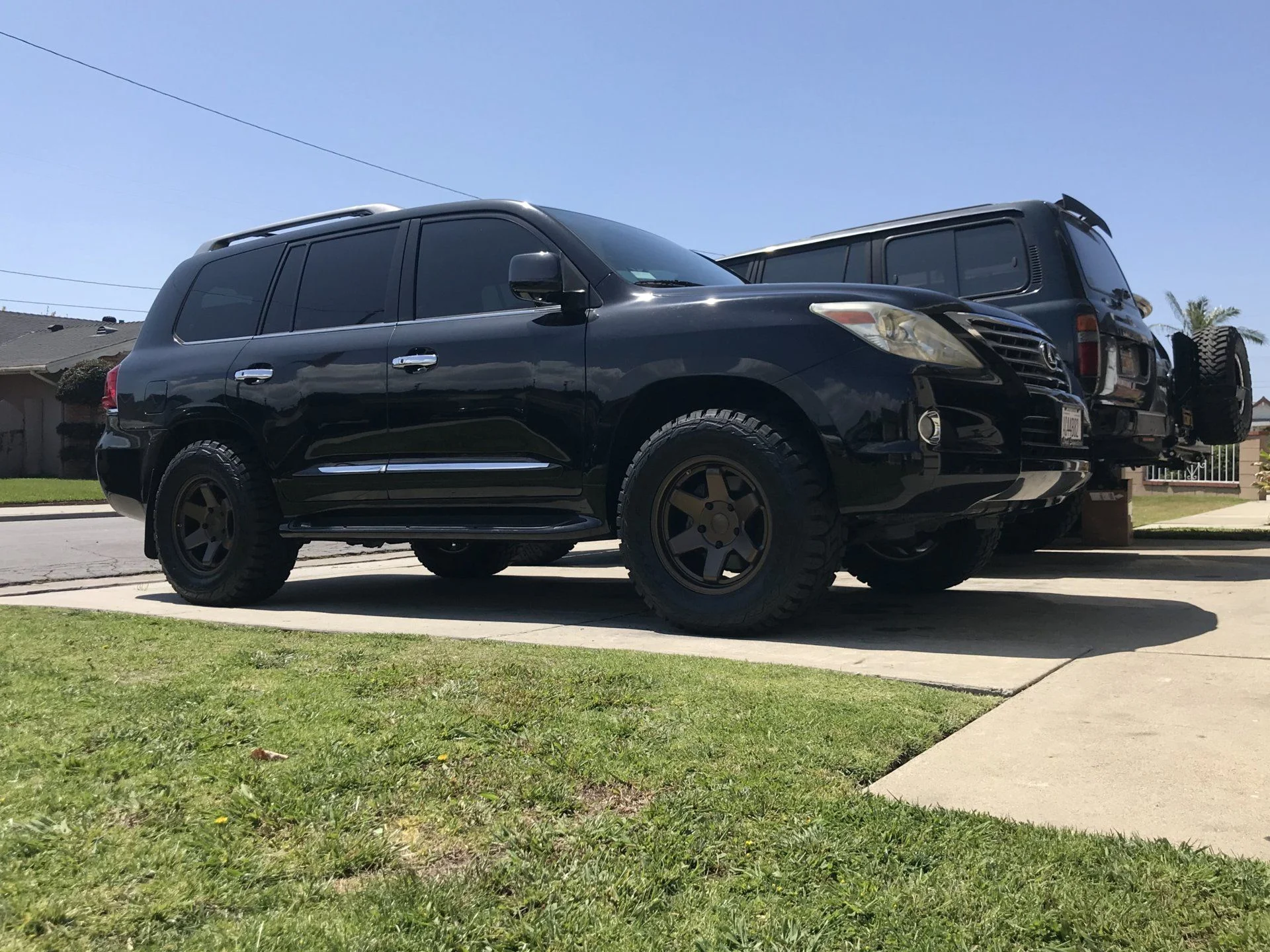

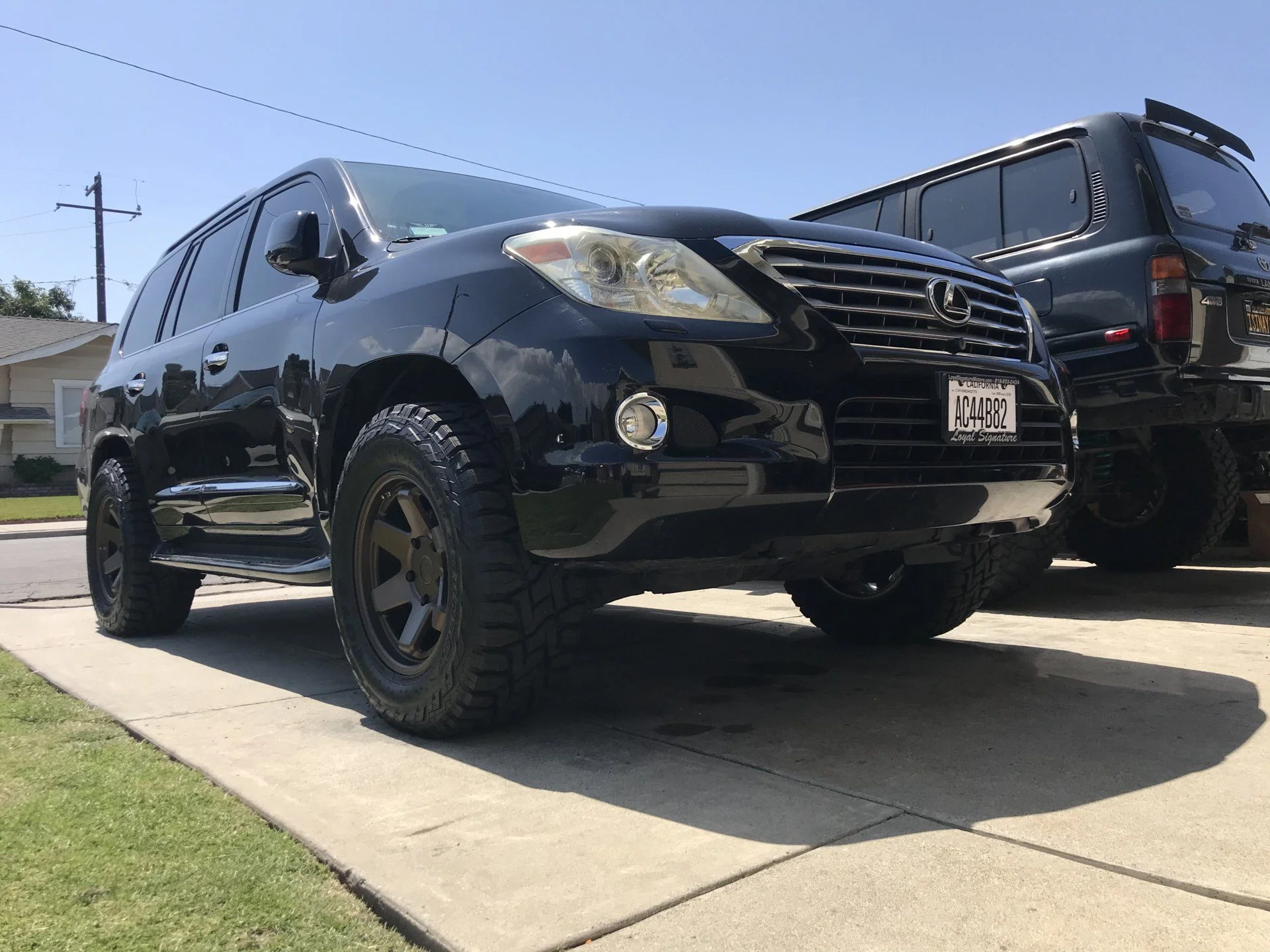

I just realized i never posted here with the results; been almost a year since then and i couldnt be any happier with the end results. Refer to the dirty rig below for 33"x12.5" Yokohama Geolander M/T tyres wrapped around stealth custom series 18x9 6.0 +25mm wheels:
I'd be thinkin the same tire/wheel pkg could be used on any GX or LX series ?
Aside from a few minor differences. The tire will fit no problem. and a few 17" rims will clear the rotors. But a +7 offset is low (high?) for the 200, which stock use a +60mm, and we have a 5x150 bolt pattern instead of 6x139.7 or whatever the 4runner wheels are.
Oh my badd......yes......6x139.7........+7 offset was purfect on our GX 460

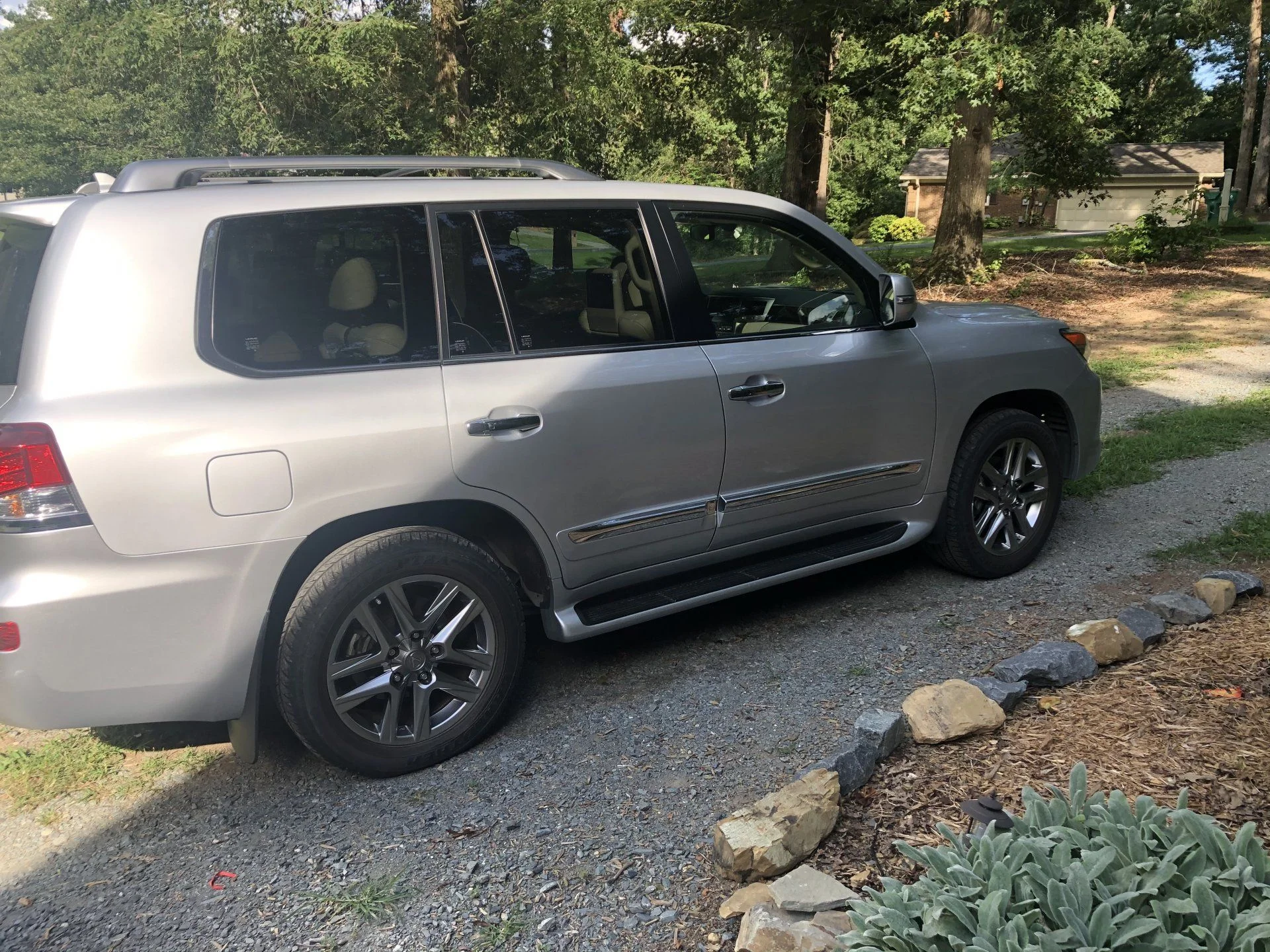

Posting this a few places. Stock to 285/65/18 with 16+ cruiser 18’s
