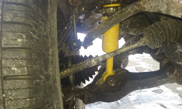

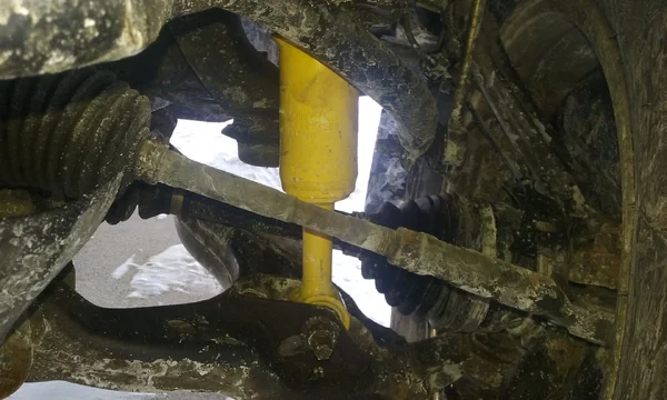

Has anyone had a problem with a vibrating humming noise coming from the front. I can actually feel it through the gas pedal. Thanks
