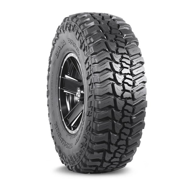

Also a good option the new Mickey Thompson Baja Boss AT, which is pretty RT like. Has a 285/65r20 (33.6). Definitely a more sane fitment. 1” spacers for this one.

Well, Those Baja Boss are some damn good looking tires. So it seems it has come back to this after all, the drawing board. I'm going to need the force for this one.

the 12.50 width is almost certainly going to require a body mount chop (BMC). That's why I suggested the 11.5/295 width. I think you'll also like lower load ratings, which is why the 35x11.5r20 (124 load) and 285/65r20 (120 load).
Also be careful - Baja Boss has an AT and MT, they are NOT the same tire.
