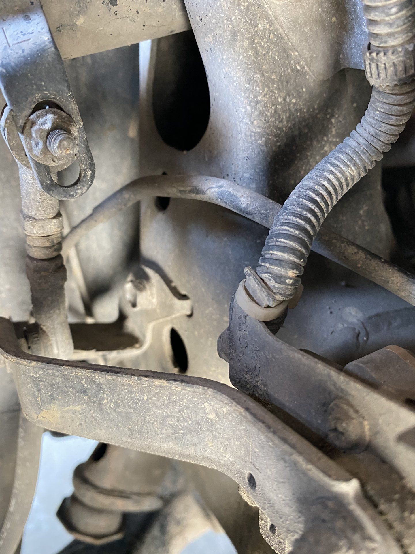

I first marked the fluid level on the reservoir. Truck was cold.
Unbolted the top link and confirmed the sensor arms were moving freely.
Reinstalled the links on the bottom of the slot (they were already very close to the bottom).
Extended the links about 1/4” on each side.
Took it for a short 5-10 minute drive. Still rides like crap.
Popped the hood, fluid level went up slightly, 1 notch or so.
Measured the front end height, it’s now about 22 1/2”, about 5/8” higher than it was before.
How can the fluid level go up and the truck raises?? How can I extend the links and the truck raises? This makes no sense.
I want to give AHC a chance but we are not off on the right foot so far :bang:
Going to try to read the sensor resistance next.

For adjusting height, you have to shorten extend the link for lowering the height. (at the rear you move the link down in the slot to lower it).
There is a new post with good pics of sensors and links in the huge ahc-thread, here.

For adjusting height, you have to shorten the link for lowering the height.
Are you certain about that? My friend sent me pics of the links on his lifted 2002 LX with 34’s and they are very short.
