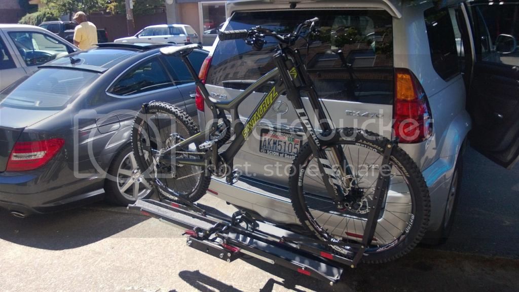

3)Bike rack capacity for min. of 6 bikes

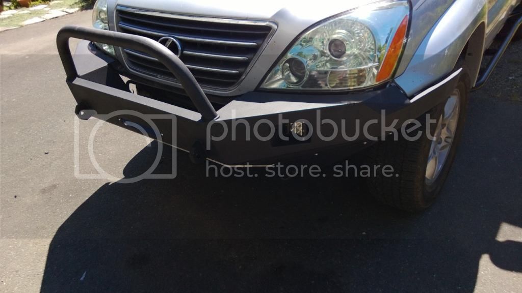

5) winch (ironman 4x4 hooked me up) - really insurance for when i get stuck or a tree is across the forest road which happens alot actually - need a bumper for that - Southern Style Speed hooked me up

oh and as for that bike rack thing i use a one up rack and for whistler i have a 6 bike northshore rack.

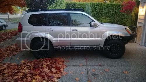

Side shot of my 2003 with the same tires no lift but jacked up airbags in the back:
side shot of my 2006 after radflo and new tires:

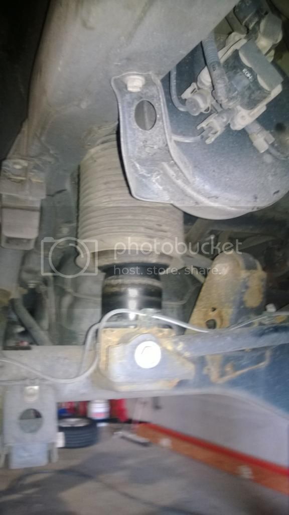

The biggest upgrade and the coolest one i think is the suspension. I wanted something not too high and not to low. I also wanted to adjust them and a great ride. i settled on a full Radflo system front and back which of course means a conversion from the airbags. Converting the airbags to springs has been discussed and done on here but i really didnt want to fuss with it so i called up the great people down at MetalTech 4x4 to help out. LT worked with me to get a simple bolt on spring perch and all the parts to convert the truck. I drove down early on a friday and LT spent the day putting new coil overs and TC control arms in the front and some really cool rear metaltech links and radflo springs with their new bolt on spring perches in the back. The ride is fantastic. we did leave off the sway bar although given how much on road driving and speed i do i think i need to try putting it back on for body roll...no idea if it will make a difference but ill give it a shot. the unknown was the computer...to handle that we pulled the relay and the fuses in the fuse box. the lights for the ride height stayed on so we tried the rear RH ecu...that didn't do anything, we unplugged the front suspension ECU under the driver side and all lights turned off. so i plugged in the rear one again and all lights stayed off. Im going to try a few more things with this just to see what combo keeps lights off. I have no idea just how much lift i got out of this but its not huge. im going to try and find a stock GX to park next to and measure...the ride and the capability has gone way up though.

I am getting ready to lift my GX and would like to learn from your experience. I am considering Old Man Emu? Do you have any pictures of the bolt on coil spring mount that Metal Tech made for you?

The radflo shocks coil overs and springs are a step up from the oldman emu and the ironman stuff. all good but as im told a different thing. I wanted adjustable shocks but spaced on it and forgot to ask for those. if i was doing it again i would get the adjustable ones...oh well less money. I don't have a pic of the bolt on part but if you contact them i bet they can work something out with you. they are trying to make it a stock part.
sure thing! Oh just got clarity on the radflo deal from metaltech and LT - great place and people BTW - the big step up is progressive valving on the coilovers. If i want adjustability the right way to do it is a secondary shock with the controls. that requires a hoop and some other stuff. overkill for me and what ill do with my truck - well at least this year. we will see next year as i bomb through forest roads. toys to buy and always options for more.
