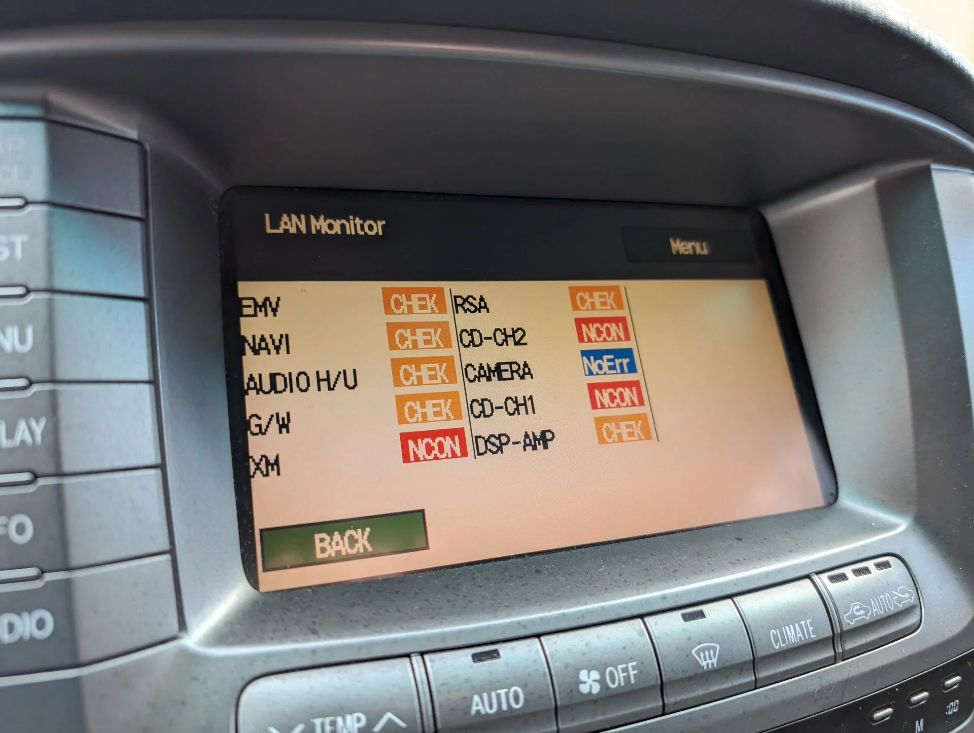

Hi all, I have a 2004 LX470 mark levinson sound system with navigation. A few months ago I began to have an intermittent issue where the volume knob would not change the volume and adjusting the temperature would not give the "Beep" sound. Next, intermittently the bluetooth device I have installed (BT45-TOY) would not be recognized by the head-unit. Then intermittently the temperature control would not display or function. If I cycle the power to the head-unit by turning the ignition on and off some of these may regain function. If I drive for a while some of these may regain function if not working when I start the truck.

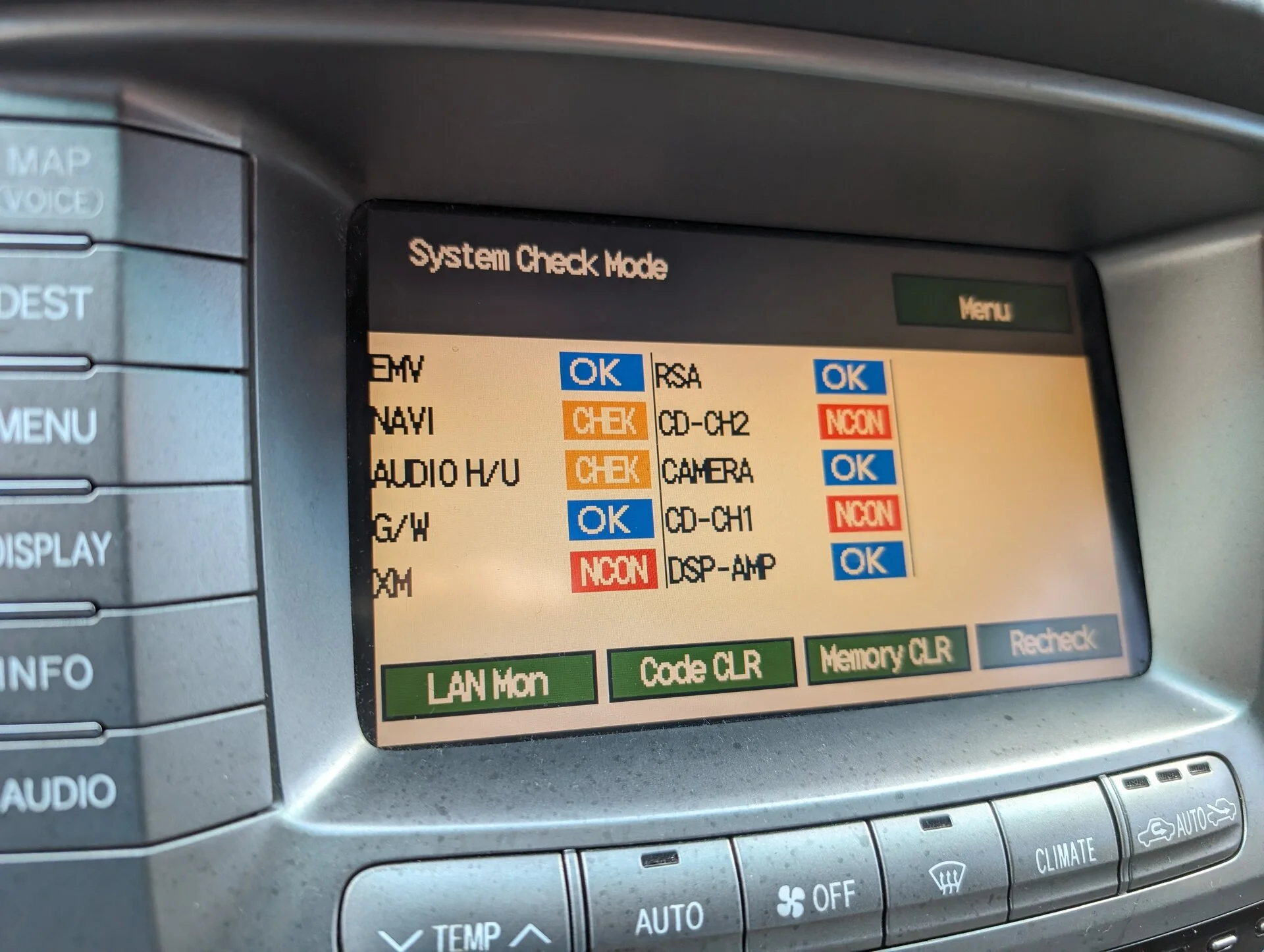

I can't find great diagnostics on how to find the causes of these issues. I don't even know if it's one issue or several. I'm resigned to the fact I'll likely be spending some serious money but I'd like to make a diagnosis to ensure I'm replacing only what needs to be replaced and not just unloading a very expensive parts cannon. I've attached a photo from the head-unit diagnostic screen at a single point in time (again things were intermittently not working here). I've seen similar issues but not these exact symptoms where people replaced the head-unit, the cassette unit, or the amp under the passenger seat (each around $700).
Has anyone had these exact symptoms or does anyone have a manual I can follow for these diagnostics? I have the FSM but don't see anything for this.
CD unit is replaced so NCON is expected.
Thanks for your time and any help.

I have the EXACT same issue. Same year make and model. Has anyone been able to solve this?

I appreciate your input on the gateway module being the culprit in your given situation, however, I am having the same problem as OP. My climate control works fine, and my problem is intermittent.
