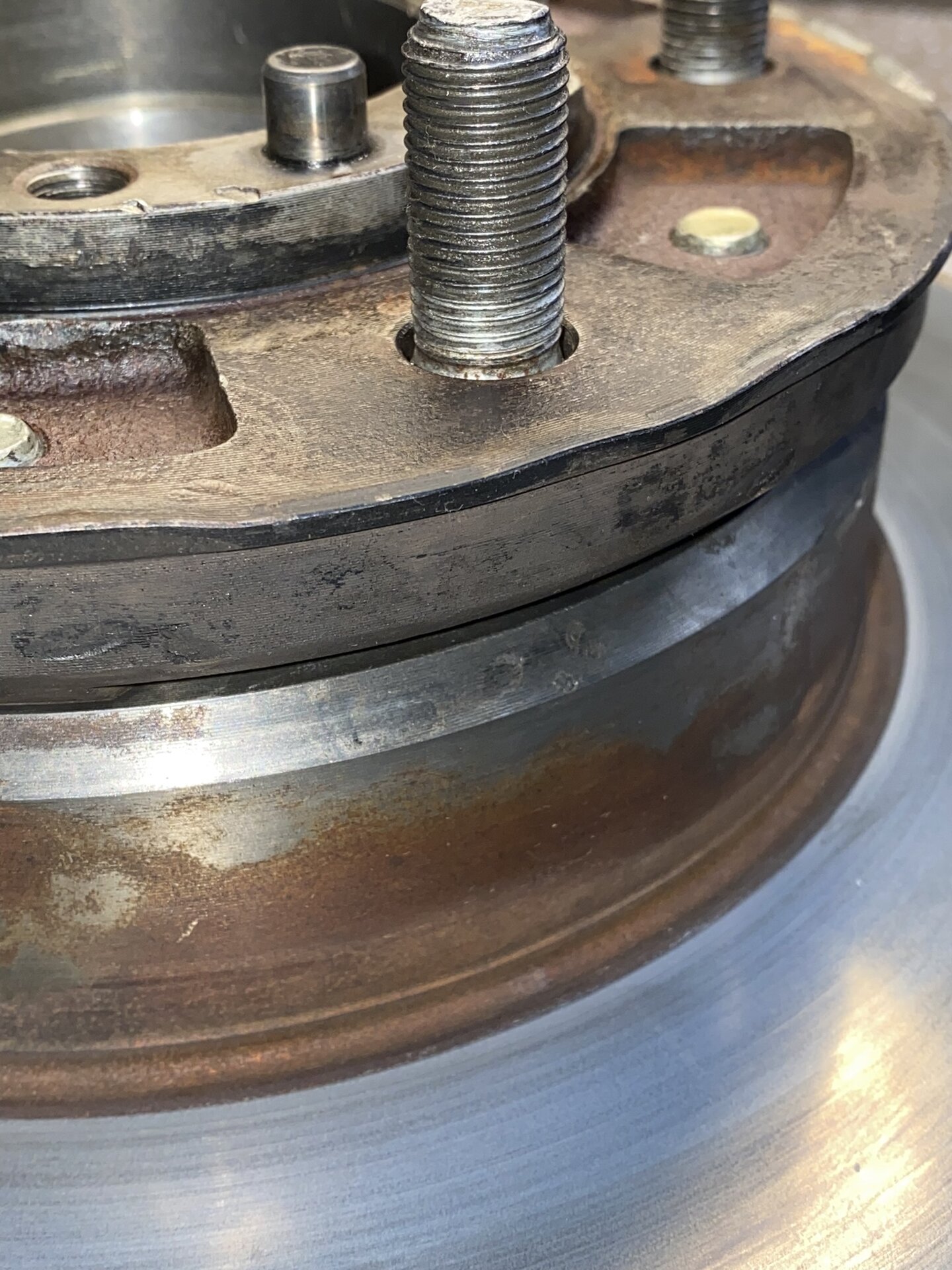

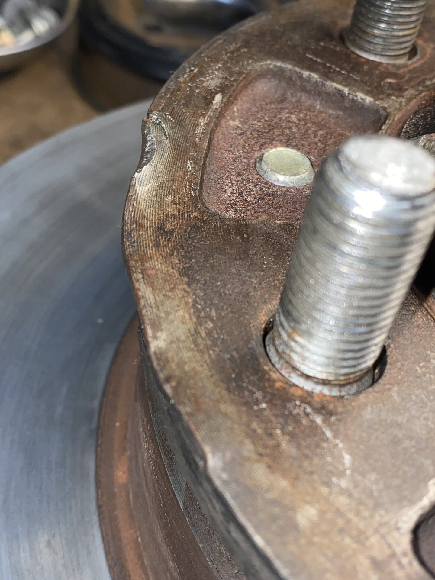

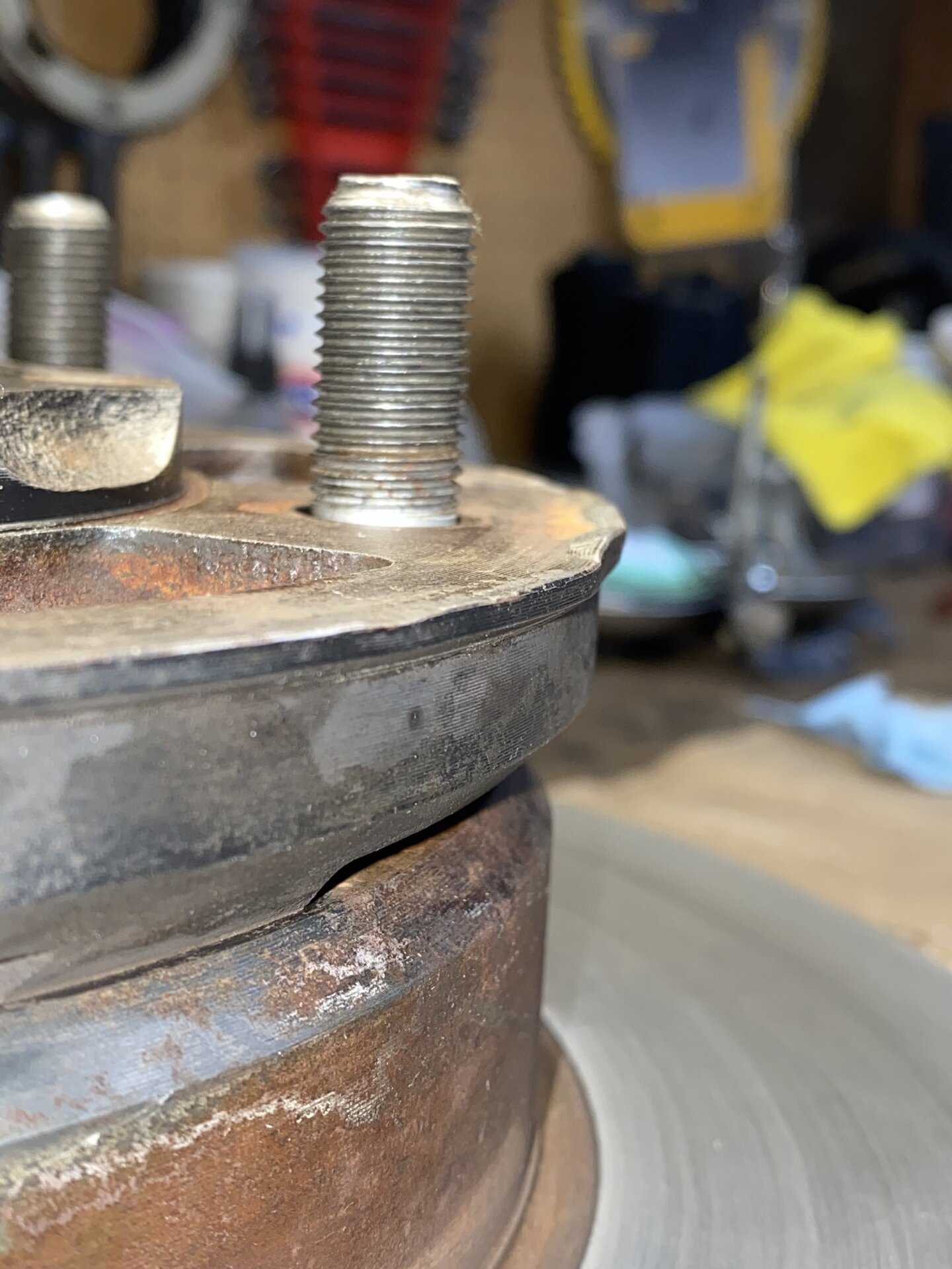

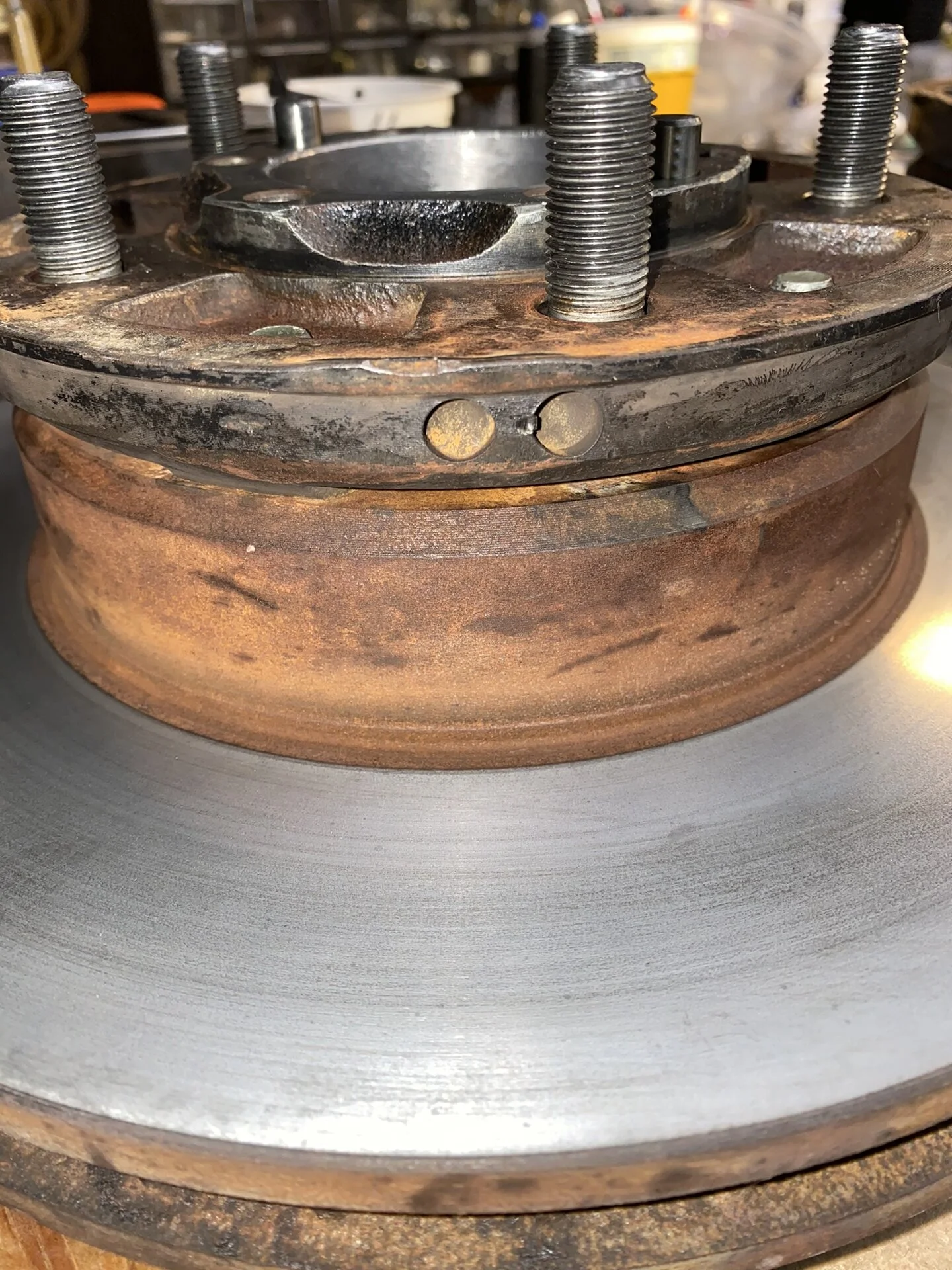

It's most likely Dealership Tech did not properly pack the wheel bearings. Unfortunately it's near impossibly to find a shop, that does the job by the book (FSM) (Factory service manual). Either they known how, and take to many short cuts to complete service in less than book time (flat rate) and or make mistakes. Or they've no clue and don't open the FSM. The worst is usual when a Brake shop replaces front rotors. Those techs, really make a mess of our front wheel hub.
Here a video less than 2K miles after a Wheel and FDS service. From a shop that claims in their name, to be a Toyota & Lexus specialty shop. We've found them to not only to do terrible service work, damaging 100 series. But crooks as well. In that if you take back for do over of a bad service work done. They'll says it's something else not their fault, and charge big $$ to correct.
Here's same bad wheel bearing service from above, as O open it up.
Here's the same wheel bearing service, where it get's interesting
Here a wheel hub where they pounded off the rotor improperly. I see this all the time. I can usually pound and flat file to get the run-out corrected. But this one, was not restorable. Even the wheel had indentation from the hub. It was a case where when wheel torqued on, a gap remained between wheel hub and wheel. As it was driven, soft metal of wheel, impressed onto hub. Resulting in loose wheels lugs. This vehicle, would never balance or align well with this wheel hub. You can't check wheel hub run-out either, with these beat on hubs.
