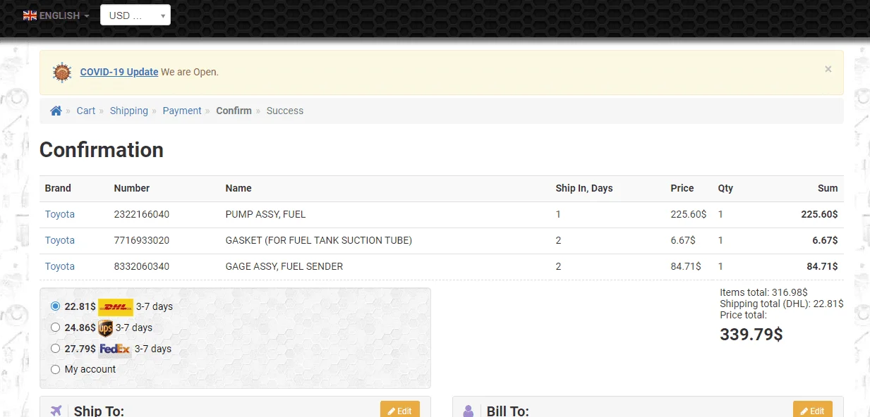

04 LC with funky fuel gauge level. Behavior is its showing low or zero after startup and slowly coming up to some where close to accurate or lower. Question is where to start replacing parts? 1. Fuel level sender with the pump as its the original as far as I can tell, or 2. stepper motor. I'm leaning towards to start with sender unit as I can replace the pump as a preventive care. Looking for experts opinions, thanks.
Mine had been doing the same for a year or so. Just replaced Fuel Sender and Pump. Seemed to fix the issue!
That's what I was thinking too. Where did you buy the sender unit and pump?
Best price I could find was Toyota Parts | Toyota Online Parts | Genuine Toyota Parts | Toyota Parts Online
All in with sender, pump and gasket was $500ish...
Thanks, looks like faster and cheaper to get from half-away across the planet
