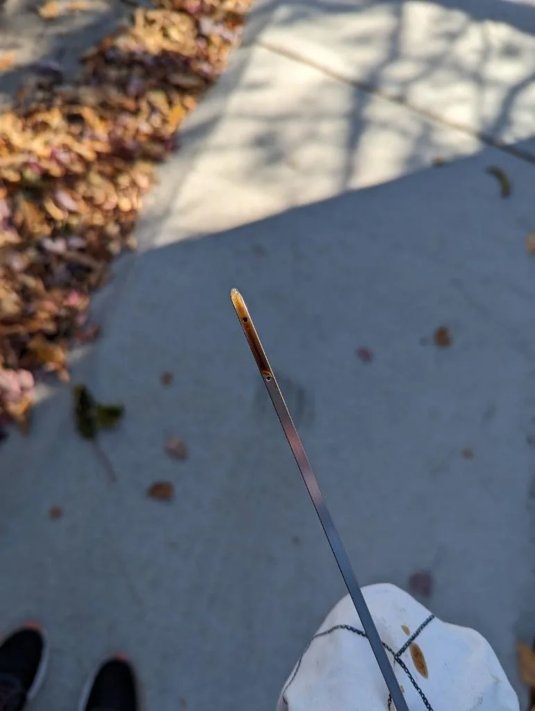

I know it's probably impossible to give an answer without a tear down of the engine. The car has 260,000 miles, but was running perfectly before it overheated. He said it still idles smooth but gets rough when you put in gear( drove it onto rollback ). Showing misfire codes for 2,4,6,8, no cat codes. Oil looks good. I'm trying to get him to find a place in Denver to fix it
