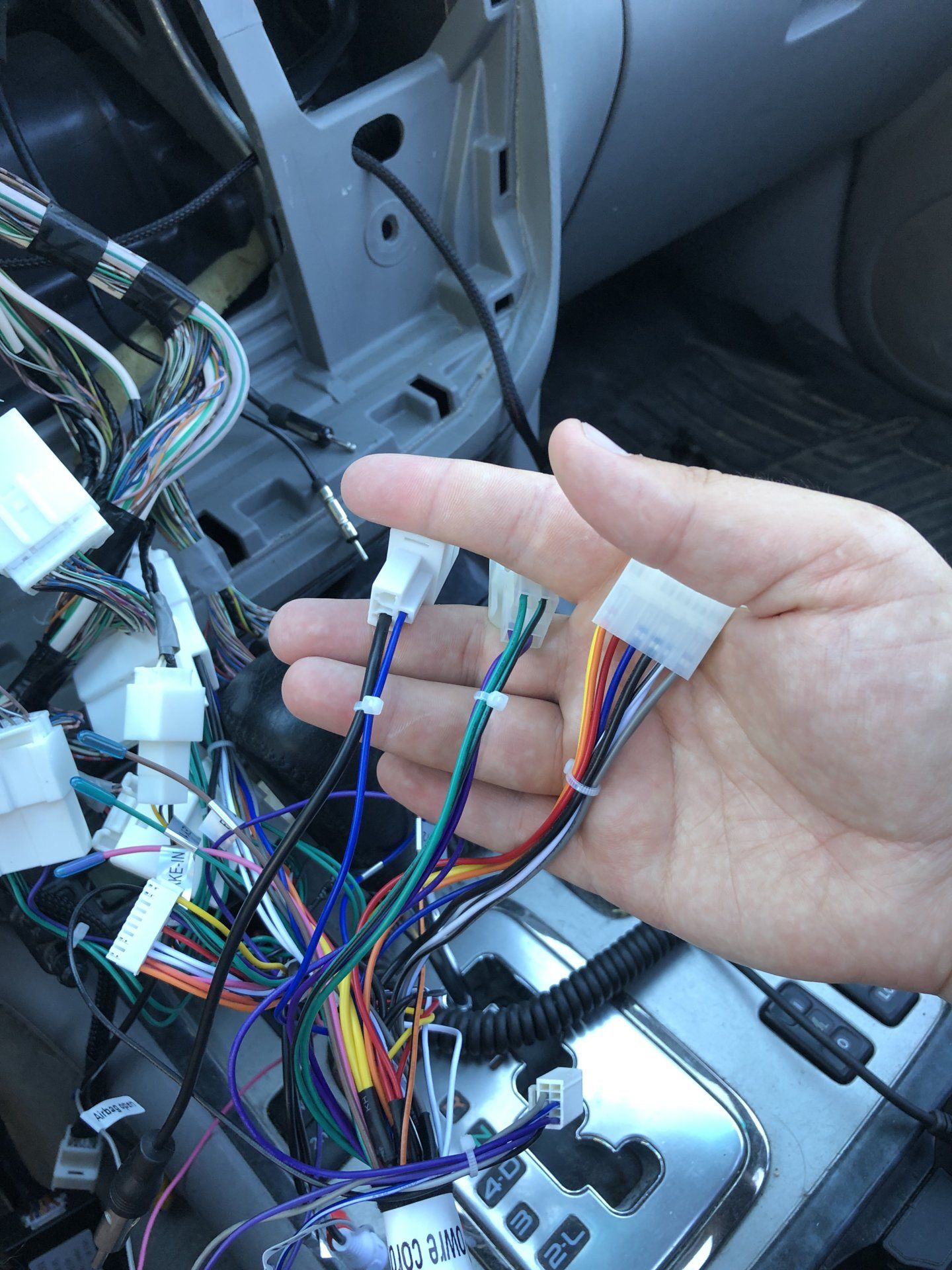

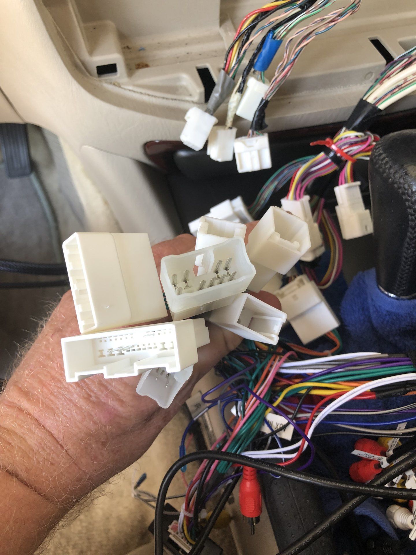

I can't figure out where these guys go. I suspect the largest one goes to the factory amp, but don't have a cable to reach it.
Have my dash apart . No climate control-no sound. unit turns on. CBeck- did you use the "low and medium A/C tieline"?

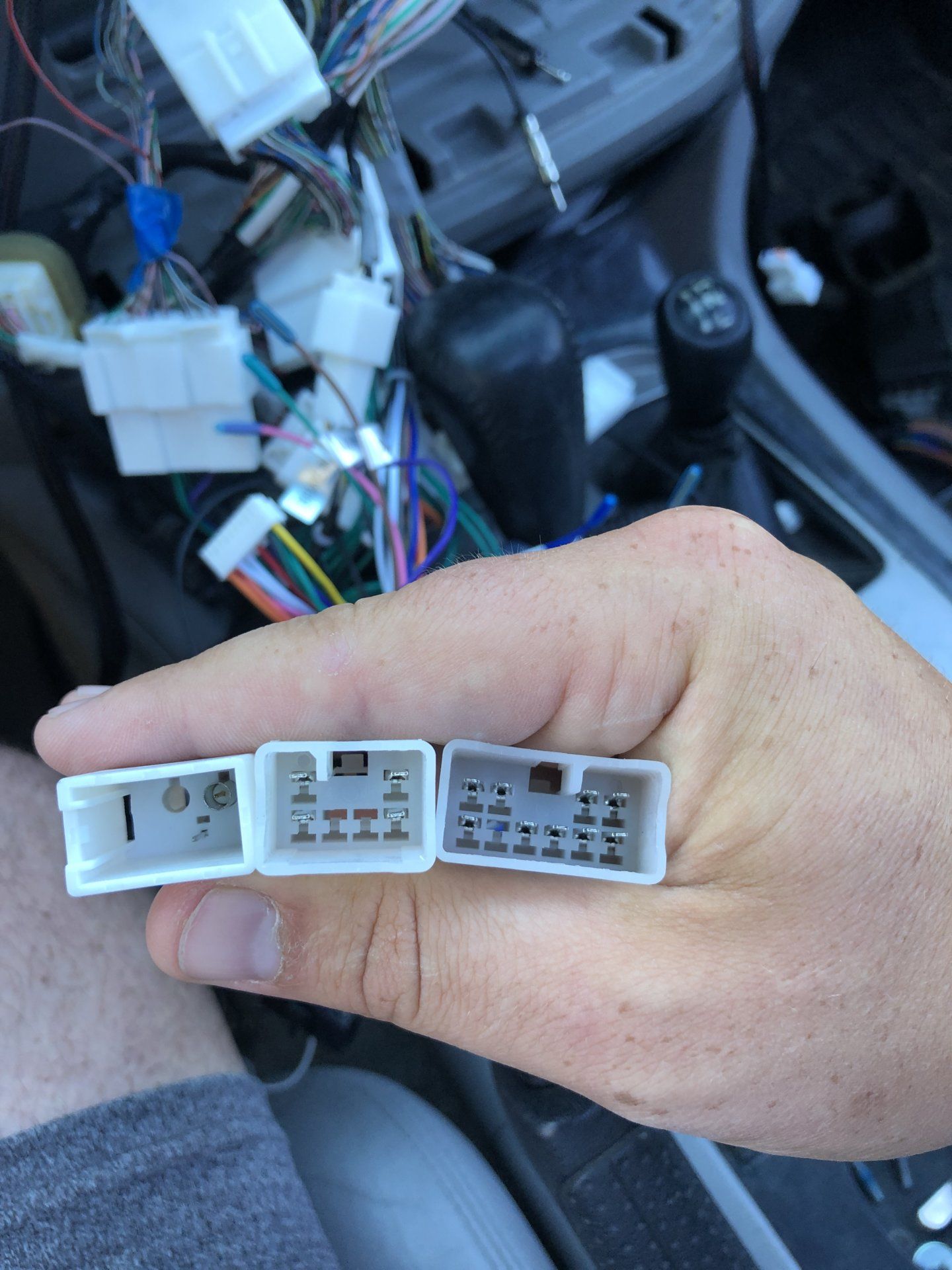

I have a few connectors on the new harness that I am not sure where they go, if they're even needed.
I am having no luck with the climate/or audio. . They said they sent the new harness, but now I have doubts they did:(
Seems like way to many unused connections..
The extra 3 plugs your looking at, I think they plug into the Airbag Indicator and Hazard/Center Diff Lock buttons on your AC Vents
Nah, those ones are already pulled through and not shown in the picture.
Is your truck a 2003? I have the same power cable ZF-1301S. I still have no climate control. Can you take a pic of your connections I cannot understand why I have so many unused connections from the power cable. They just won't align with the factory wiring

Spoke to the company I bought it from and their engineers in China, they’re building me a new harness and sending it out tomorrow. I get the feeling they expected this all to be plug and play. Keep you posted.

Well that hypothesis was incorrect. None fit into the amp.
On my original harness, I had LOTS of unused connectors (3-5). On the new harness, I didn't have any. Hopefully your new harness will get you squared away.
