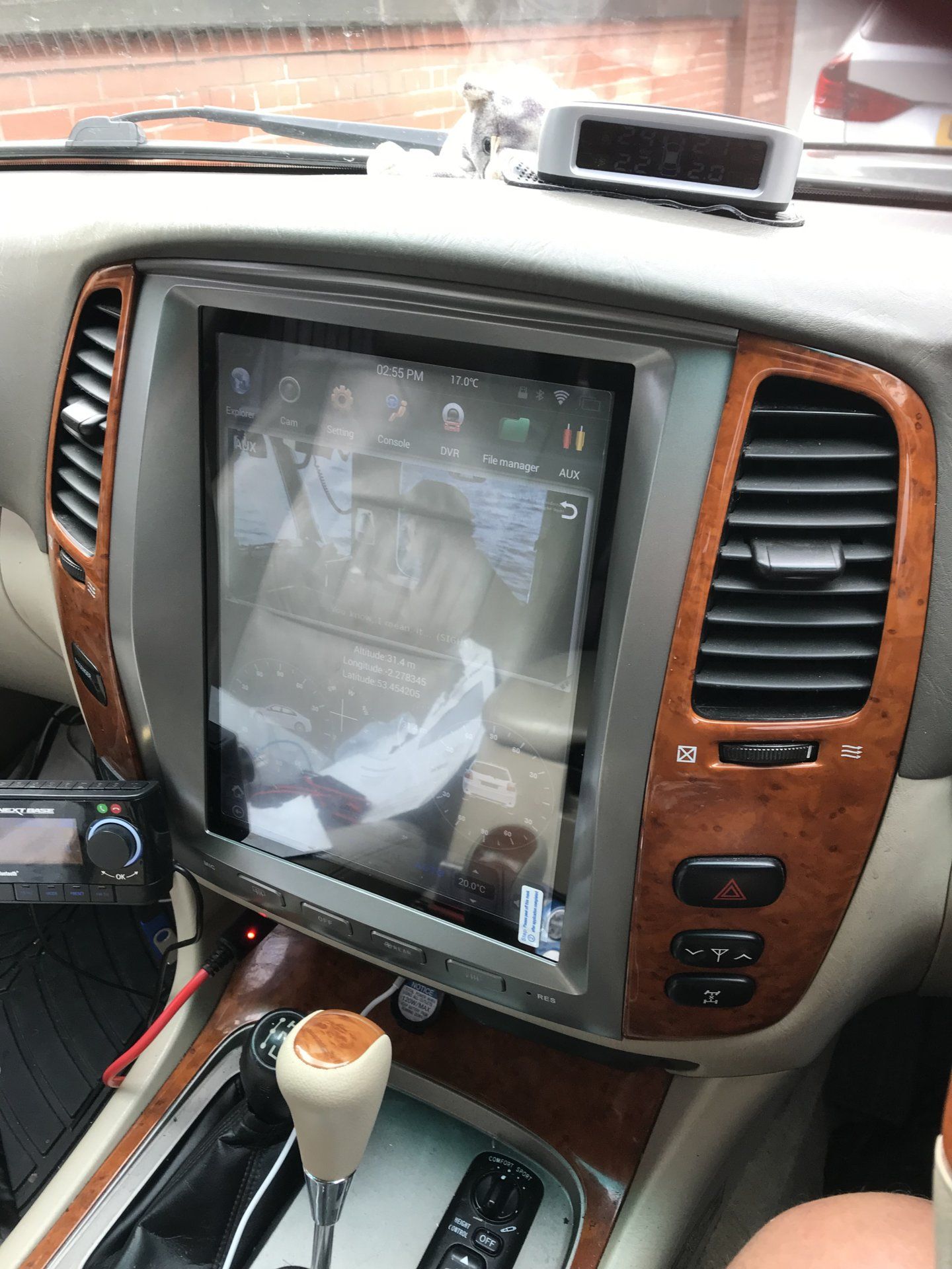

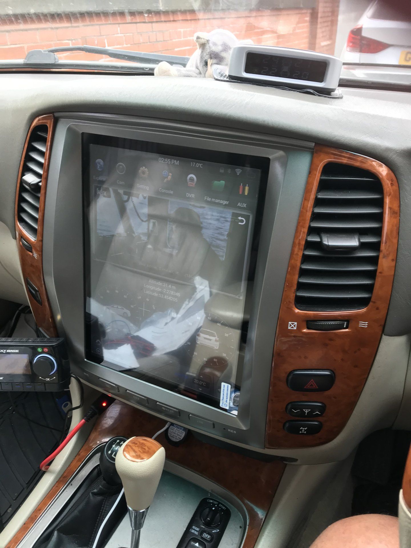

In uk we don’t have carplay , what is it. I’ve enclosed a photo of my unit
Carplay and Android Auto are Apple's and Google's attempts to make a handsfree interface for phones that integrates into head units. The thought is that you plug your phone into the unit and get navigation, music, text to voice, Siri/Assistant through the car without having to deal with the historically awful factory interfaces as the phone is serving it up instead.
