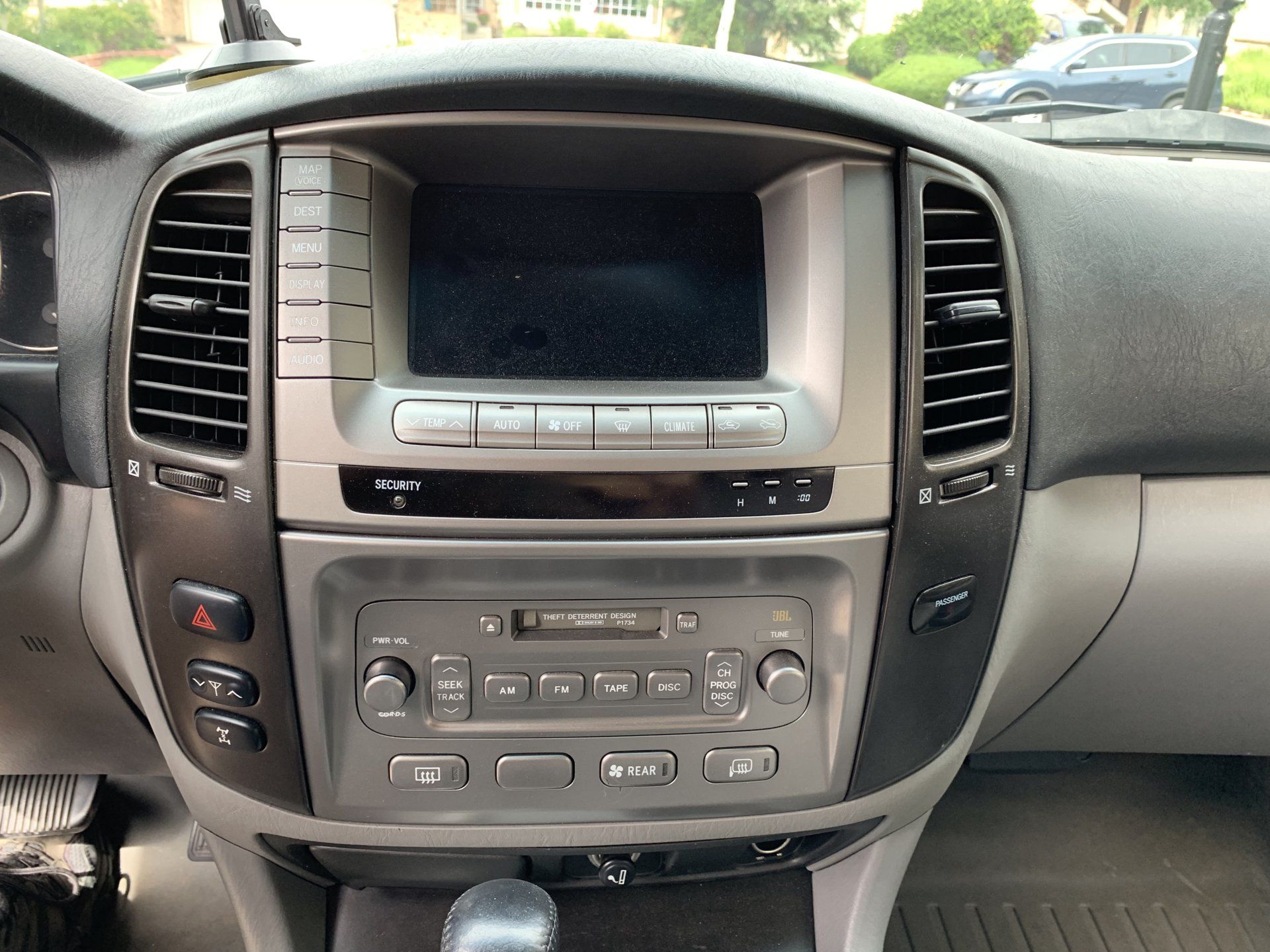

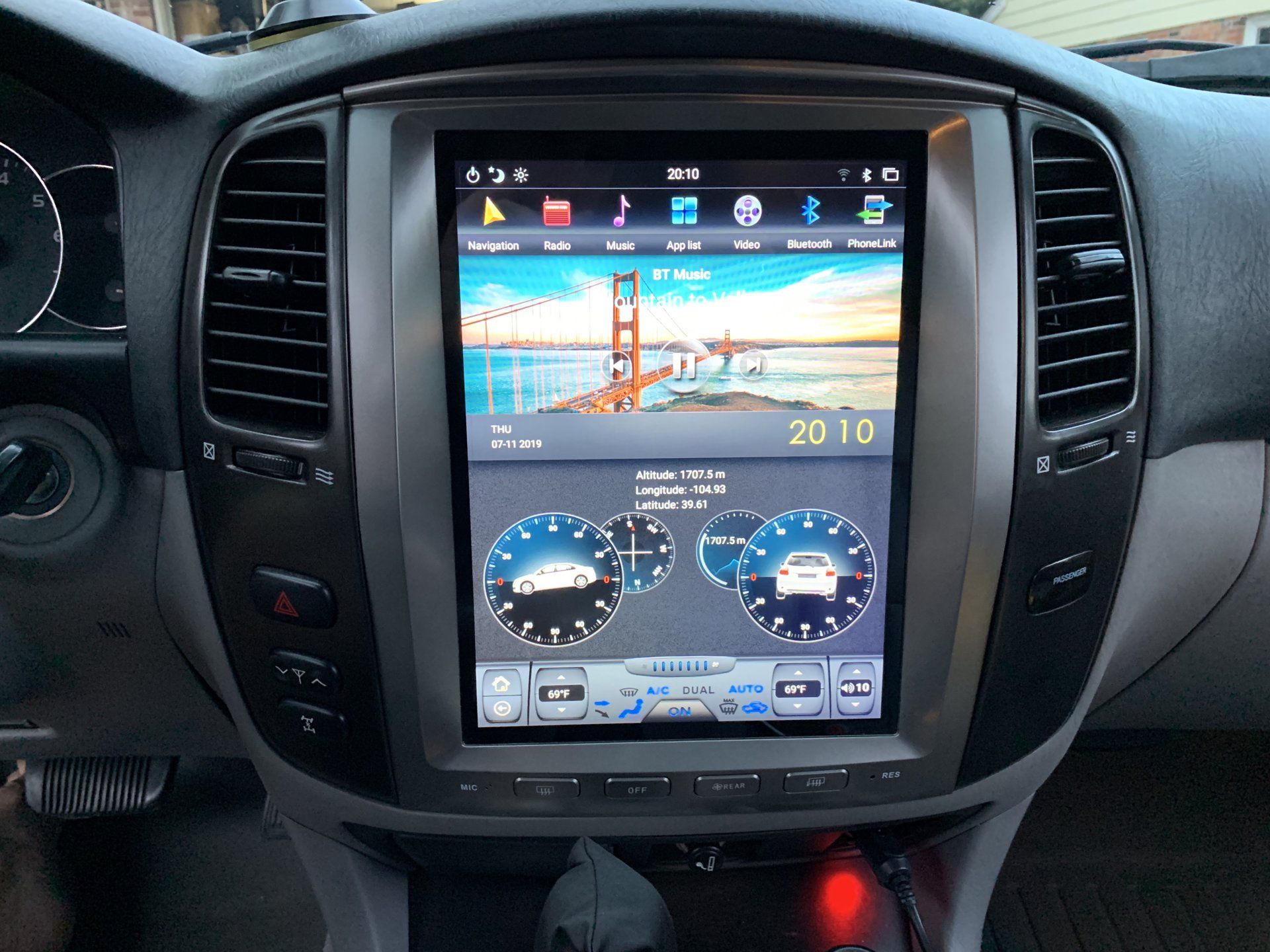

HERE. WE. GO!
BEFORE
AFTER

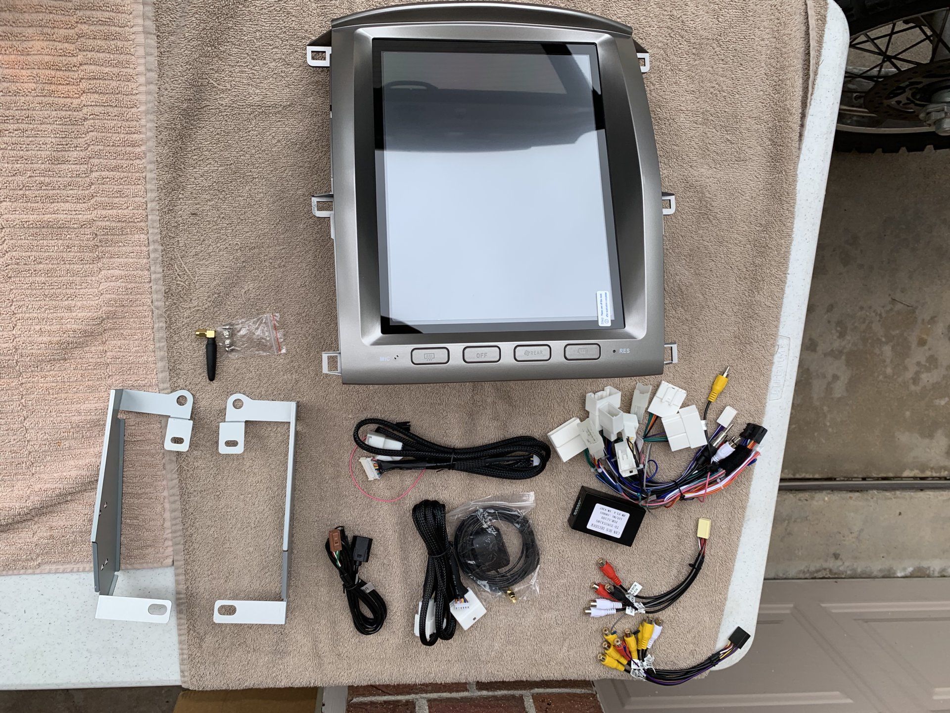

This is everything that came in the box. They sent two harnesses and all the CAN-BUS stuff that you'll need.

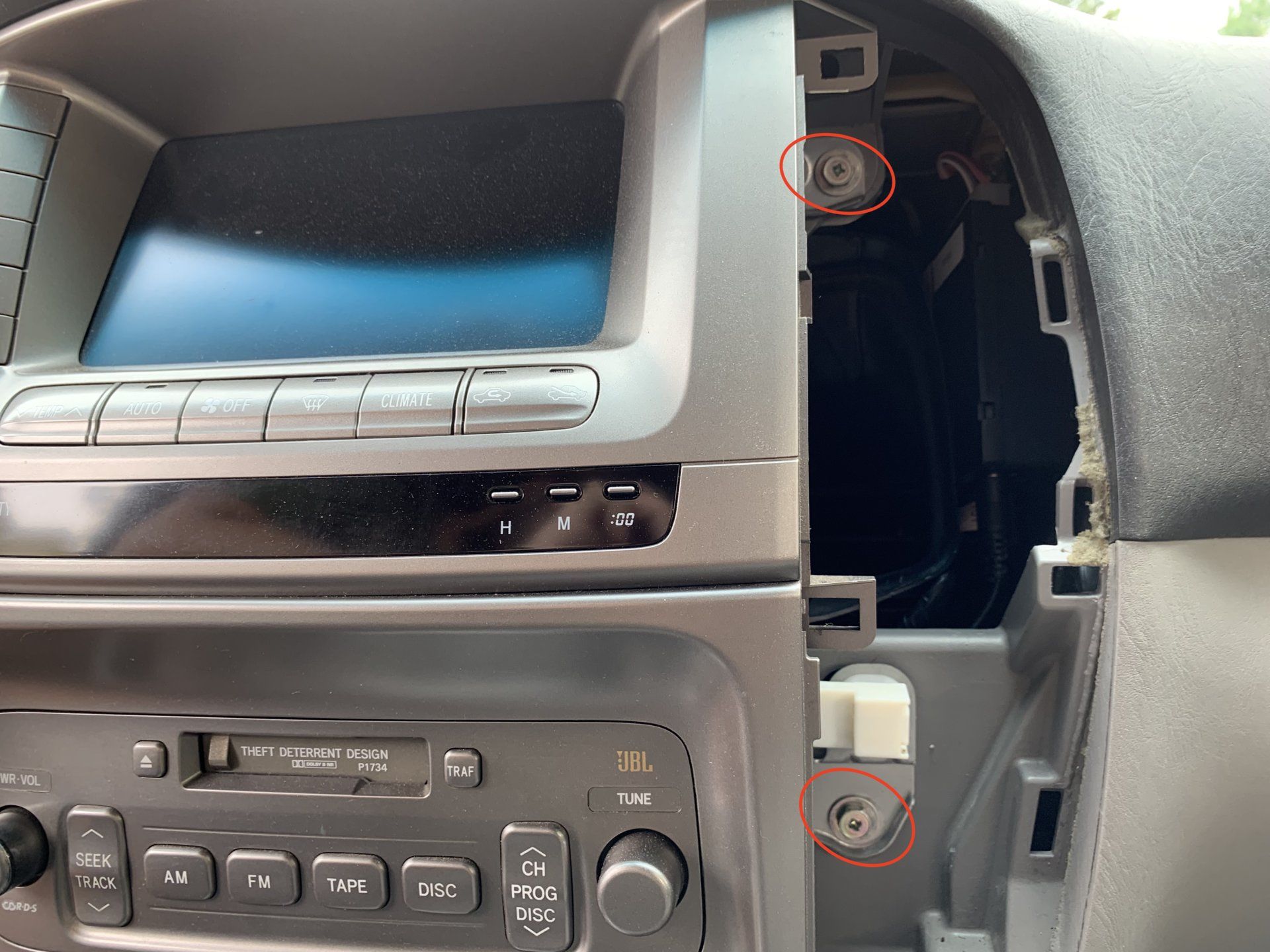

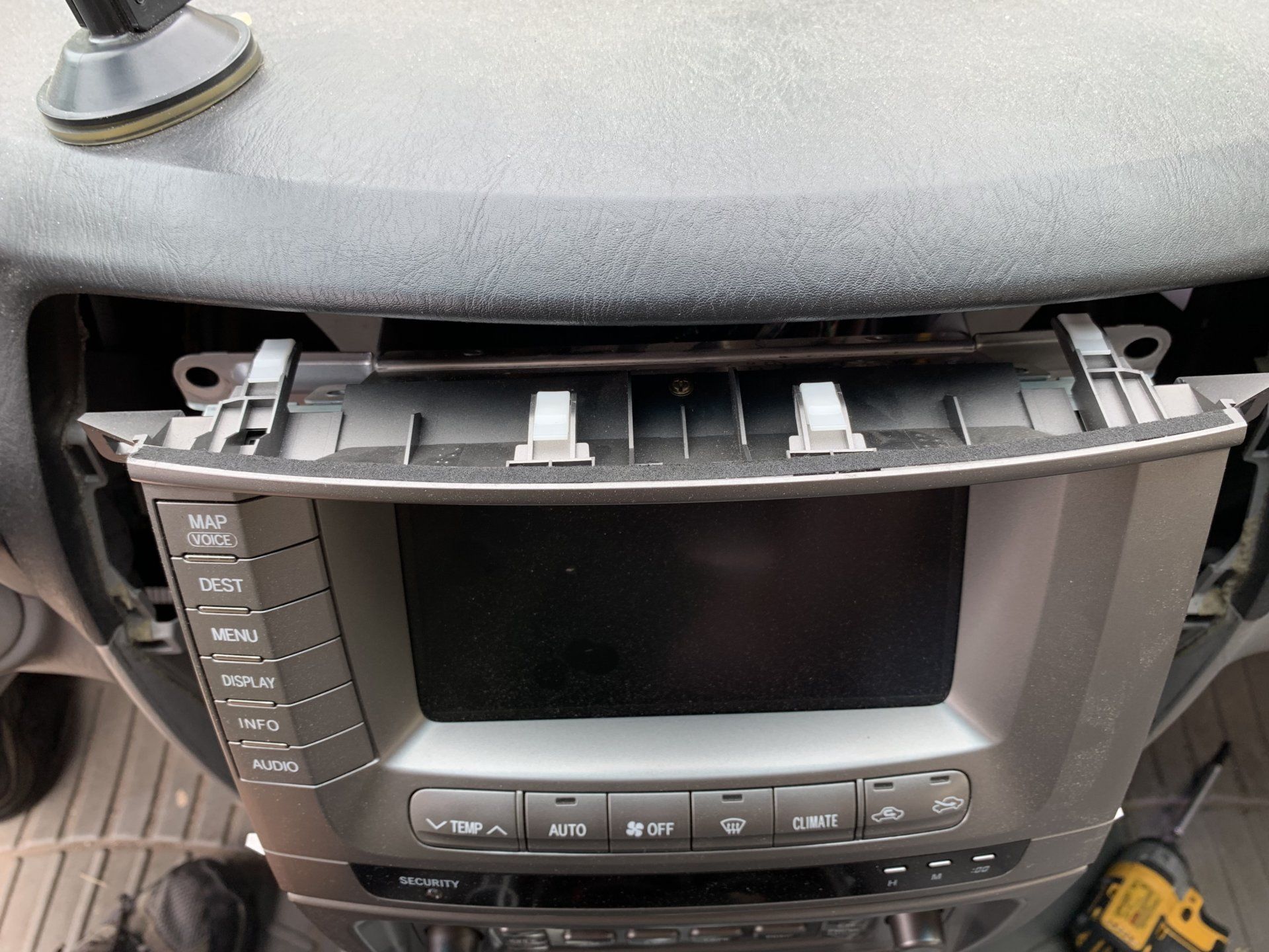

To remove the old headunit, use a nylon spudger or equivalent to remove the two side ducts/panels - no screws, just plastic snaps. Disconnect the connectors and put them out of the way. Remove the four screws that secure the entire center section and pull it out.
View attachment 2027413 View attachment 2027414

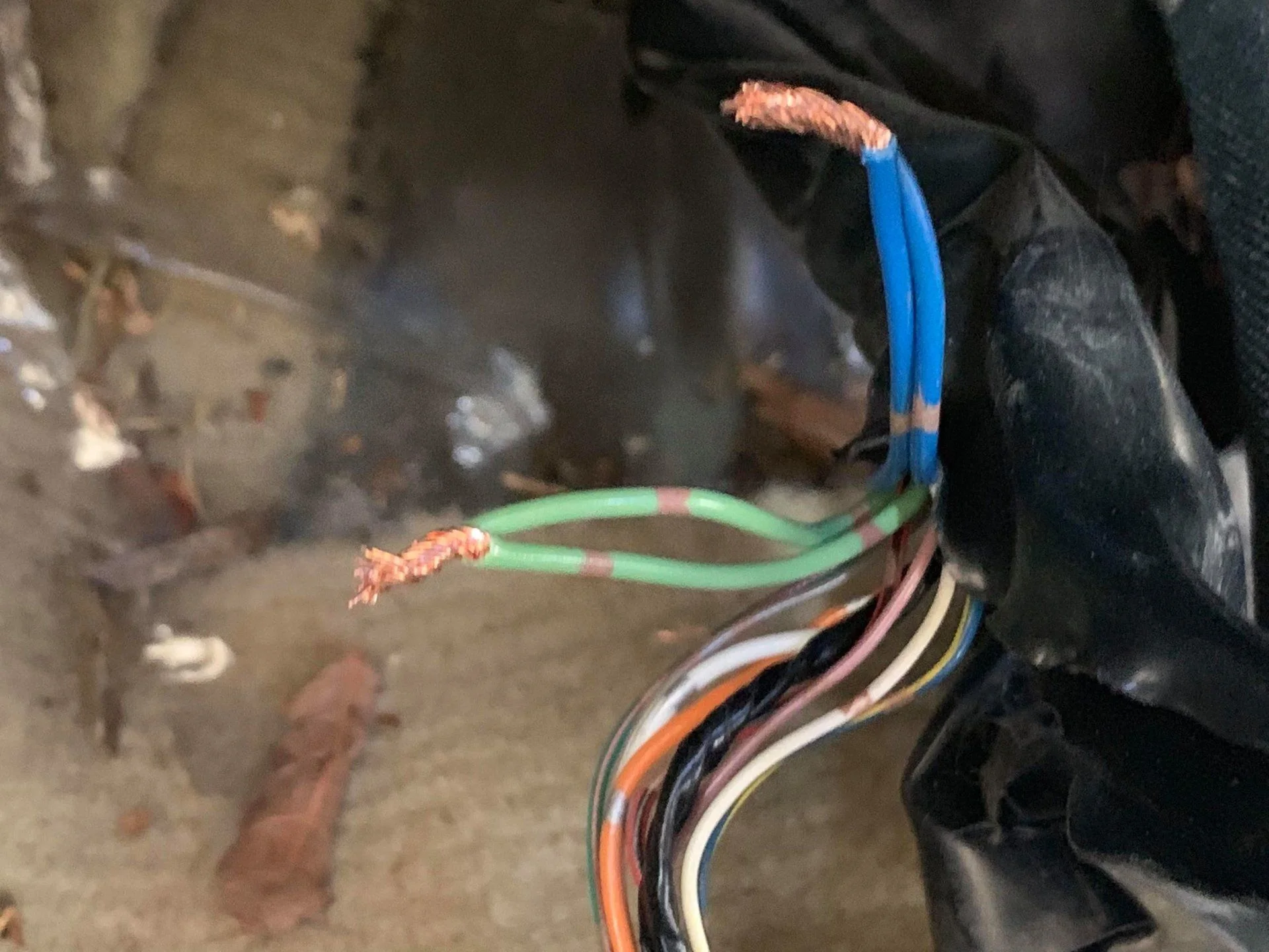

What wires did you cut on the navigation to get the front left speaker working?
Here's a photo from someone else that helped me with the install along the way. I forgot to take a picture of this part. However, my wires were a different color than these, but still in the same pins on my vehicle.

@mistered123: what is the purpose of splicing the two DVD/NAV wires together? I'm all for trying it, but would like to understand why I'm doing it before I dive in. My system sounds perfect for the first few minutes after turning it on -- could be one minute, could be 20, but eventually all speakers stop playing except for the left-front set. Is this the same symptom you were addressing when you spliced yours?
I actually just did it as part of the install due to a recommendation by someone else that had already installed several of the units. He said it needed to be done for the driver door speaker to work correctly. Not sure if that's true or not since I never tried the unit without splicing the wires.
