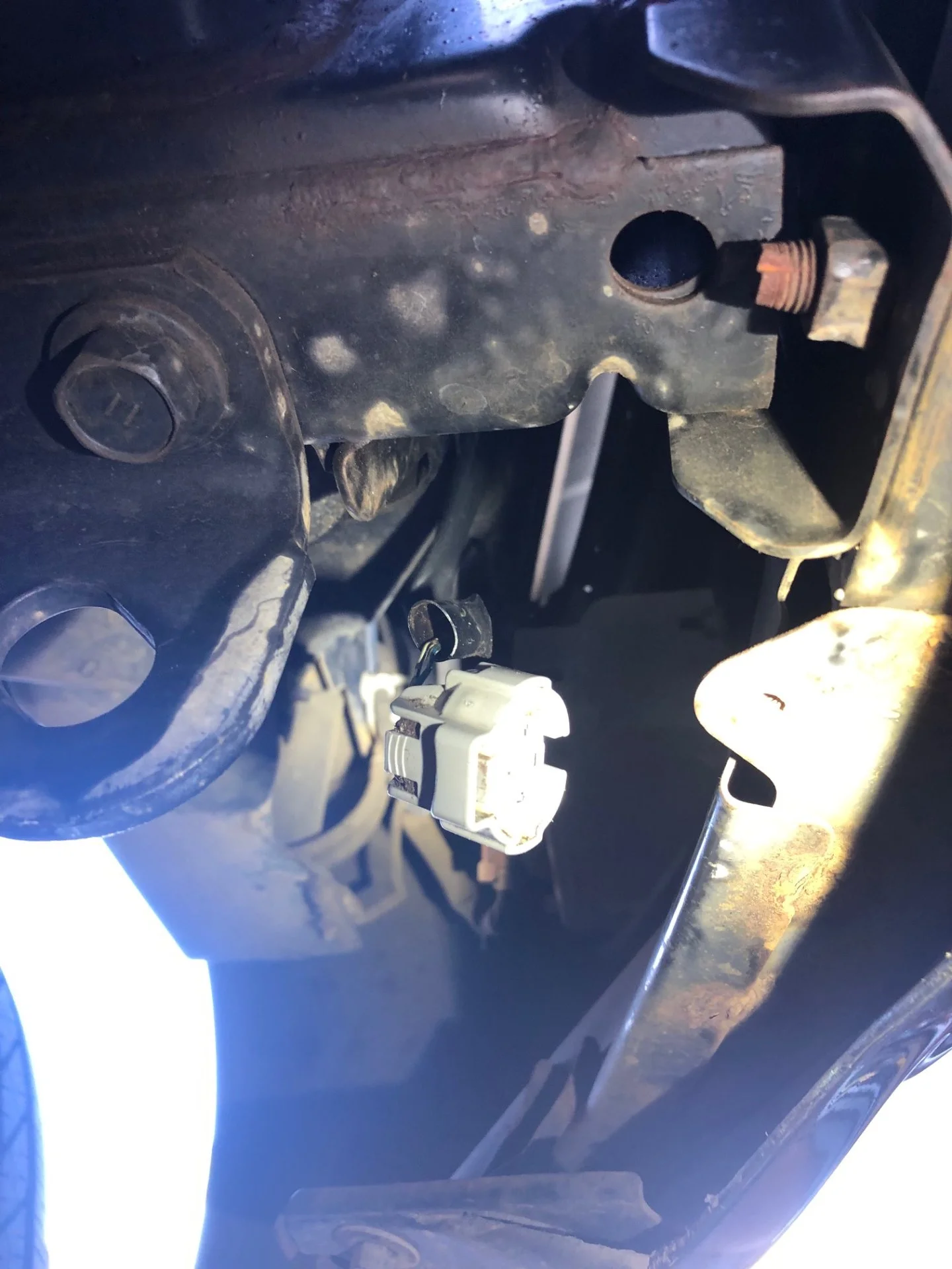

OK so i just went out took the skid plate off and was looking around for possible issues once again. The Crank sensor and wires all looked good... everything else was dry and seemingly no issues... then I found a sensor which appears to be an aux coolant sensor? its in front of the rad and inline with a coolant line. Looking closer the wires for the plug were exposed and there was water/coolant running straight down the line and collecting in the wire shielding! the senson and wires were soaked and seemingly the wires were sitting in some of the coolant or water collecting inside the shielding/wire cover.
I unplugged and cleaned both sides with some electric cleaner and fixed the wire cover issues. I assume it is possible this was causing my issue as any wire contacting water and or sitting in it cant be good haha... so fingers crossed we have a solution.

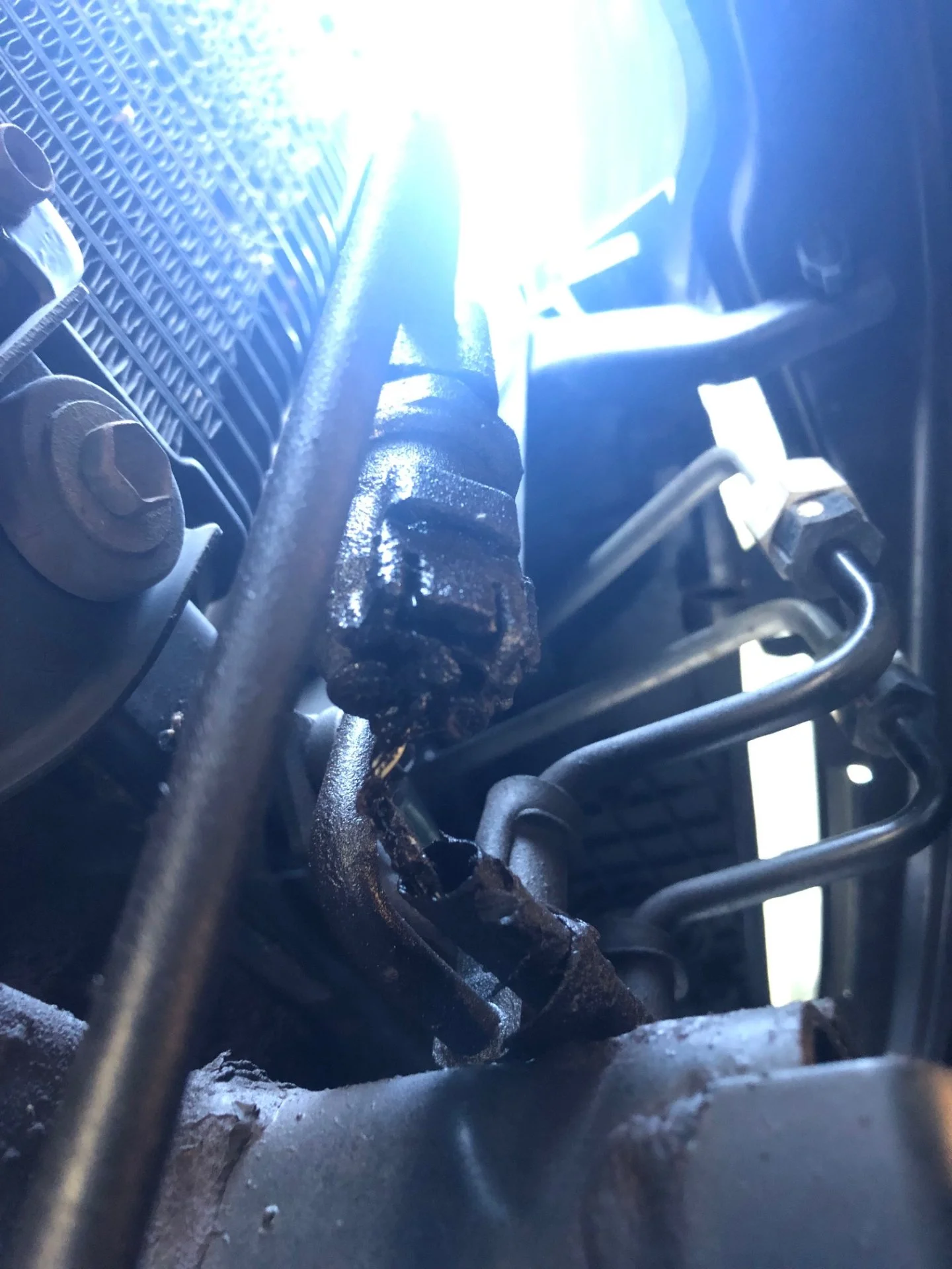

Here is the trouble maker
