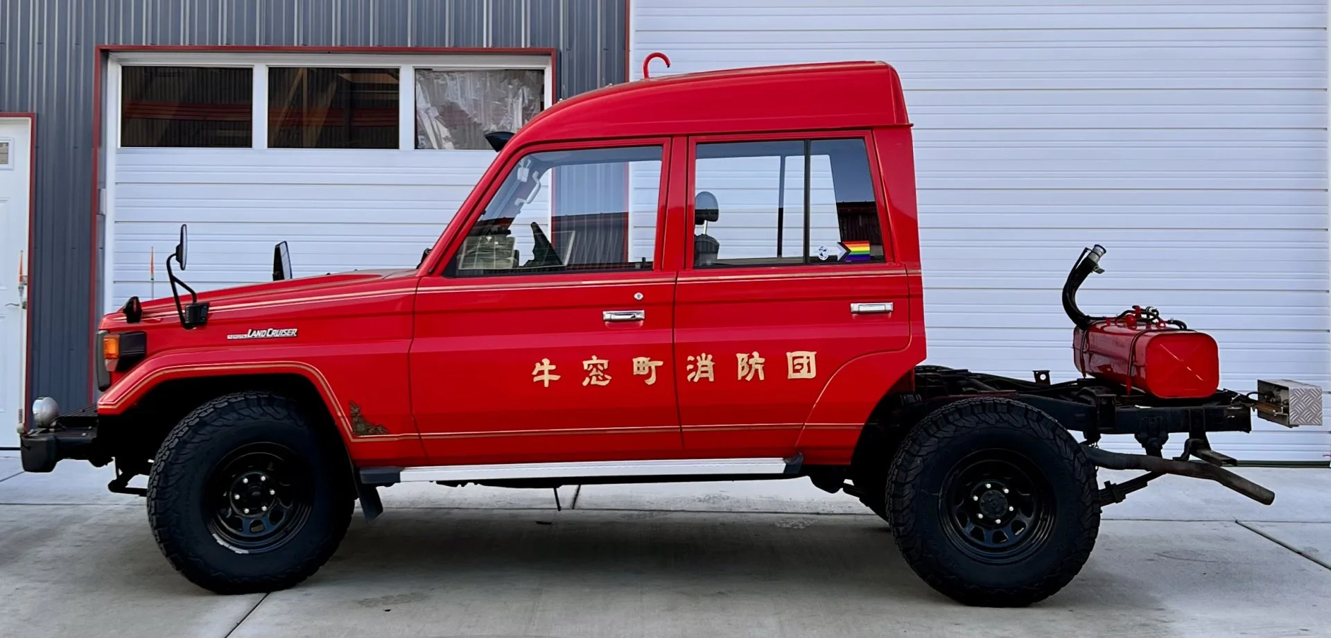

Been a little bit busy but thought I would post a few updates.
Finally got the rear pump station removed. What a pain the the A$$ that was but its done. The rear pump station was not only bolted onto the frame but it was tack welded in spots making it a bit of a challenge to remove. Persistence prevailed!
Significantly lighter now, better handling and dare I say sporty off the line 🤣 The 1HZ appreciates all the help it can get.
The rear spare tire carrier had to go and new mounts for the gas tank were fabricated. New tank and brackets dropped in like a glove and so far I am really happy with the turn out. Will need to go back and do some touch up jobs for rust prevention but all in all it was a productive and successful day.
To be legal I picked up some fenders from the local Princess Auto and through them on. Very little allowance was left but now with the 3" OME that was recently installed there is certainly no rubbing. All of this will come off in spring anyways when the tray gets installed.
The only hiccup I encountered was the fuel sender. The new tank was a two wire unit and the old a three wire. I tried several times but finally resorted to picking up a new sender. Hopefully will fix the issue and ill have my gas gauge back.
On the to-do list is to build a temporary frame for the back just to keep things covered and to add a little sandbag weight for traction.

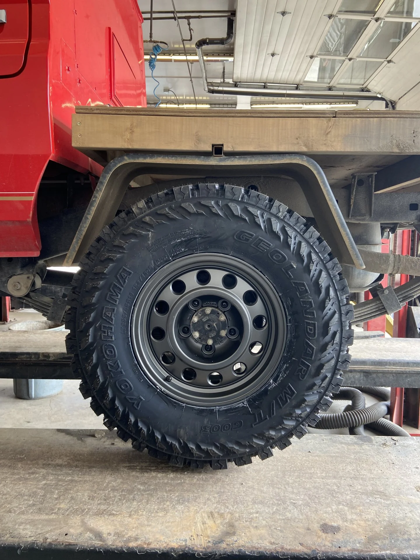

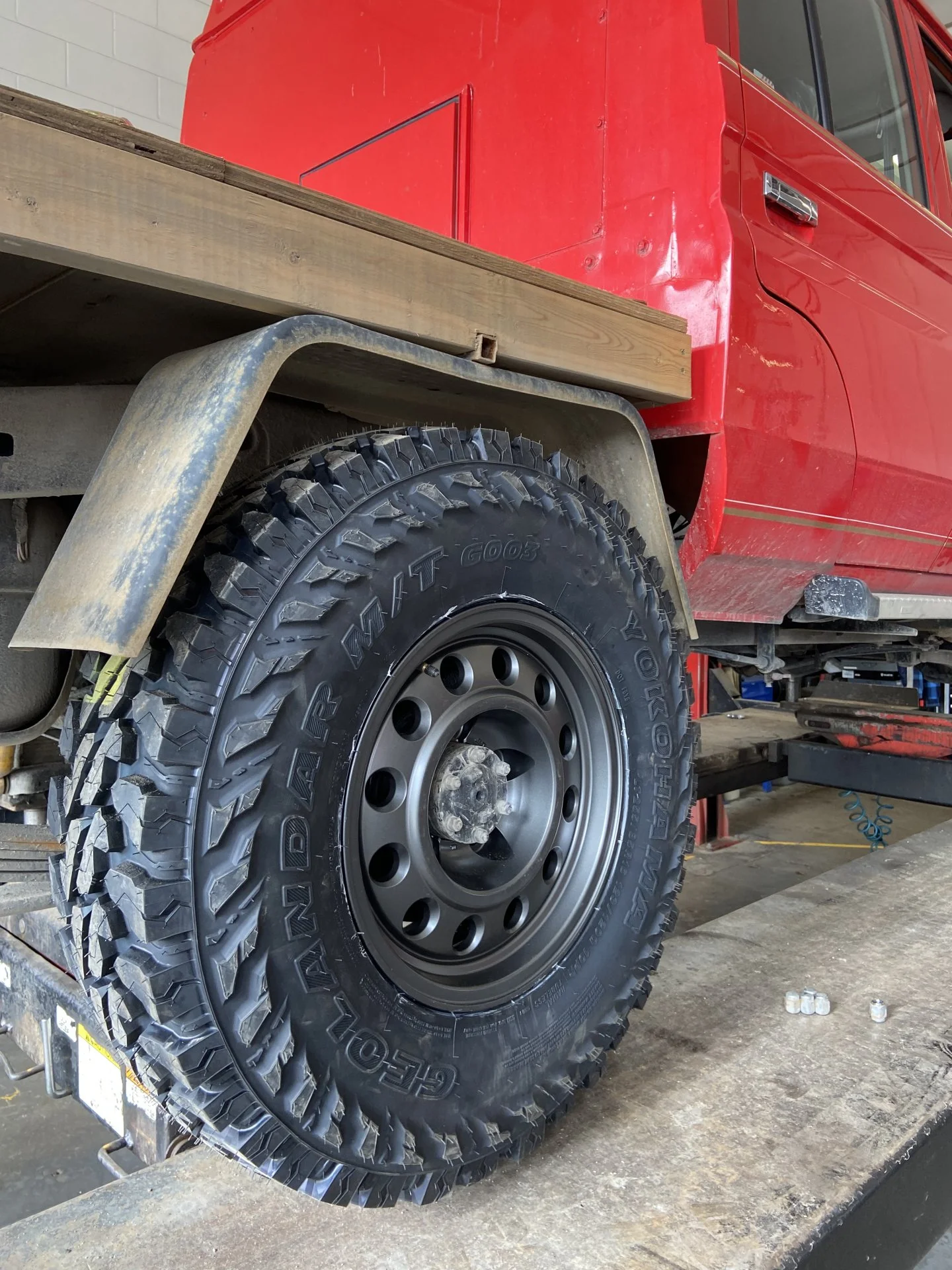

Finally after months of waiting my Yokohama Geo's arrived! Pretty tickled with how they turned out with the rim choice!
Took them into my local tire shop to get them mounted. After a few hours passed and the truck not ready I approached the salesman to ask what the hold up was. Apparently the bolts from my red rims were not compatible with the new rims I had purchased. They were able to source the bolts elsewhere in town and were just getting the tires on the truck. Out of curiosity I asked what the price was. 14$... per lug. I was beside myself. 280$ for the 4 tires being installed/mounted. I brought my frustration to the salesman saying that if I had known the price I would have had my winters put back on and I would have sourced them elsewhere (3-5$ on RockAuto). In addition I was disappointed that they did not come to me and inform me of the price before bringing them in. Finally the manager came to me and said "I also need to show you your rims". Took me out to my truck and pointed out where the installer had nicked one of the rims. I had waited 2 months to get these rims from Japan on special order so one could imagine my frustration.
The manager offered to have them resurfaced. I declined the offer. He then offered to pay for a new rim plus shipping from Japan which I accepted. I settled up the bill and drove home with mixed emotions. Frustrated that they had nicked a special order rim and were not careful with the install and second about the price of the lugs and no transparency with price before install.
Once home I did a quick walk around of the truck and found yet another nick..... by this point it was almost comical. I called back to the shop and simply said "I don't know who installed my tires but you really need to have a chat with them". The manager asked me to return to the shop so he could take a look. After a quick glance he sighed and offered to pay for 2 rims plus shipping. I accepted. I have mixed feelings about the tire shop I chose but I can say that their customer service is top notch. One could say "well they should do that" but I wonder how many shops actually would.
Mistakes happen and at the end of the day they are just rims but there is still an expectation from a professional service that they are installed with skill and care.
Now I wait for the extra 2 rims from Japan to show!

Prob the best looking rims iv seen on these. Awesome rim and tire combo! Wish they where not so expensive, costly mistake for the tire shop ouch!
Im not surprised they dinged them up, and I am surprised they offered to replace them.
gonna get them dinged up long run anyway so now you have some spares.
