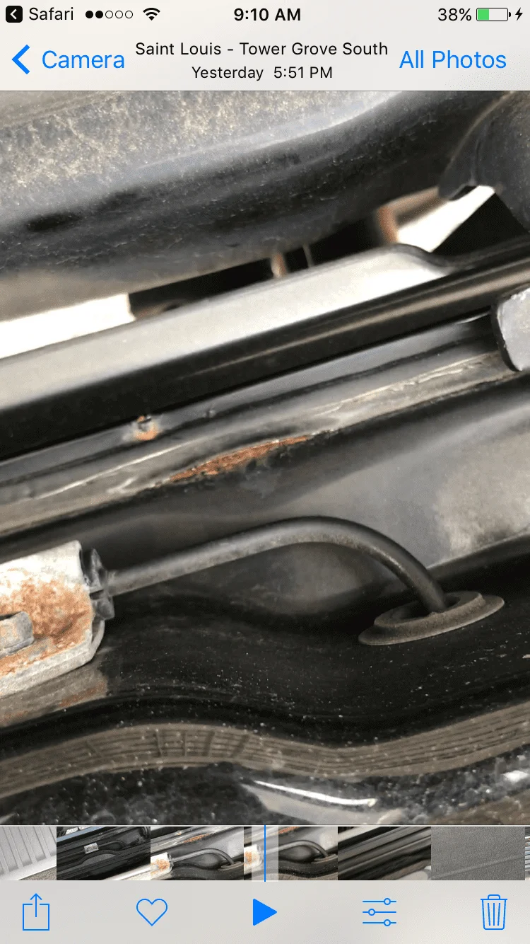

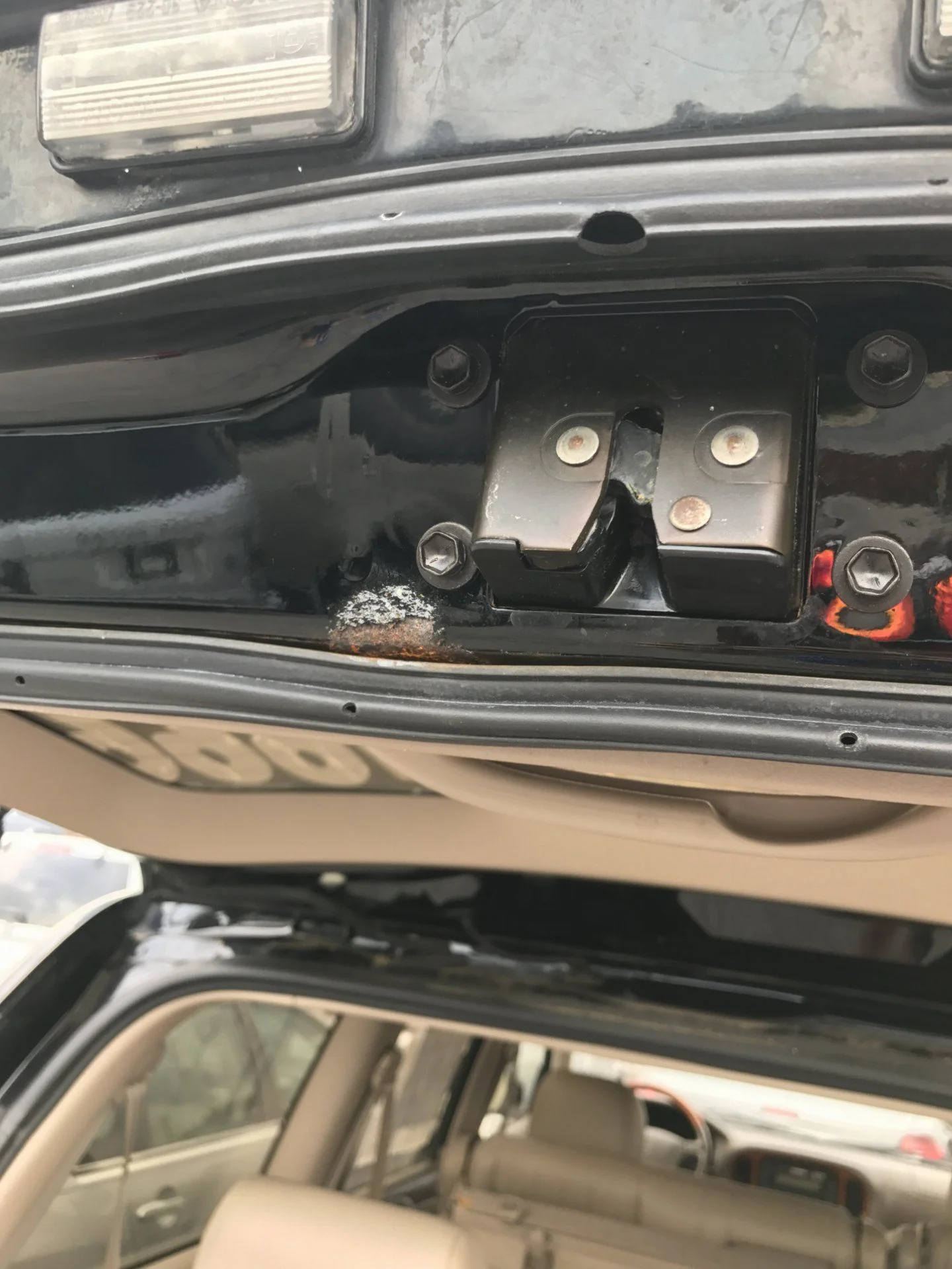

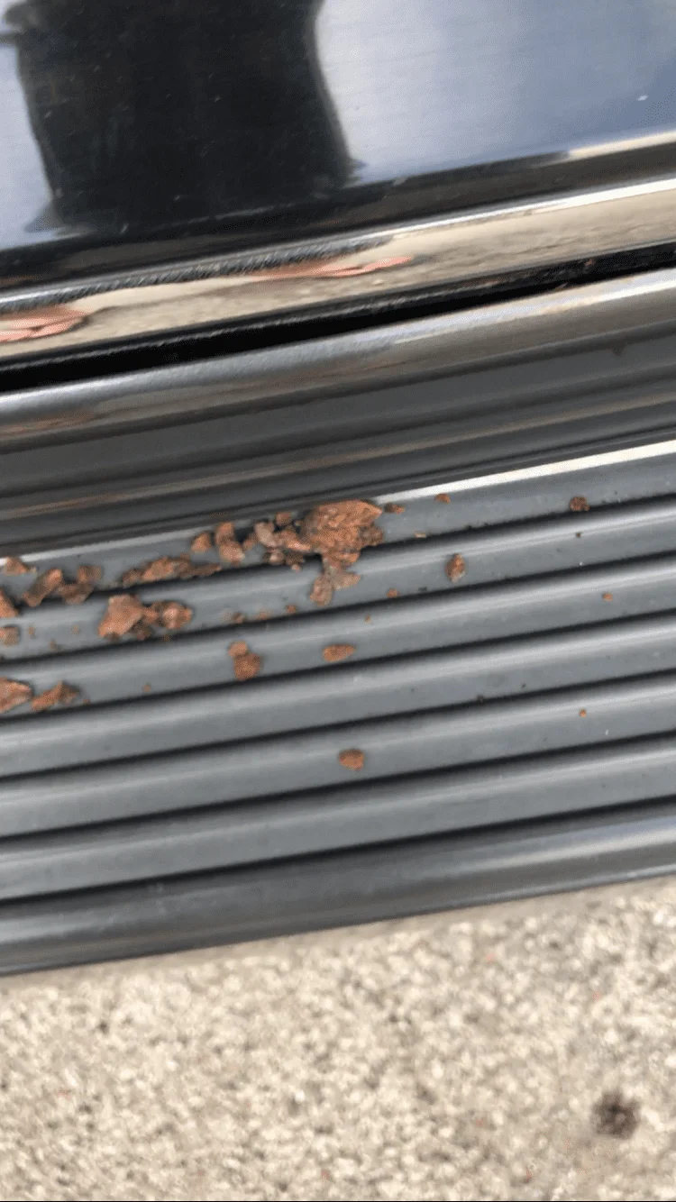

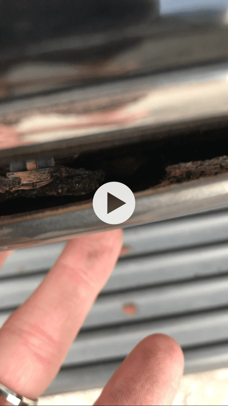

Anyhow, I thought I'd found the one yesterday (and only a two minute drive from my house in STL city). Beautiful black mamba. I went back today for another test drive and a closer look. Right before I was gonna talk numbers, I noticed that the cladding on the tail gate, just below the liscense plate cove, had separated just a bit from the body. I knew that meant water, and rust. When I poked and peered in, it was just super crunch town, and my heart sank. When you grab/squeeze the bottom of the gate in that area, you just hear and feel the grind, with small flakes dropping out the bottom (pics attached).
They're asking $9,995, reduced and moved from their main lot after 20+ days. It has 127k miles, and the timing belt, transmission fluid, and some other were items hit at 93k. Has a couple other small rust spots, some minor scratches, some carpet stains, and a clear coat spot on the hood that will start peeling, and some lights issues. When I turn engine over, all lights pop up as they should except for the diff lock light, and the diff lock light doesn't come on when I engaged it, though I hear the click on/off and it feels engaged (maybe a light or fuse?). Aside from those, my concern is the gate rust. Prior to finding this rust in the gate, I had planned on negotiating. When I showed them this issue, they took the NBD "just seal it" approach, of course. In my mind, this is a major compromise. I've just started looking into this issue, and have searched for and read several threads, but I'm needing more input.
Is this a deal breaker? Is it a possible bargaining chip with a replacement gate plus paint match in the near future? How tough are they to find? Is a cheap fix truly possible?

That doesn't bode well for other areas of the vehicle you haven't "discovered" yet (wheel arches, other cladding areas, lower door sills, etc.). I'd get under that vehicle and inspect with a fine tooth comb before considering it. Rust, it seems, is the only thing that can kill these rigs. I'd rather get something with higher miles and less rust than low miles with more rust.

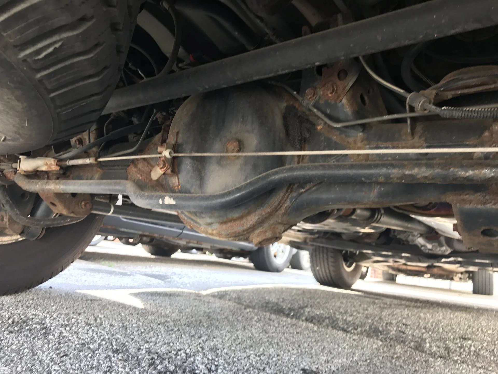

I spent a long time crawling around under it yesterday, though now I want to look closer at rest of cladding. There's actually little rust underneath for the year, which made the tail gate situation even more of a bummer. If the gate is only true rust problem area, would you proceed and try to deal down?
If that were the only true rust spot, I'd strongly consider negotiating it. Tailgates show up on eBay pretty frequently in decent condition. For probably $4-500 you could procure a new tailgate + whatever paintmatch would cost. I'd budget probably $700 for a cheap replacement.

Having said that, I'd definitely be checking out any and all of the gasket interfaces, especially the sunroof which is a common rust area along with the front of the rear wheel well.

Mine looks worse than that at 147k living in maine. but my upper hatch is even worse. Mine didn't look to have a lot of rust on first glance. Do yourself a favor and check the front right sway bar bracket is still in good shape. The AC drips right on it and mine was pretty much gone. Wish I had seen that problem before I bought.

How long are you planning to keep the car? For next several years, maybe not a big issue without fixing it. For the next decade, you may need to get a new tailgates. Good thing is, tailgate is a bolt-on part. You can replace it and you are done, as oppose to a rust that cause a hole in the frame, which would be harder to fix.

So I ended up going back up for final inspection before negotiating. I crawled around in the rain and looked closely at the bottom of each door. The passenger sides had a thin line visible rust. When I squeezed the front corner of the front passenger door, it crunched a bit, and some rust flakes dropped out. I was so bummed, because the engine was so clean and well-maintained, but I don't have the funds to deal with gate, maybe hatch, and doors. Overall, probably a good pass. Just now it's back to the drawing board. Anyhow, I wanted to say thanks because I'm not sure I would have looked so closely at the door sills. Take care!

That sucks about the tailgate. Seems like a very common rust spot on these. The underside looks pretty clean with just some light surface rust.
