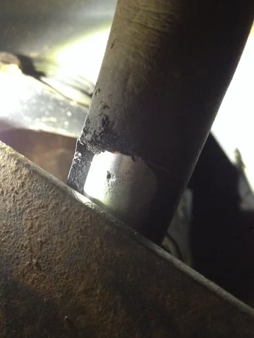

I knew I had better look real close at the plumbing in hopes of finding a leak. It wasn't long before I saw where a tube to the rear unit had been rubbing on the gusset of my slider along the frame. But it was covered in foam so the contact wasn't completely visible. I cut off the foam, muscled the tube to the side and revealed what might be a corrosion type of pinhole in that contact spot. I then saw the slight moisture from the leakage, but it certainly wasn't the large mess I was searching for, this was evidence of a very small slow leak I thought. So I cleaned it and picked at it until the hole was fully punctured and it let the rest of the gas out into the atmosphere (sorry about that :().
Rather than trying to order that section of hose I just figured I'd go for some JB Weld being that it was such a small hole. I generally don't use that stuff much but this seemed like the perfect solution. Time will tell I suppose. I reinforced the wear area with what I had on hand. It looks, and is hokey, but some hose and zip ties were all I could muster after about 10 minutes of rummaging for the perfect guard...

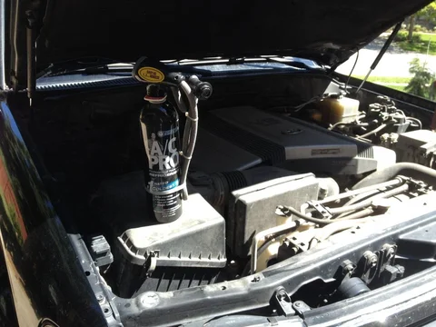

After the repair it was a quick run to the store for a $35 can of A/C Pro and 15 minutes later I had cold air once again! The product also is supposed to have a sealing element which should also help with that tiny pinhole from the inside. I'm hoping it stays that way and that this wasn't just one of a number of other problems with it. Hopefully there won't be a follow up to this thread and it will continue to work as it should.

I fixed mine today using Devcon epoxy, it's rated for 1900 PSI and chemical resistant so time will tell. It was hard to get it to set up and keep from dripping but a combo of wrapping paper and perseverance seem to have done the job, I've got two coats on it now and will add the third and final coat tomorrow morning.
In the meantime, I'm ordering the Dorman 800-673 Air conditioning line splice kit for 5/16 line and throw it in the toolbox ($36 on Amazon). While I think the epoxy will hold, I'm in Angola and I'd rather have a spare than wait 3-4 weeks in the dead of summer for the mail to arrive. Anyway, this kit looks like the correct way to repair this all too common issue and it only costs $36 instead of the crazy $1500-$2100 estimates I've been reading about.
Alright, I just pressure tested and while I didn't hear a hiss, I could still tell that their was a slight leak (a freon charge would probably last a few weeks). If I was in the States, I'd pull a vacuum on it and then add more epoxy but alas, I'm on another continent without the comforts of home. SO, I'm about to order the Dorman kit and will post up when it arrives and how the install went. The last thing to check before ordering is to make sure those are 5/16 lines....I'm 99% sure they are based on what I read but want to complete my due diligence so that I'm 100%.
The Dorman came in the mail and I went ahead and installed it. It was pretty simple, I just cut out the damaged section of line, measured, and installed the new hose. I thought it was going to be a stainless hose but it turned out to be rubber, which wasn't an issue as it went on very well and looks to be a long lasting repair.
I recharged the system, tested for leaks and found none,, and am now enjoying cold air.
