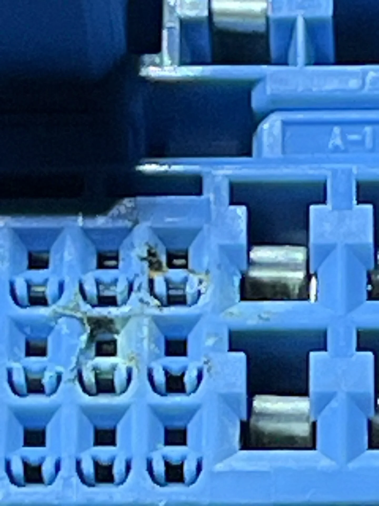

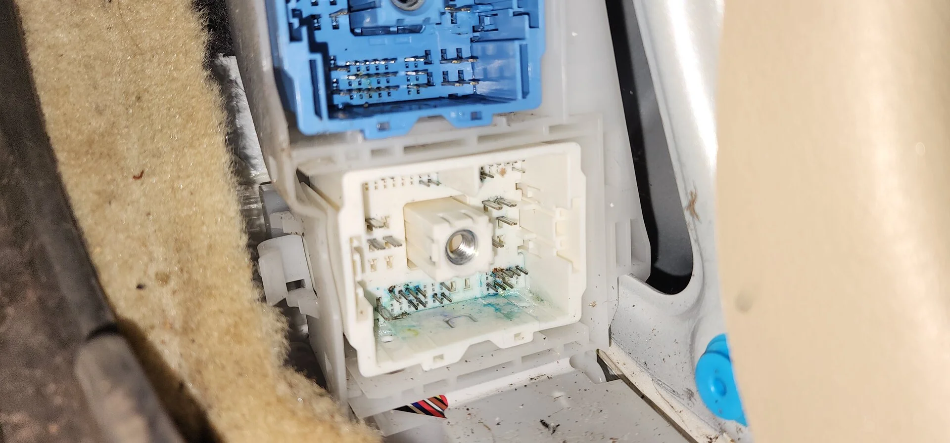

Houston, we have a problem. Likely a water intrusion problem although I see no evidence of dampness currently. Please see in the pictures evidence of a short and that at some point could have been caused by water intrusion. A few pins (see close up) are not green and just looked toasted a bit.

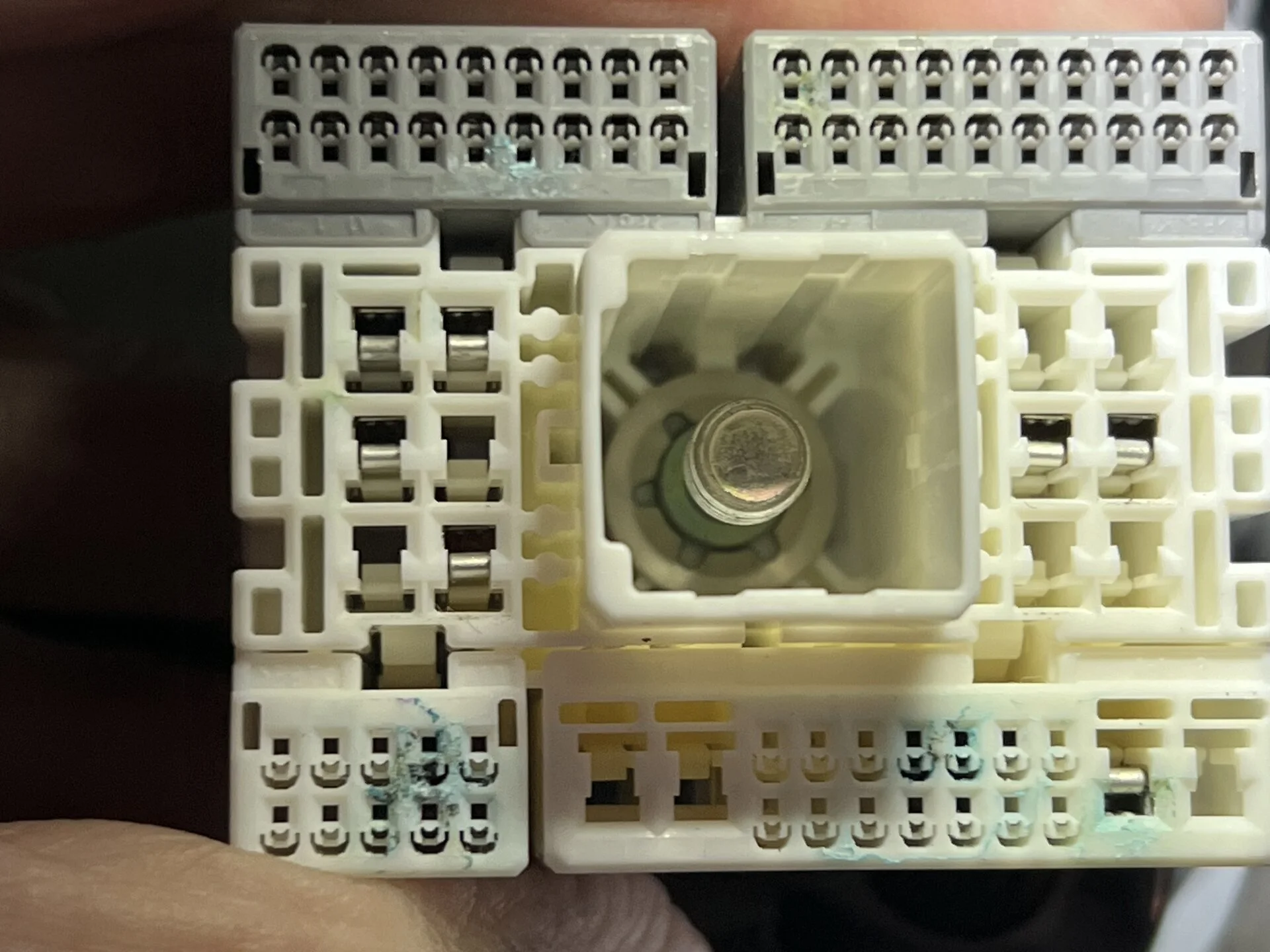

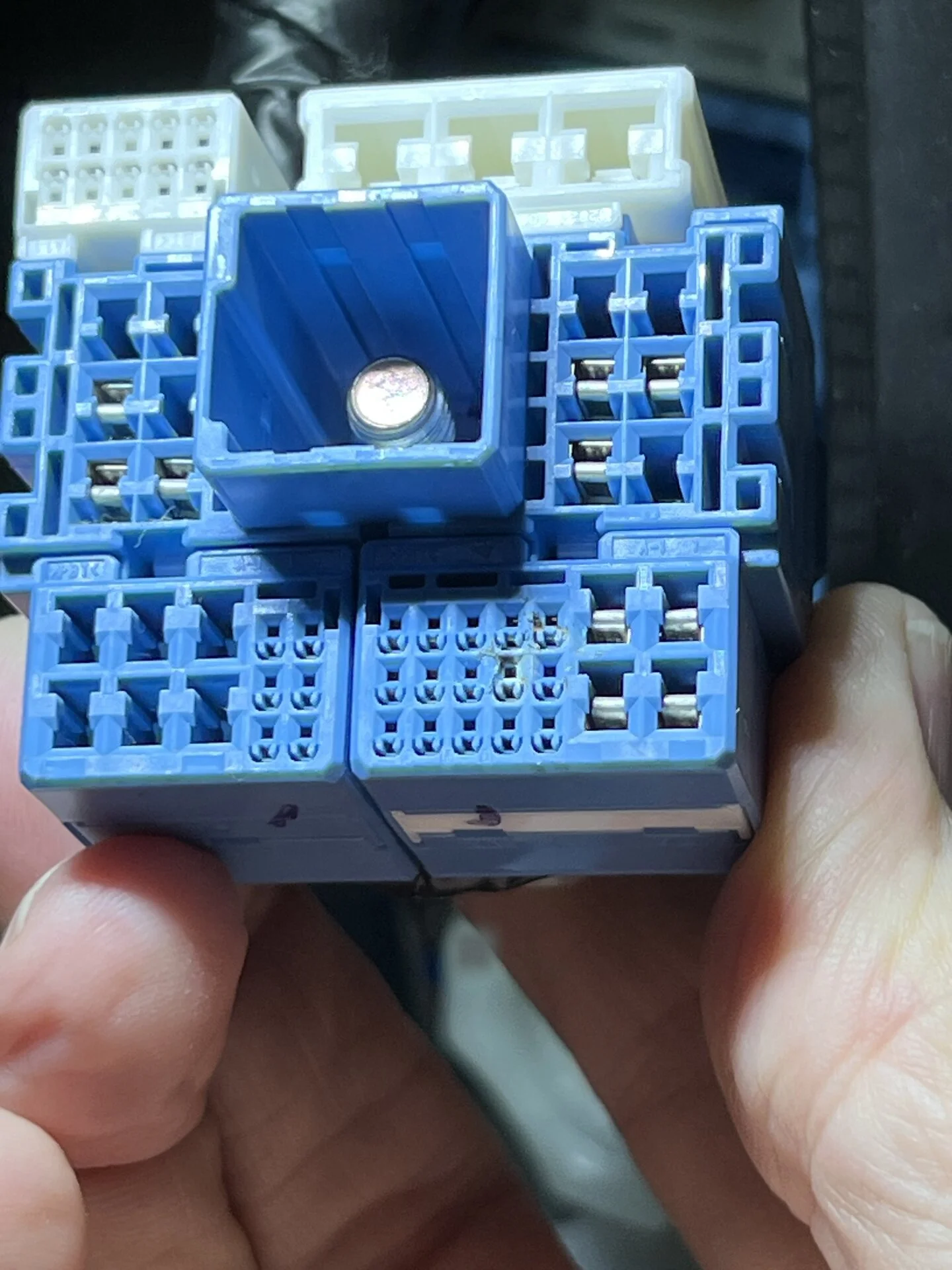

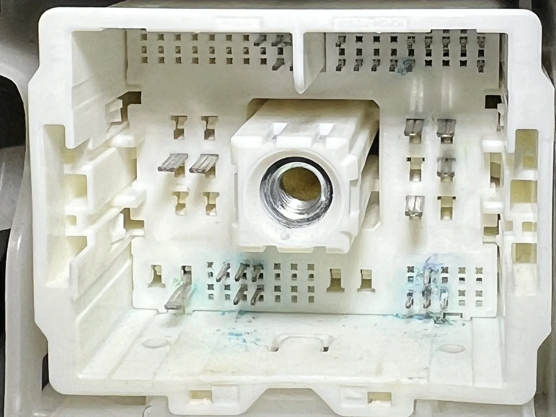

I removed the harness plugs (see pics) and see damage on a few pins on both plugs. My mechanic said use contact cleaner followed by a light coating of WD-40. I was thinking of buying some CRC 2-26 plastic safe electrical lubricant spray.
I don’t want to screw this up could someone here please direct me in a layman‘s step-by-step instructions of what I should do next. Do I use a toothbrush? Do I use contact cleaner? Would the CRC be better than WD-40?
I had almost no success with any of the commercial cleaning sprays and wanted to try this but you may beat me to it. In my opinion the vinegar and salt thing may just work. You can put it a ways down your remedy list but I definitely would have it on my list.
I’d start with some CRC and go from there.
Once it’s all cleaned up, some dielectric grease would be a good idea to help ward off additional corrosion.

I'm a CRC fanboy. I used the contact cleaner. and everything "looks" better. I only had a toothbrush and that would not get into the male plug at all. For anyone reading this in the future, I would recommend a painter's brush to get into the small spaces. For future treatment I only put the dielectric grease around the outside of the connectors to help with any future ingress of water. I was not confident on how to use the grease otherwise. This issue is so intermittent and that's a hard problem to troubleshoot much less correct. Time will tell if my efforts have corrected the problem. How common is it that the gateway module itself would be bad?
