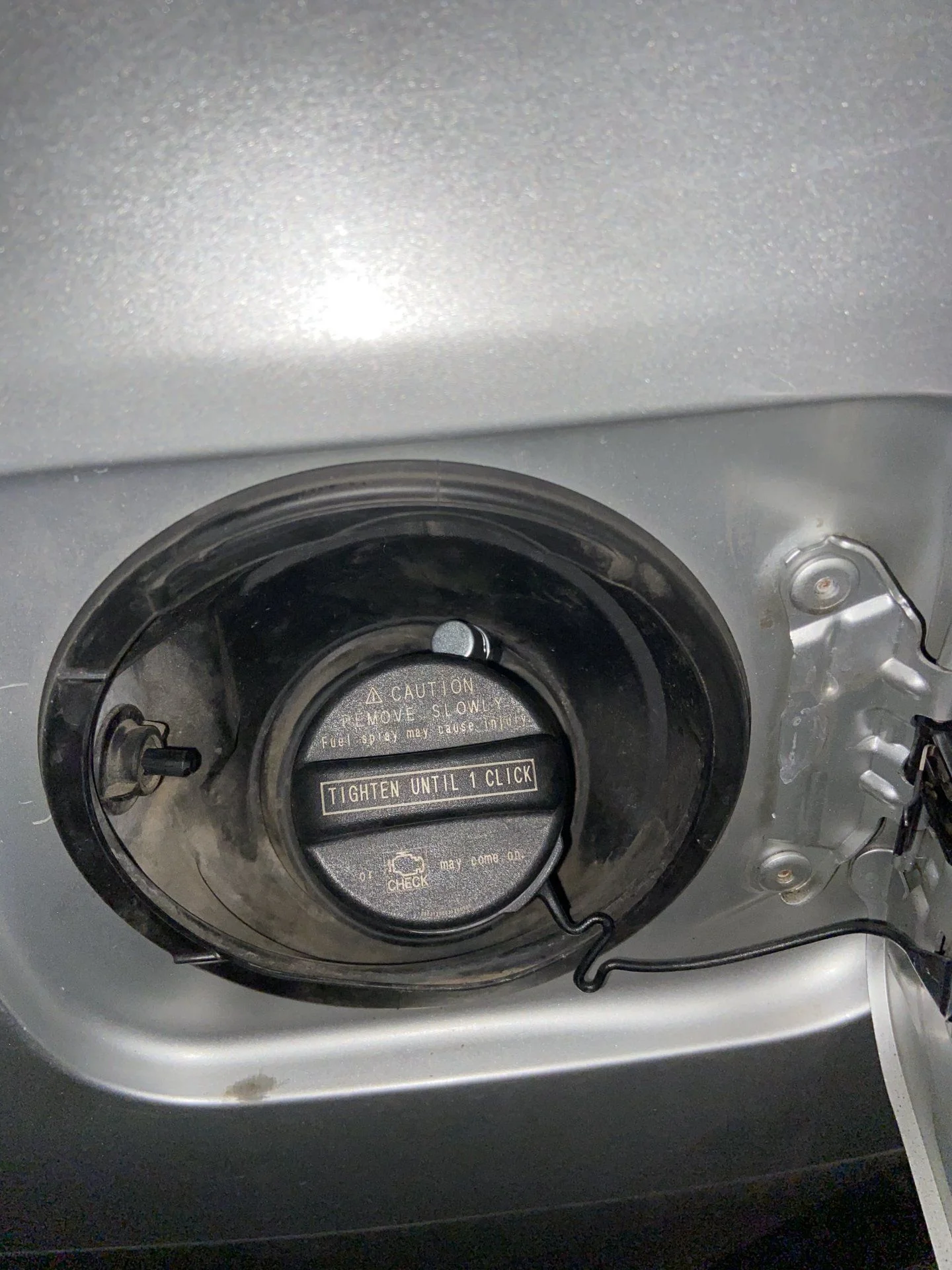

Today after reading more about tail light vs Gas fill location for the rear differential breather mod. I decided that the gas fill location as mentioned before is a better location that the tail light location due to the possible smell coming out from the breather and getting inside the car. It was easy to install by the gas fill location and now any air Coming from the breather will be released to the outside of the car.

@Lion2008 did you cut a hole in the gasket material or did you bypass the gasket material and go under it? Thanks!
I did not cut a hole. When I pushed the breather hose by the filler tube, it just went through. The gasket is not sealed to the gas filler tube.

FWIW, I had my rear diff breather extended up into the fuel filler neck when I had my LRA aux fuel tank installed.
how has this location worked out over the years? Any issues with dust or water getting kicked up into that spot or any maintenance required in that location?
It has worked without any issues. No dust or water issues..it looks as new as the day I installed it.
