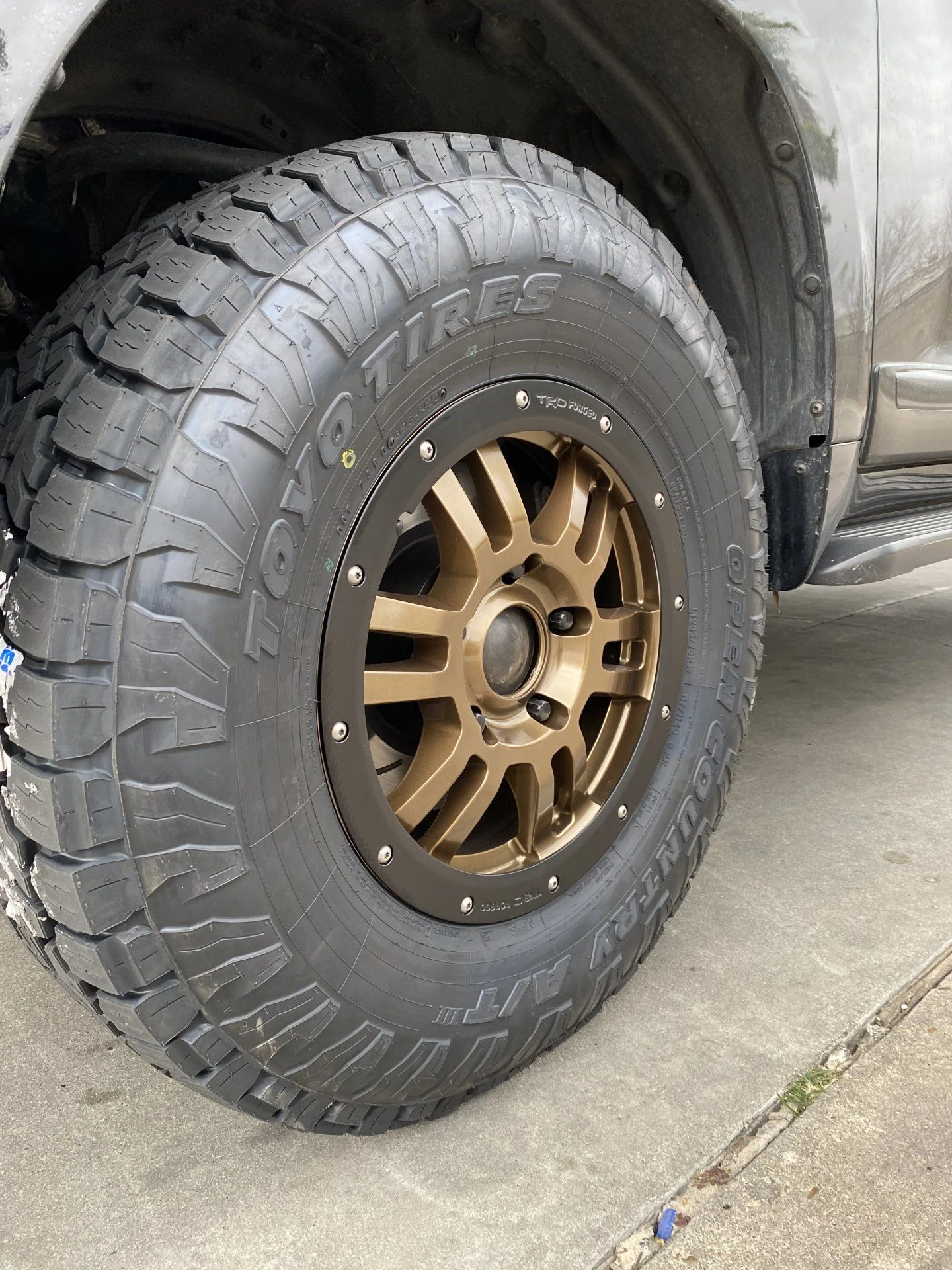

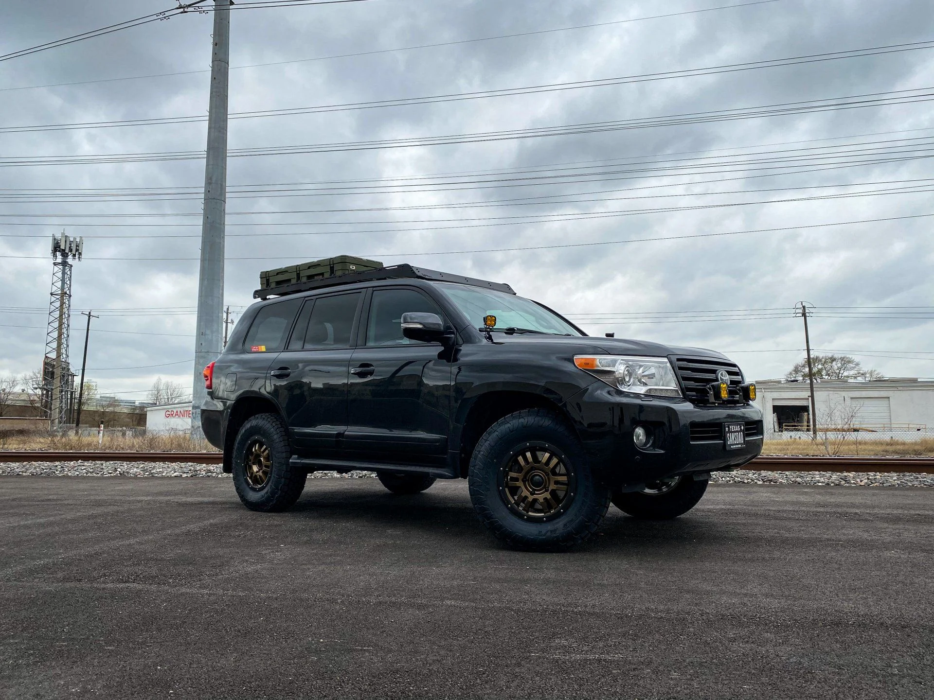

Switched up the wheel tire combo! Went taller with a much better offset and load range C as opposed to E. Rock Warriors powder coated bronze and black, Toyo Open Country 285/75 17. A weight savings of 7lbs per wheel.
Previous setup was black rhino rokus (18x9.5 +12 offset), Falken at3w 275/70 18. Currently for sale if anyone wants them!

Those bronze RWs look great. What'd it cost you to get them done?

How do the c rated ATIII's ride? I am close to pulling the trigger on that exact tire. Hoping that the lower load range maintains a better on road ride quality.
Any rubbing?
Any rubbing?
So far, I’m in love. Rides much smoother and quiet. No rubbing but I had already cleared and heated a lot from the previous aggressive offset.

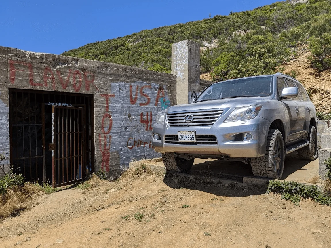

I have 285/70/r18s (34x11.50) Ridge Grapplers on my truck with Icon lift, UCAs, and spacers. Removed front mudflaps and still rubs at near full lock or articulation but not too badly. I would say you would definitely get some (or maybe a lot of) rub but your setup will dictate how much. A really good alignment from a toyota off road shop helped me tremendously.

Any thoughts on a lx570 running 305/55/20 on 20x10 with a +12 offset ?
Wheel poke would be covered by fender flares and height would be sensor lift only
You'll rub. Pretty badly.
I ran that size with +35mm offset which needed some good clearancing and still rubbed in spots. At +12mm, you'll likely need to roll or trim the upper fenders, body mount chop, and likely trimming of the bumper and steps. The offset also won't be great from a handling POV as scrub radius will be pretty far off.
It could look good with fender flares though. Just trying to help you go in eyes wide open.
You'll be poking out another 1" from this.
