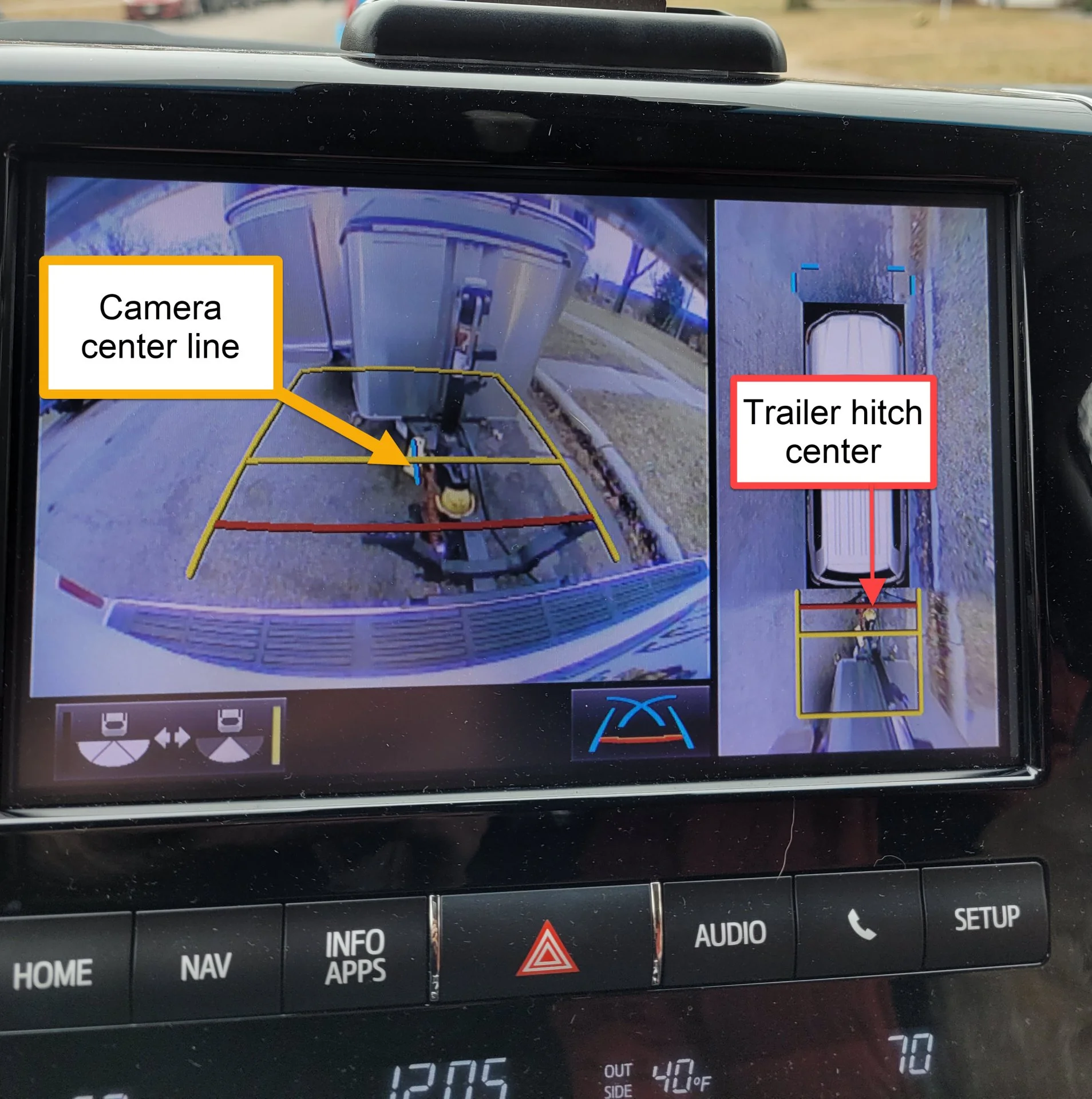

I have a 2021 200 Series that is my new tow vehicle for my small Airstream. Bought the truck for countless reasons, one being a more comfortable tow vehicle over the 2012 Tacoma I have had since new.
To my surprise when picking up the Airstream from storage, I found I could not for the life of me center the trailer coupler onto the hitch from the rearview camera (pic included). If our exhaust pipes came out the right side of the truck, that is what is showing as "center" from the camera view.
Today I brought the truck to the dealership and asked for the rear camera to be recalibrated, and learned from them calling Toyota, this is "just how it is". Super surprising on such a premium truck, especially since my Tacoma was rock solid center and I could always count on hitching up without assistance. What the heck?!?
How have any of you experienced issues with the rear camera for trailer hook up? Have you just grown used to it, or have you sought out other solutions? I saw Victory 4x4 has a rear camera relocation kit, but I'm not planning on moving my spare to the back of the truck. Any advice or thoughts are helpful. Thanks.

I don't disagree with your situation and response - sounds like you see that 8 inch offset location of the camera is the culprit. I chalk it up to a platform designed in 2006, 2007 when the cameras weren't standard features. Camera relocation would be your best bet, or others have added aux cameras mounted under their spoilers if I recall.

Put a marker on the flat of your bumper in the center over the hitch. Could be a stick or some tape or some paint, sky’s the limit.
If you want to spend $100 there are many Wi-Fi temp camera / monitor solutions available designed for this issue.
I don't see the problem at all. You can clearly see the coupler in the camera screen, why do you need it to be centered? Align the coupler with the trailer, hook up and go.

Great responses--appreciate the thoughts. I was thinking on the way back from the dealership about a painting new "line" on the a frame of the trailer hitch. Maybe I'll try that till I get irritated and then go the aux or camera relocate route. Watching the ball and hitch alone on this initial hook up didn't give me enough time to course correct.

If it really bugs you there are cheap trailer hitch cameras with a Bluetooth screen that you can stick on the hitch with a magnet. Use it to hook up. Then take it off and store in your glove compartment for the next time.

It is very easy to adjust those lines.. so they line up with the trailer.
I just moved mine as I moved the camera.
Directions:
1). press the start button 2 times (do not step on the brake) and wait until the Navi gets past the continue to it's normal state.
2). Hold down the Navi setup button and cycle the headlights switch to headlights on and back to off 3 times... while holding down the setup button.
3). release the setup button and the back door menu appears.
4). then press the I think it's align button and hold it down.. then the rear camera..
Then you can move the lines around up down sideways etc..
Then start the car and see how they look.
Redo as necessary.
If you get stuck post back and I'll post some pictures.

Hmmm would love to see and hear how this goes. But my feeling is you’ll be moving the green yellow red lines which currently aligned with your car. And moving them may give a false sense of where your car will track for the sake of centering the hitch in your screen.

... It has different setting for the blue vs the yellow red lines.

The setting for the camera looks like it it is greyed out and unavailable but you just press it for a few seconds and the camera adjustments show up.
I find the offset to be terribly frustrating. I often park where I have to elevate the trailer tongue up almost to the limit of the jack to level it and the offset makes trying to get the two lined up almost impossible. This isn’t a operator problem, I have a commercial drivers licence originally issued in the 70’s and have quite a bit of experience towing my jet boat, 16’ travel trailer, 25’ travel trailer and my utility trailer with my 200’s. I have to try and guess how far the offset is to estimate how far to the right the ball has to be to ma5ch up. I guess if you park on level ground all the time it’ll be okay but I don’t. And those line up lines on the LX end up going across the screen right where the ball is, especially if there is sunshine.
