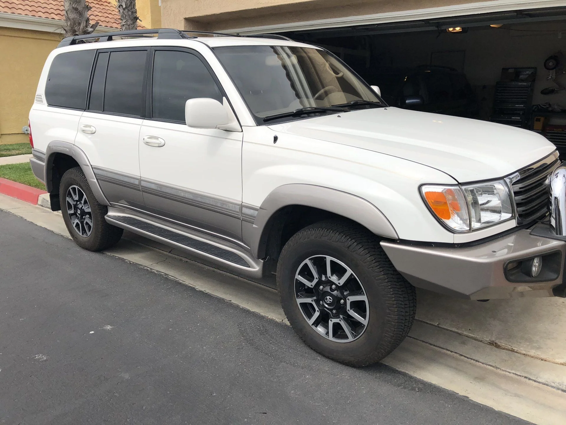

@G-Cat So if I decide to run these and dont care about the center caps, I could run them without the spacers?
If you want to run the center caps...yes.
@implayaz9
If you’re asking for a 100 series, I would suggest on doing more research before you decide to mount the rock warrior wheels without any spacers regardless of center cap.
If you have these wheels you can modify the center caps to fit by using a 1 1/2” (38mm) hole saw and some light dremeling.
Push out the Toyota emblems using a screw driver. On the backside of the center cap, there is a reference mark in the plastic that indicates the exact center. Using an awl, mark that spot and drill out with the hole saw. You’ll have to do some dremeling to slightly expand the hole, to make them fit flush. If you go much larger than 1 1/2”, you will cut out the mounting holes for the Toyota emblems, hence the drill and trim routine. Once the center caps are mounted, you can use gorilla glue or similar to mount the Toyota emblem back onto the center cap. It will stick out about 1/4 - 1/2” beyond where it normally did, but mine haven’t come off in over 1,000 miles. This seems easier to me than taking off hammering caps flat.
TRD Pro wheels with 275/70-18 Duratracs. No spacers. Needed to flatten the dust cap with a hammer and trim tabs inside the center caps for the fronts. Everything fits now.
