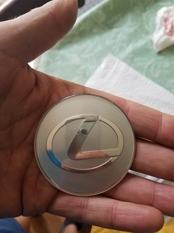

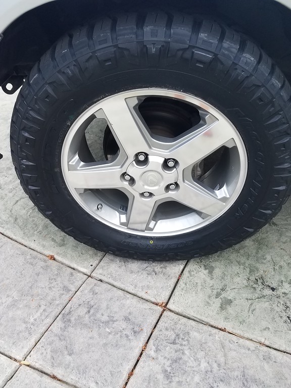

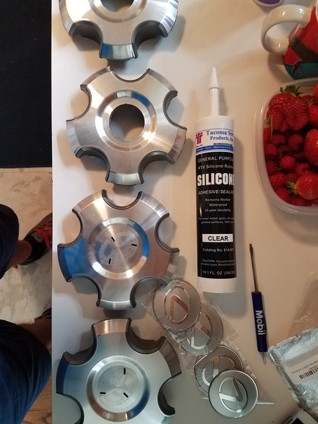

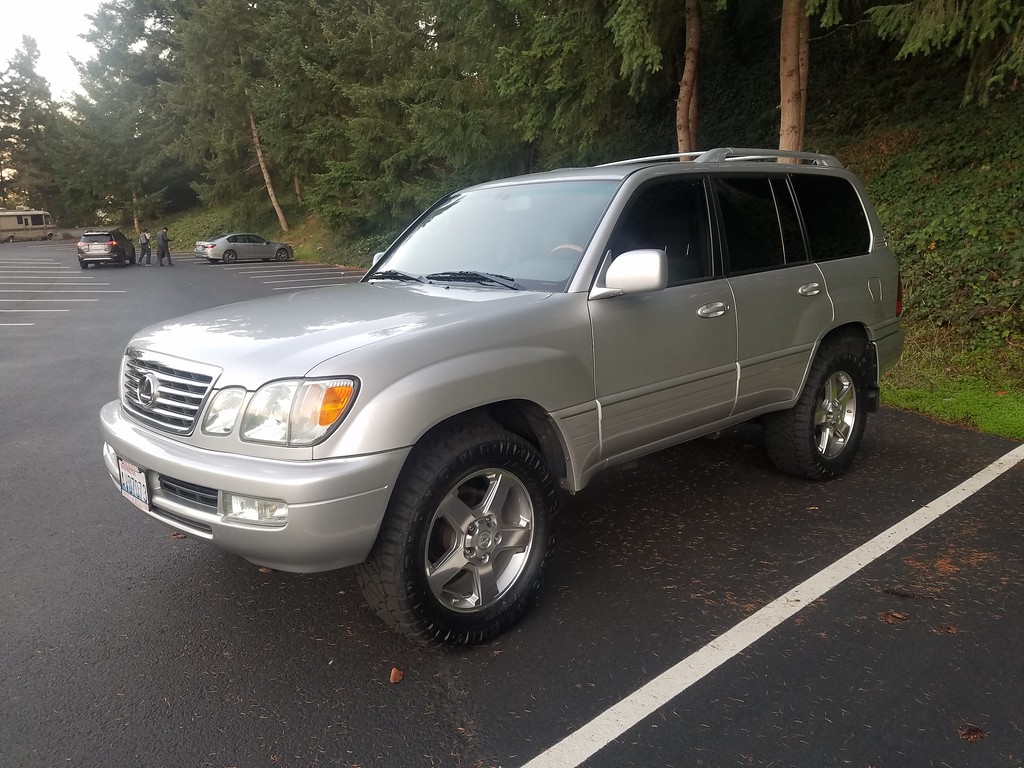

Here is a quick wheel cap mod I did on my Tundra wheel caps. You can flatten the dust cap just a bit. Some have flattened them completely and removed the plastic on the inside of the cap and had just enough clearance. I used a holesaw and picked up some center cap covers on amazon around 65mm made of alloy and slightly domed. There are TRD models as well.
Before
Center cap
dome view
silicone the caps in place
Finished look

Looks really good! You can’t tell it wasn’t oem.

Have you had issues getting these wheels/tires balanced?
No, not at all. They came off of a brand new 2018 Tundra TRD. Same wheels and tires I have on my 2016 Tundra TRD. Love them. Hard to beat a Michelin for smoothness on the road. That being said, it is not a true AT tire.

looking at the hub on that wheel I would say not. Tundra does have the same hub bore size but that wheel does not look like the bore continue through the whole wheel body. The small center cap is a good indicator on wheels that wont work on the 100 series hub.

Is it safe to flatten the cap a bit? I’ve found a couple of sets of 20” tundra wheels that I’ can get. Either for $250.
I’ll try to retro fit my Lexus center cap on it vs trying to get spacers or flattening.
