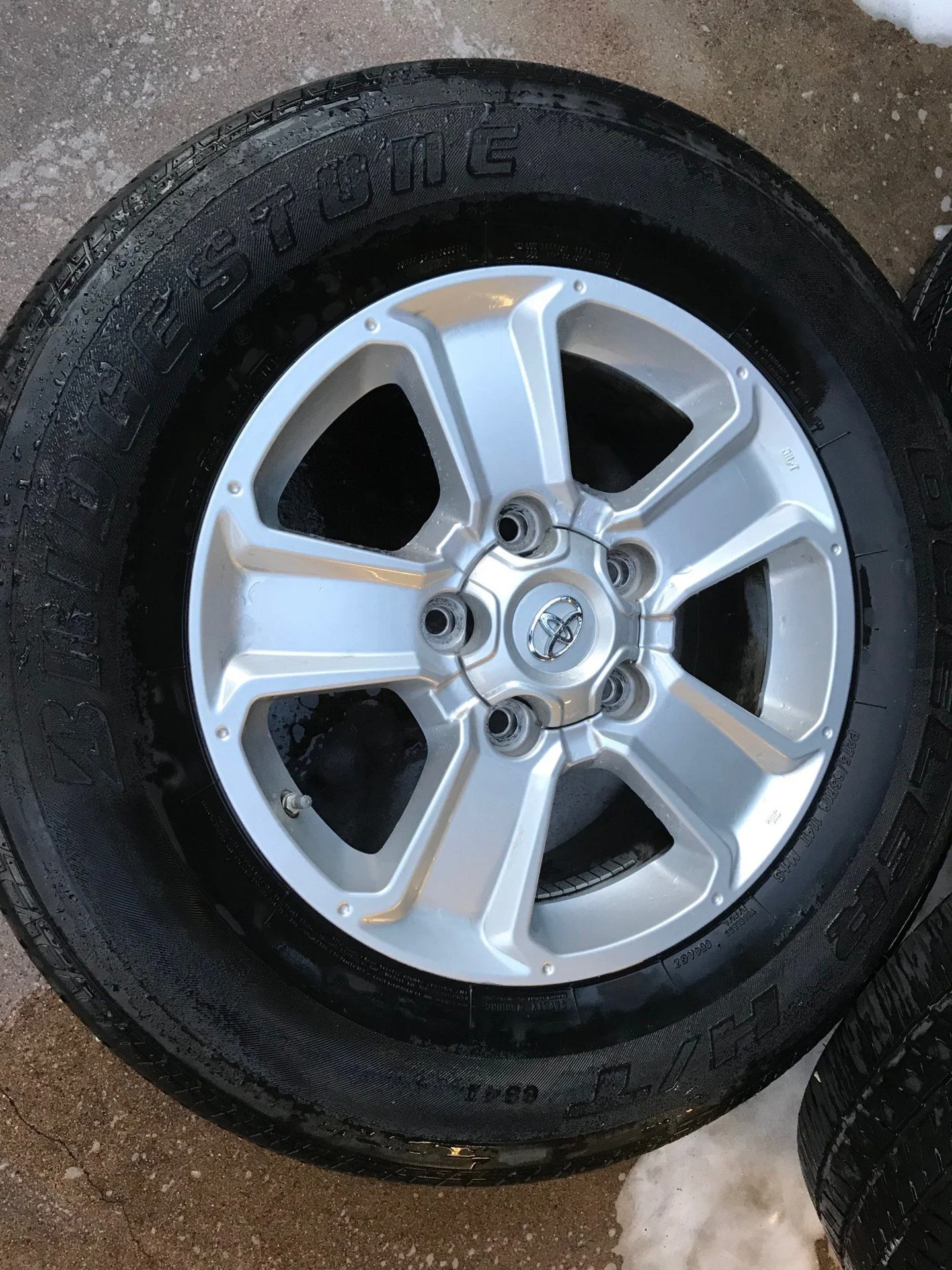

@geanes I picked up these wheels a few weeks back. Did y'all find the need to run spacers with the? Or were they pretty much good to go.

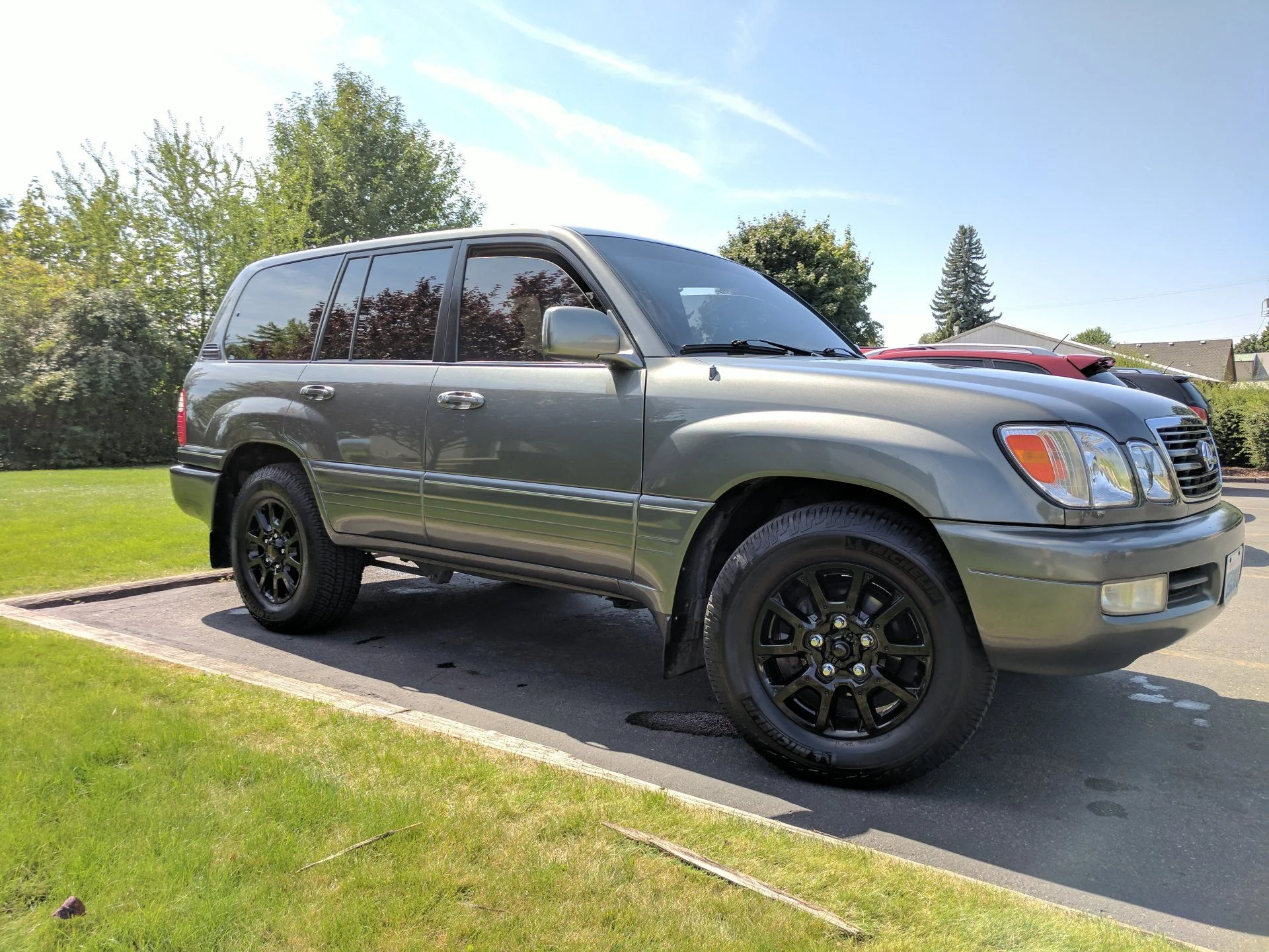

I ran 1.25" BORA spacers to get them even with the fenders. The BORA spacers are 1st class. So are the Spidertraxx from SLEE
Might be a better "stance" shot here with the Tundra wheels on the 1.25" spacers

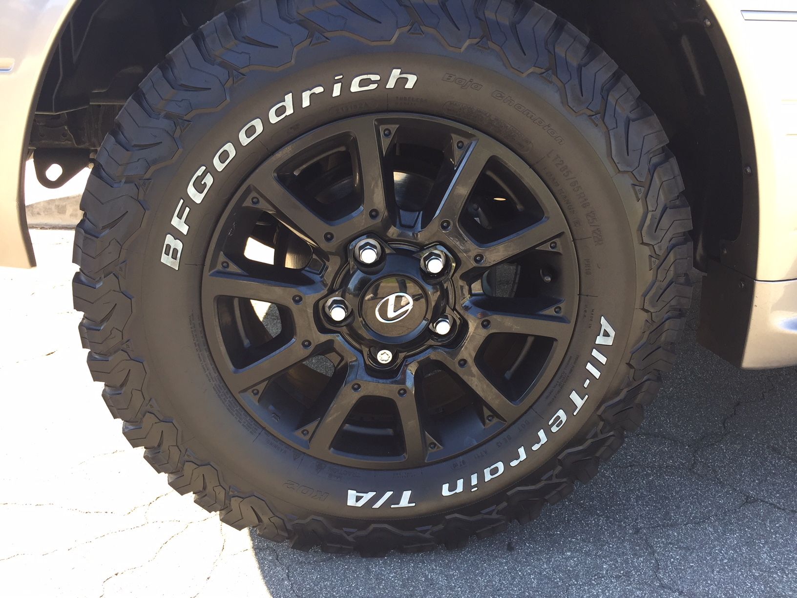

Can anyone say if I have the right nuts for these wheels? My old wheels had a recess and the nut had washer and was shaped smaller at the end.... these nuts have conical end (dorman conical), it just felt strange tightening them down, I was able to get them tight but was unsure of the nut engagement with the wheel. And I'd like to run a small spacer, I read .75" is probably lowest I can use?

You should just get M14x1.5 tapered lugs without the washer to run steel wheels. The angled part on the factory nuts is more to guide the nut into the wheel, and the washer is for retention. I’d bet the taper is different on proper steel wheel nuts.
Looks great! I’m on a phone so this may be in your signature but is everything else stock suspension? Other than an alignment did you have to do anything else after installing the spacers?
Didn't have to do any alignment at all. Stock AHC suspension.
