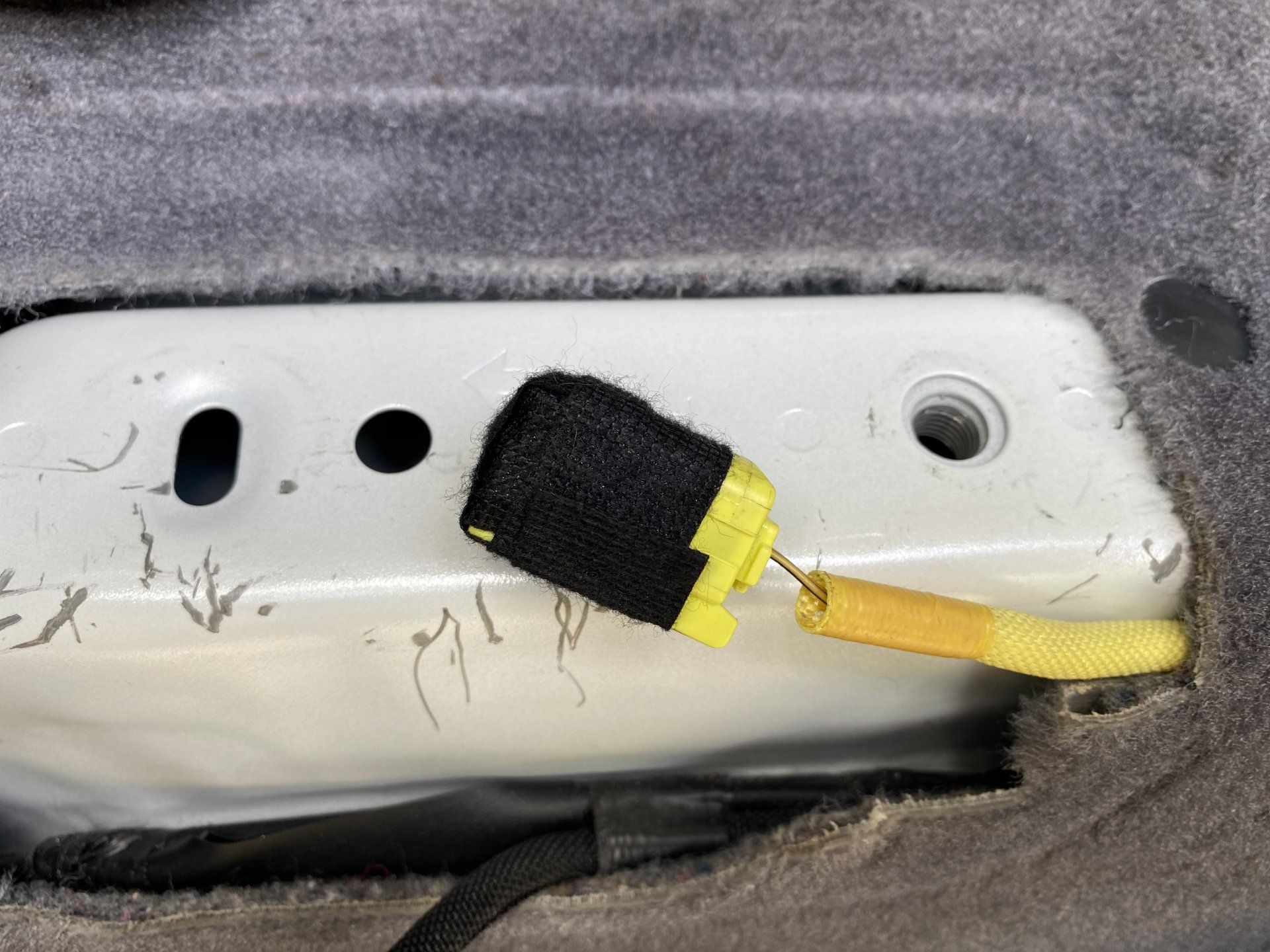

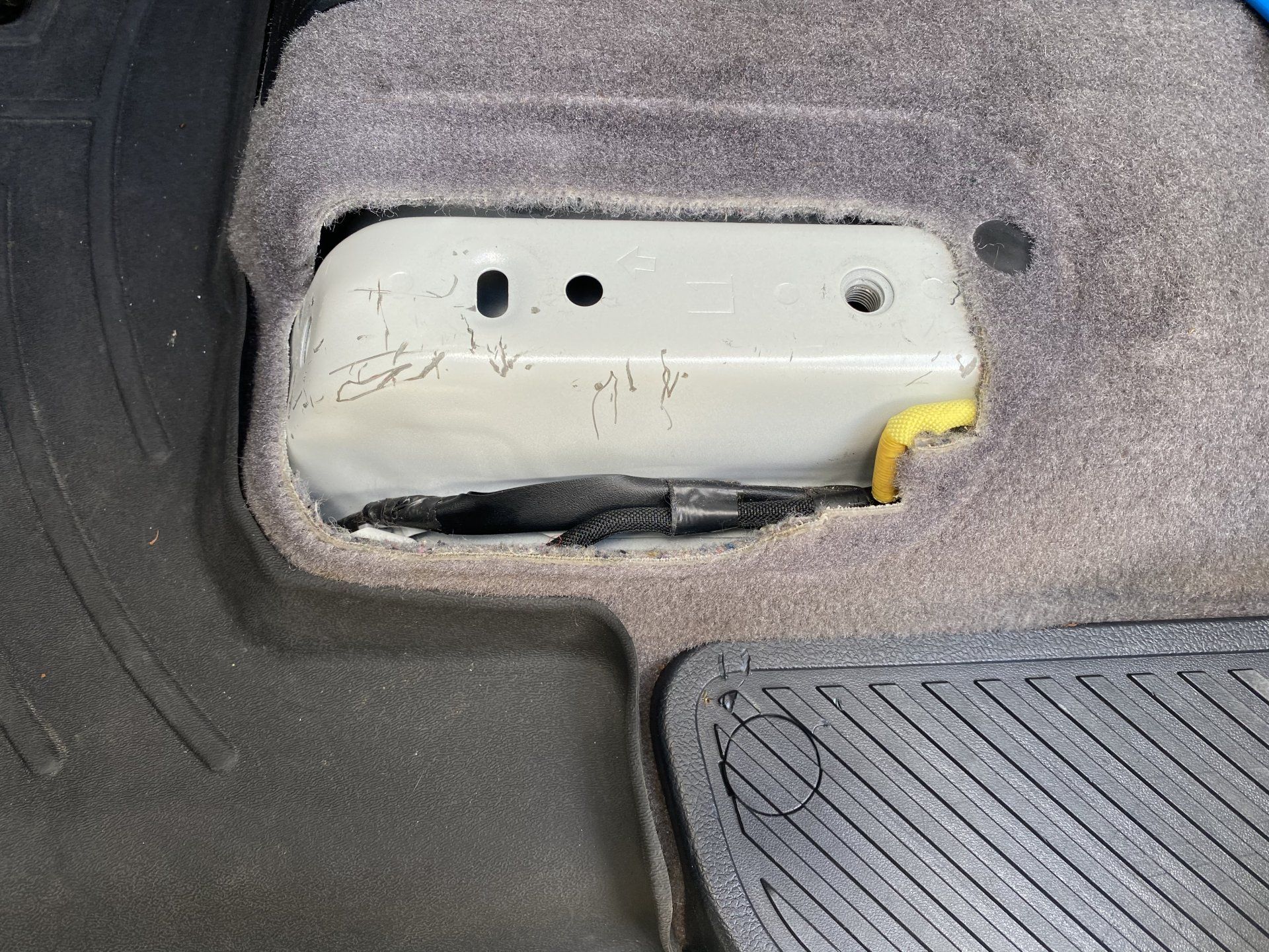

It is silly easy. Remove the plastic covers, unplug the two connectors on each side (airbag and heated seats), then remove the bolts and take them out. The hinge is spring loaded, so remove the bolts on the vertical surface first, then tip the seat up to remove the horizontal ones. They are much heavier than they look.
That is the process, super easy. I just put the resistor straight into the airbag plug and taped over it, no need for special wires etc.

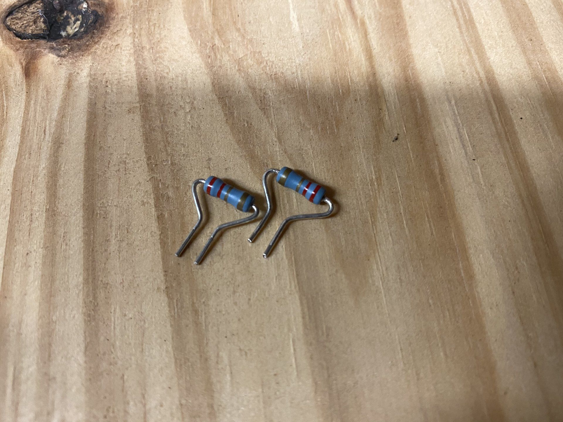

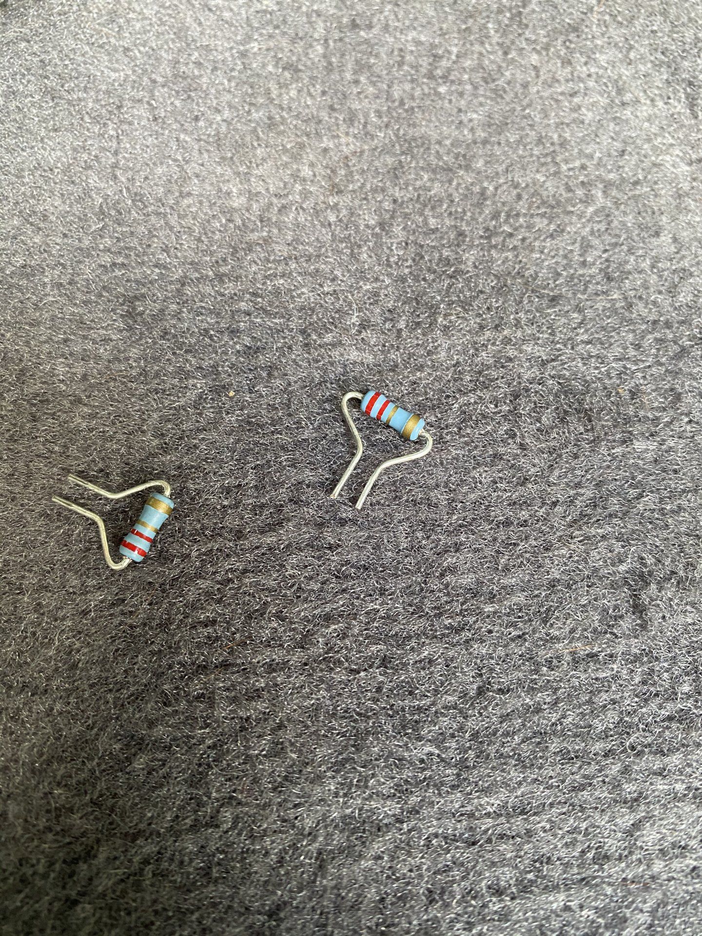

take the resistor, trim the legs some.
fold the legs down so they can go into the female portion of the terminals on the airbag plug.
make sure the legs don’t touch Once inserted
tape it up w electrical tape
should be pretty self explanatory once you are in there.

These are the resistors I use when my second row is out for trips.

The main specs will be resistance (ohms) and power (watts). Technically a higher wattage resistor will work fine, but fitting it into the connector will be more difficult and the fatter wire might damage the internals of the female connector. The diagnostic function constantly checking for continuity (what triggers the light) will be very low power so we don’t *need* to run a high power unit.
I THINK I used 2-ohm 1/4-watt resistors for mine.
I’m assuming the airbag trigger signal is higher power, but if the airbag isn’t there (no passenger) and the resistor doesn’t survive being fired.. I’m not that concerned.
If the connectors are gone you can just put the resistance in between the wires. Soldering probably best, heat shrink butt joint would work too.
