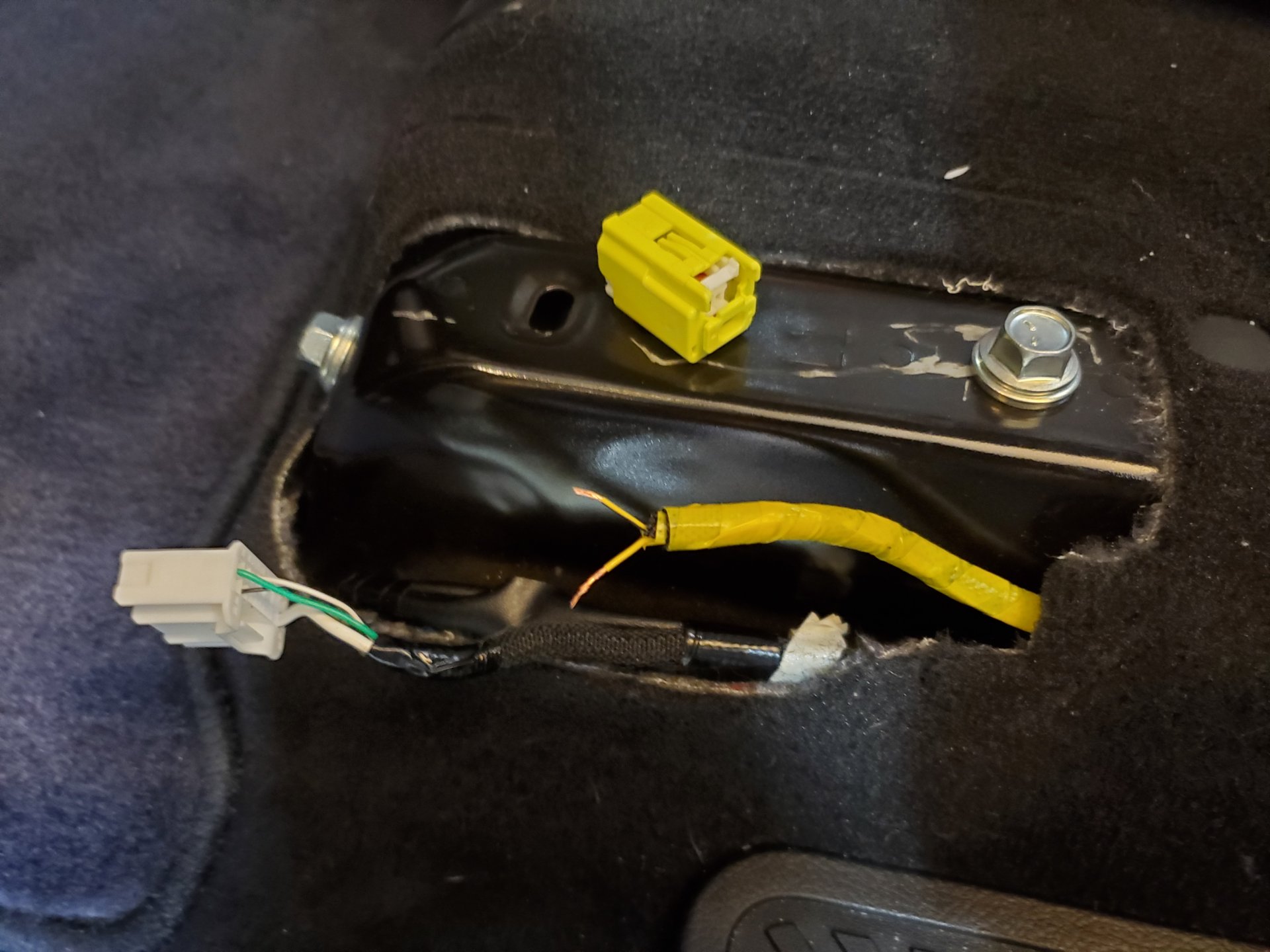

The trick to that yellow one is a two stage release, you release the shell, then then the push will push. If I recall they go in different directions.
I screwed up the removal. I was having a hard time getting the SRS connector to come apart and tried removing all of the bolts so that I could move the seat a little and get the wiring in a better position to release the connector . . . The seat is heavier than I thought and I ended up pulling the wires out of the connector :doh:.

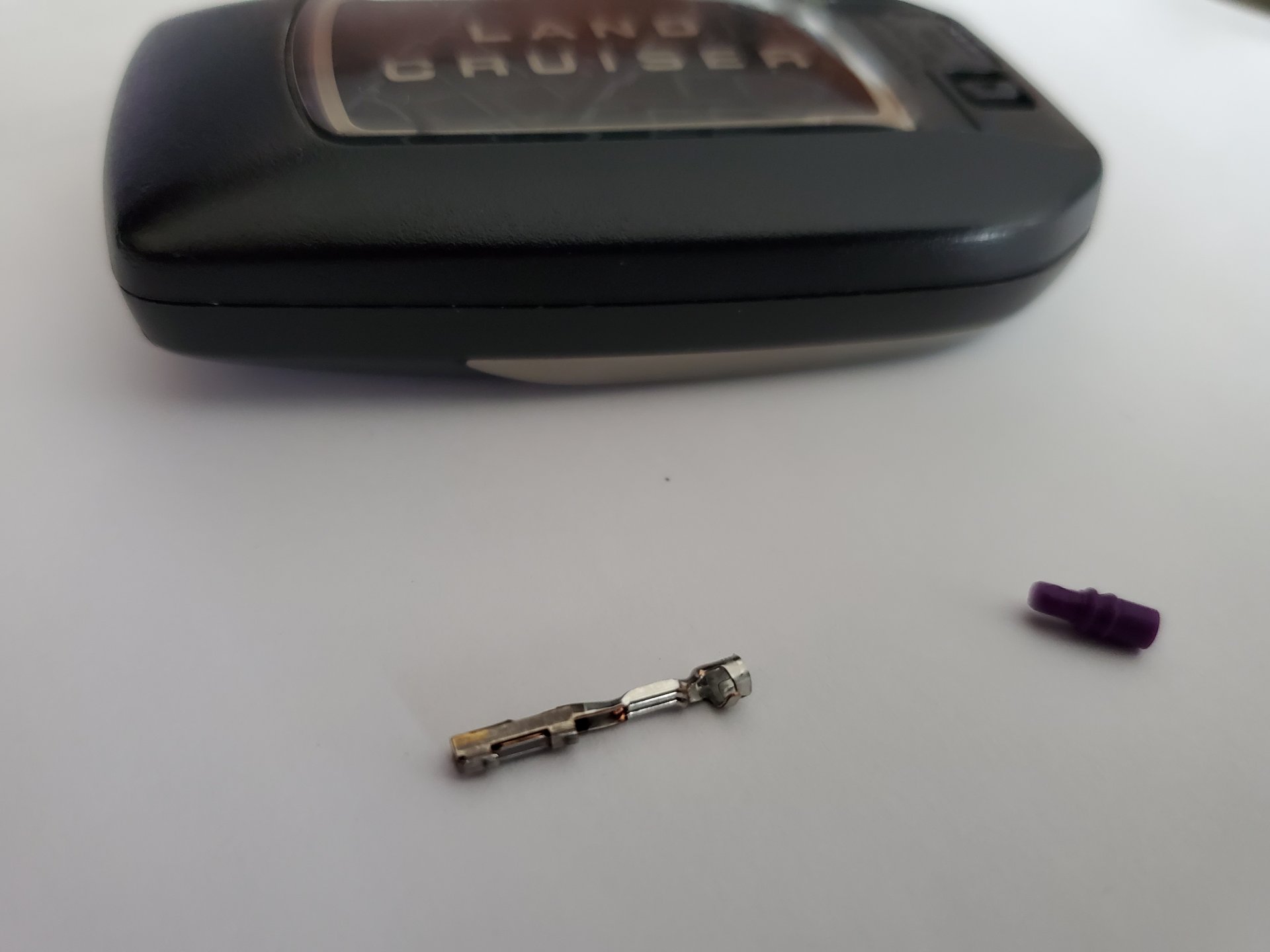

I am certainly not an electrical expert. . . probably just barely competent in the basics. From what I can see, it appears to be a relatively straight forward strand wire crimp job that requires the correct tools. That said, I don't know what I don't know. I'm just keeping my eye on getting it fixed without replacing the entire harness. Below is a pic of one of the female connector pins (there are 2) in the connector housing. The wires just got stripped/pulled out . . .
That looks to be a standard toyota terminal but it’s hard to tell for sure without seeing it in person. I believe the grounding trickery I mentioned earlier is on the airbag-side connector, not that end, so it is plausible it’s standard. I’ve used toyota repair wires that come with the terminal and wire already crimped, and you’d solder/crimp that into the harness.
In this case finding the bare terminal and correct tools would be better. I don’t have access to the FSM at the moment to see if that stuff is available.. I know it talks at length about using the repair wires.
I'm going to keep my fingers crossed and hope the mechanic I found knows how to proceed. I do appreciate all the info and learning opportunities the members on this forum provide. This is an excellent resource. Thank you!

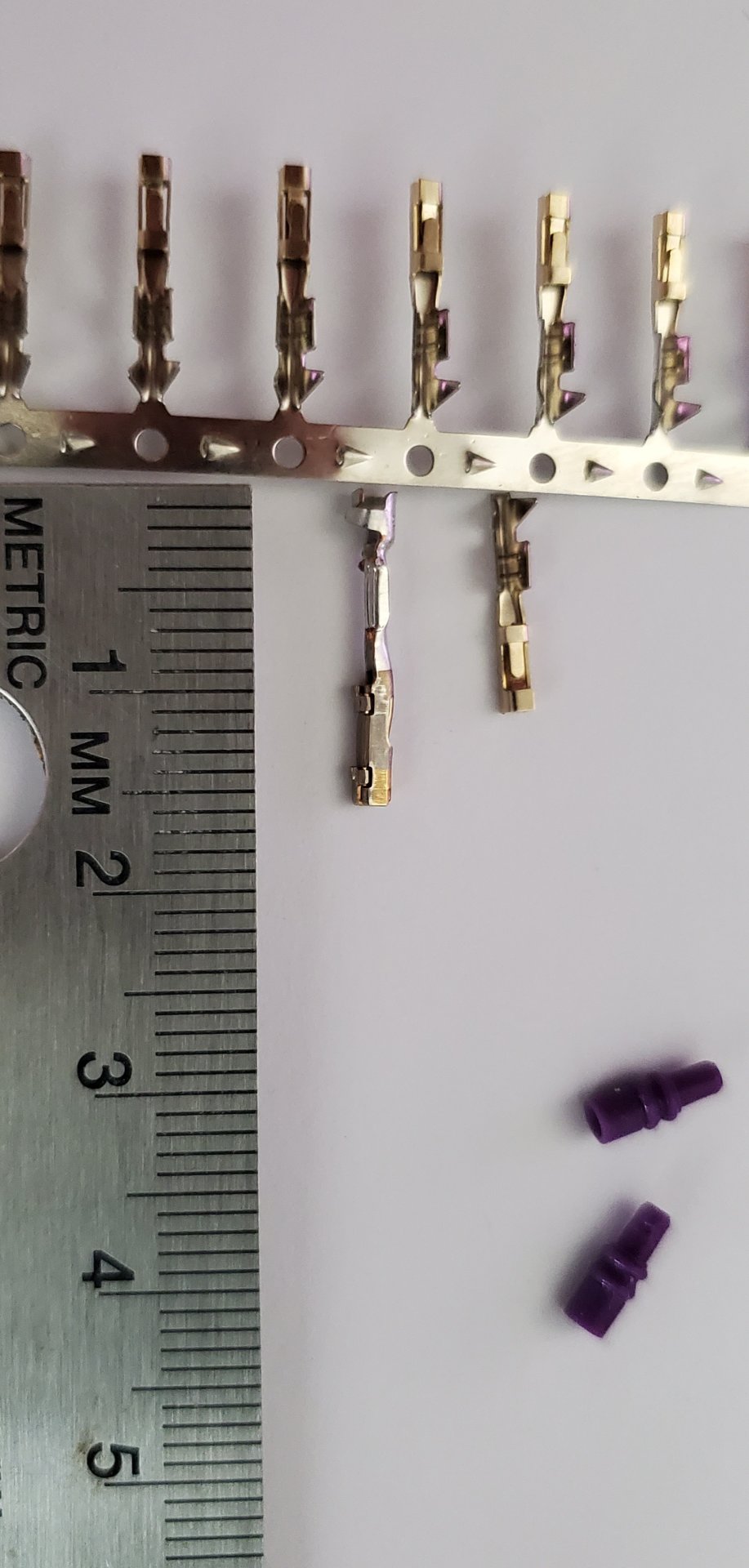

UPDATE #2 - Mechanic I found to re-attach the connector housing was unable to re-use the terminal lance connectors and/or locate correctly sized replacements. The mechanic said that the lances they could find were either slightly bigger or slightly smaller. The mechanic assumes that Toyota might make these difficult on purpose because of liability concerns with the safety systems, etc. As of now, I think that I have to either find a used harness to pigtail into the connector (I think the Sienna uses the same connector housing), or replace the entire harness. I prefer to just replace the entire harness, but I haven't yet been able to find the part number to even price that option. Toyota wants $$$$ to do this for me. If anyone has any part number or suggestions on searches, I'd appreciate a point in the right direction.

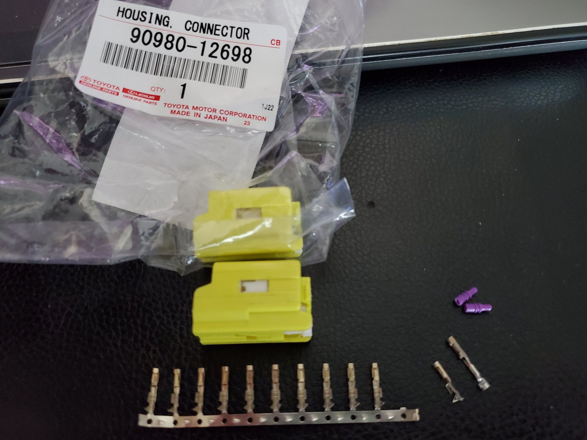

I was considering that. I found out that the same connector is on the Toyota Sienna and I suppose I could be able to cut off the wire on an used harness and pigtail it, but the mechanics I spoke with suggested that as a last resort only. I was able to order the connector housing from Toyota, which makes me question why I can find/order that (presumably for repair purposes), but not the lance terminals that fit into the connector housing. I was hoping that we could re-use the lance terminals, but they are so small that repeat crimps might make the connection fittings unreliable.
I’ll see what j can find in the FSM as I have time over the next couple of days but I can assure you you won’t want to pay for a harness. It goes from one end of the truck to the other.. then back up the opposite side. $$$$. And effort, to pull that much carpet and trim. Still, If you post your 12-digit chassis code I can try to dig up the part number.
