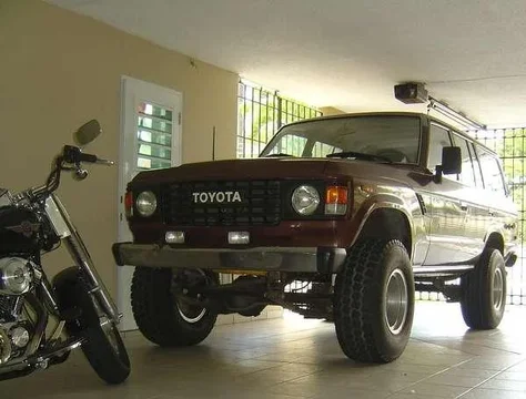

I just found out today that I have a 4.5" lift on my cruiser. It consists of Man-a-fre safari springs +2.5", man-a-fre extended shackles +2", extended sway bar links, nitro 9000 shocks, and OME steering damper. The setup works great! The only thing I don't like is the poly bushings because I have to be constantly lubricating them, if I don't they start making cracking noises:popcorn: . I could easily fit 35" tires. I currently have 33" tires. I have no driveline problems(at least that I know of.) I am gunna see if I can test it on a flex ramp this week.:cheers:
