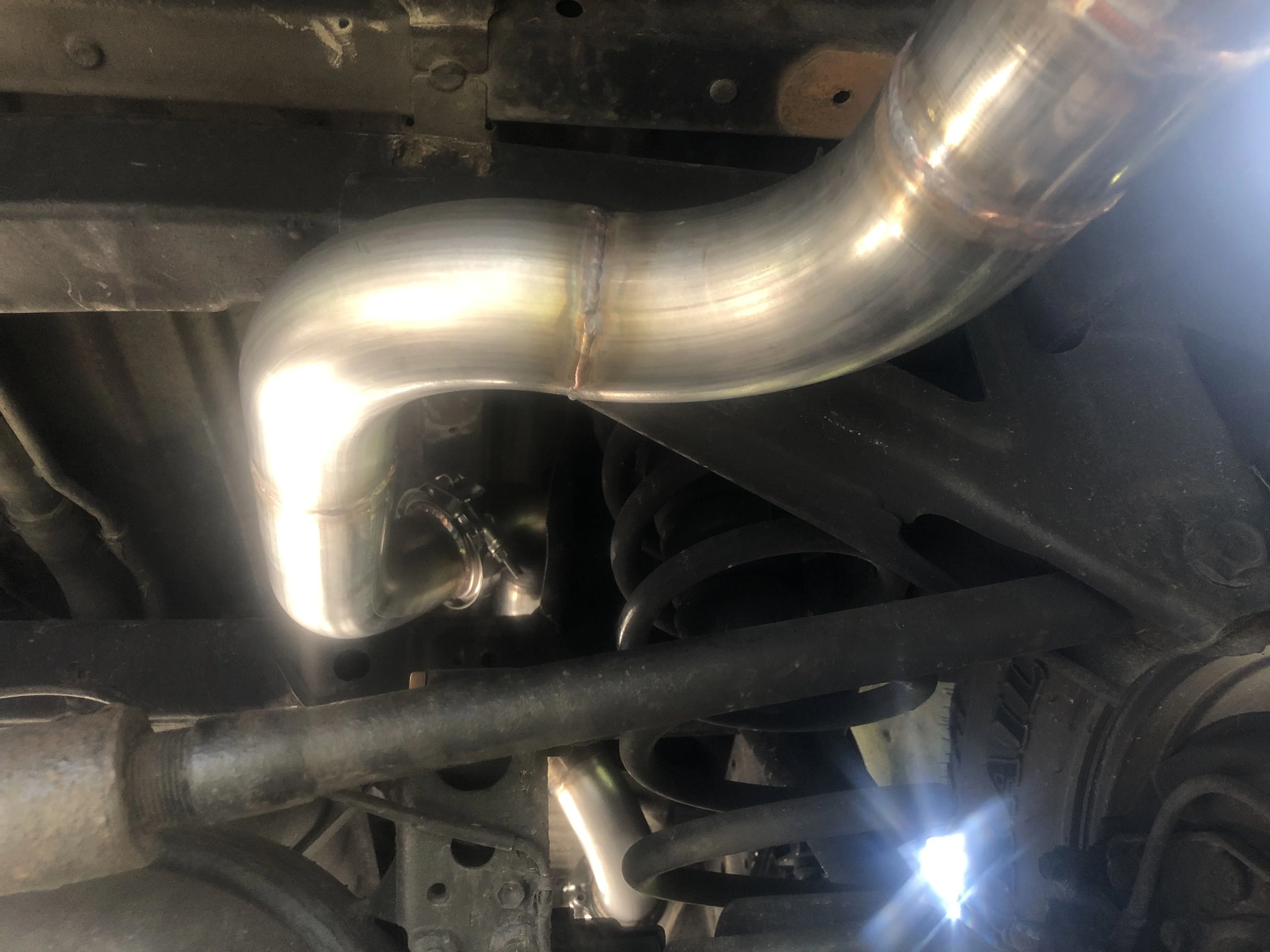

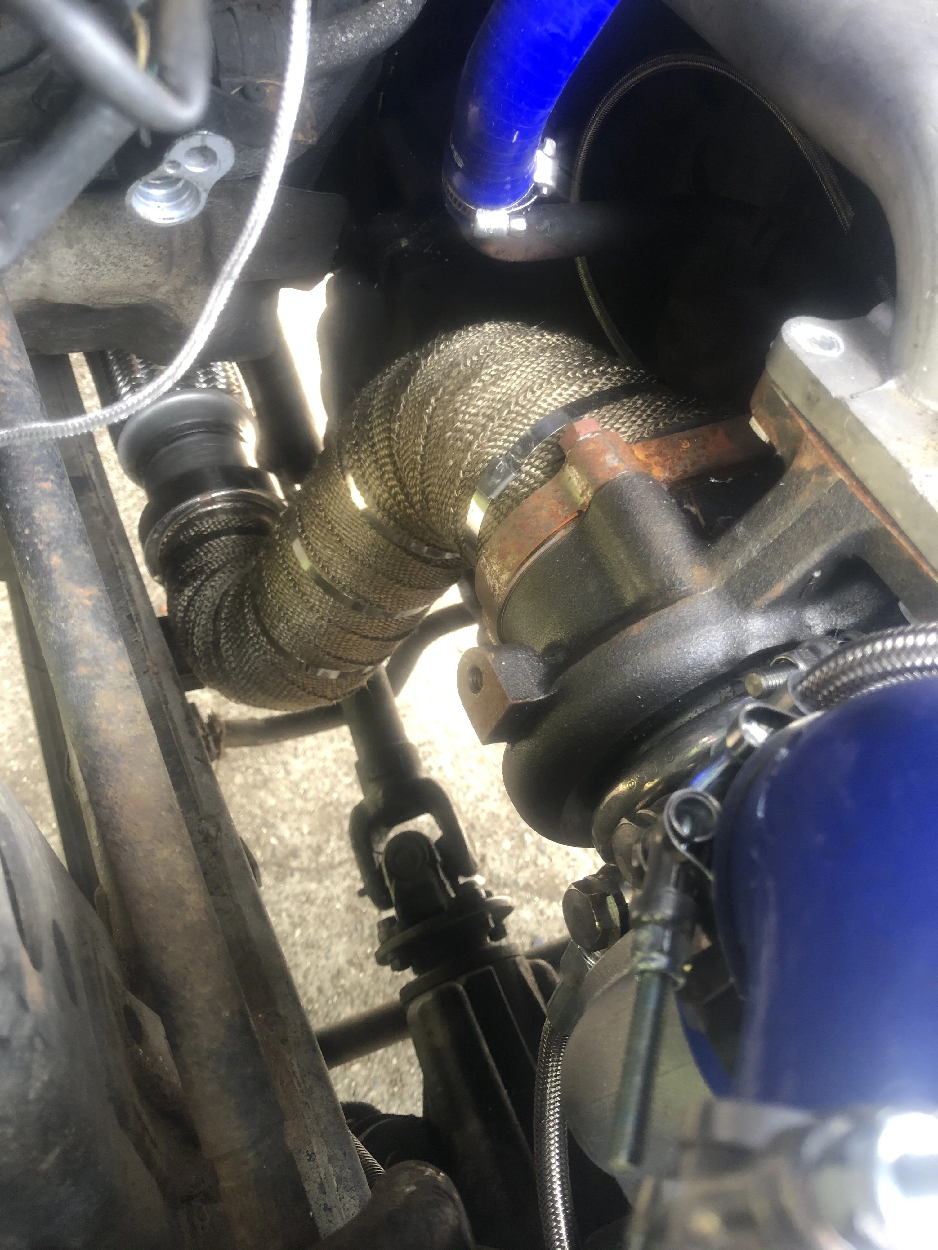

On both my HDJ81 and HZJ105 I used 4"pipe from turbo to T-case.
Initially tab the HDJ81 with no mufflers, but with the 4" pipe it was too noisy, so added mufflers.
Some pics here
