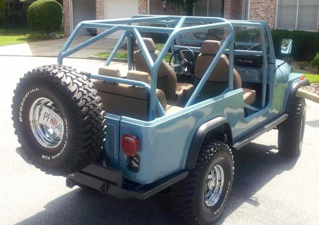

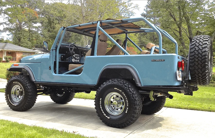

I did this in my CJ8. As @steffan said, you'd need to fabricate location points. I like the bar behind the seat as opposed to beside the shoulders - unless that tube is far enough back that tube can NOT be a contact point for heads. The front shoulder harnesses are on the side/upright tubes but those are far enough back to avoid head-to-tube contact.
We ran a cross bar behind the seat for the two shoulder mounts. And yes - it did reduce the utility of the bed when that seat was out or folded forward, but safety was the main goal.

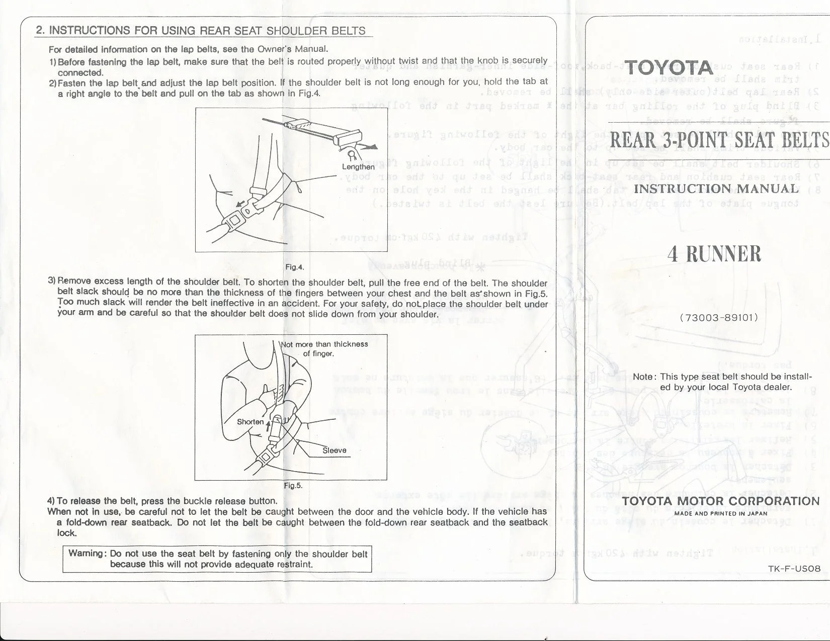

Wasn't really a conversion. Factory, and factory option. My 1985 came with lap belts in the back only. I was able to purchase the shoulder belts from Toyota. They attached to the bungs on the rear roll bar. I have also seen them on boneyard trucks.
