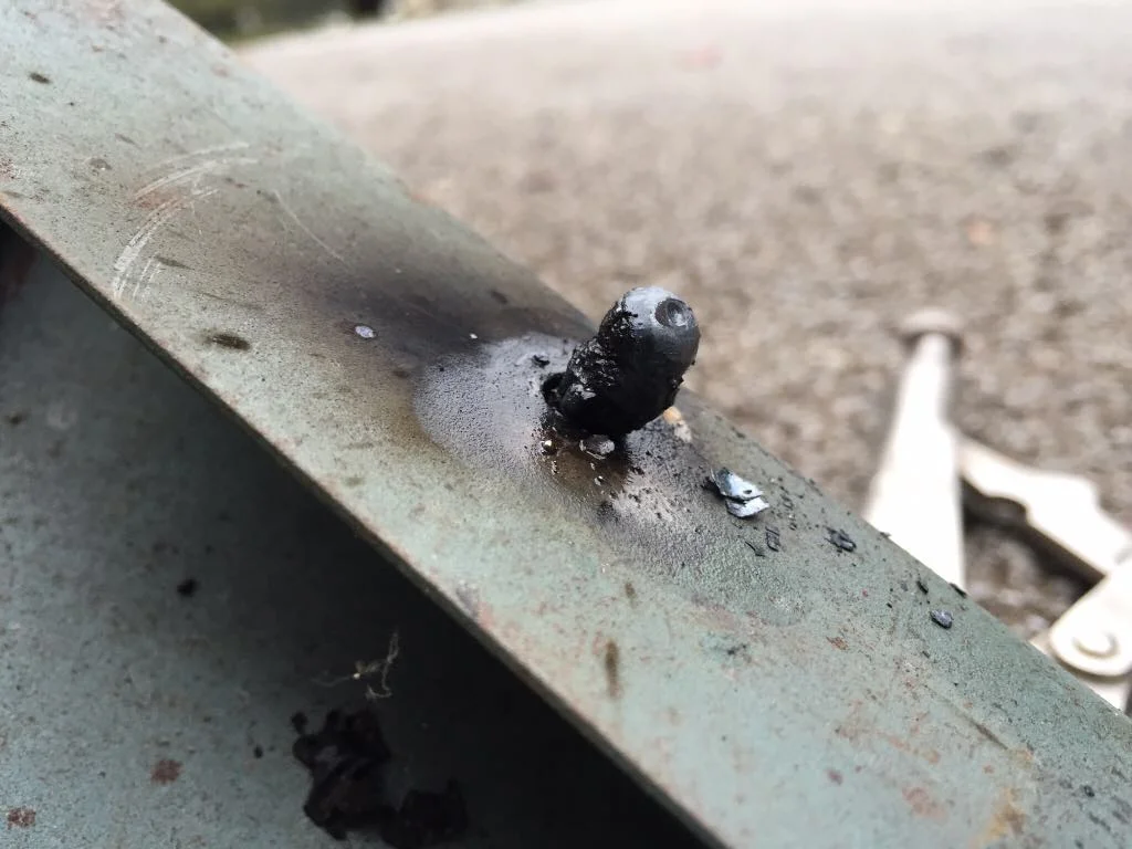

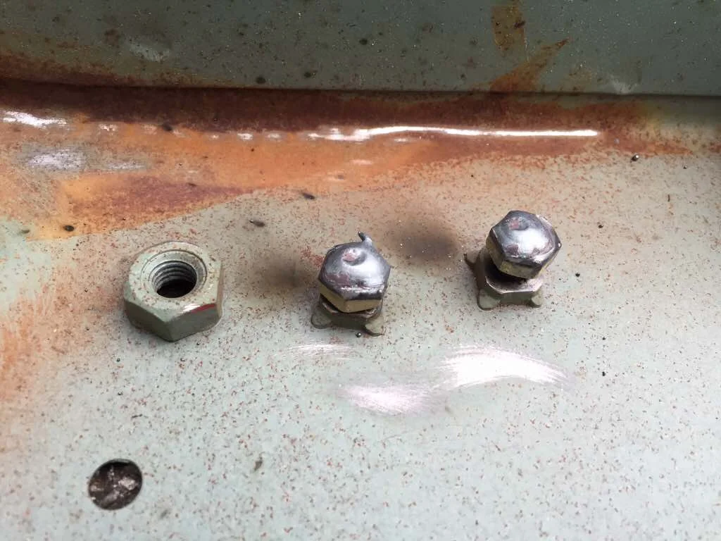

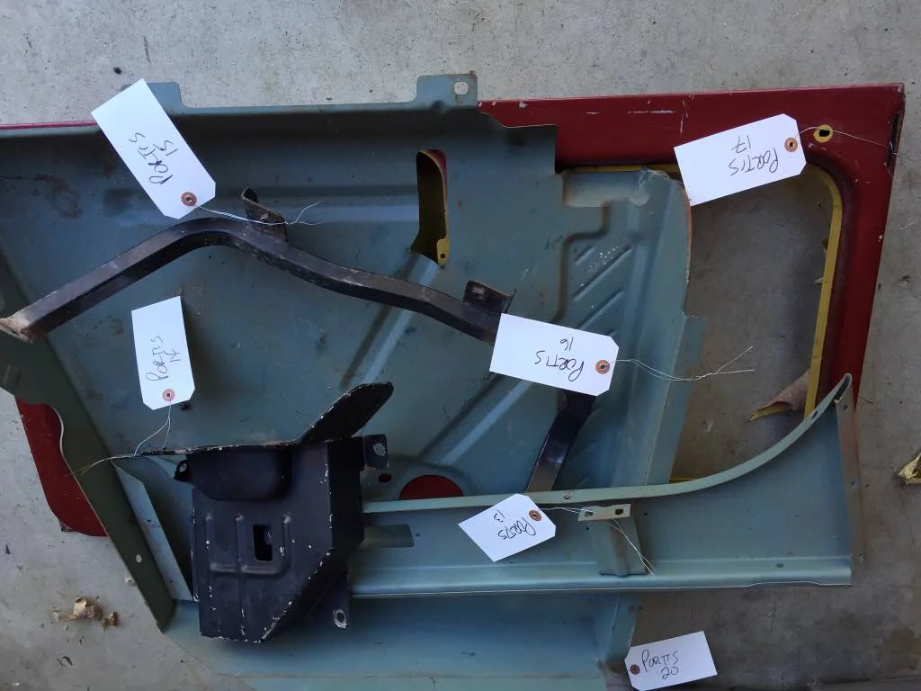

A few remained with broken bolts so last weekend I attacked those.
Welded nuts on some
Built a few short ones up and used vice grips on them.
I was able to get all of the broken bolts out pretty easily.

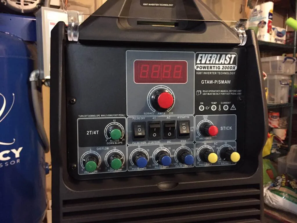

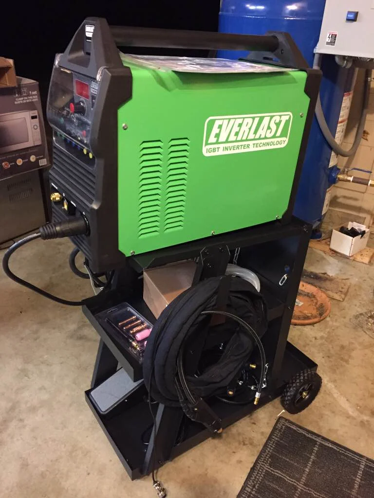

I think I'm going to try to TIG weld the body panel repairs instead of MIG welding them. My TIG welding outfit is not the best, so I got a new welder! I ended up getting in Everlast unit which is foreign-made, but it's reasonably priced and like Datsun Toyota Subaru and Hyundai, the quality has improved over time.

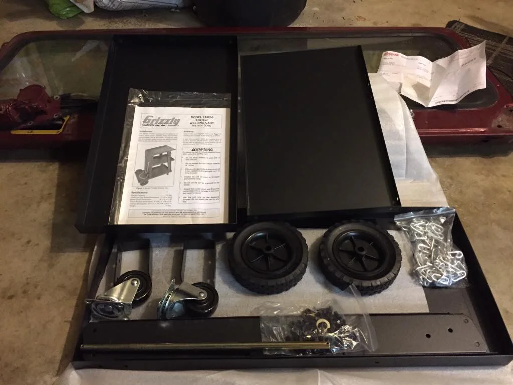

Here's a couple pictures of what goes on at welding cart that I teased about above.

This is my first ever brand-new piece of welding equipment. Everything else I have purchased has been eBay or craigslist. It's all worked but it's all been pretty rough stuff. This is a really nice welder that I'm looking forward to doing TIG work with. I can also fix some of my restaurant equipment that is aluminum which I could not do with my DC only Miller unit.
As I said in the previous post, I've seen a couple of forum postings on the Internet about doing TIG welding for the body panels it's supposedly a bit cleaner if I can get a real good fit up on the panels.
We shall see. It should be fun! (that's sarcasm, I'm really kind of dreading it.)

Just because I know very little about welding - but will need to learn (and buy one) eventually. Why would a TIG unit be superior to a MIG for body work? Hopefully this doesn't spark a "MIG vs. TIG" debate, just wondering what guided you toward the decision.

I have the PowerPro 256 and love it.
Awesome welder! I tend to use mig instead of tig for auto body work. Mig is a lot more tolerant of contaminants on the metal.
Whatever you use have fun!
the biggest issue about doing MIG for body-work is you get a harder weld - it's not a huge deal, but you have to be careful about warping both in the weld and in the grinding smooth... that said, I can't remember the last time I TIG welded a body panel on. That said, I was TIG welding tonight on a stainless bracket - so it's not all obsolete.
Inverter welders are cool - I've seen those, but refuse to be a guinea pig to figure out if they're a good buy or merely another welder company that comes, goes bankrupt and leaves you with a welder you can't get parts for... ESAB survived and has thrived but every every ESAB there are hundreds of companies that didn't make it.... heck, even my dad produced and sold a welder in the 70s.... that company didn't survive either
I don't think it is superior but I think for these long welds it may be a good solution. This is the forum article I was reading that intrigued me: Tig welding body panels - No hammering method - Metal Meet Forums
Inverters seem to be a new category that all manufacturers are adding to their product lines. I don't understand all the benefits but there are several nice features about them.
they are easier to control the heat which gets you better weld-quality. Plus, you can also get those nice, stacked dimes with even pirate-level of ability ;)
simply put - the welder varies the amount of energy put into the weld, thus it welds/cools/welds/cools and by doing that it can put more energy into each pulse without blowing through because there's cool cycle in-between. With older welders, they use large coils which do not give it the same ability to vary the frequency so quickly (square wave vs. sine wave).
computer vs. old school.... the big issue, prior to these welders was the inability of the chip to handle the energy... now they can, so they're a lot lighter as well...

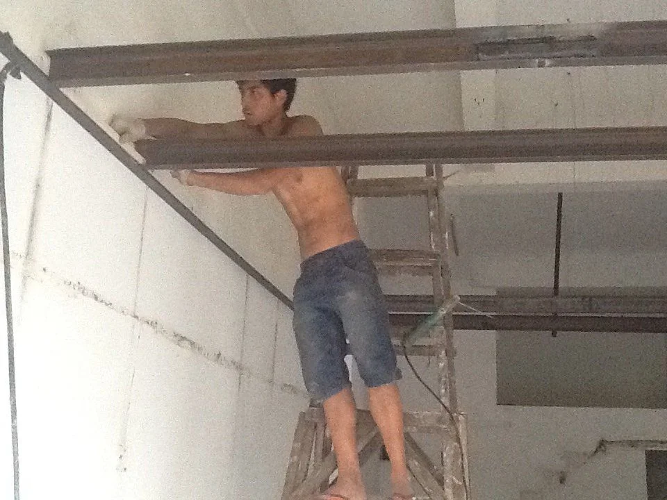

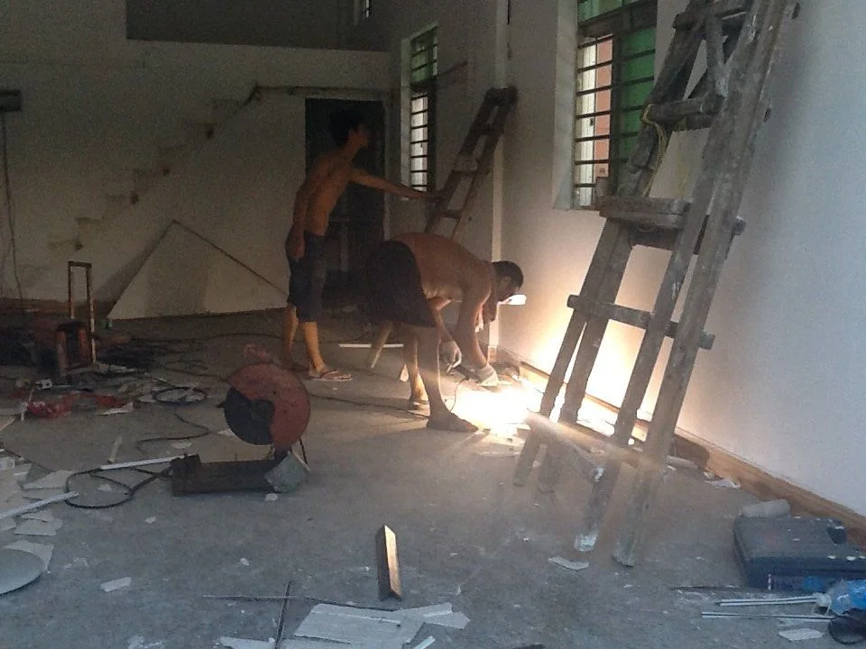

Just back from China and I was watching this China guy mig welding 0.5 mm mild steel sheet . He was making shelving and what a beautiful job.
His wire size was 0.35
One the other side of welding in China check this guy out.
He is building a mezzanine floor for me.
No need for welding masks with these guys.
The guy on the ladder had just stopped welding when I took the photo.
Must have thick skin as molten weld on the skin did not seem to worry.

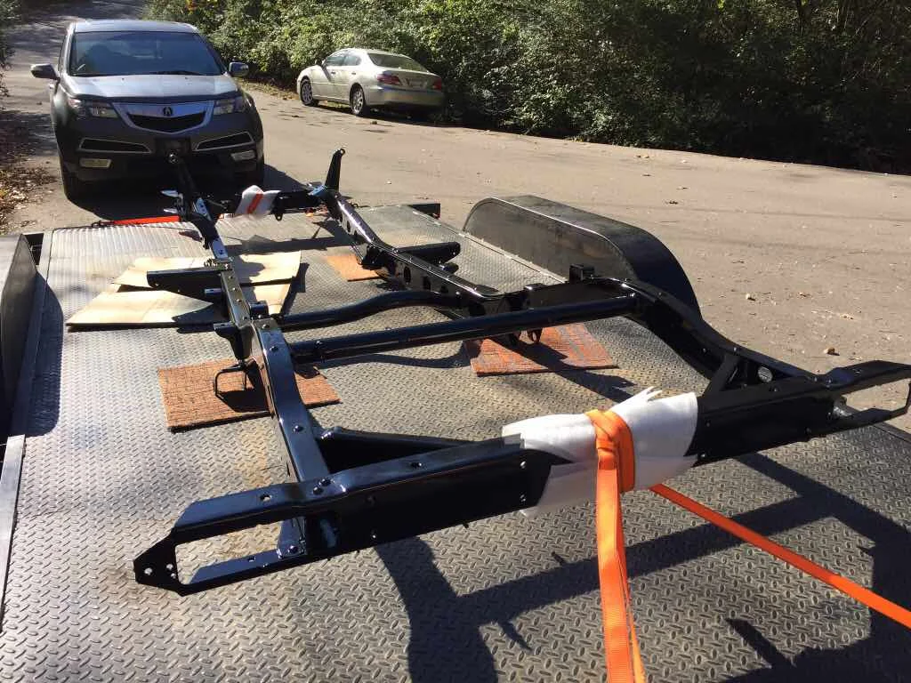

Here is the next installment of news: picked up the frame today from powder coating. This is another "big moment" as I can now start actually reassembling the truck. Looks great - very dusty in the photos but the finish is better than I hoped.

FYI - the welding stand seems common here in US. Go to Amazon.com and enter "welding cart". This one is a Grizzly unit. Good maker of power and shop tools here. Good cart - $100.
