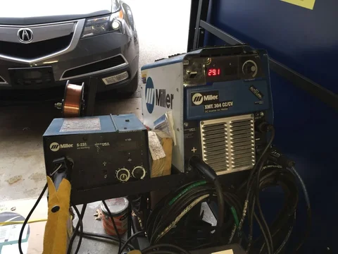

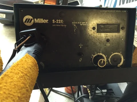

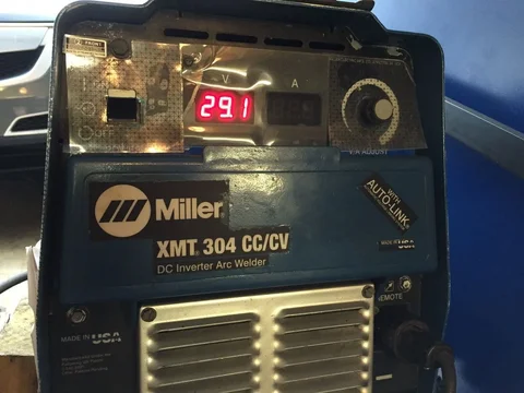

Here's the welder. Miller XMT 304 cc/cv, and a Miller S-22A wire feeder.
You may have to increase the wire speed some to balance out the heat input . Need to see some butt welds and I suggest beveling the plates a bit . Need pics of both sides, want to see how much heat input you're getting and width on the other side . Keep watching Jody and learn about gun angles paying most attention to nozzle distance and angle of attack . Pull or push depends on you, arguments as to which is better are as old as the process itself .
Have you verified you're running dcep ? Is the machine set to straight polarity or reverse ?

Something is really wrong here - you're not getting hardly any penetration at that voltage and wire speed . Try turning down the wire , increase gun angle a little bit lower and stay ahead of the main bead a lot more - need to be on the leading edge of that puddle , not in the middle . I'm wondering if your power unit is getting full amperage or has a bad leg on one side of the input that is restricting it's output . Like I said , not totally used to using voltage vs amps for an output setting - need to see if Miller has a conversion chart .
I assume you are using 220v , pretty much have to with the XMT anyway . I know you had to repair a board , was it anything associated with the power section ? At 35v , it should blow large holes through 3/16" steel nearly regardless of wire speed - should be running extremely hot but it isn't . The only other thing I can think of is it's running in Constant Current mode versus Constant Voltage mode - which is what is needed for mig work .
Maybe I'll track down the user manual for the XMT - need to do some reading as I'm way more used to stick and tig work .
Sarge
Just read through the manual for the XMT's , seems it has to be set for remote feeder and automatically runs in CV mode so that should be covered .
What gauge is the ground cable ? Checked for corrosion or burning at the welder plugs/cables ? Trying to figure out why you are losing raw power output - the XMT should be able to fry that steel and it isn't . I hope the short circuit issue it incurred didn't wipe out part of the power board on the step-up side as that can happen and it's the most expensive part of an inverter machine .
Just for fun , got a stick cable and stinger around ? I'd be curious to see if she can still stick weld or not properly ....?

It's in CV mode? Hmmmm. So when I adjust the voltage, it stays constant and the amperage adjusts based on what? Always wondered how that works.
Something is wrong or wired incorrectly - the welding calculator is calling for around 21-24 volts with 75/25 gas mix and 360-380ipm on .035" wire for 3/16" steel . Amperage range is 180-190 also . At that power , it should easily weld all the way through 3/16" steel and it's not even close .
Either you're moving way too slow or something is wrong with the machine , I'd suggest having a second pair of experienced eyes on it if you can ....mostly checking machine settings .
