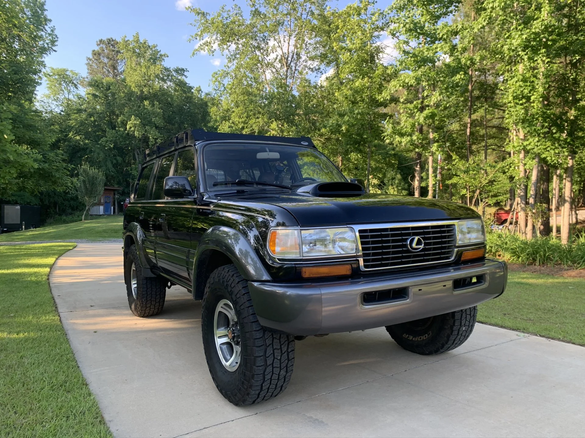

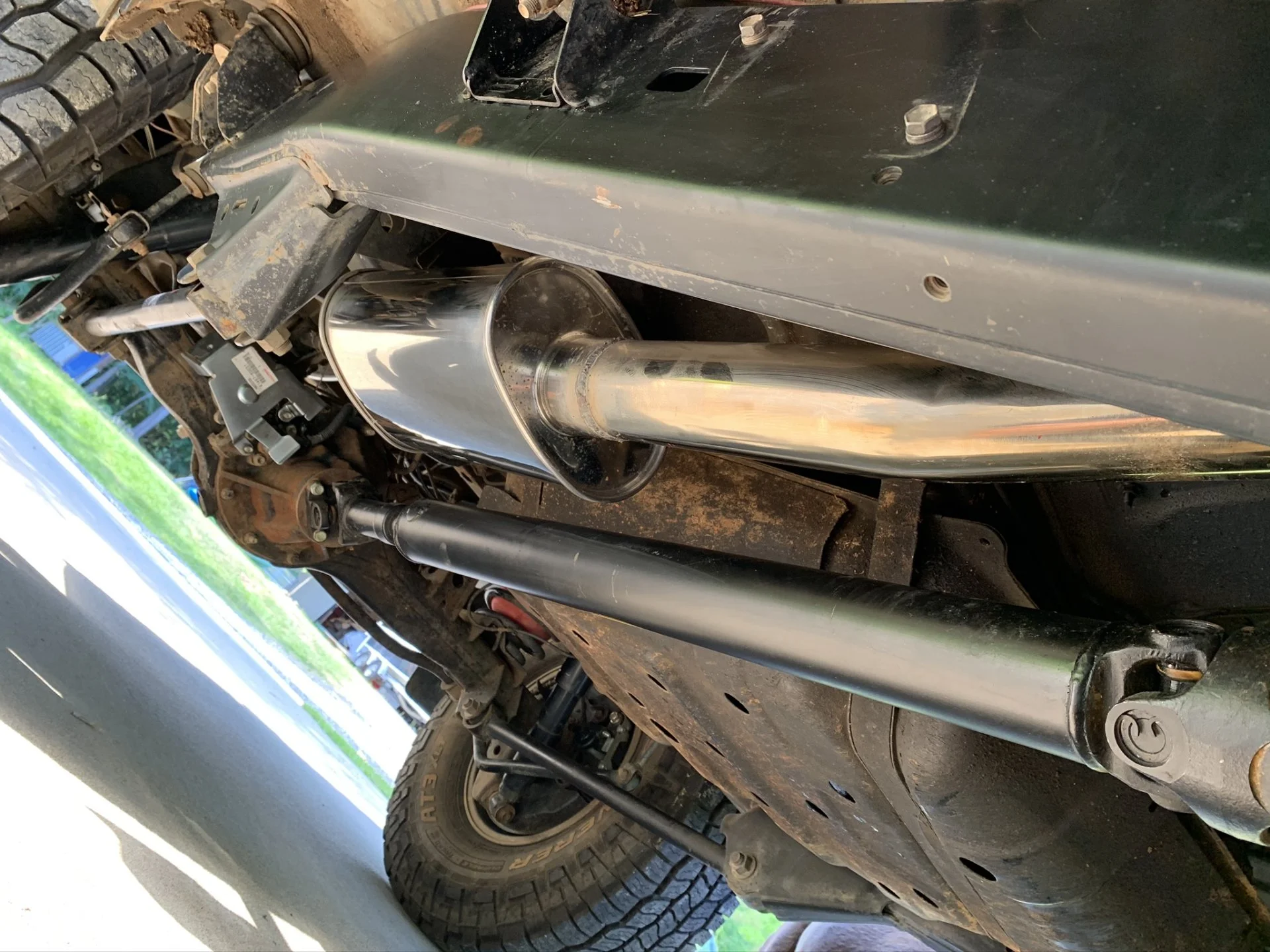

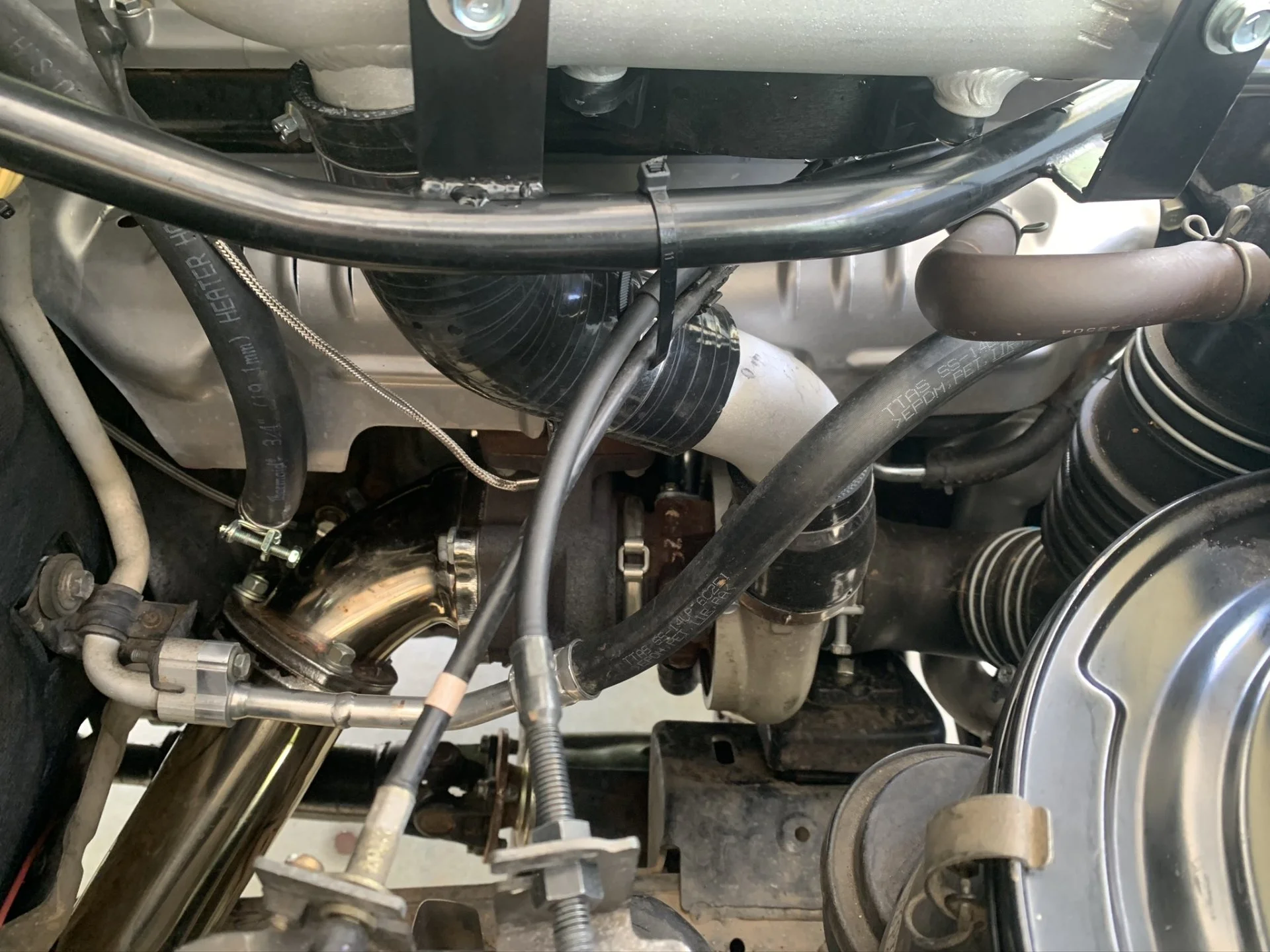

I swapped a brand new 1HZ/H55 into my 1997 LX450 with a turbo running 10-12psi, intercooler, 3” free flow exhaust, etc. it was great on backroads and especially off-road but fully loaded for a trip with the wife and kids trying to keep up on the interstate was WORK. If I’d had it to do over again I’d go 1HDT or 1HDFT so much more potential for safe reliable power with the DI diesels.
Biggest upside in my opinion to the 1HZ is it’s still in production today so parts should be available for a long time to come, the 1HDT hasn’t been in production since the early 90s so parts can’t be a little more tricky though it does share some basic components with the 1HZ.
Wow, that is a fantastic conversion. You've got a functional hood scoop and everything - well done!
