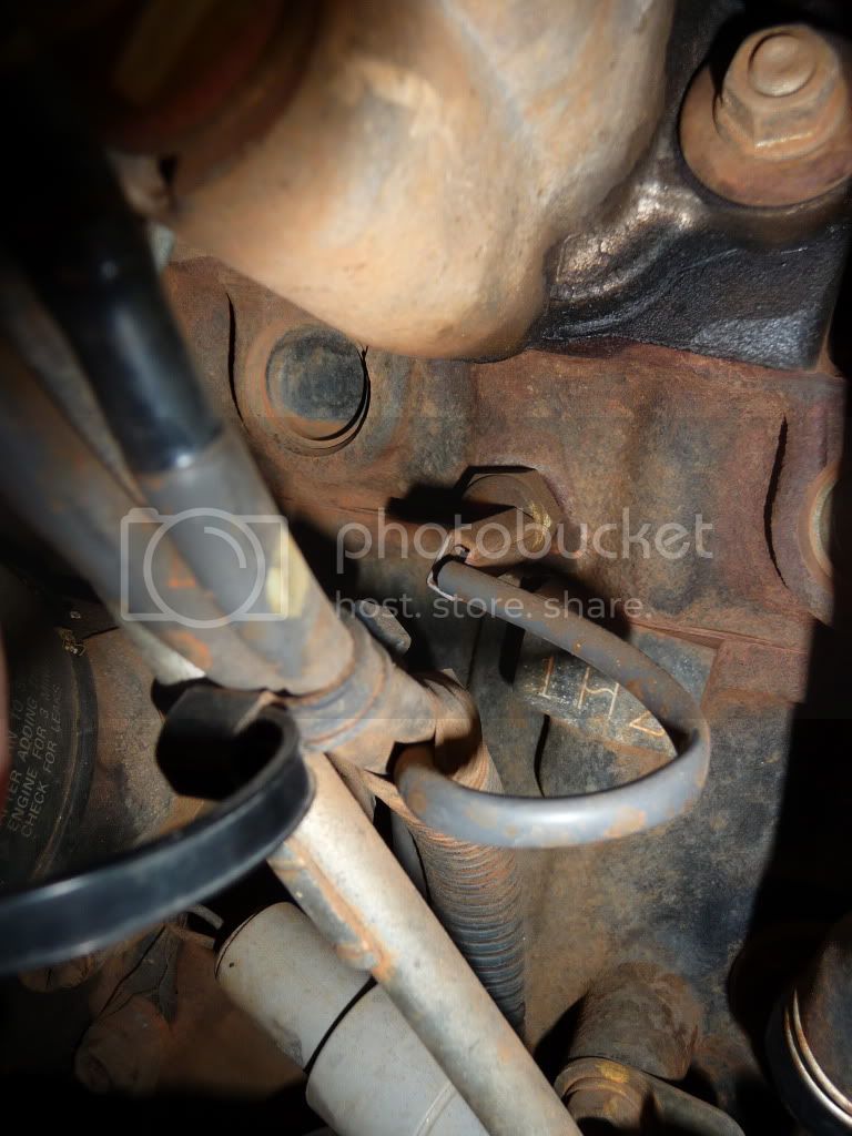

Mine is not in the oil cooler or the coolant outlet housing
I just went and took a pic for you .
It's in the head behind the oil filter .
I thought it was in the oil cooler but lynchmob's post above made me go have a closer look it not in a very visible spot .
