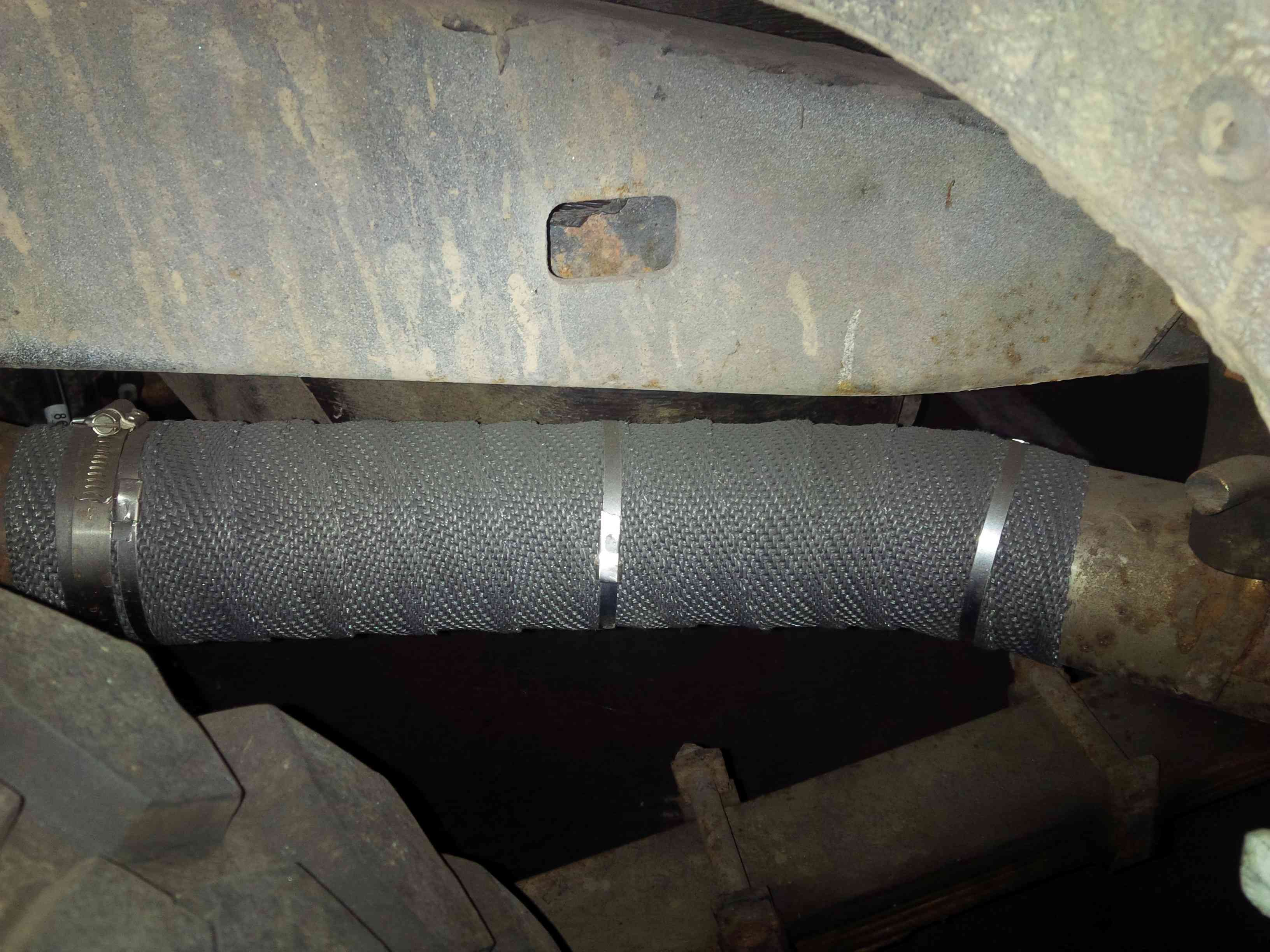

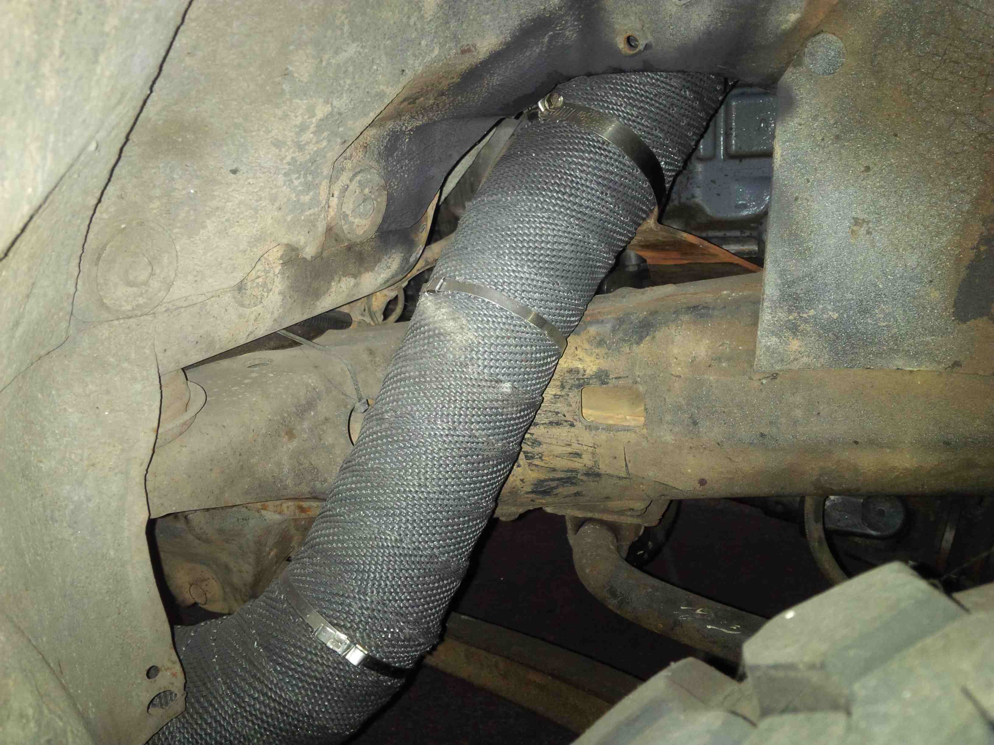

bit of an edit to the exhaust system, added a wrap from the turbo past the footwell. i will be covering the wrap to protect it from crud once she's on the road again
the leftover wrap went beside the rear fuel tank, which i re-routed closer to the tank to give more room for airbags on the rear springs.

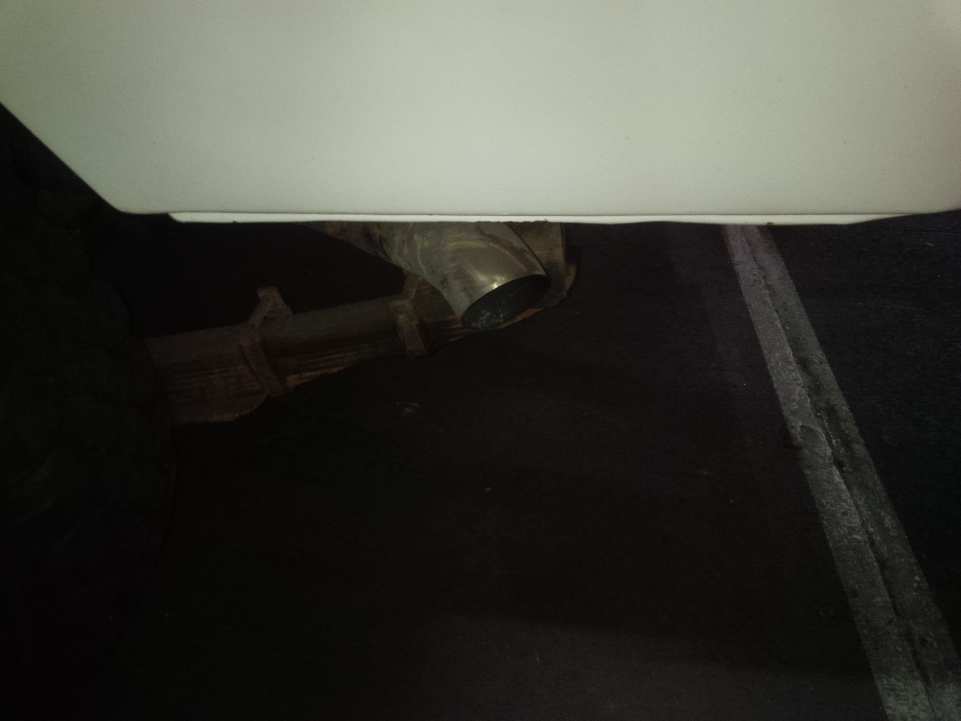

the exit is angled out the side to keep the exhaust away from the rooftent annex hanging over the back entrance, so i can run the motor when camped up... the cooking annex will be on the other side of the vehicle as well.

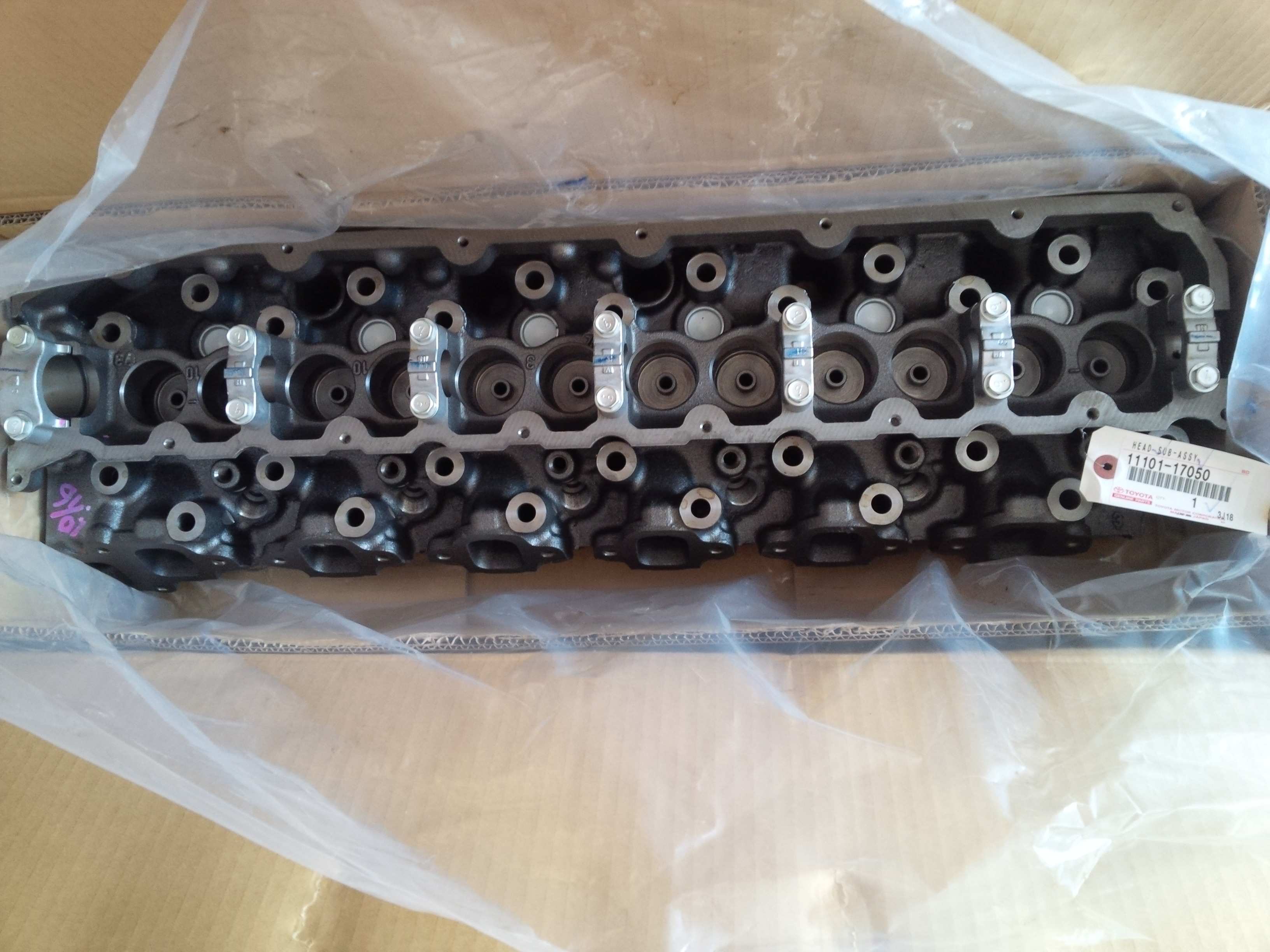

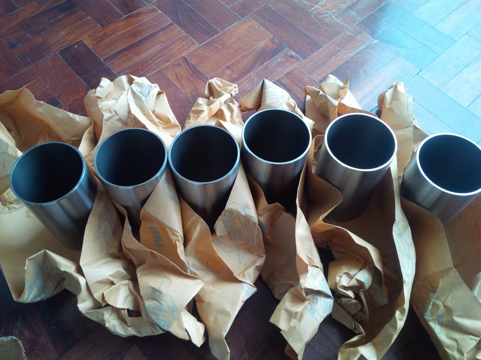

how naive of me to think things would be go smoothly, 4 months after dropping her off, the rebuild has only just started this week. to cut a long story short, some measurements by the machinist were communicated incorrectly and i ended up importing the cylinder sleeves twice, after the first ones didn't fit, the second set had to be custom made that took the factory over a month to forge and only arrived last week. I had these centrifugally forged from A536 '100-70-03' ductile iron by PowerBore in Salem, OH.
Previous to that I'd been collecting practically everything to replace everything but the big bits, many thanks to Yan (@Akella) for helping me with all the nuts and bolts (literally).
I don't think i detailed it here in this thread, but i decided to abandon the AXT turbo kit and further performance enhancing, and I ordered all the parts to retrofit the OEM 1HZ-T turbo and keep it's performance relatively stock. Here's some photos of the unique OEM 1HZ-T turbo (17201-17020), once i get it installed and dyno-tested I'll post up a parts list to do the entire 1HZ-T turbo conversion with toyota parts, which starts at the airfilter lid and includes air, oil, vacuum and vent hoses amongst other bits and pieces.
thanks to Yan for this photo, this isn't all the bits required, but alot of them
