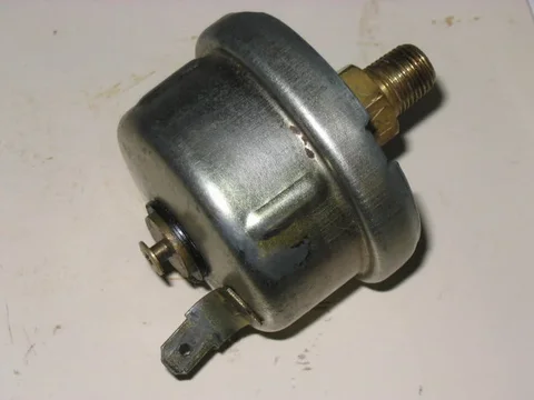

Hey, you beat me to it!!! From the description, my spare is exactly the same as yours... How is the contact fitted on the can connected to the sender itself? Do you happen to know what the manual specifies for the resistance range, by any chance? Could you post a picture of your sender? Here's the spare I got...

My sender is exactly like the one in your pic.The centre contact connects to the circuitry by a spring-type contact.The same idea as used on the centre post in an old type distributor on a petrol engine so you can twist and turn the top cover to free it without breaking any wires etc.
Couldn't find any resistance values for the sender in my manuals.It gives a value of 22-28 Ohms for the gauge itself as measured between 2 terminals on the PCB of the instrument binnacle.

I think the outside contact is connected to the inners (the actual sender) by means of a leafspring, sitting on a contact point.
At the time I took the old sender apart I was not able to get the cap off without distroying it too much. So I could not trust the refit.
But I don't know or there are other kinds of senders with a different kind of notching. Mine was all around. All this is as far as I can remember having it taken apart 6 -7 (?) years ago.

I reckon it would be very difficult to adjust the sender with the whole thing assembled even if you drilled a hole in the right place which would have to be on the side and not the top as adjustments are made by turning the small plastic wheel via the teeth on the outer edge.If you were trying to adjust the thing with,say,a small flat bladed screwdriver it would be very easy to damage the contacts or maybe break one of the wires if the blade slipped off the wheel.
I adjusted mine off the car by connecting it up electrically with a long length of wire and connecting the pressure inlet to a pressure source (I used a bicycle tyre) set to whatever pressure you want,say 20 or 30 PSI and with the ignition turned on just turn the adjuster wheel in the sender to get the OE gauge reading where you want it.

OE OP sender (1HD-T/FT).
Turning the white plastic adjusting wheel moves contact A up or down which in turn alters the gap between contacts B and the position (or pressure) at which they close and hence the reading on the gauge.Hardest part is removing the cover but can be done and refitted with care.
