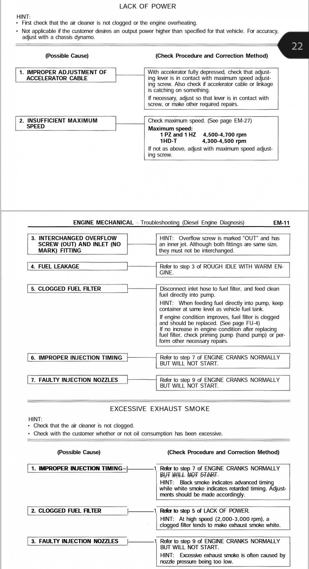

It should be able to rev to 4200 in neutral according to the FSM.

Ah, I couldn’t find it on the FSM but I see now, very helpful, do you know the part number for the OEM Toyota fuel filter and air filter? Cant seem to find it on the manual.
The air filter is 17801-61030 and its the same as a US 80 series. Fuel filter is 23303-64010
