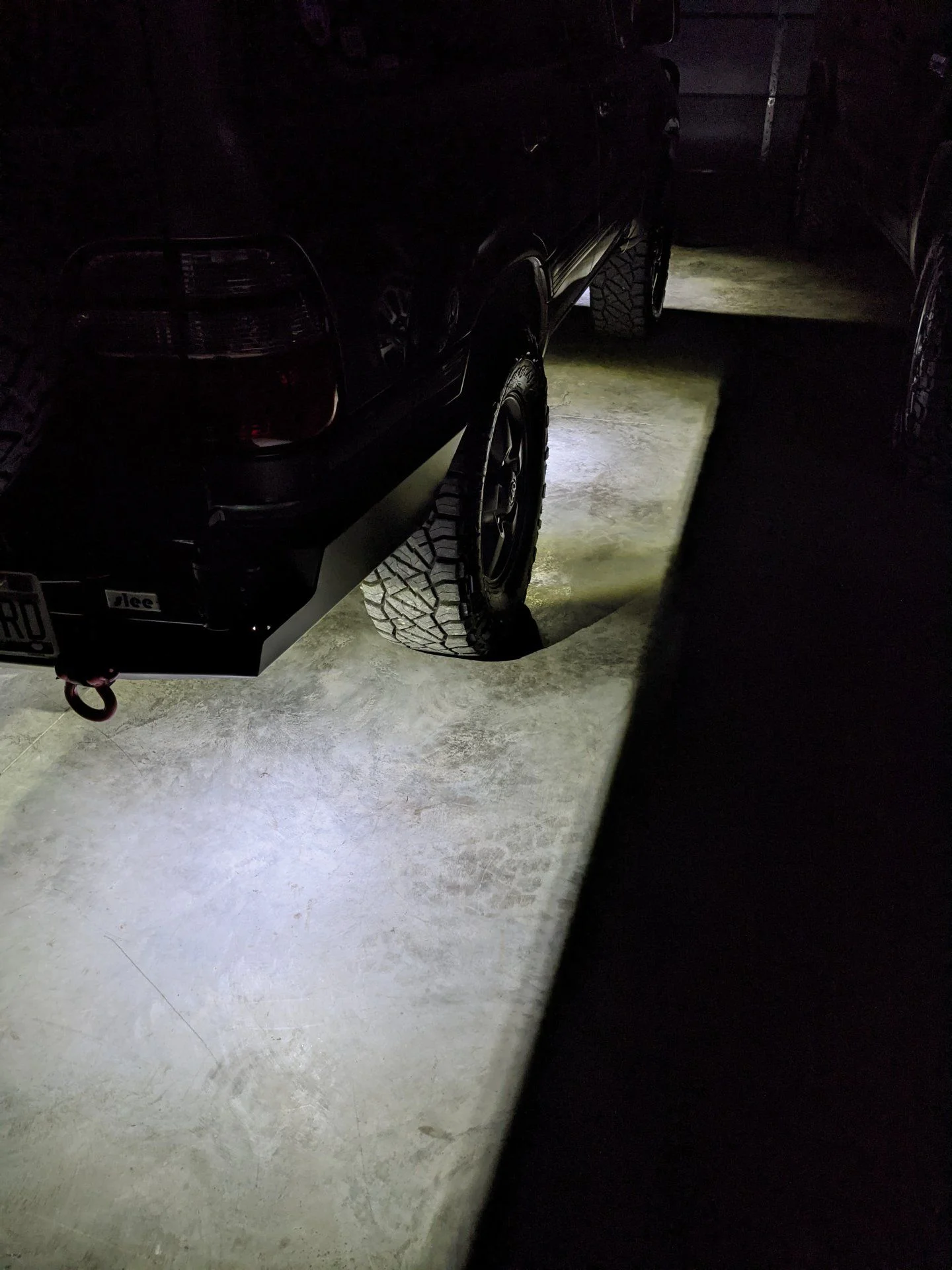

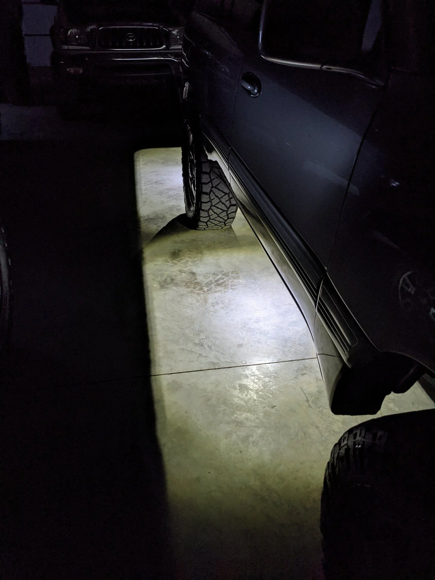

After dark I tested them and I like the pattern of the sides/rear but I'm not loving the front yet..

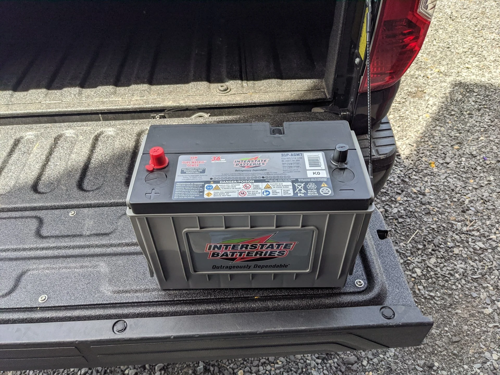

- I need to replace the primary battery... I'll go with an Interstate, just researching the models

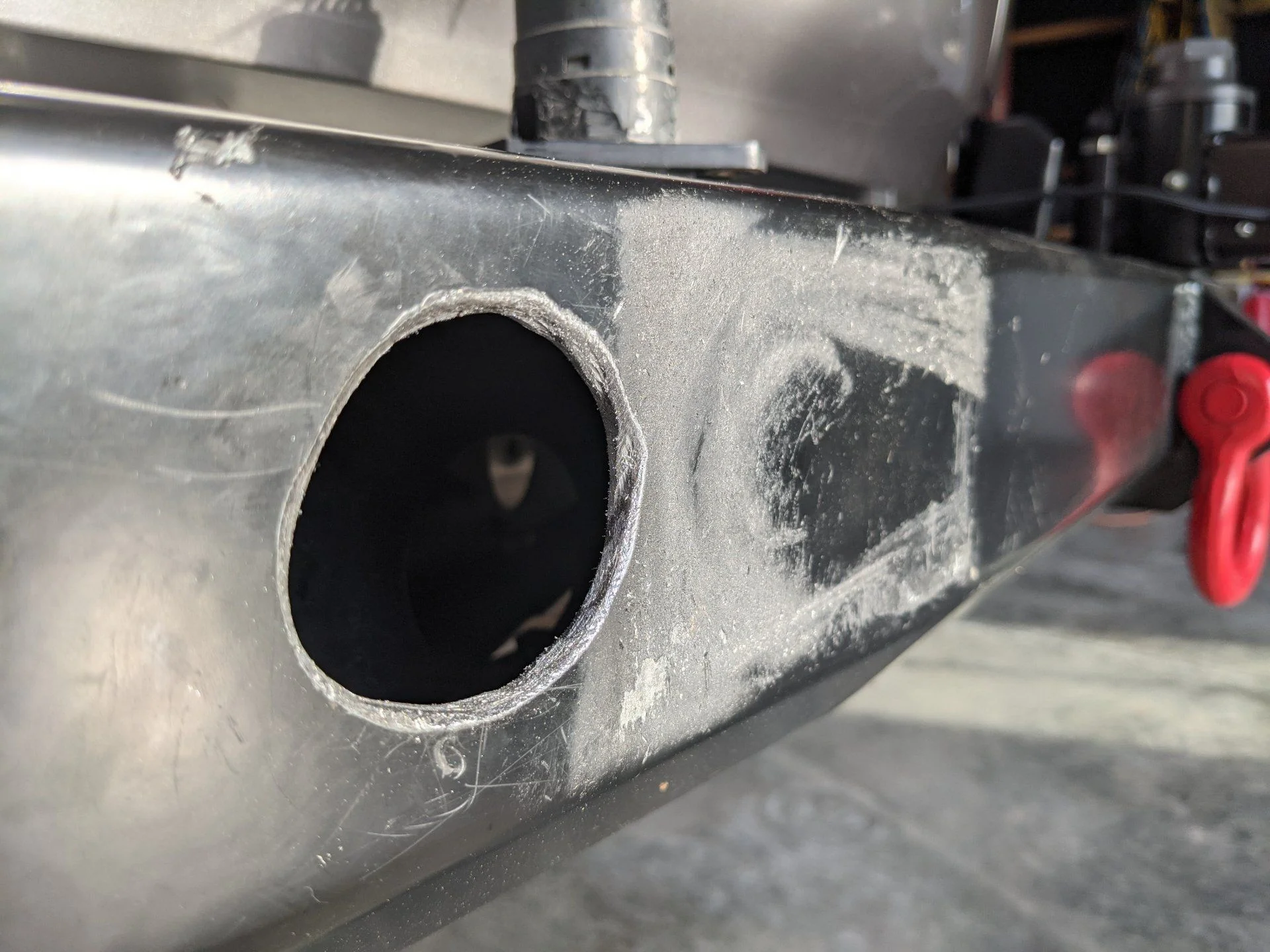

I had an appointment with a local fab shop to drill the hole in my bumper for the trailer plug.. He said he had a mag drill and it wouldn't be any problem. I dropped it off and told him that it's a fairly high-dollar bumper with powder coat so please be careful. I even gave him the opportunity to decline if he was uncomfortable with doing it. He reassured me that it would not be any problem...
Well, apparently all mag drills are not created equal or some people don't give a crap or something.. 🤬
He called me a couple of hours later and told me I'd probably need some touch up paint. The mag drill had "moved around a little" and "scratched" the powder coating..
When I got there to pick it up I figured out real quick this was more than "touch-up".. Totally unacceptable.. The drill must have been sliding around the whole time. The hole wasn't even round! What a mess... 😤

In the mean time I cleaned up the hole as best as I could with my step bit and file..
I'll get it all looking good I think but the worst part is that I won't have powder coating on that section of the bumper..

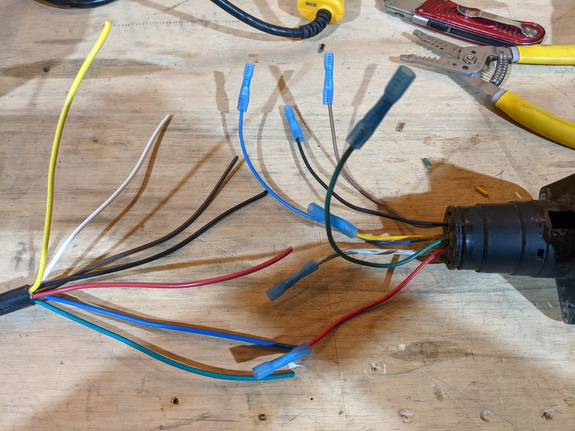

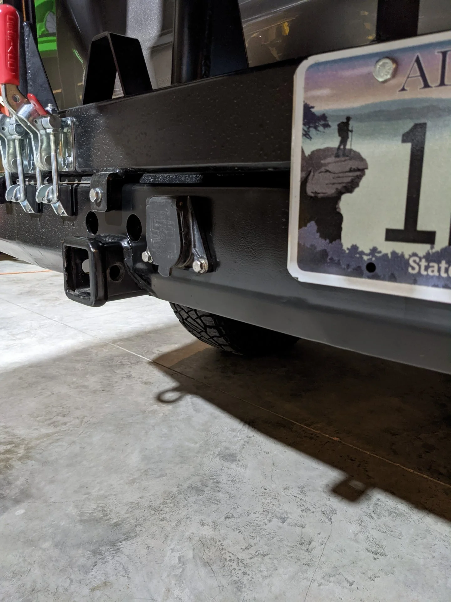

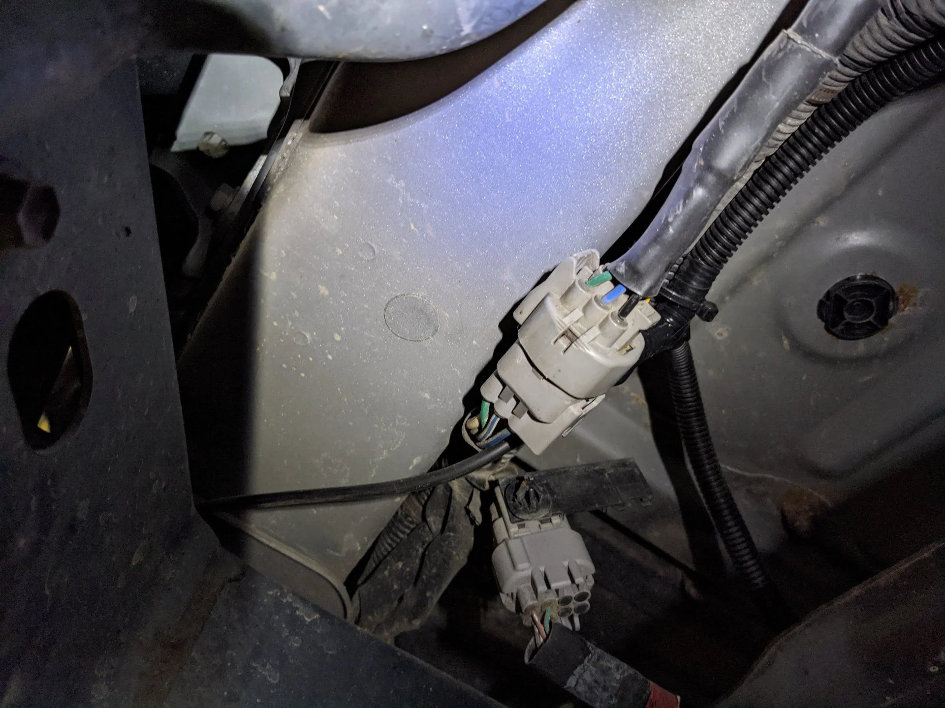

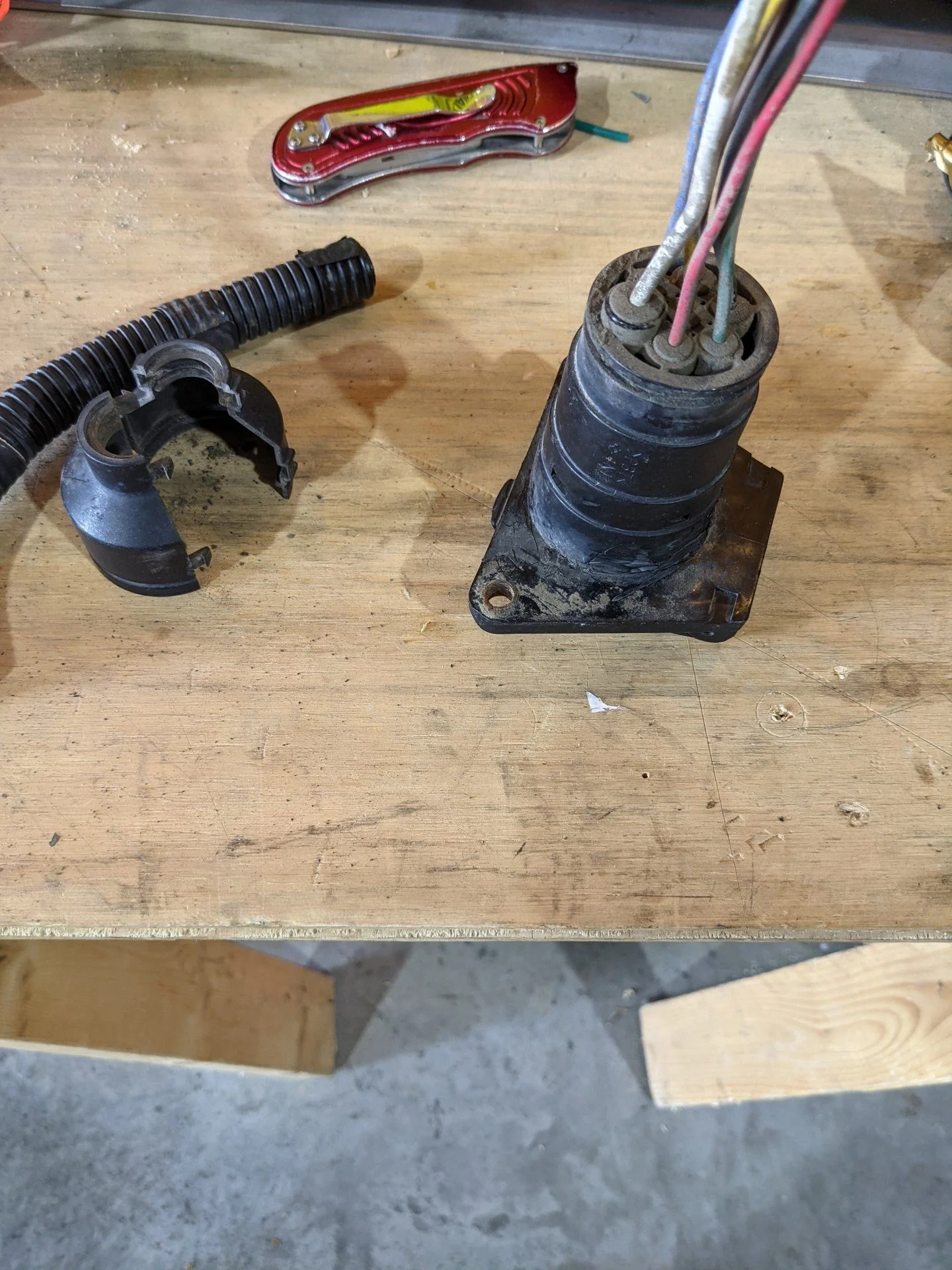

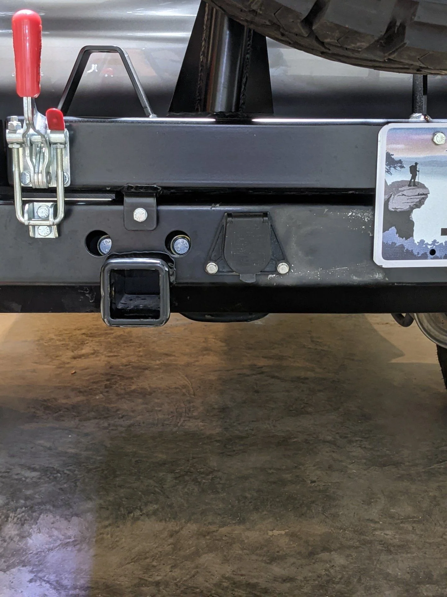

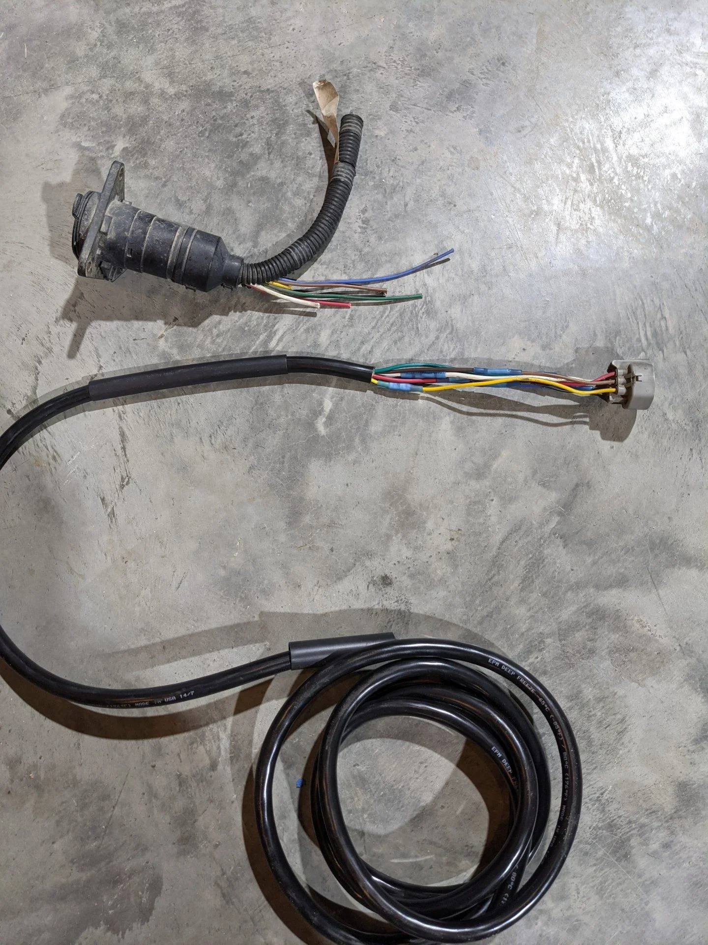

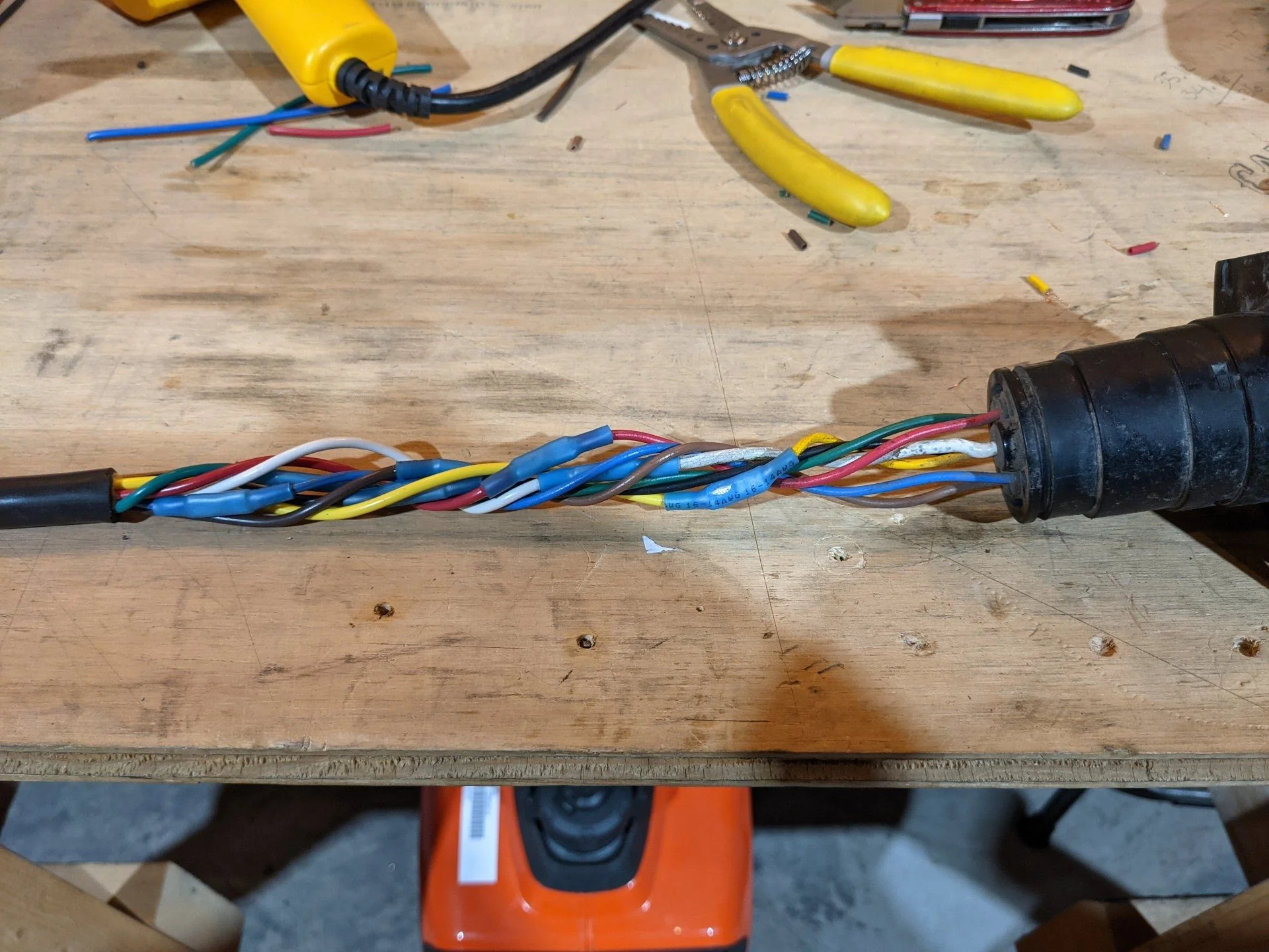

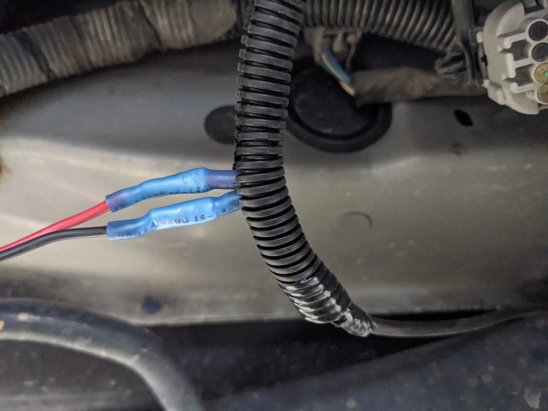

On a more productive note, I got the trailering plug all assembled and ready to install.. (actually installed it and then removed it for the paint repair)
The factory pig-tail is only a foot long or so. I cut it in the middle and added a piece of 7-wire trailer cable in between.
I also had to remove some of the plastic material from behind the plug flange so it would insert into a round hole..
<continued>

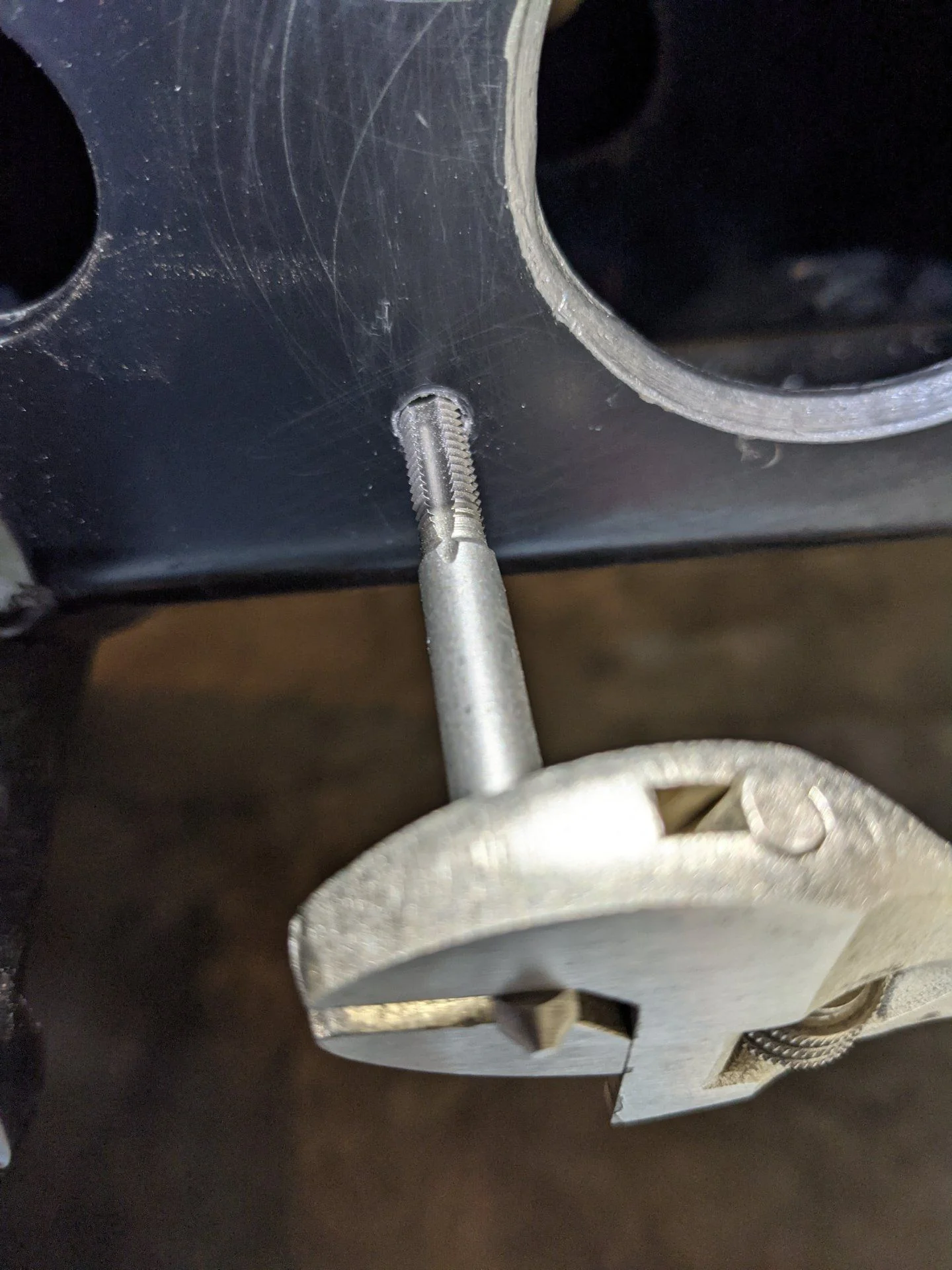

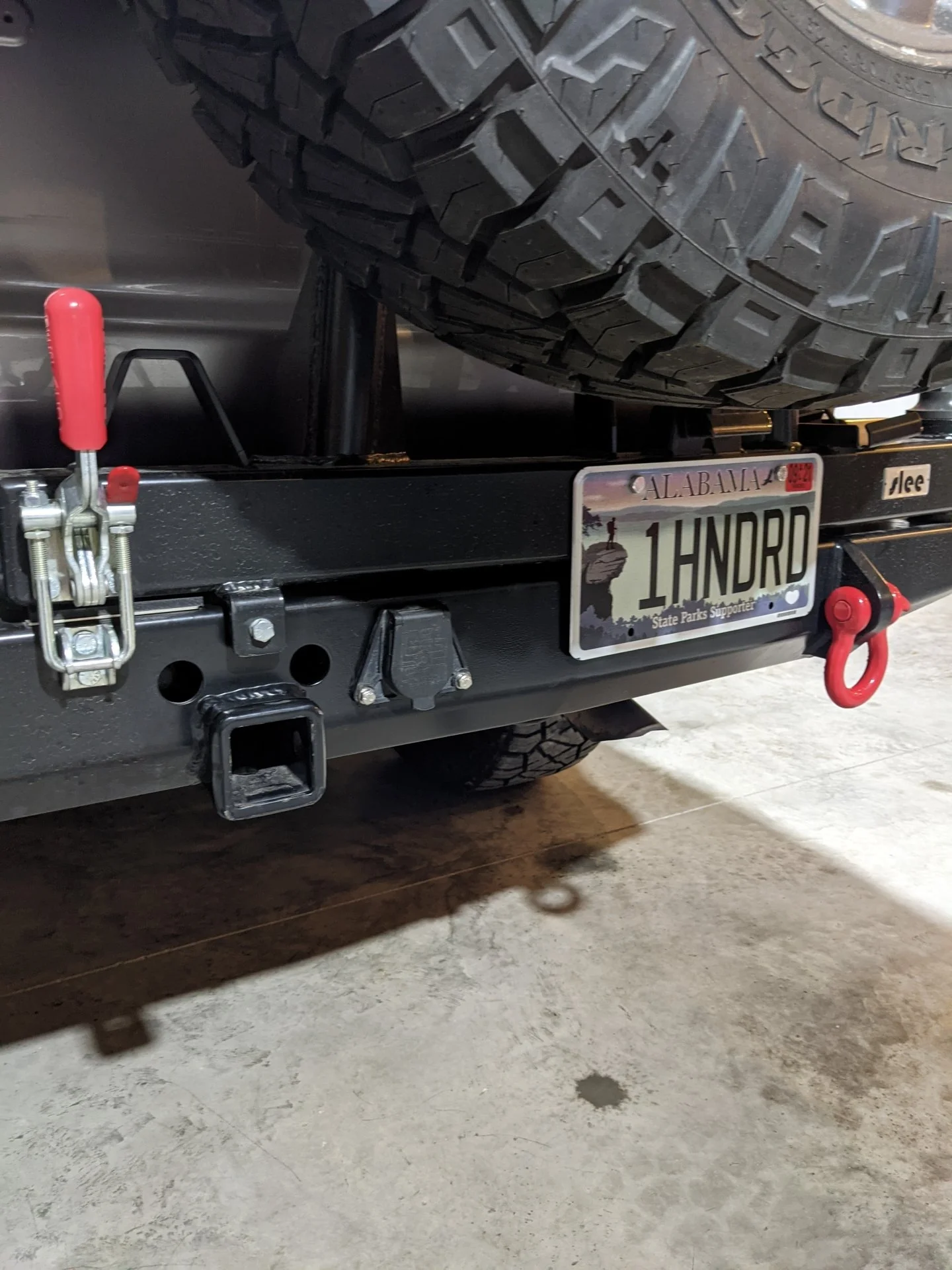

Next I drilled and tapped the bumper to mount the plug using 6mm SS bolts.
Plug it in under the truck and should be good to go... (after the re-paint😡)

I actually started the hole with my step bit but quickly figured out that it was woefully inadequate.. I then purchased another step bit in hopes that I could alternate between the two for each step before they would be completely dull.. When that failed also, I gave up and found a local fab shop with a mag drill. These guys do excellent work on the products they build but I guess this was outside of their zone or the just didn't care..
I think if I could have found a good quality step bit with a 2inch capacity, I could have done it myself and everything would have been golden..

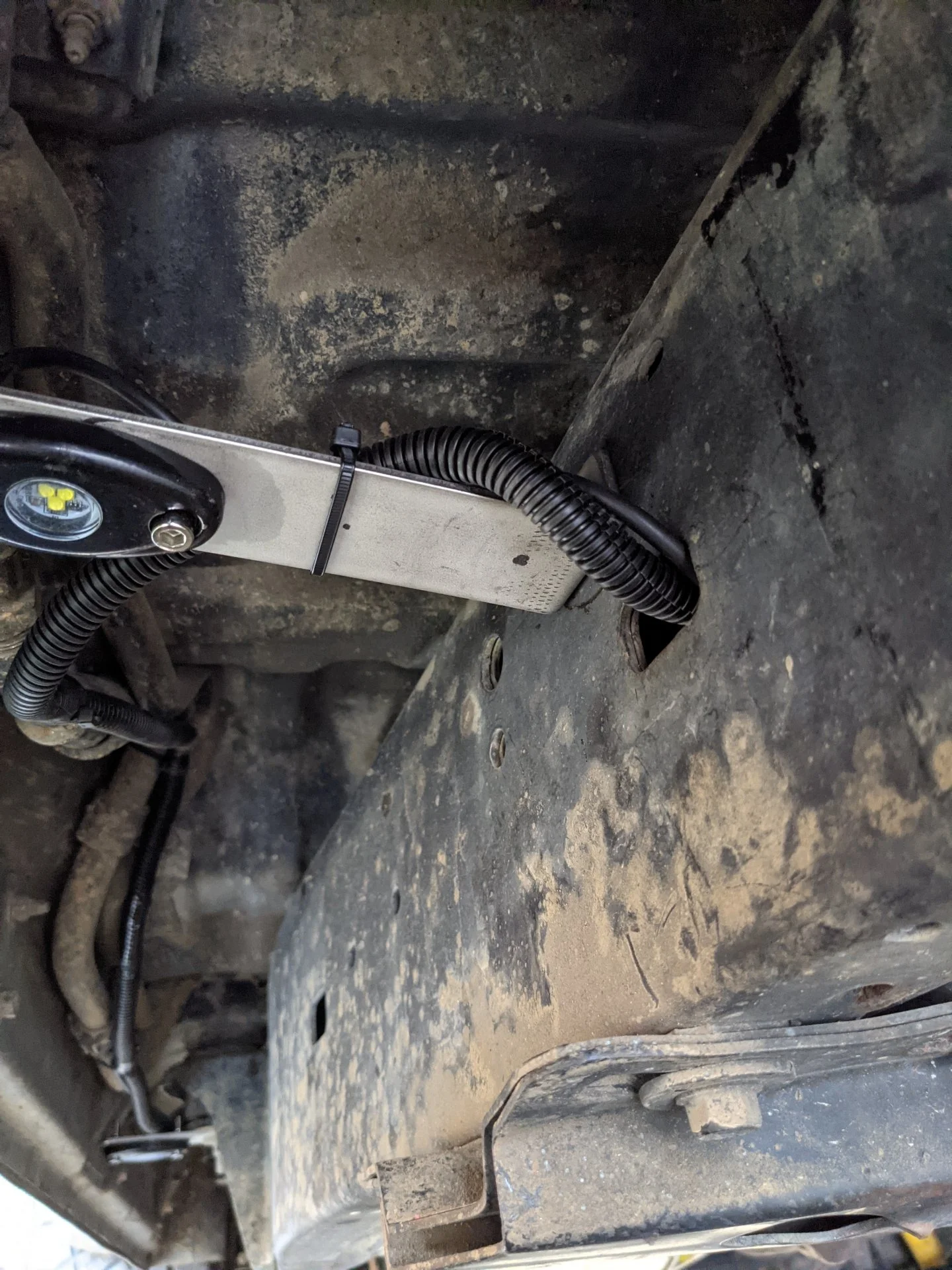

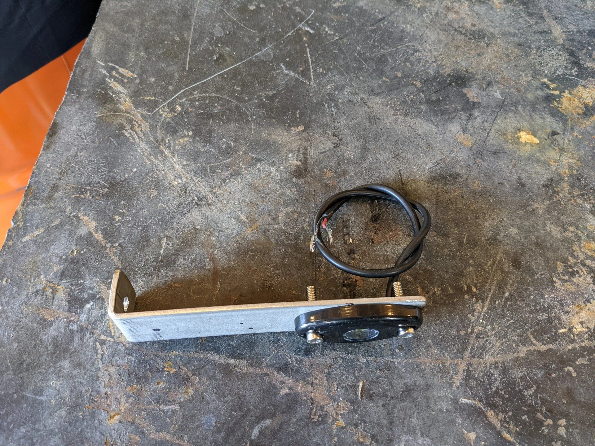

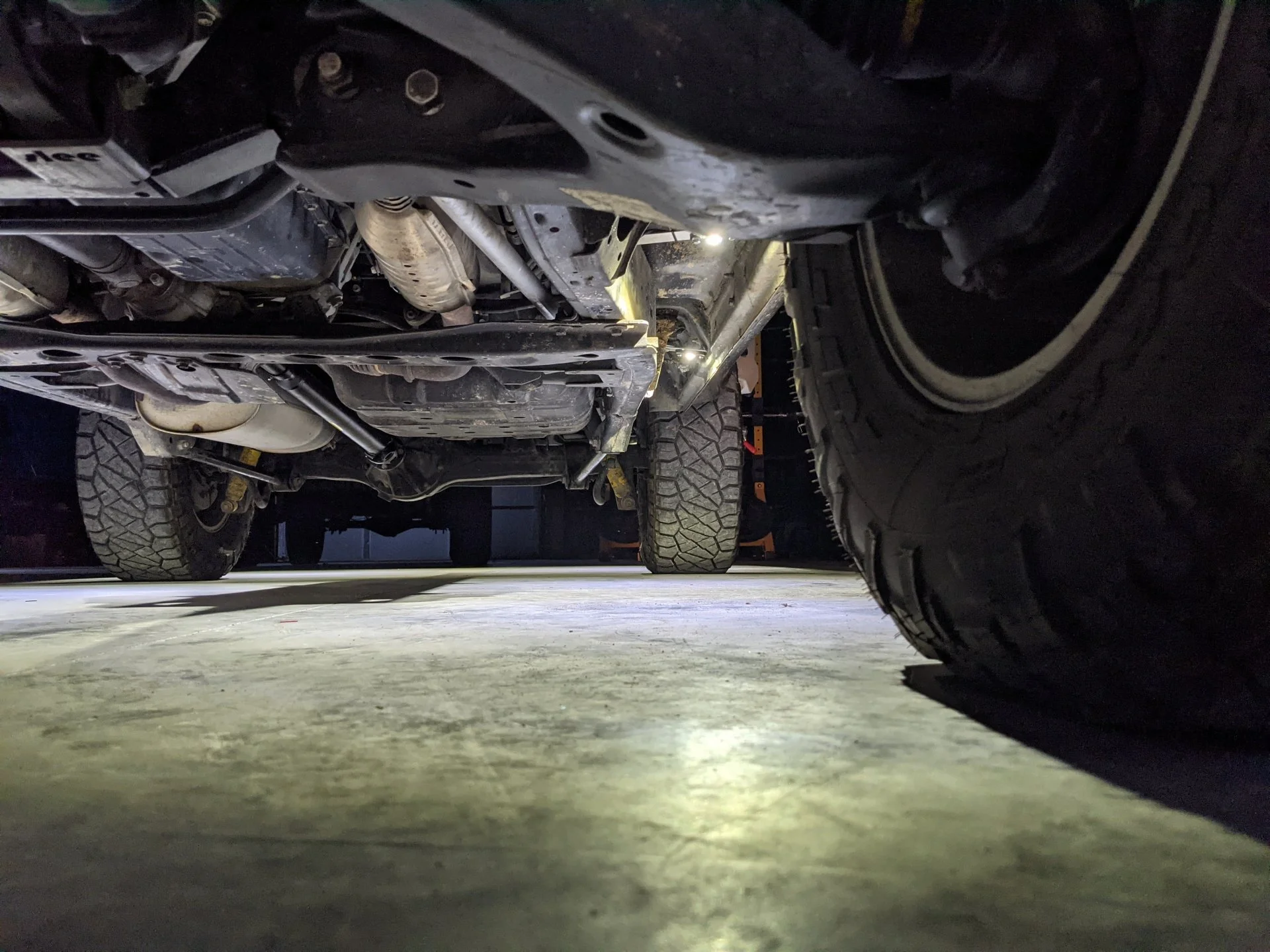

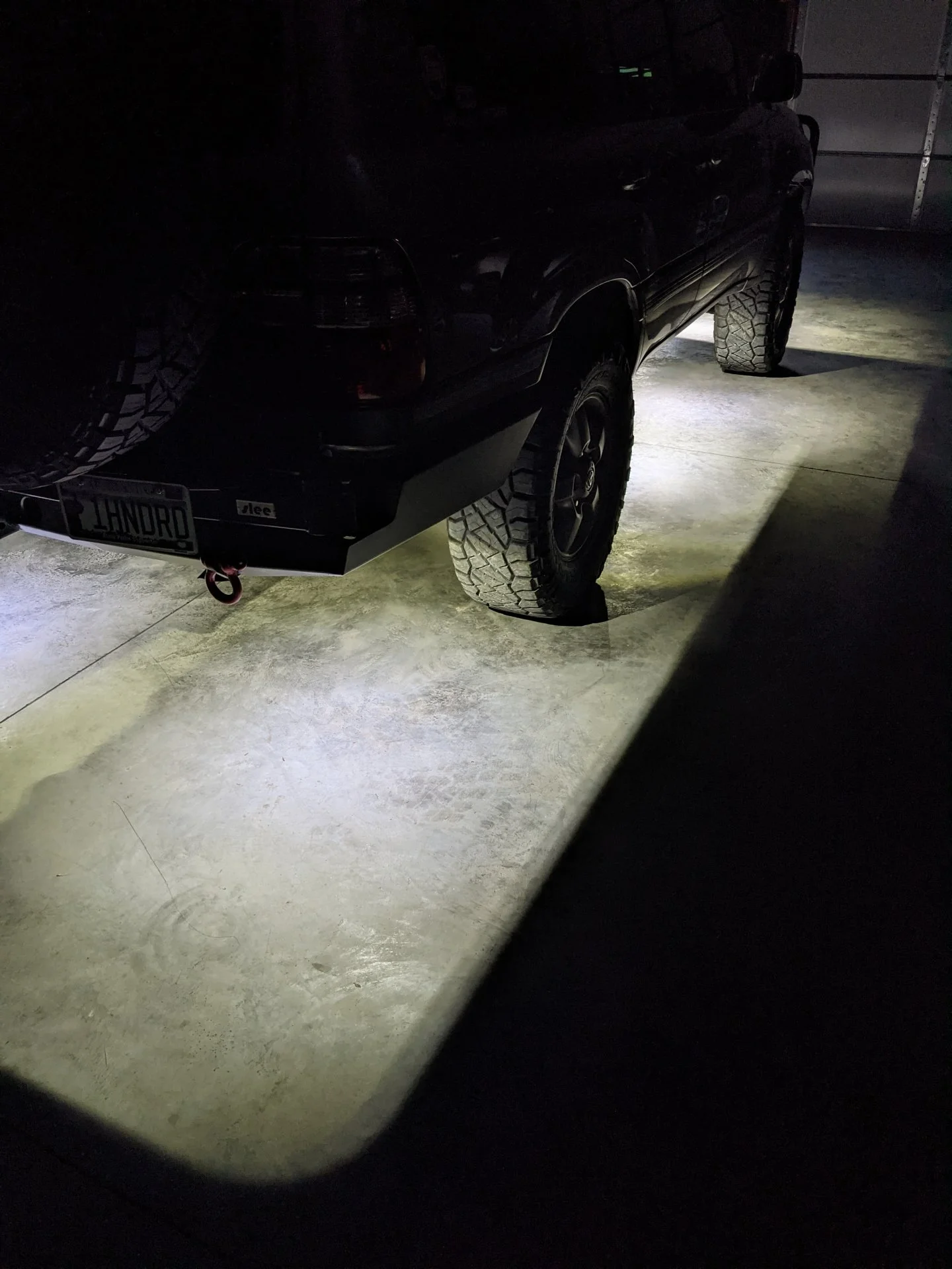

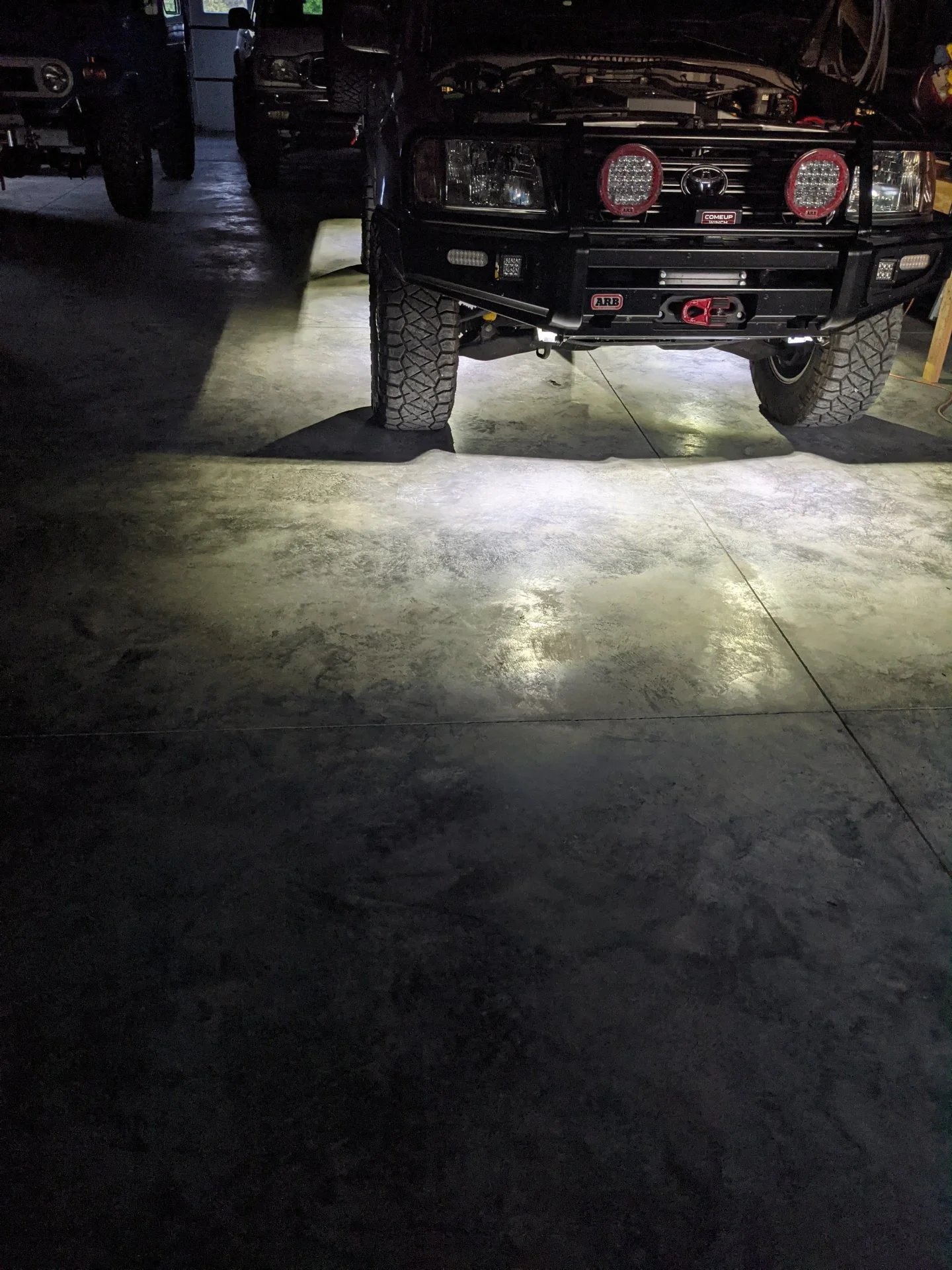

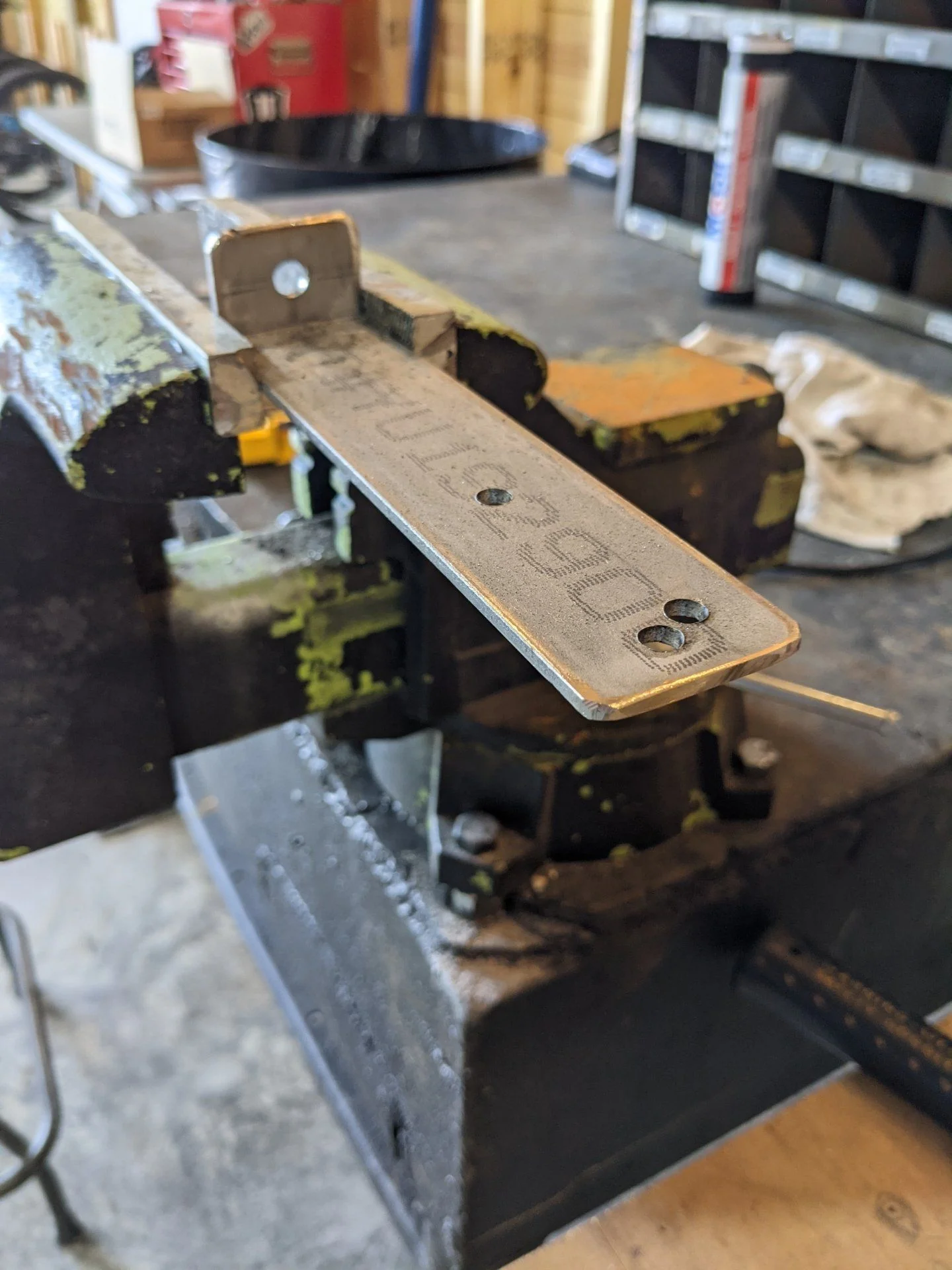

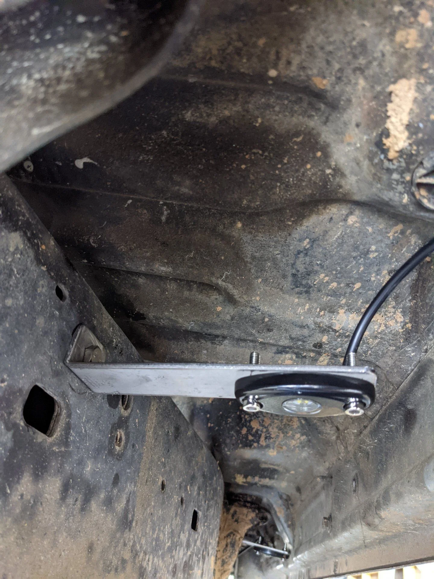

Just added 2 more rock lights. Still haven't connected all the wires.
I didn't like the light pattern with 6 lights (too much shadow in the front tire area) so I added 2 more for a total of 8. Haven't tested yet...

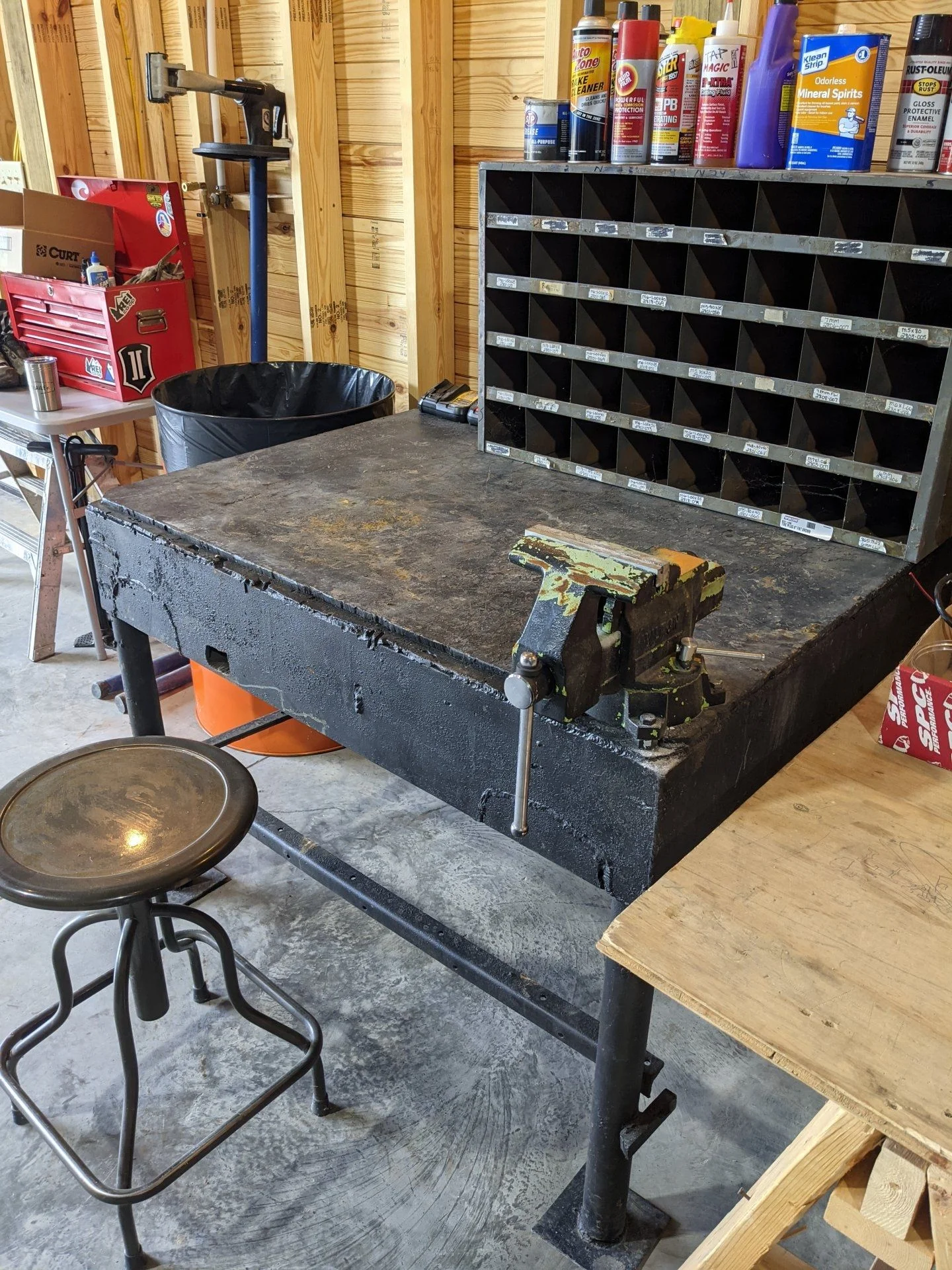

Also.. I scored a really heavy duty used work table with a vice for my shop.. Already loving it..
Finished the rock lights yesterday.. Originally was planning on 6 but ended up adding 2 more mid-project. Turned out pretty good. I expect it to be a very useful camping enhancement.

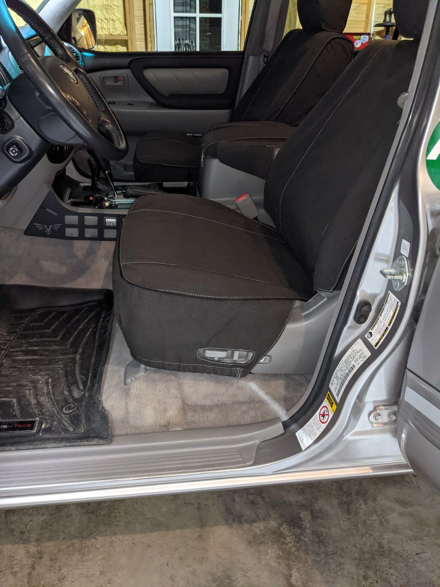

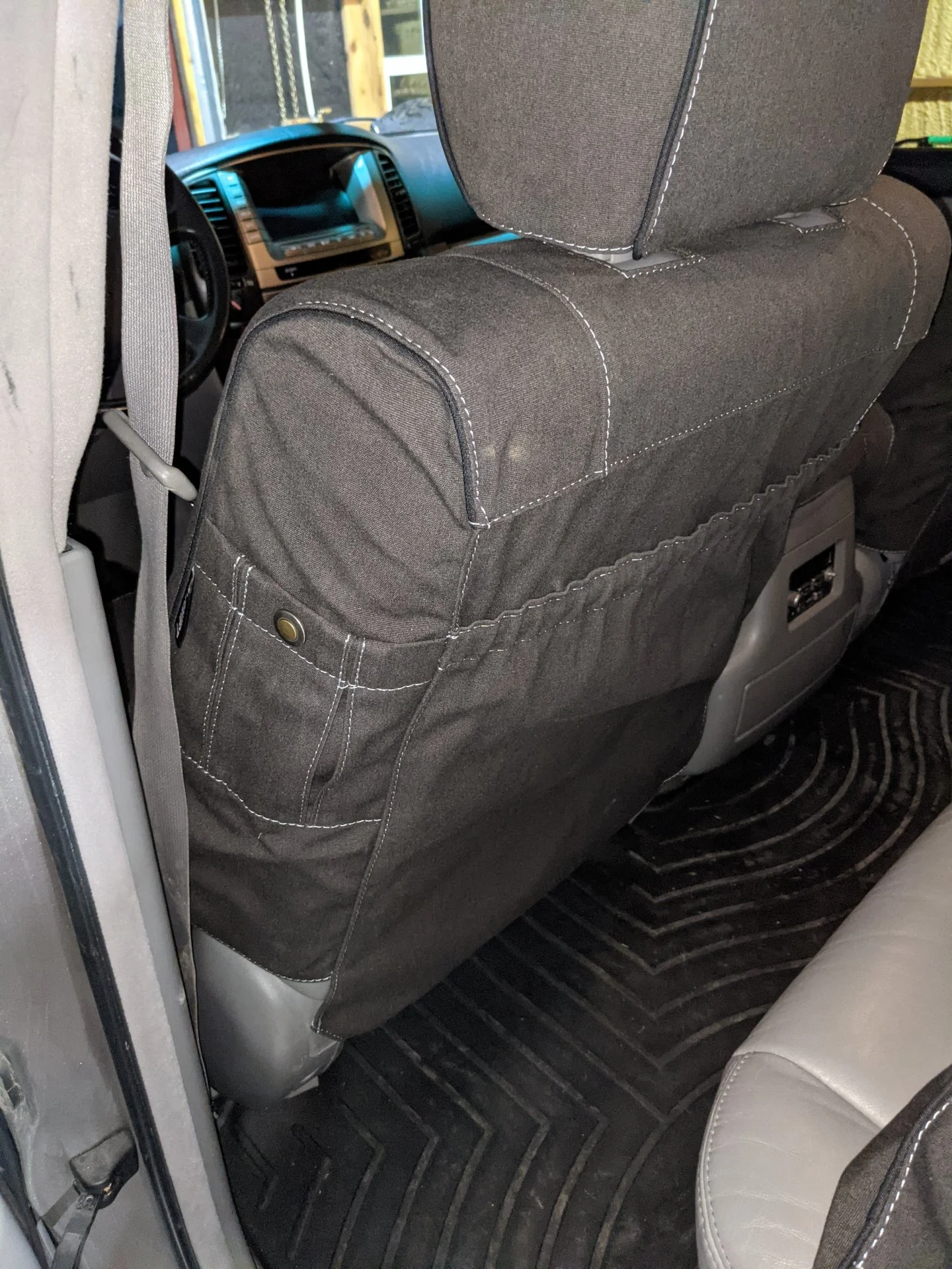

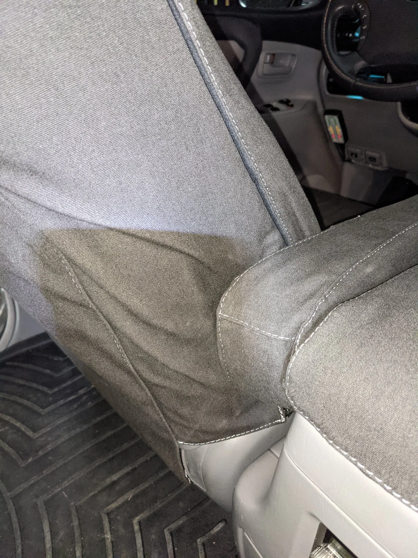

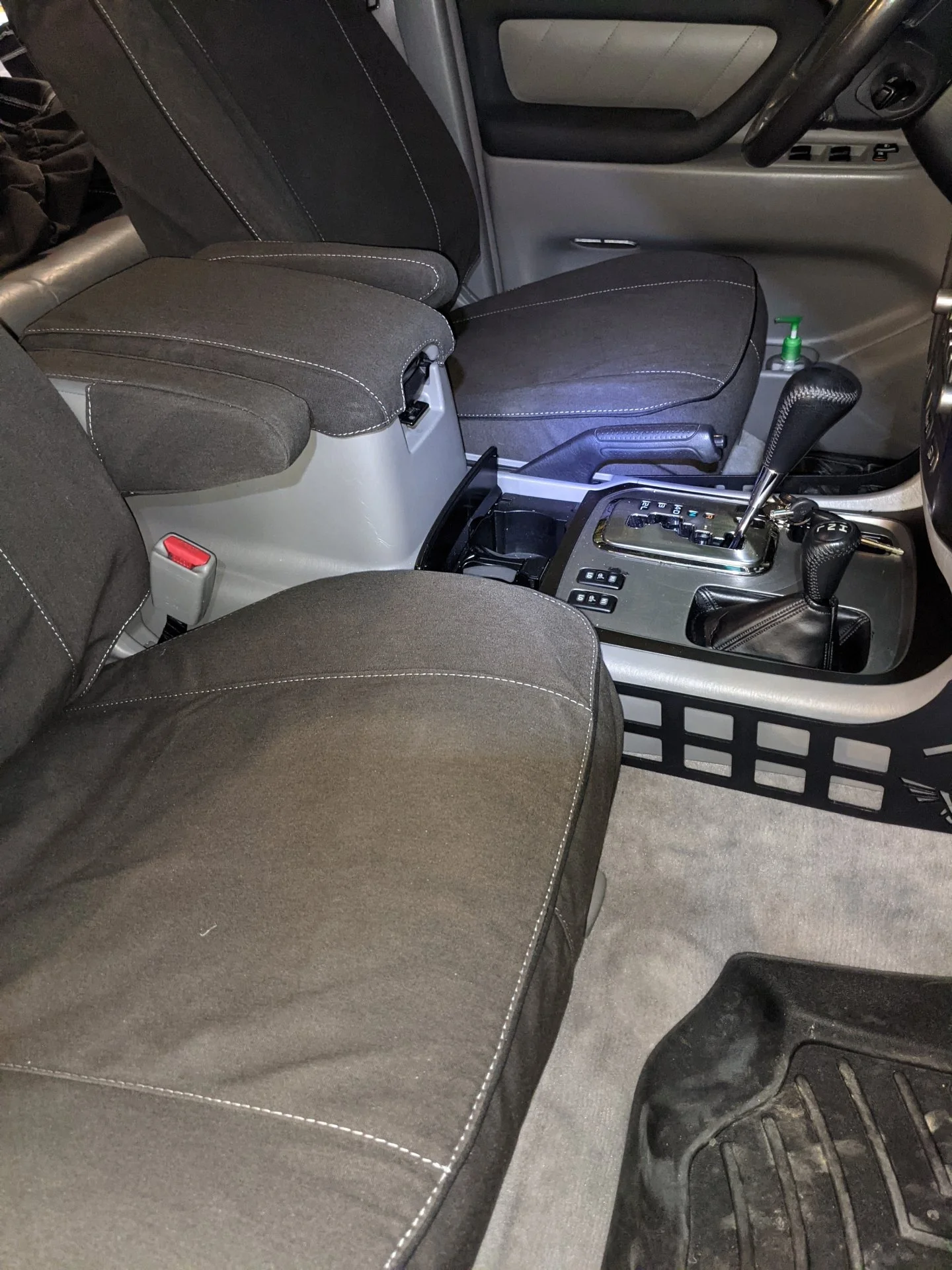

I finally got around to installing the seat covers... Got the front row installed and I've gotta say they are not super impressive. I was under the impression that they would be very snug and form-fitting but that isn't the case. Also the edges and some of the finer details just have a bit of a sloppy fit/finish.. These are Escape Gear from Equipt...
Since Equipt messed up the original order, I am still waiting on the 3rd row to arrive.
I'm gonna use these for a week or two and see if I start liking them better. I do like the idea of having the leather protected and having washable seats (although removing/reinstalling these won't be fun) I also like the side pocket.. Looks cool and seems like it'll come in handy.

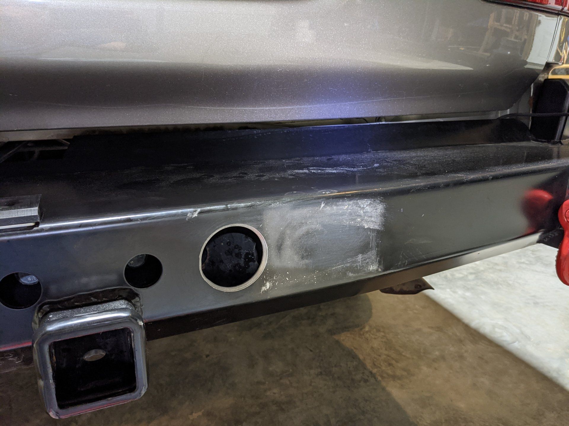

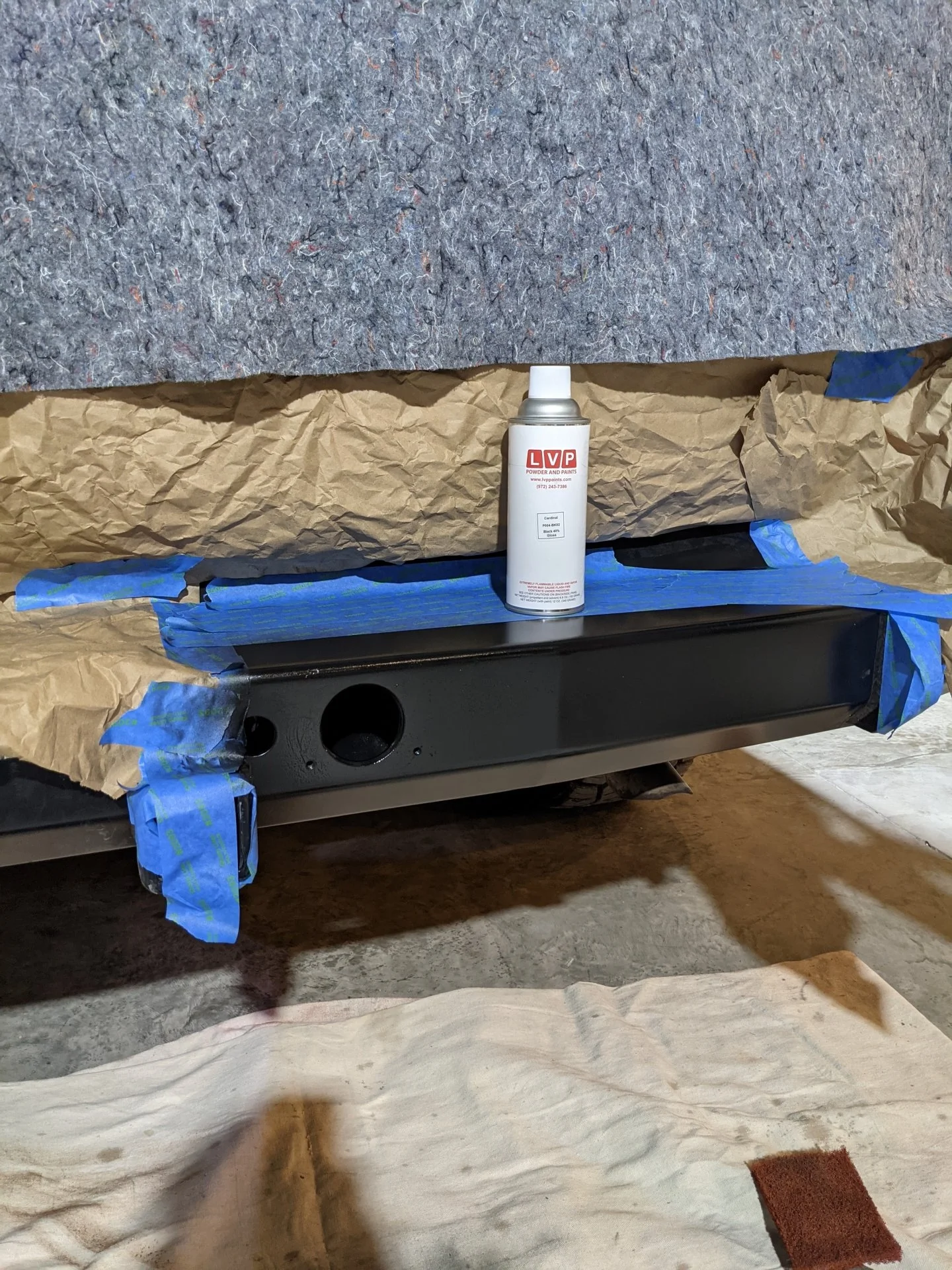

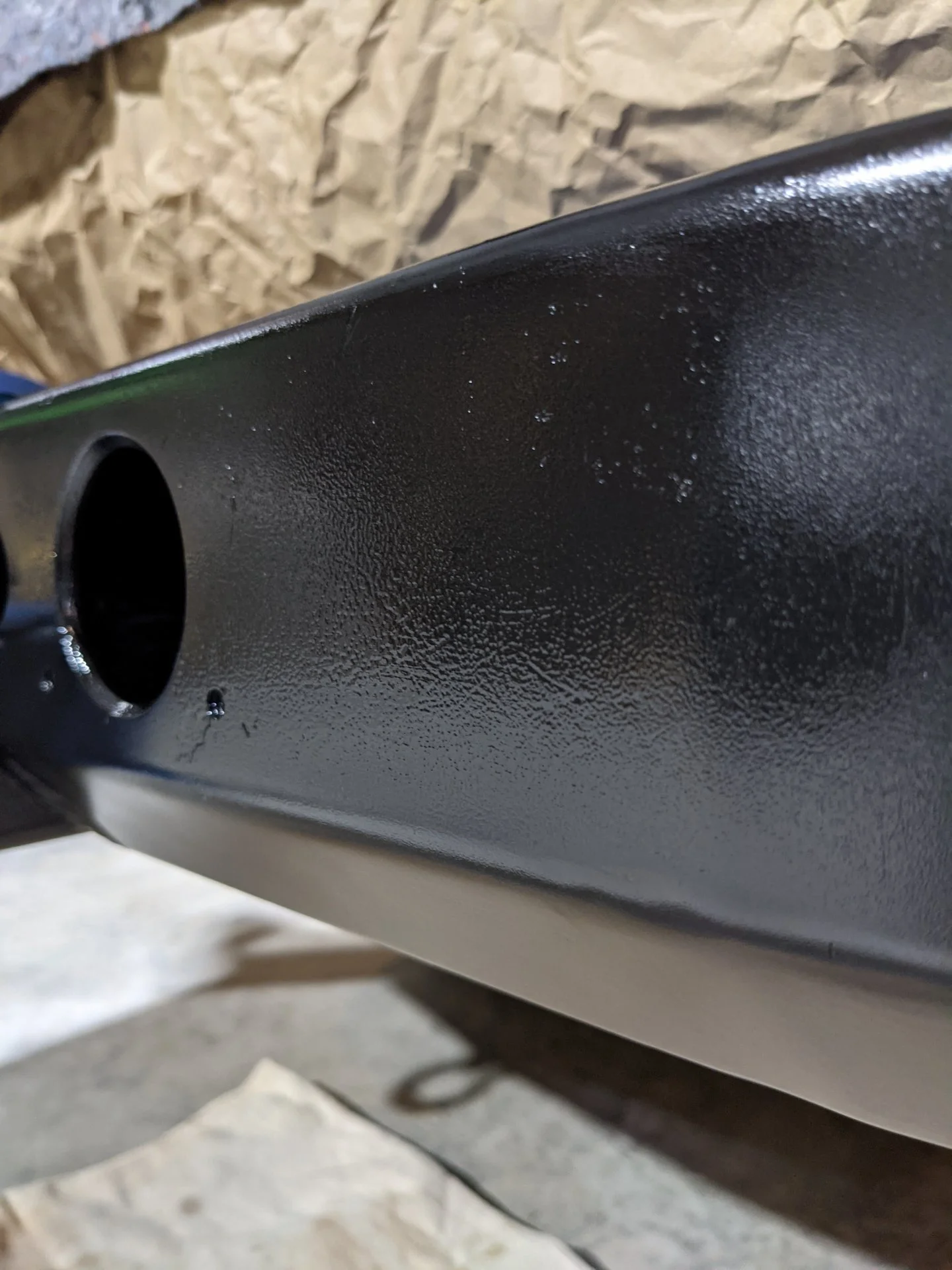

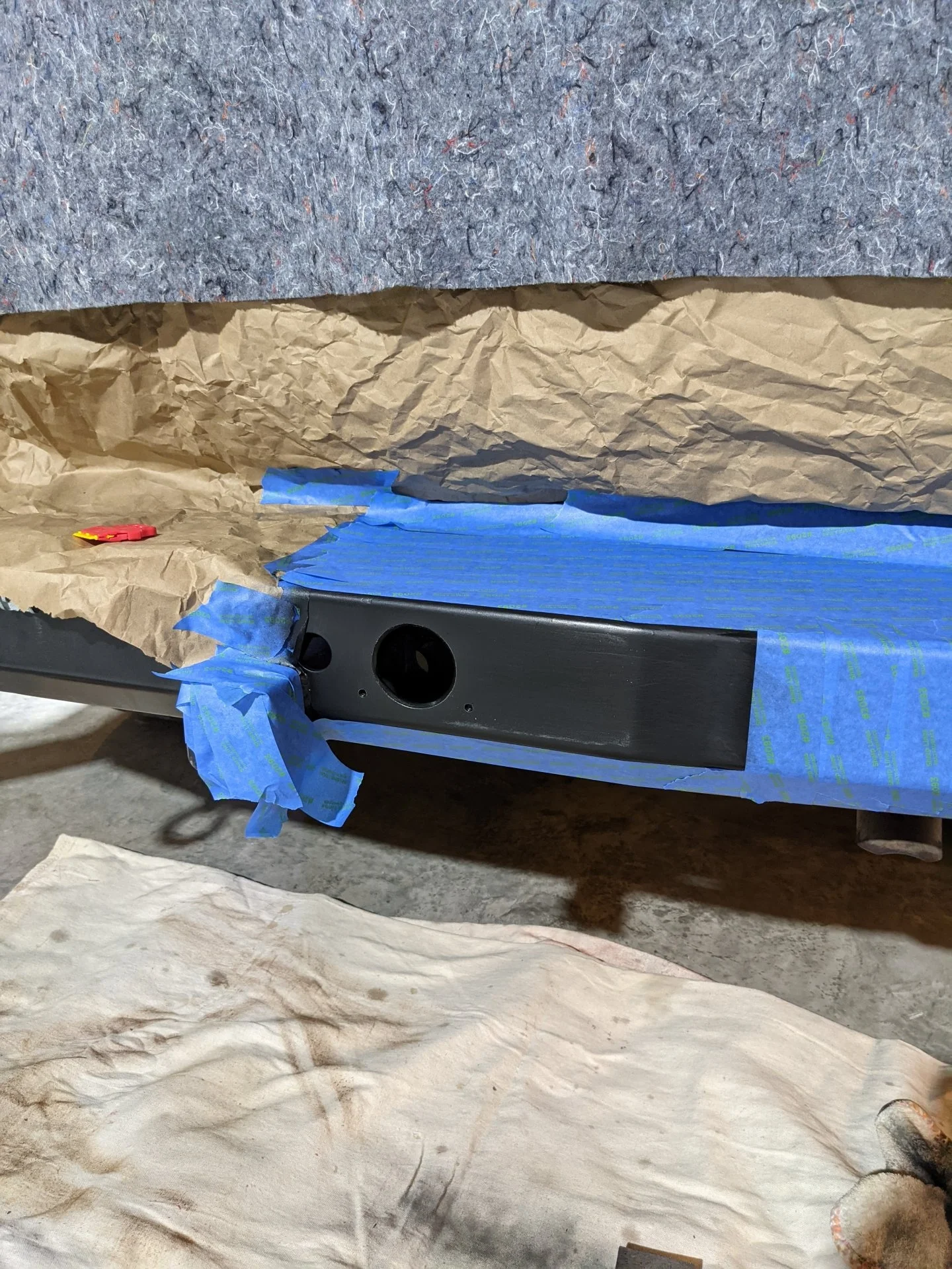

I also had a chance to try to resolve the bumper hole fiasco...
So I have an appointment at the body shop next week but I got the Slee-recommended paint and I thought if I could get a good result I'd save the money..
The paint is a good match but I ran in to a couple of challenges.
First, the surface of the steel is pitted and scratched from the mag drill. It's tough to get it smooth like the rest of the bumper.
Second, I couldn't decide if it was better to mask off a defined area and end up with edge lines or try to blend it in over the powder coat.. I sort of tried it both ways and I'm not sure yet what it will look like when I remove the tape.. I definitely know that it has lines though.
I figure if it just doesn't look great I can have the body shop fix it..

Have you ever tried red sanding puddy? Wet sanding it tends to blend scratches with a low shrink rate... https://www.grainger.com/product/3M-Glazing-Putty-5DYY5
Have you checked into Marathon seat covers? I have a set on order for my Tacoma. Supposed to be top notch. Worth a look.
This morning I stopped in at the body shop and showed them what I had done on my bumper. I asked them if they thought they could make it a lot better and they said probably a little but they would have to repaint a large area.. I opted to work with it a little more myself and call it good.
The worst part is the line behind the license plate where I had masking tape... (under the "S" in "State"...) No real good way to blend it in. Also the area where the mag drill was "mounted" is still pitted slightly but this is as good as its gonna get.
