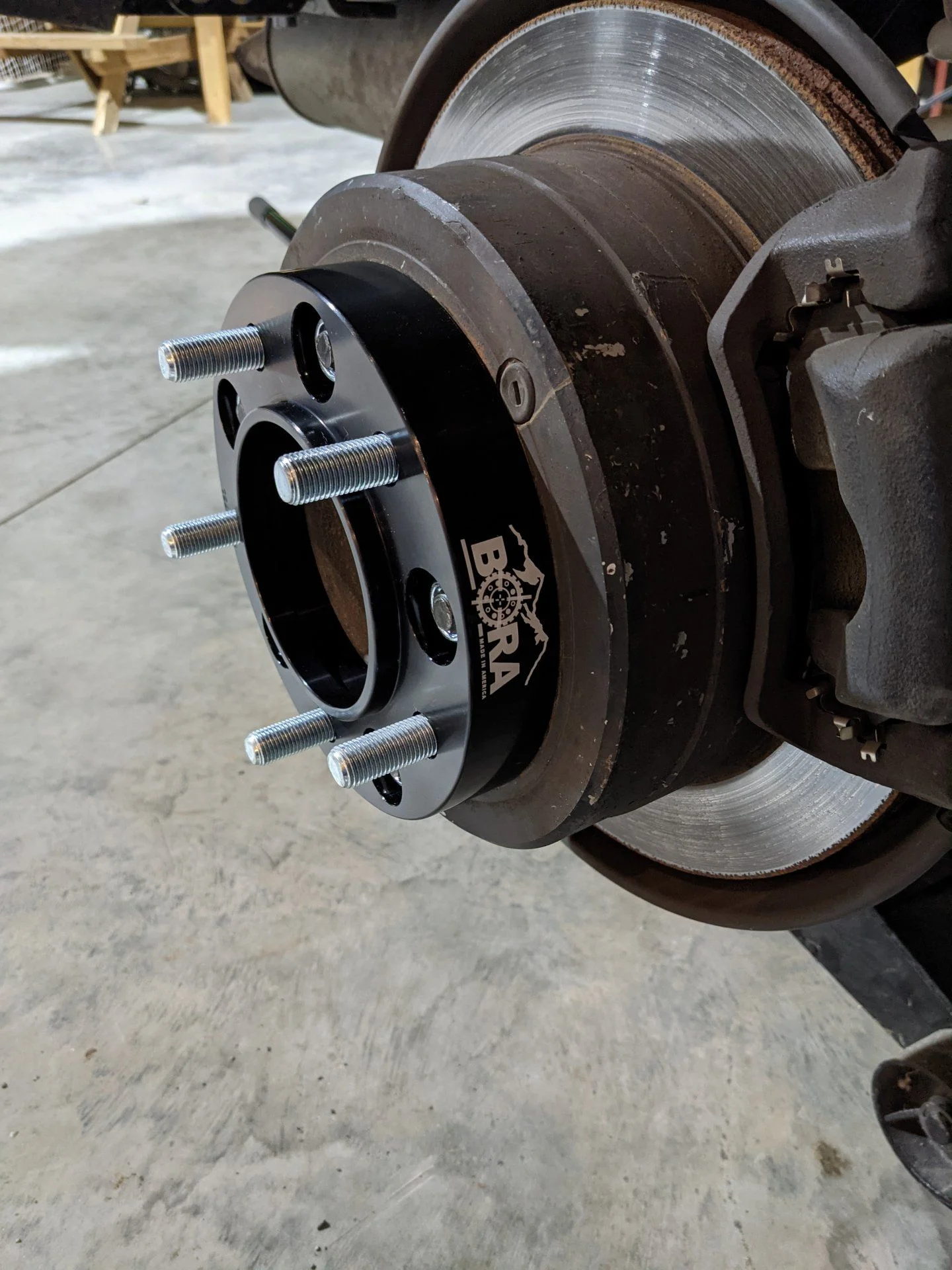

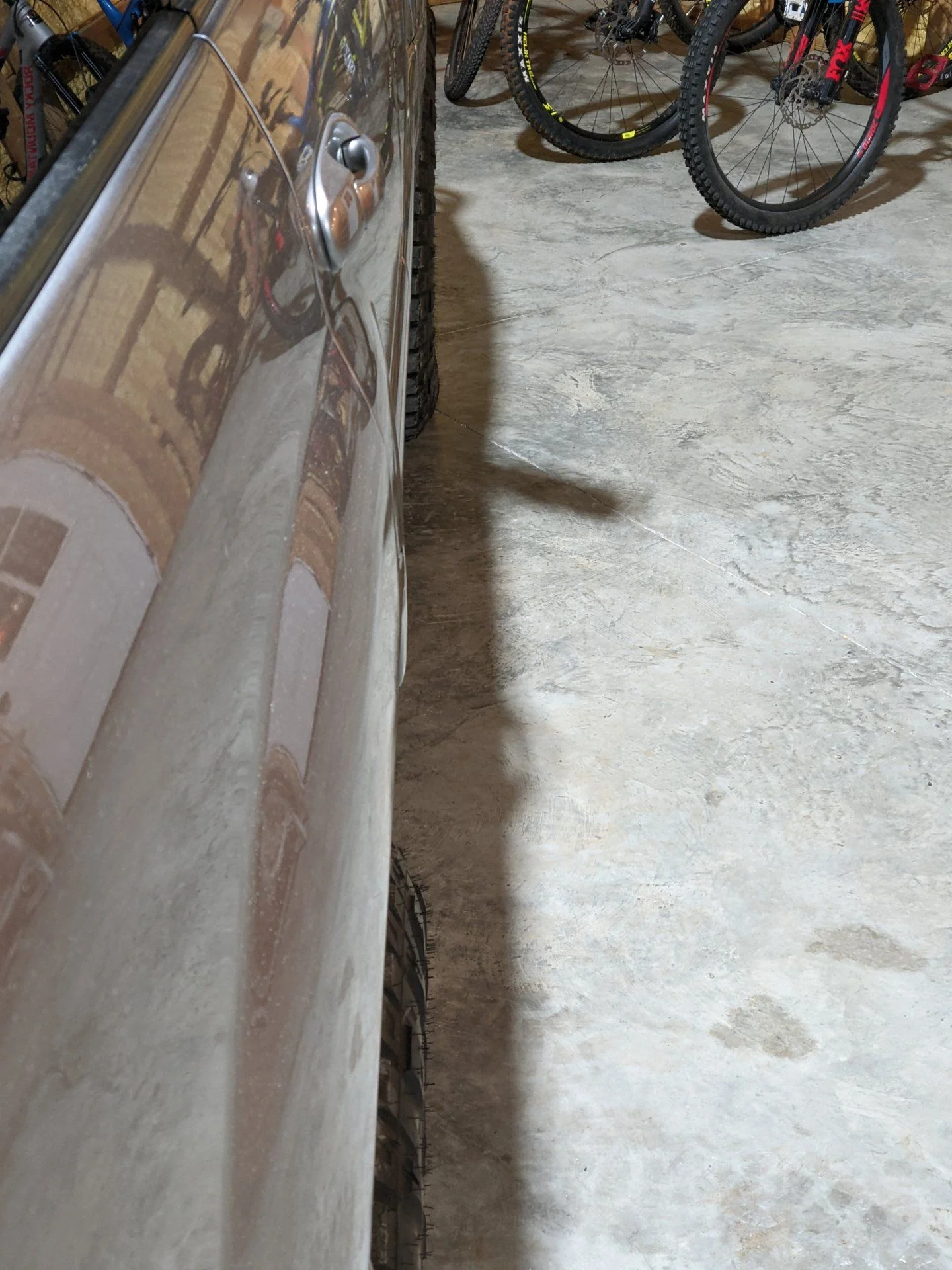

I replaced the 1.5" spacers with 1.25" in the rear only.. So I have 1.5" up front and 1.25 in the back. This makes the tires more consistently relative to the body. Previously, the rear tires were out past the body noticeably further. Amazing what 0.25" will do.
Also, the rear tires should stuff better this way as well.

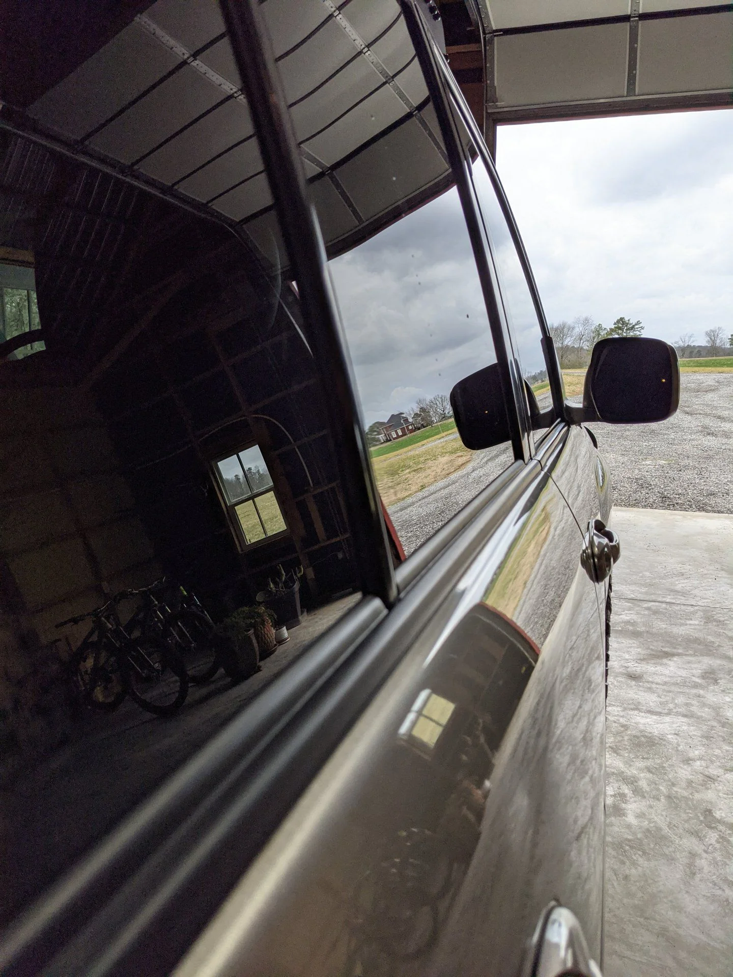

I also have new lower exterior window seals that I'll be installing to replace the old ones.. And a WeatherTech cargo mat.

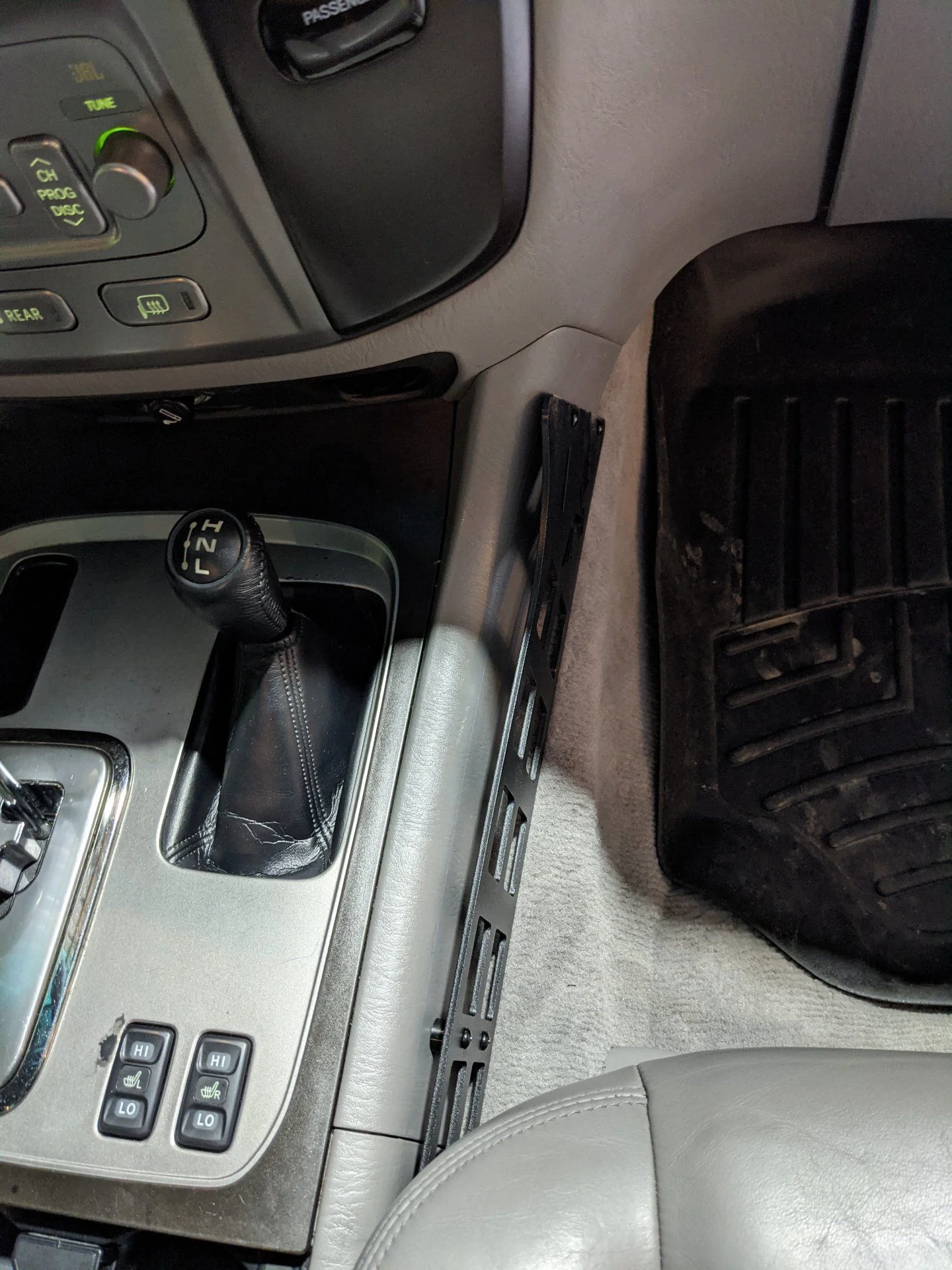

Installed the console molle panels from Victory 4x4. I figure they will offer a little extra space for phones and stuff.. But also they look cool.

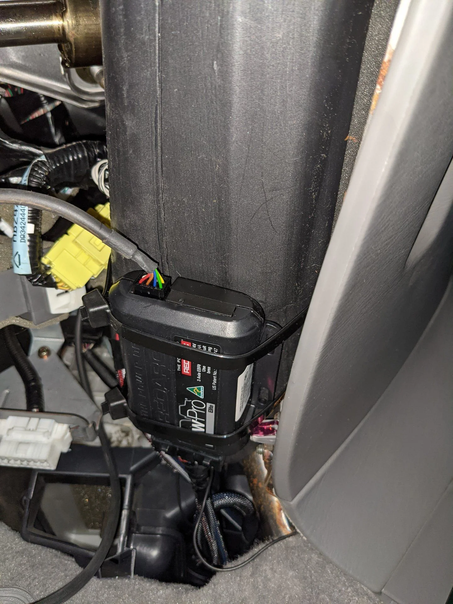

Also installed the Redarc trailer brake controller.. I had some trouble finding the factory connector under the dash but the MUD brain trust came through again.
The bezel for the dial just barely fits between the vent and the hazard light switch.. I considered turning it sideways but the label would have looked goofy so I squeezed it in vertically. Maybe I should have installed it without the bezel..? Anyhoo, it's installed and looks semi-factory.
I avoided screw holes by using large zip ties to secure the controller to the air duct...

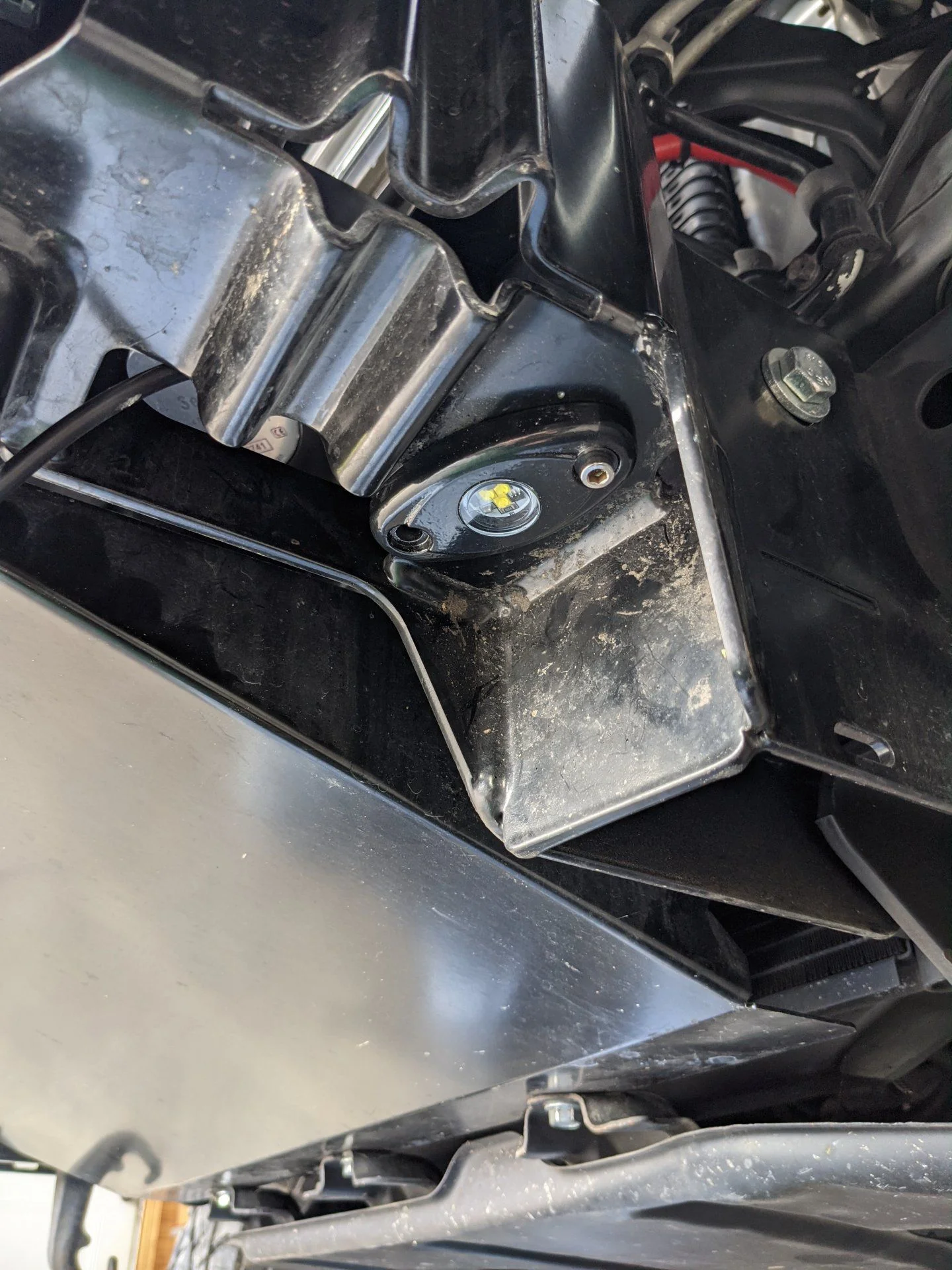

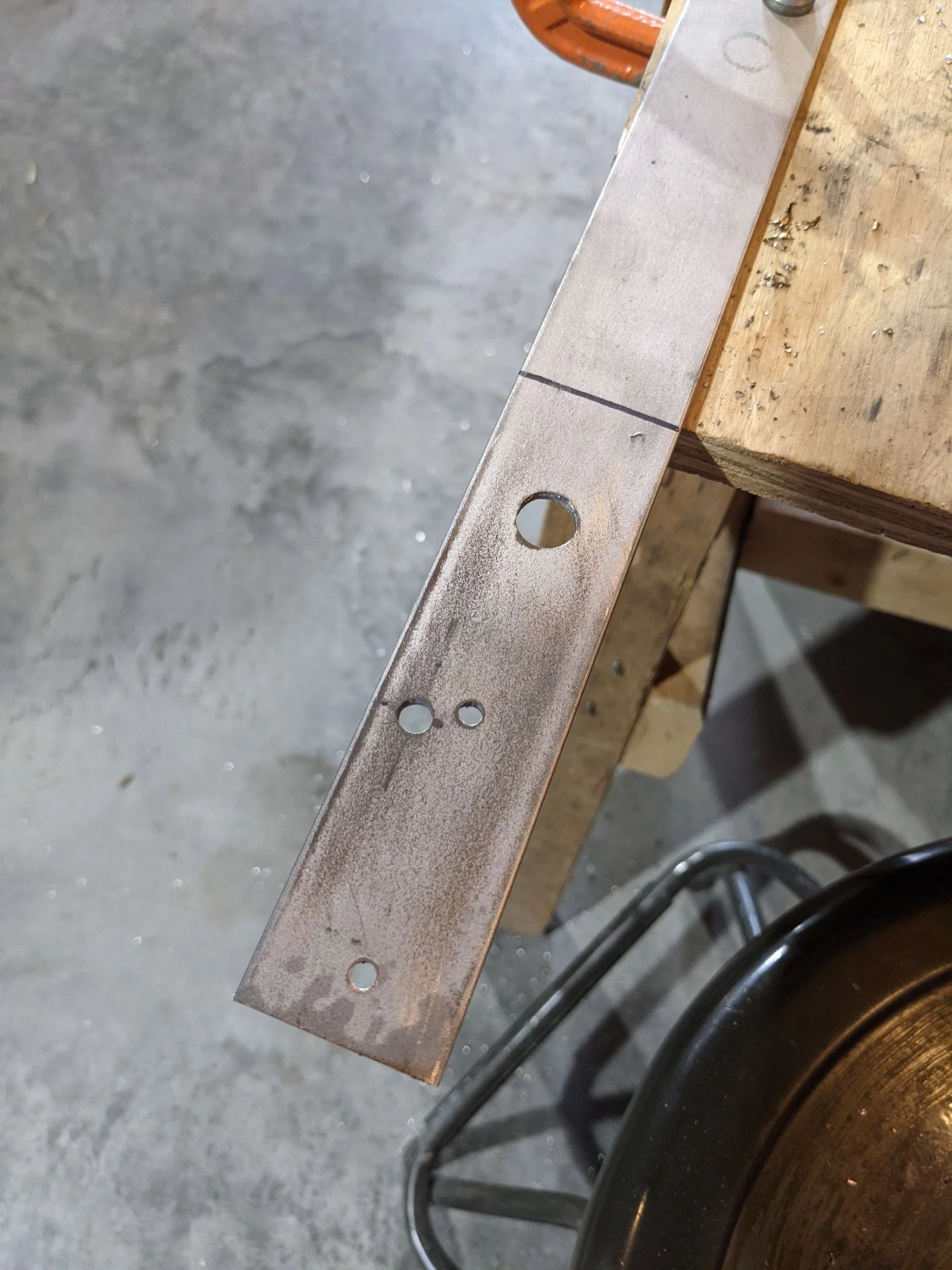

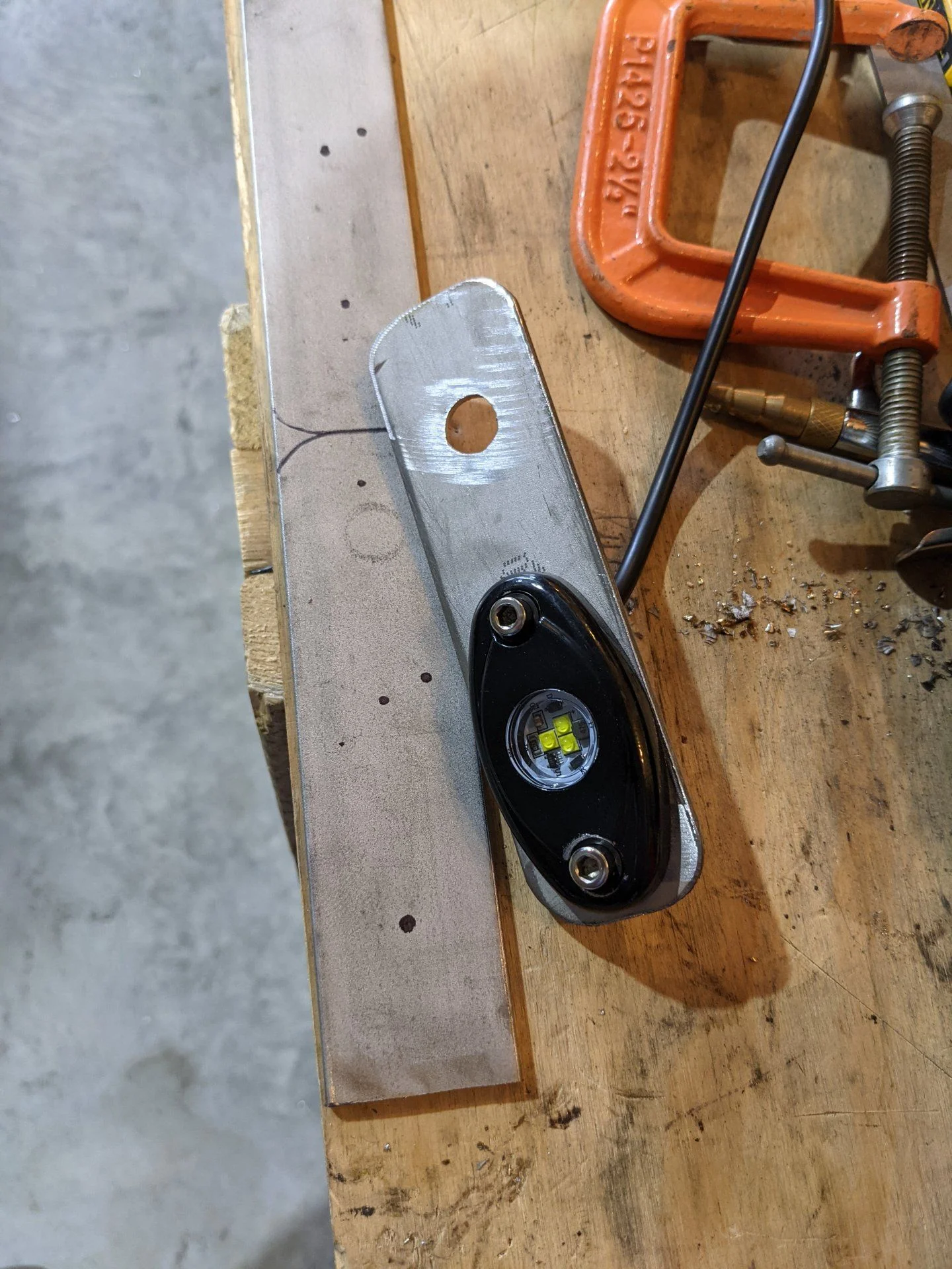

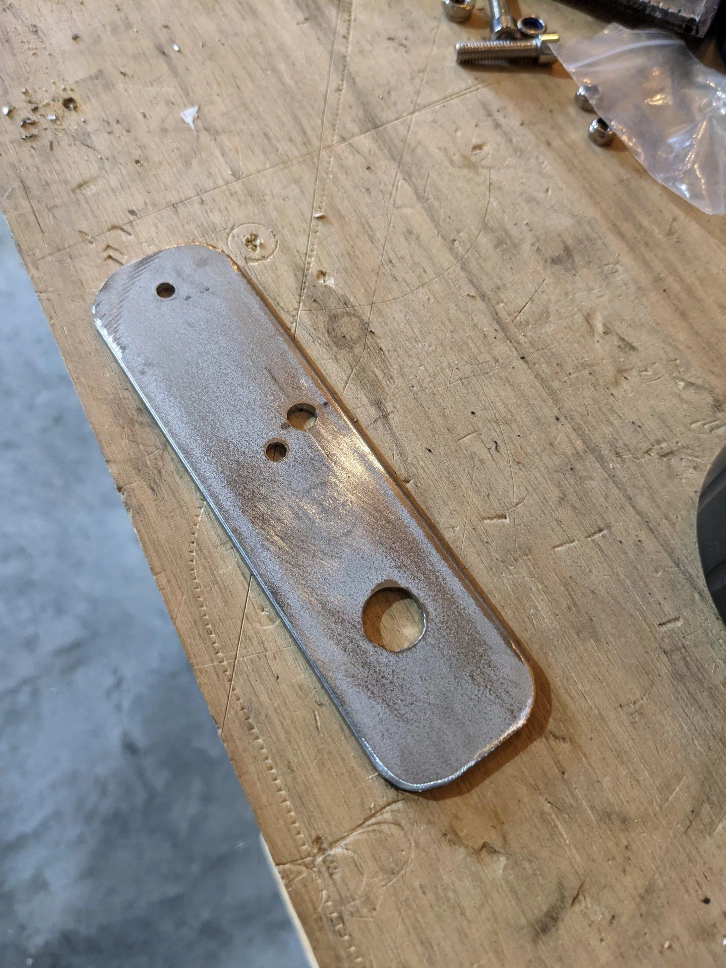

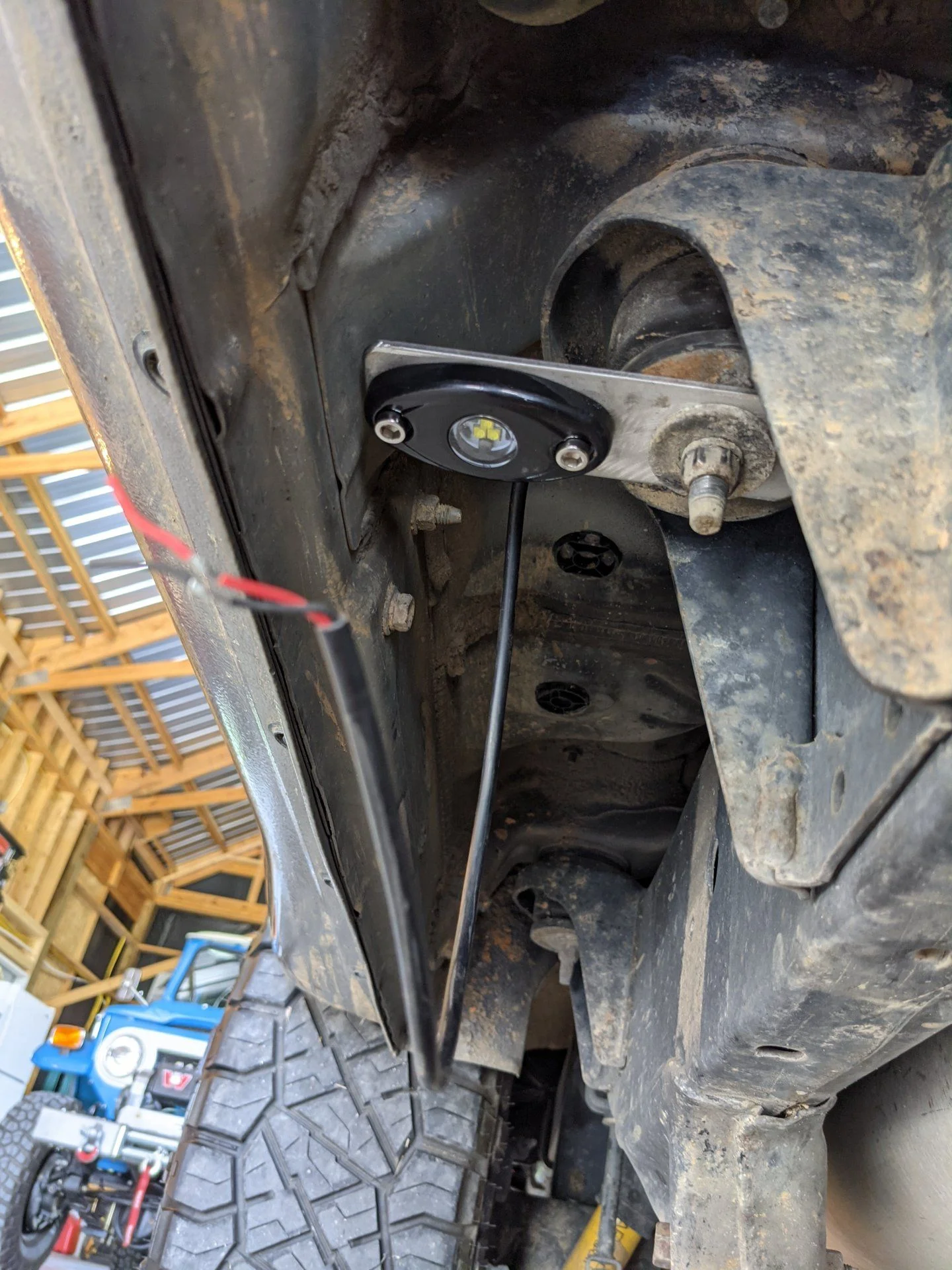

Started mounting the rock lights. I'm cutting the pieces out of a stick of stainless steel and using the body mount bolts to secure 4 of them. There will also be 2 on the front bumper for a total of 6.
I need to install 5 more and then run the wiring..

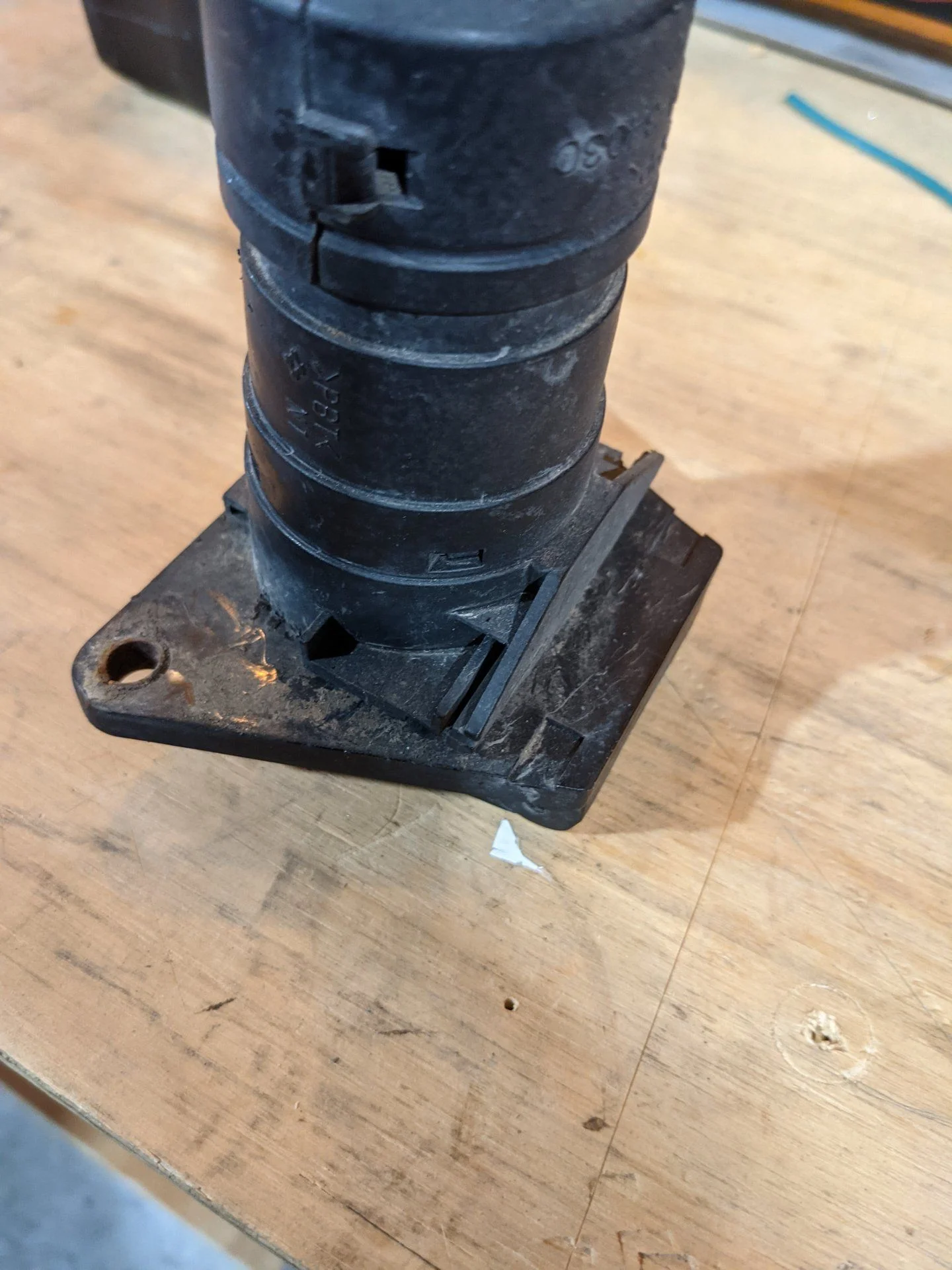

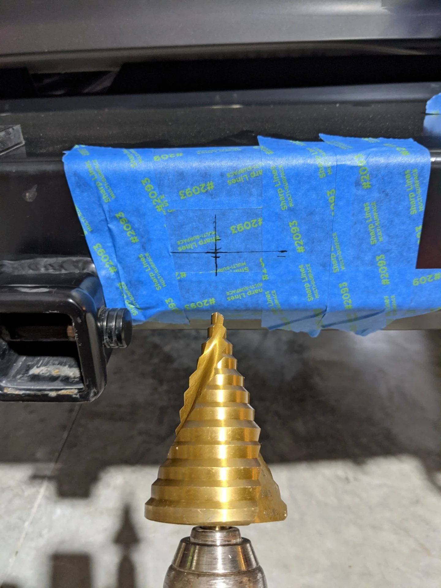

Also started prepping to mount the trailering plug in the rear bumper. I had to remove the extra plastic from the housing so that it will slip into a 2" hole.
After very careful measuring I nervously contemplated drilling the massive hole in the pristine bumper.. Once I got it marked and ready I went for it. I thought I had the correct tool but unfortunately it was dull in no time so I'm kind of in a bit of a pickle now. I'll need to figure out how to drill it bigger without ruining things... :bang:

Getting ready for another Saturday in the shop.. My bumper drilling project did not work out so I've got a tentative appointment with a fabrication shop and they will drill it with a mag drill.

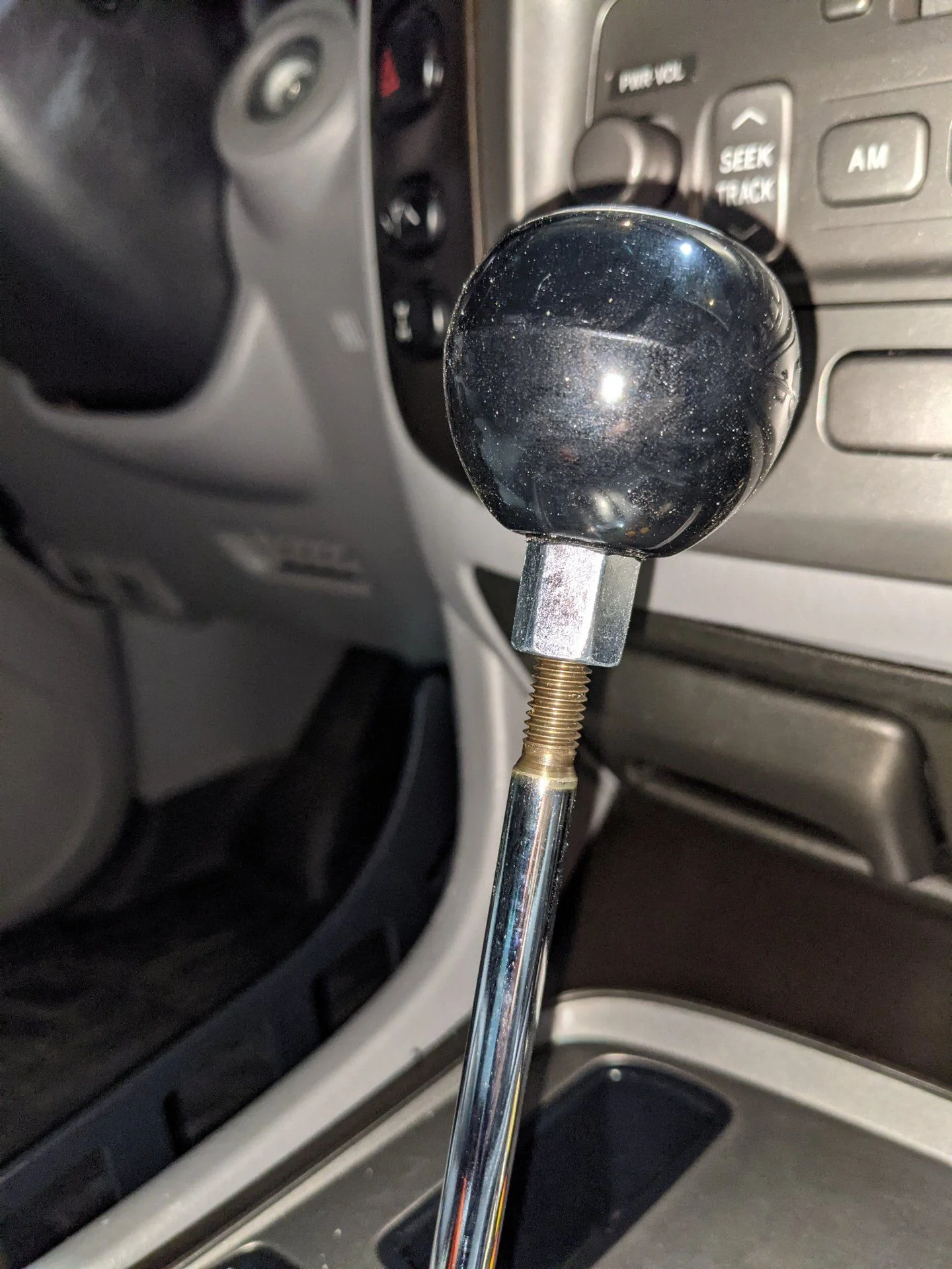

Meanwhile.. Just a quick post here regarding an idea I had for the gear shift knob. I bought one for a FJ40 just because I thought it'd be sort of cool. Problem is that the threads are different size so I found an adapter on Amazon. It didn't really turn out like what I had in mind because of the hex and the exposed threads at the top.. Maybe I could find a leather sleeve or something..

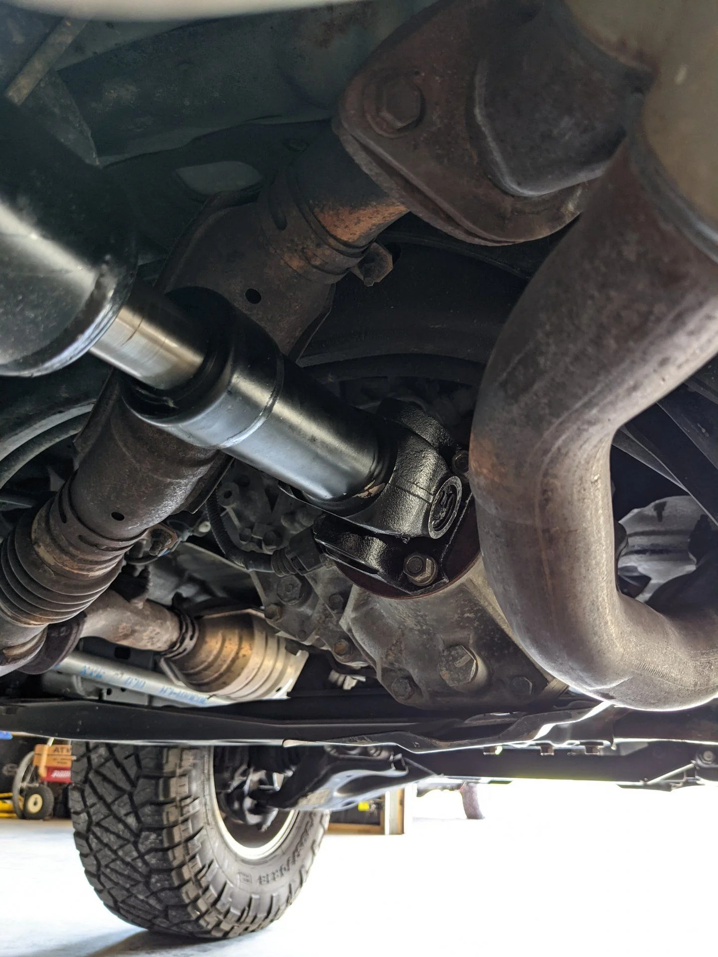

My son installed the new Tom Woods drive shaft. We used the old bolts because the ones they sent with the shaft were a smaller diameter... The clunk has been eliminated! (so far 🤞)
I got all the rock lights mounted (6) and four of them wired..
<continued below>
