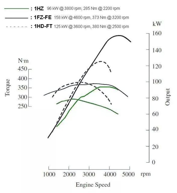

P.S.S. at 1400RPM the 1HD-T has top torque, the 1HZ has it at 2200RPM...manual transmission makes it difficult to asses it...H151F has different gears than H150F...R151F used in FZ or HZ has different gears also
