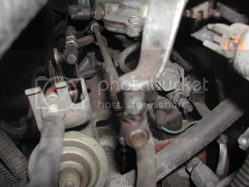

There ya go, the one just to the right & below the one that says OUT
That screw is a PITA to get to but with a little screwing around it can be done.

NO, NO, & NO
As i said above the one just below & to the right of the one saying OUT
You'll need a spanner to slaken the locknut first then it's trial & error, remember it's position before you start so you can go back to how it was if needed, only adjust an 1/8 of an inch at a time & try it up the road each time till your happy.
Fantastic picture and thread that has really helped me to reduce my black smoke.

I have the same problem on my hdt, is running rich on fuel, so I made a little adjustment on the screw like joinerman said.
I haven't tested the car, as soon as I check the results I will share it with you guys.
Here are some useful pictures of the After and Before.
I will go and adjust this little by little until I see is fine.
Hey guys, here is an update...
I fixed the problem by adjusting the screw. It used to burn my eyes when staying of the back of my car, but now it does not.
PD... After Installing a 3 inches muffler, the problem came again... I re-adjusted the screw 1/4 of turn right, and it stopped again.
